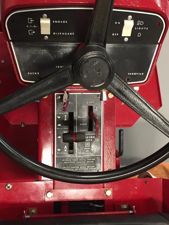

19richie66 17,846 #1 Posted February 8, 2018 Where these mount in the dash, is there a bezel or sleeve they each fit into where they go through the hole or are they straight through and the nut tightens them up? Reason I ask is mine did not have an original switch or any lighter in the hole. Both of the holes look huge. I just didn’t know if there was something that took up the space. Also if anyone has a picture of a gt14 lighter assy with measurements, I would appreciate it. Share this post Link to post Share on other sites
953 nut 64,860 #2 Posted February 8, 2018 8 minutes ago, 19richie66 said: is there a bezel or sleeve they each fit into where they go through the hole or are they straight through and the nut tightens them up? The lighter on mine is long gone been replaced by a flasher/switch. but the hole looks right for a direct mounting. The ignition switch is also a direct mount. 1 Share this post Link to post Share on other sites
p38js 441 #3 Posted February 8, 2018 This is the best picture I have right know with the lighter. My assembly was corroded pretty bad so I bought a replacement lighter assembly from Pep Boys and swapped the original knob with the new one and it works as advertised. 1 1 Share this post Link to post Share on other sites
Achto 31,416 #4 Posted February 8, 2018 I believe that all lighter bodies are the same, I've used off the shelf lighters to replace the missing factory ones on some of my tractors. No extra bezel should be needed, unless some one has made the hole larger on yours. 1 1 Share this post Link to post Share on other sites

19richie66 17,846 #7 Posted February 8, 2018 Well I got half my problem solved. I was digging in the old parts stash last night and came across stock wheel horse lighter assembly. Tried it and it fits. Now to figure out the ignition switch. Maybe its just me but the hole seems huge. They had a washer on it to keep the switch nut from pulling through. I have a larger cole hersee ignition switch I will have to try. If it fits, it gets used. I’ll know today. I got my light switches in yesterday so I can get my dash wired up. Coming together slowly. 5 Share this post Link to post Share on other sites
Sarge 3,470 #8 Posted February 8, 2018 Thanks @gwest_ca , I had forgotten about the whole male versus female stud thing on those elements. Dad used to know all the part numbers from NAPA for replacement elements, but he's gone and I'm fuzzy on this old stuff these days. Almost all of the 60's ignition switches used a D shaped hole, external tooth washer and nut , some have been drilled round to accept aftermarket switches. If you have a Cole-Hersee L-key switch with the heavy lugs/screws that one is rated to handle the load of a starter-gen, but it's still a good idea to switch it over to using a heavy duty relay and get all that battery power out of the dash - they are a great fire starter.. Looking forward to the big 14 and some pics of it done... Sarge 1 Share this post Link to post Share on other sites

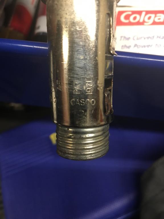

19richie66 17,846 #9 Posted February 8, 2018 (edited) You and me both! I will know today if the ignition switch will fit the hole. It’s heavy duty. The lighter I have is a Casco dated ‘71. Thanks for all the help. Edited February 8, 2018 by 19richie66 Share this post Link to post Share on other sites
Sarge 3,470 #10 Posted February 8, 2018 That's great - I've never had a lighter that was marked yet - or my tired eyes just can't see it but I'm used to hunting for numbers on parts/bearings anyway. Original, nice condition lighters are getting like the hood ornaments - crazy expensive used. Sarge 1 Share this post Link to post Share on other sites
19richie66 17,846 #11 Posted February 8, 2018 (edited) Its on the socket part, not the twist on barrel. Edited February 8, 2018 by 19richie66 2 Share this post Link to post Share on other sites
Sarge 3,470 #12 Posted February 8, 2018 Yeah - I searched through google images and found that - none of the ones I've here were legible or showed the stamping, weird. Part numbers like that really help - it's how I found a slew of NOS Cole-Hersee L-key switches years ago. Sarge 1 Share this post Link to post Share on other sites
19richie66 17,846 #13 Posted February 9, 2018 (edited) Well the cole hersee body is too big. A regular ignition switch will work but Ill have to make a bushing for the switch to sit in. Someone hogged out the hole. I appreciate all the help. Edited February 9, 2018 by 19richie66 Share this post Link to post Share on other sites
953 nut 64,860 #14 Posted February 9, 2018 27 minutes ago, 19richie66 said: Ill have to make a bushing for the switch to sit in Bet you can find one here. https://www.mcmaster.com/#bushings/=1bhji3c Share this post Link to post Share on other sites
