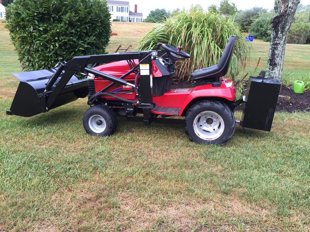

stevebo-(Moderator) 8,743 #2 Posted February 7, 2018 I own the 520LXI which has the liquid cooled Kawaski motor and I run a 60" deck on it. I will never go back to mowing with the older style horses as the XI is just a different machine. I also have a 522xi with loader. That has a 22 hp air cooled Kohler twin. It has under 500 hours and runs like a top. You cannot go wrong with it. The downside of the 60" deck is that it is very heavy to take off and move around. I would not hesitate to buy it but make sure you do the usual testing of the hydro once it is nice and hot and drive up hills. The hydro has a high and low speed so try both. Check over the engine for smoke as cold start etc. Good luck and keep us informed on what you plan on doing. Pic below are of my 522xi with loader. 4 Share this post Link to post Share on other sites

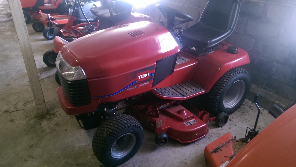

EricMassey 14 #3 Posted February 7, 2018 (edited) Thanks for the info, I will keep everything in mind. We have 4 520-H’s and 3 of them have the 60” decks so I know all about how heavy they are lol... This one has sat outside for awhile as it’s pretty fadded but doesn’t look to be beat up and abused.. Do you know rightly how many hours the Kohler air cooled motor seem to run? I’m going to try and go look at it this weekend so we will see! Edited February 7, 2018 by EricMassey Share this post Link to post Share on other sites

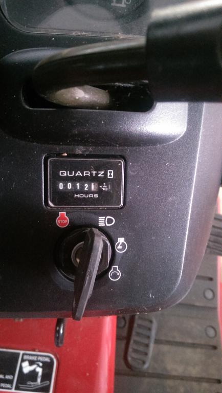

WVHillbilly520H 10,379 #6 Posted February 8, 2018 (edited) I bought a one owner dealer serviced 1200hr 520xi with 60" deck last Nov, but after owning the a 520H since new ok just my personal opinion, 520H with the Onan has more power the front axle has more articulation for going over ditches ect, and implement/attchment interchangeability and with the xi I really wasn't fond of the toe/heel "rocker" pedal, if it were a side by side set I probably would have liked it better, the lift lever where the motion control is on the H, the steering linkage not as heavy or simple, the pluses of xi the hi/lo range trans,cruise control, tilt column, one piece fender pan, power steering (518/520xi doesn't), more weight for traction, IDK if everybody knows this but you CAN leave the deck ON and lock the lift linkage in the up position and with a rear clevis hitch on you can use it with plow disc rear scraper blade ect, attachments harder to come by at they are xi only (Toro made it blue for New Holland), the smart steer is love or hate, when I brought it home after carrying that 60" deck all those years most if not all the bolts holding the transaxle to the frame had backed out and letting it "flop" around causing a jerkiness, again just MY personal experiences/thoughts, had I bought the xi new when I bought the anniversary they may be different now, but I sold it and up graded to compact 4wd with FEL and kept my 2 classics, Jeff. Also from what I hear engine life 2000-3000 hrs if maintained/serviced regularly. Edited February 8, 2018 by WVHillbilly520H 2 Share this post Link to post Share on other sites
EricMassey 14 #7 Posted February 8, 2018 (edited) 20 minutes ago, WVHillbilly520H said: I bought a one owner dealer serviced 1200hr 520xi with 60" deck last Nov, but after owning the a 520H since new ok just my personal opinion, 520H with the Onan has more power the front axle has more articulation for going over ditches ect, and implement/attchment interchangeability and with the xi I really wasn't fond of the toe/heel "rocker" pedal, if it were a side by side set I probably would have liked it better, the lift lever where the motion control is on the H, the steering linkage not as heavy or simple, the pluses of xi the hi/lo range trans,cruise control, tilt column, one piece fender pan, power steering (518/520xi doesn't), more weight for traction, IDK if everybody knows this but you CAN leave the deck ON and lock the lift linkage in the up position and with a rear clevis hitch on you can use it with plow disc rear scraper blade ect, attachments harder to come by at they are xi only (Toro made it blue for New Holland), the smart steer is love or hate, when I brought it home after carrying that 60" deck all those years most if not all the bolts holding the transaxle to the frame had backed out and letting it "flop" around causing a jerkiness, again just MY personal experiences/thoughts, had I bought the xi new when I bought the anniversary they may be different now, but I sold it and up graded to compact 4wd with FEL and kept my 2 classics, Jeff. Also from what I hear engine life 2000-3000 hrs if maintained/serviced regularly. Thanks for the info and your input. If I do happen to purchase this 522xi I will also be keeping the 520-H just for all my implements, snow blower, snow plow, and tiller work. I have converted the 520-H to a rocker style foot controlled motion lever as I never liked the one on the dash.. they also said that the 60” deck had just been put under this one as something happened to the smaller deck so hopefully it hasn’t packed that big heavy think around all it’s life. Like I said thanks for your input I will keep that in mind when I go to look at it. Edited February 8, 2018 by EricMassey 1 1 Share this post Link to post Share on other sites
