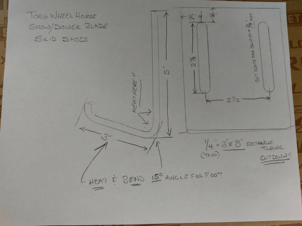

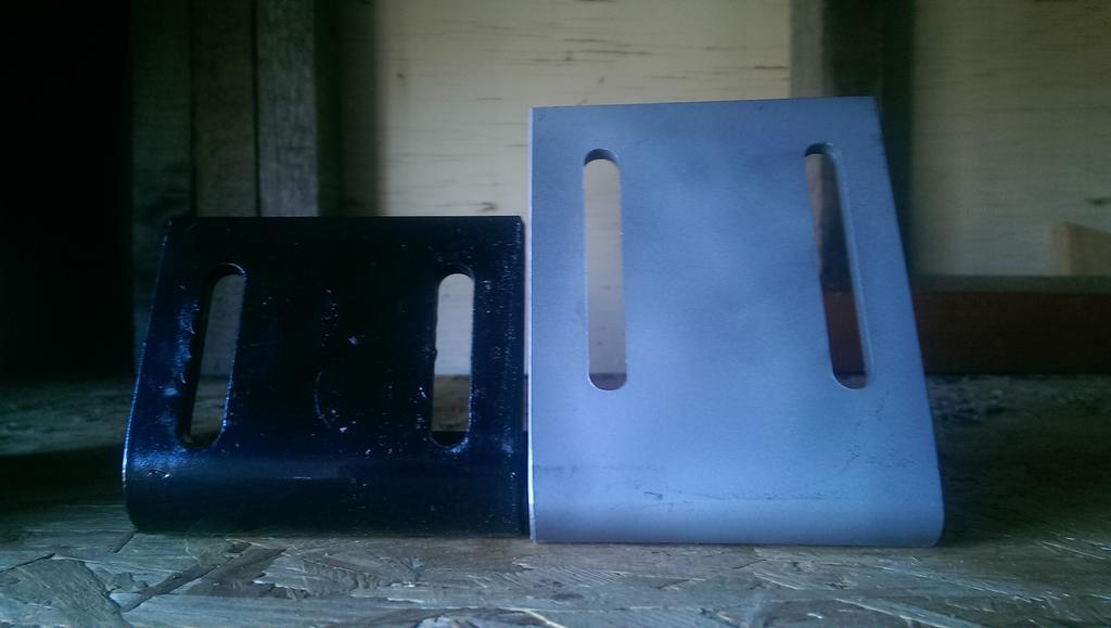

Just picked up a 48" Snow plow for my 2000 522xi. Cleaning it up to mount this weekend. The plow looks almost identical to the one on my 310-8 (A-frame; plow;) but there are no plow shoes on the bottom of the plow. On my 310-8 the shoes are simple bent iron with a single bolt running through the mold board. Can anyone provide a pic on what part # 92-6840 "Blade Skid" looks like? There are a couple holes on either side that look like a skid slips into these factory holes but a pic (should I have to fabricate a new set of skids) would really help. Thanks in advance.

The black ones in 1st pic are the factory skids, the unpainted are a set I made myself, the second pic is the ones I made mounted up, and 3rd here's the blueprint, Jeff.

Hey WV Hillbilly! Excellent! Thanks for the pics and specs! Very much appreciated!
Tom
I'm sure 1/4"x4" flat HRS would work, just take longer to make all the bends, Jeff.
