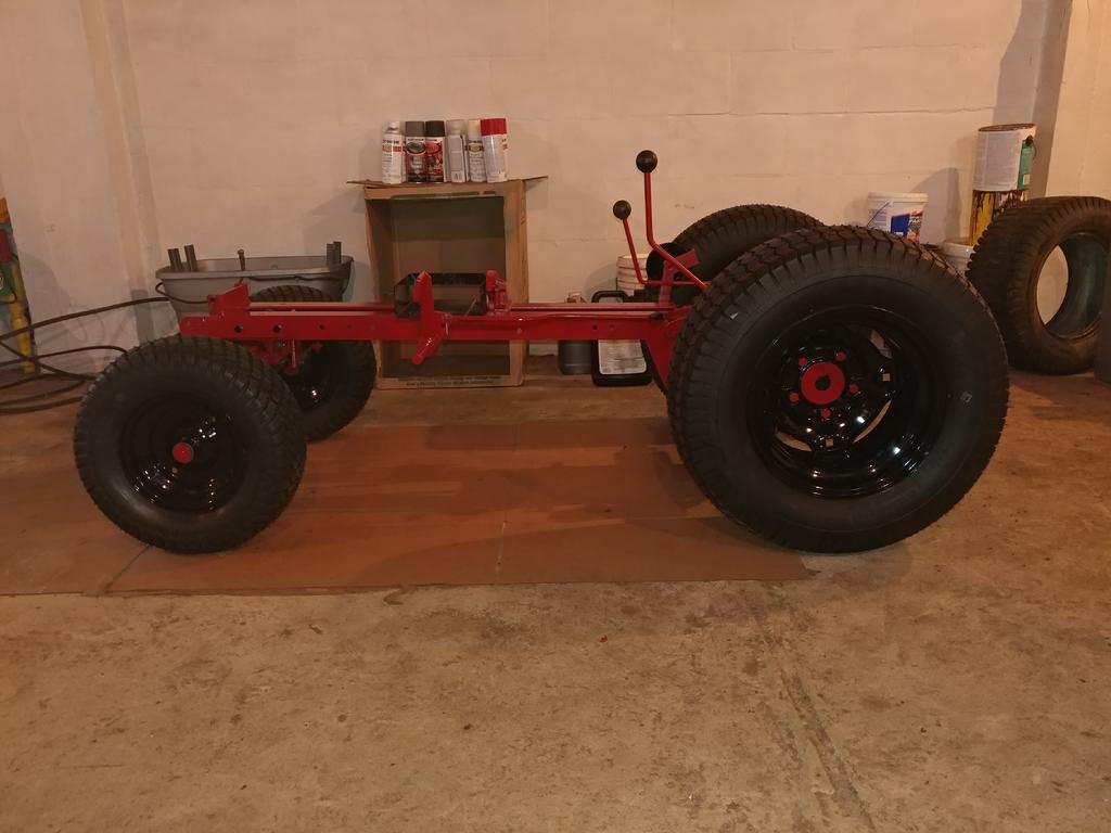

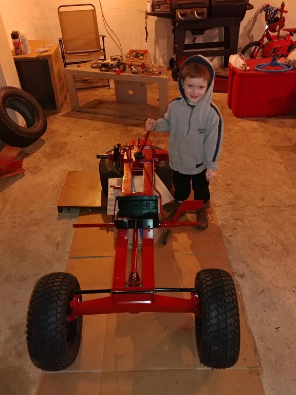

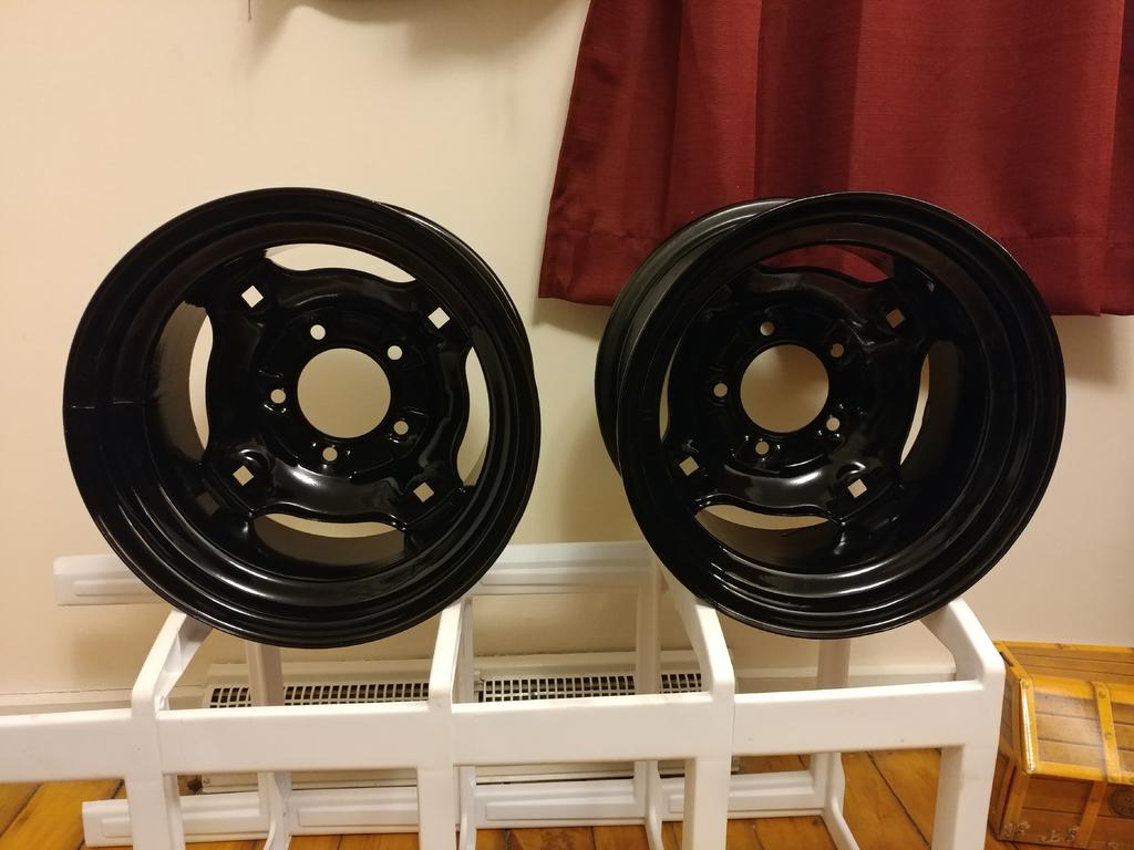

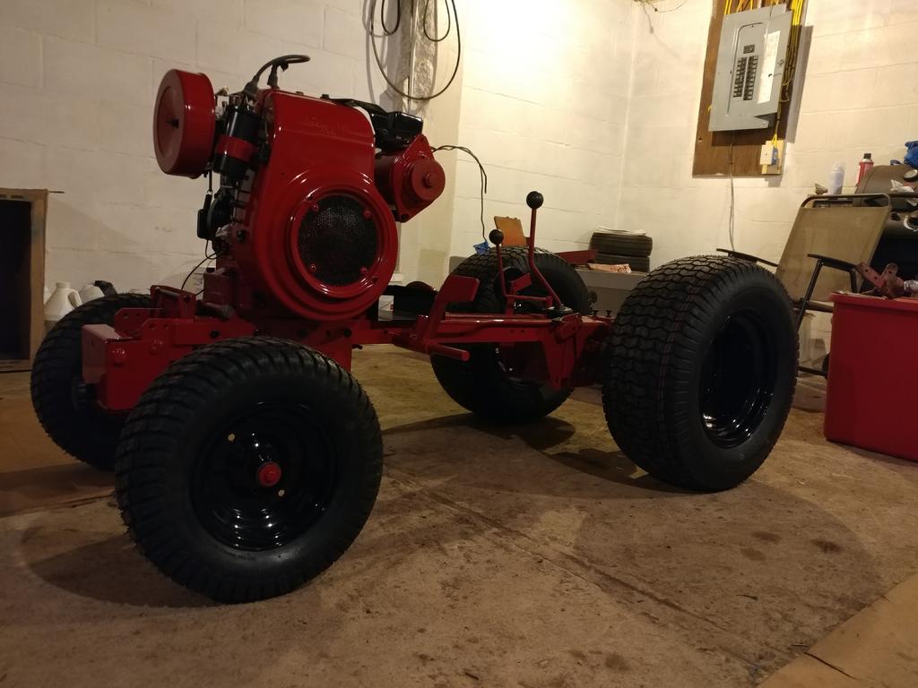

Joshn569 273 #51 Posted March 13, 2018 4 hours ago, WHX14 said: I always like the black contrast with the red. I t just makes the whole tractor pop a little more and forces one to see detail work more. @JPWH, myself and @Achto is doing one with some black trim and no matter how you do it you can never be wrong. Next non original I do will get the same treatment. Looking good .. get that tranny together and you'll have a fine roller! That engine does look good in black! I wasnt sure if doing the wheels black would offend anyone lol. I have a vision in my head so we shall see how she looks as it starts to come together. Side project, Today I put some tubes into my c81 front wheels. I quickly shot them in antique white. The rusty ole girl looks good with fresh paint on the wheels. 3 1 Share this post Link to post Share on other sites

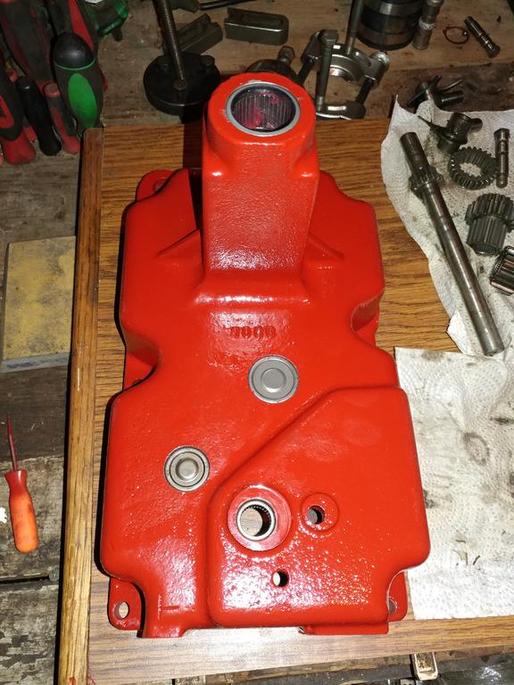

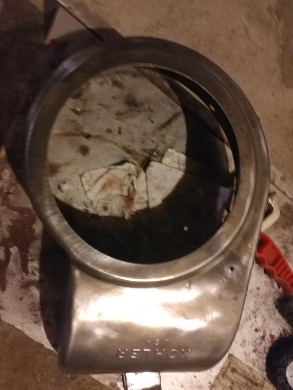

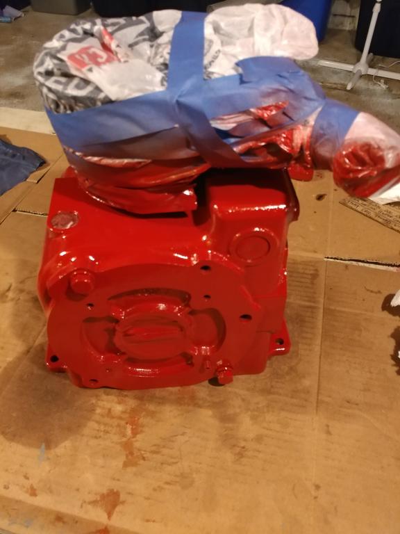

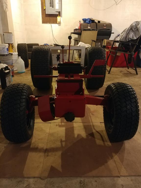

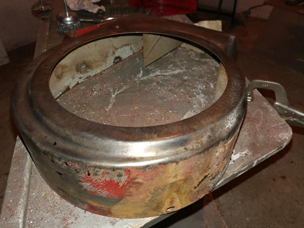

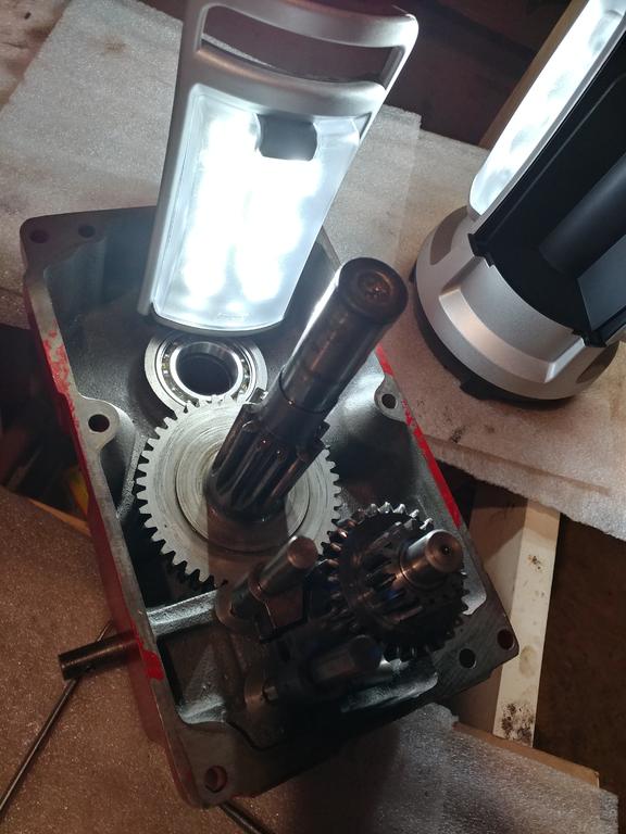

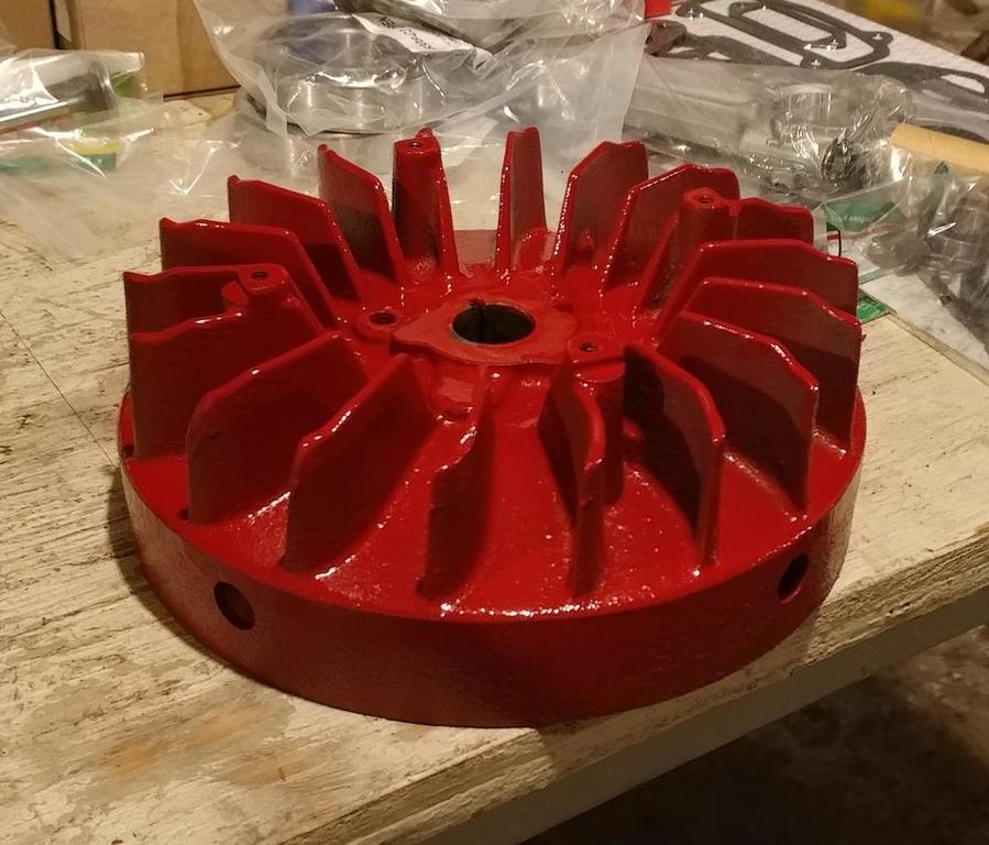

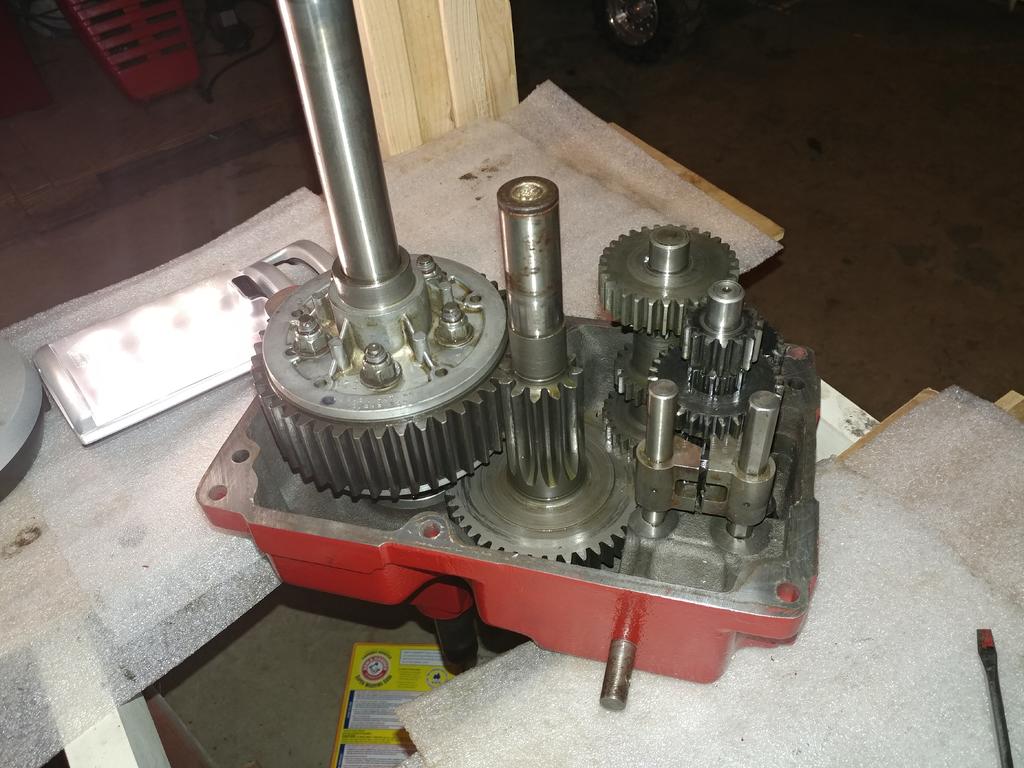

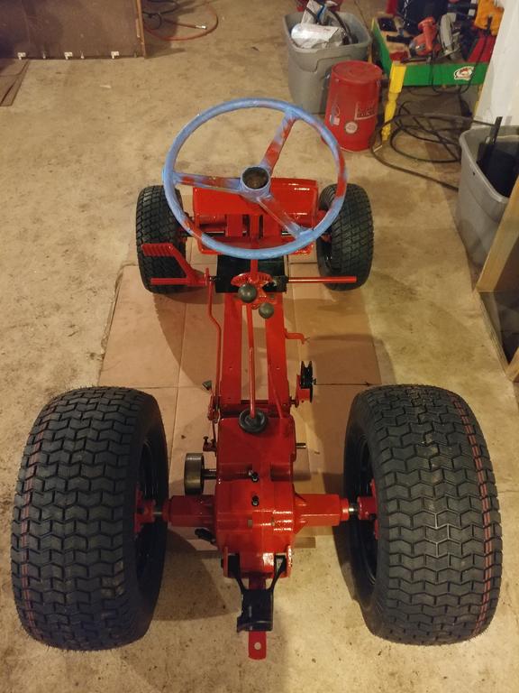

Joshn569 273 #52 Posted March 15, 2018 Rear end is back together. 👍 Gonna have to order the input shaft and brake shaft seals again as I somehow destroyed them putting the cases together. Got a few more parts in primer too. Kohler shroud will need some work as the bottom has some areas of swiss cheese. 5 2 Share this post Link to post Share on other sites
Mike'sHorseBarn 3,712 #53 Posted March 15, 2018 6 hours ago, Joshn569 said: Rear end is back together. 👍 Gonna have to order the input shaft and brake shaft seals again as I somehow destroyed them putting the cases together. Been there. I usually don't like to put the oil seals on until after I have the transmission back together. Seems like I don't ruin them as fast this way. The horse is looking good, keep it up!! 2 2 Share this post Link to post Share on other sites
WHX?? 58,381 #54 Posted March 15, 2018 Boogered up seals has been done by the best of us so you are in good company. Sometimes I'll wreck one on purpose just to have it over and done with! Lube up seals well when installing and maybe some tape over sometimes sharp keyway edges to keep from cutting seals. 2 1 Share this post Link to post Share on other sites

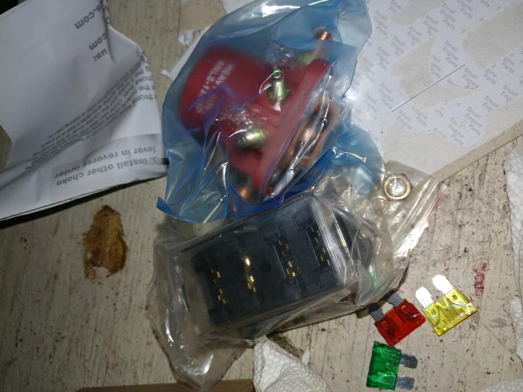

Joshn569 273 #55 Posted March 15, 2018 Oh yea look what came in the mail today 4 1 Share this post Link to post Share on other sites

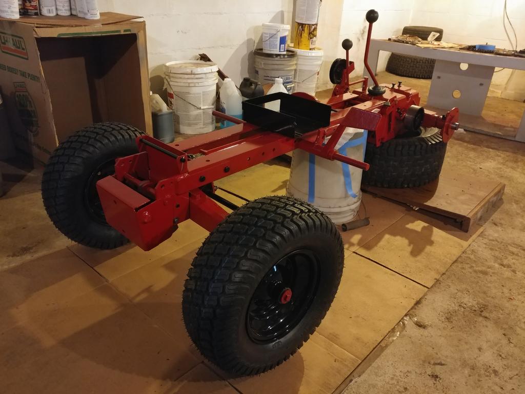

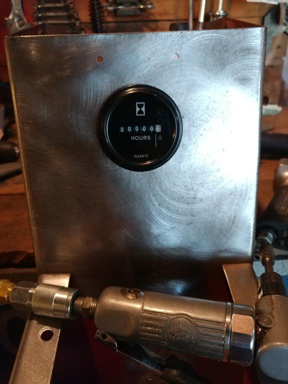

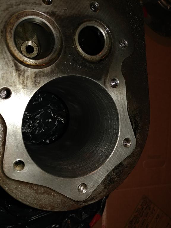

Joshn569 273 #56 Posted March 17, 2018 Some more progress. Added and hour meter. Got my block back from the machine shop with a fresh cylinder bore. Waiting on some warm weather to do some more painting 6 Share this post Link to post Share on other sites

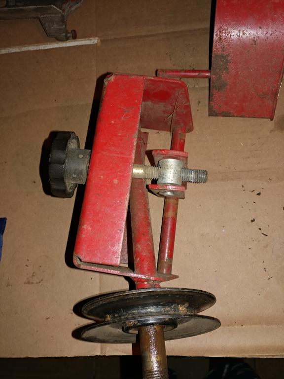

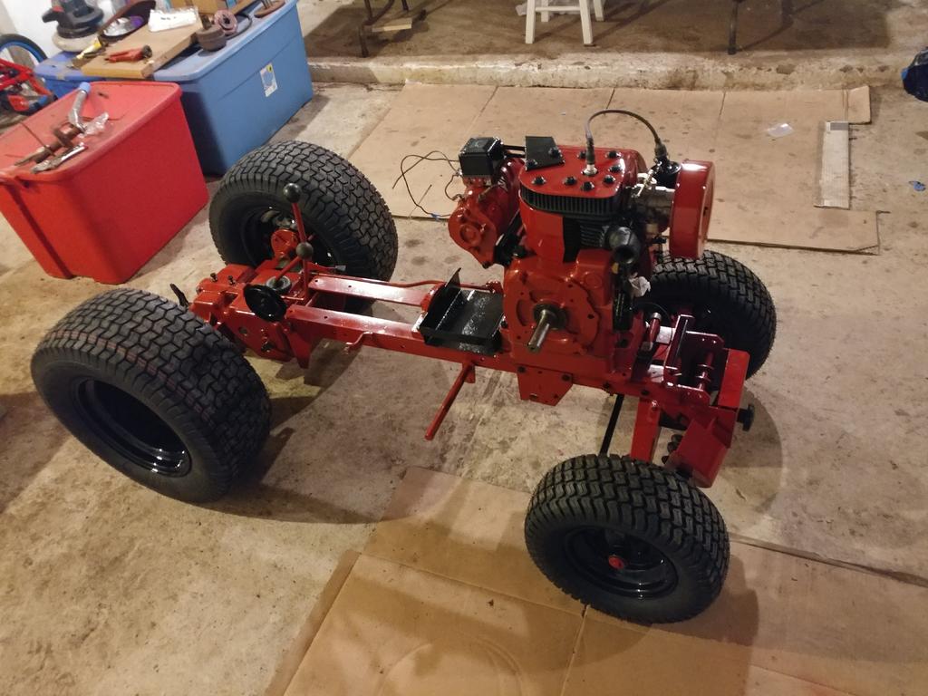

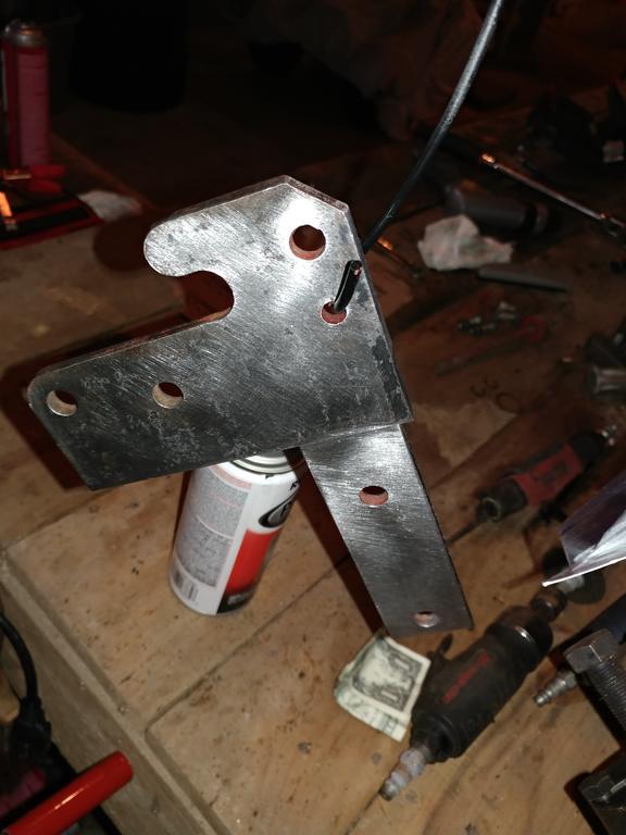

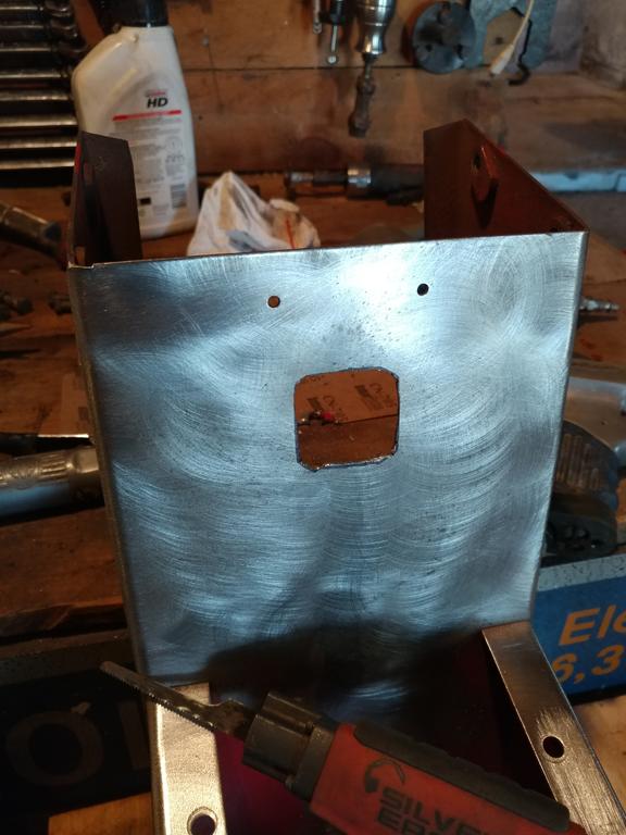

Joshn569 273 #57 Posted March 20, 2018 Got the mule drive retro fit onto the raider. Had to cut a notch out of the front bracket the hood mounts to but it worked out good. Question on rear axels, does the hub set screw get set behind the key? One side had the set screw right in the keyway and the other behind it. I tightend it down while behind it but questioned how far the axel is sticking through the hub. 3 Share this post Link to post Share on other sites
Achto 32,953 #58 Posted March 21, 2018 1 hour ago, Joshn569 said: Question on rear axels, does the hub set screw get set behind the key? The set screw should tighten down on top of the key. Your axle should be flush with end of the hub. 1 1 1 Share this post Link to post Share on other sites
Pullstart 71,542 #60 Posted March 21, 2018 I think the trans hi/lo lever needs to point forward, I think. But I can only hope my upcoming trans rebuilt looks this great when it's done! Share this post Link to post Share on other sites
Joshn569 273 #61 Posted March 21, 2018 5 hours ago, pullstart said: I think the trans hi/lo lever needs to point forward, I think. But I can only hope my upcoming trans rebuilt looks this great when it's done! Yea I had it backwards lol 1 Share this post Link to post Share on other sites

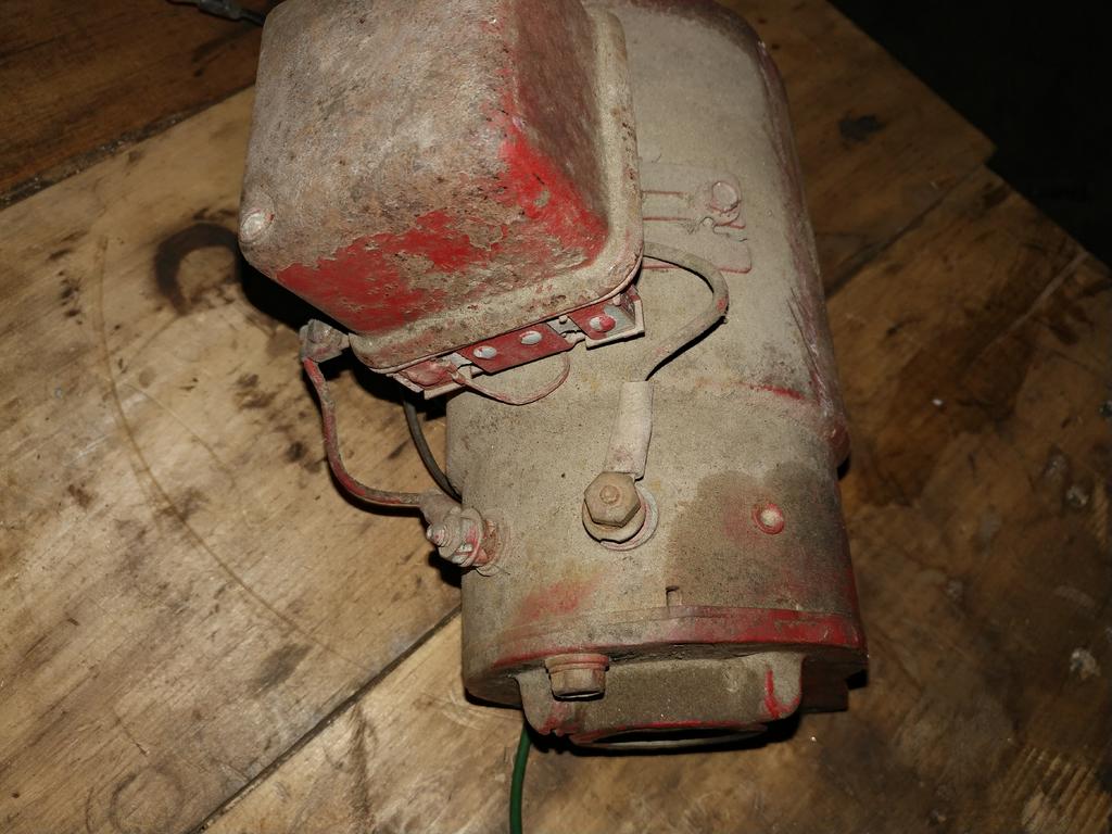

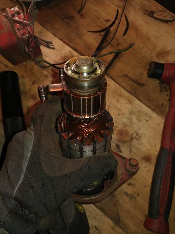

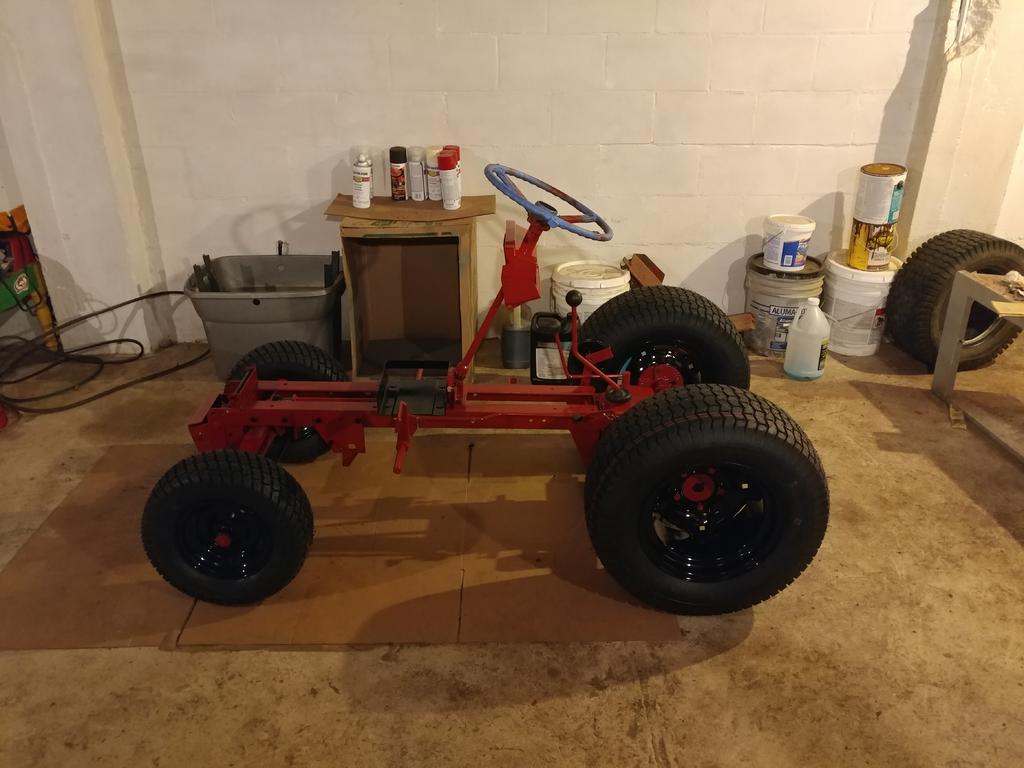

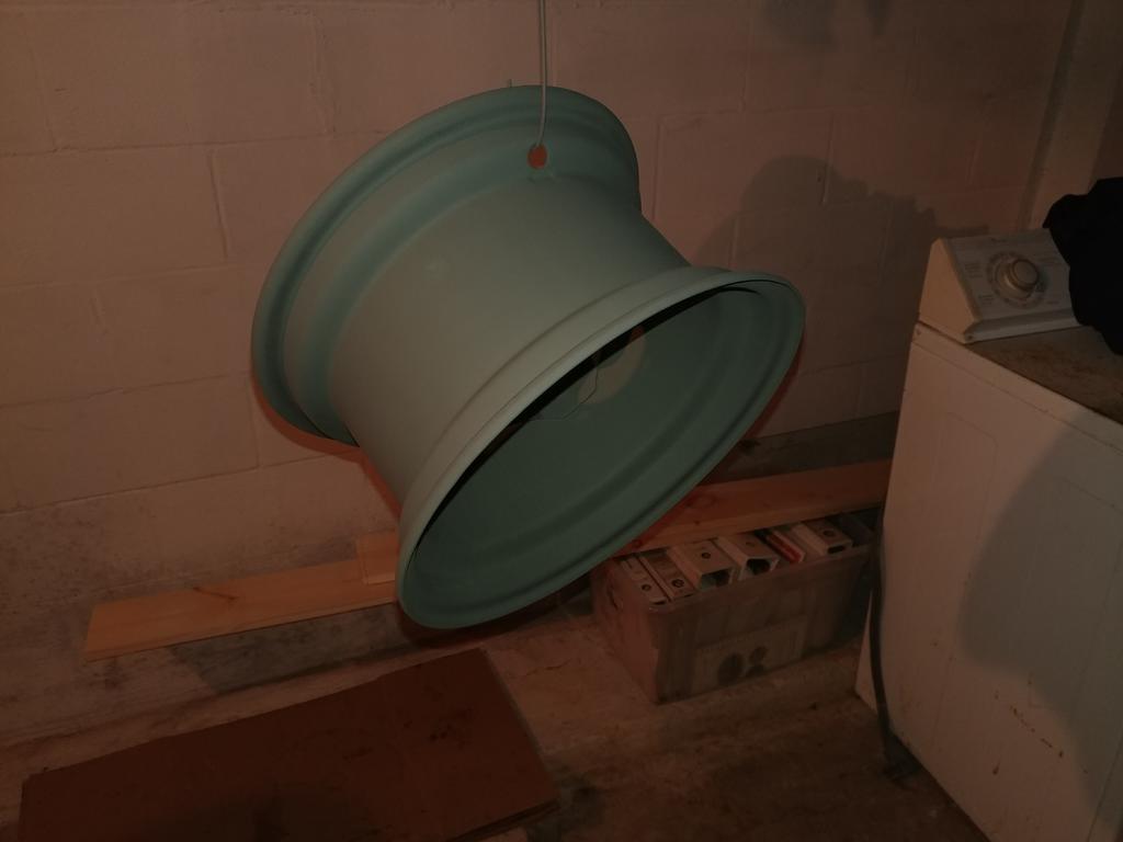

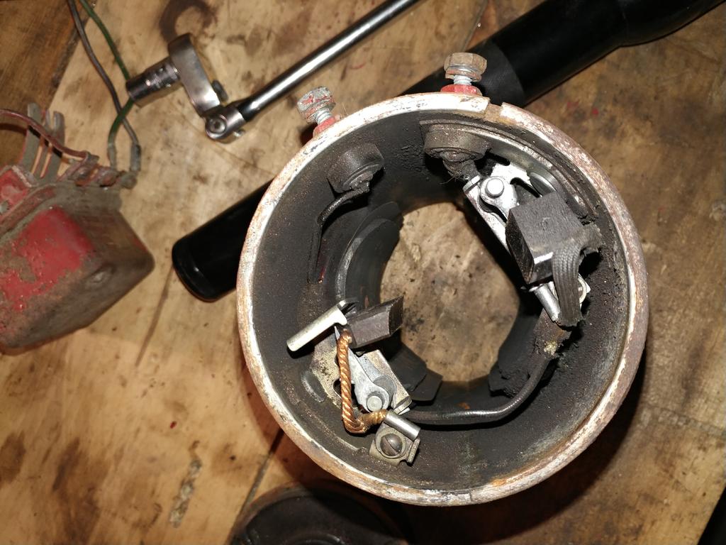

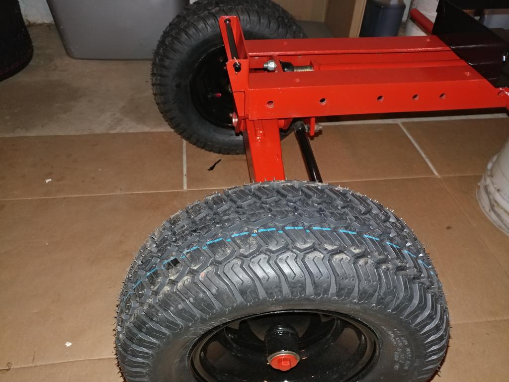

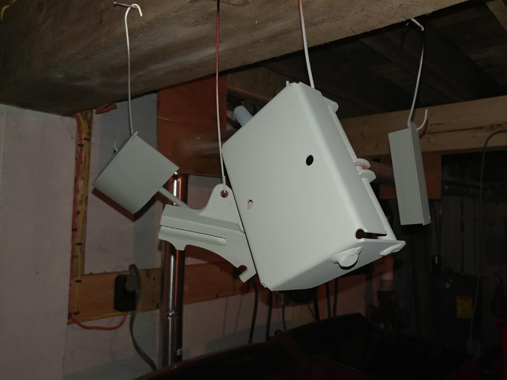

Joshn569 273 #62 Posted March 22, 2018 A few more things bolted on. I kind of rushed painting the rear rims, plus it was cold out (i paint outside then bring them right inside to dry) and well they dont look as good as I had hoped. I may redo them. I think i put a tire on backwards also, didnt think it matterd but the tread is going opposite ways but thats for another day. Got some paint on the engine. Should have the cylinder done tomorrow and then i can start to assemble it. Started to take the start/gen apart for rebuild and paint too. I never was able to get the steering wheel off. Even with using a press she didnt wanna budge. So instead of breaking something i just worked around it. I need to drag my mower deck inside and give it a good once over sooner than later also. 3 2 Share this post Link to post Share on other sites

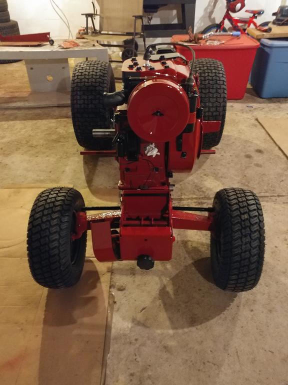

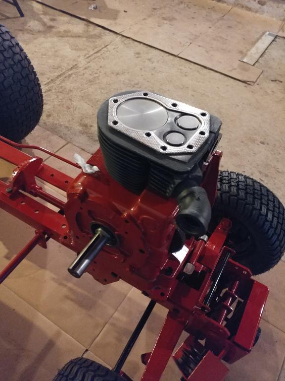

Joshn569 273 #71 Posted March 25, 2018 I was planning on using the old carb instead of the one that came with my engine kit, but when i tore it down today i found it was damaged so i will give the new one a try. Im a little skeptical about how well a cheap carb will perform, but i will give it a chance. Motor is in! This thing is starting to look like a tractor again! I used some bondo to fill the holes in the bottom of the shroud. Still need a fuel pump rebuild kit and exhaust but im close. I want to use a stack if anyone has any suggestions I also picked up a fuse block and starter solenoid. Might try to put them in if i can find a spot when i start to rewire everything. 3 3 Share this post Link to post Share on other sites
Achto 32,953 #72 Posted March 25, 2018 That's looking really nice, I like the black accents. 3 1 Share this post Link to post Share on other sites
classiccat 548 #73 Posted March 25, 2018 Lookin' really sharp!! and you don't have to worry 'bout your thumb rustin' up on ya! 6 Share this post Link to post Share on other sites
rjg854 13,432 #74 Posted March 25, 2018 10 hours ago, Achto said: That's looking really nice, I like the black accents. I was thinking the exact same thing. Share this post Link to post Share on other sites
