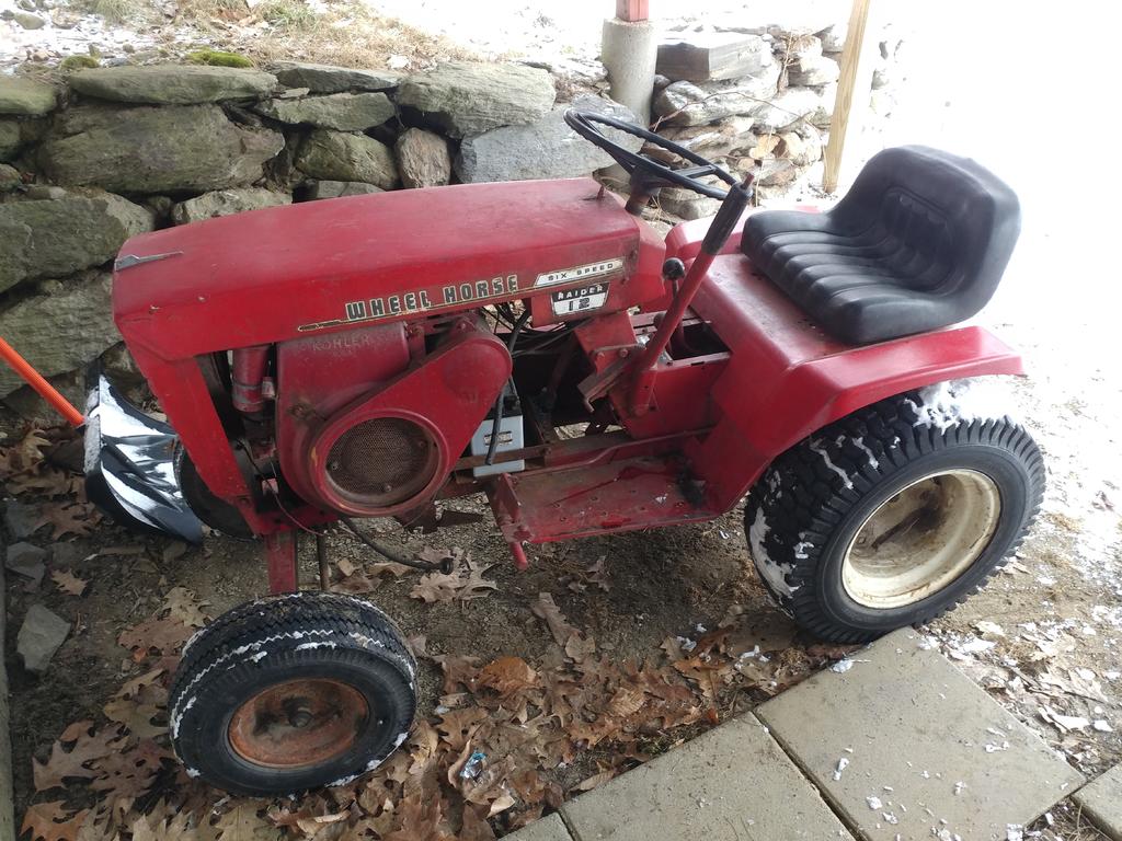

Joshn569 273 #1 Posted February 1, 2018 Hello, So i just picked up a raider 12 6speed with a Kohler 12. I havnt tried to start it yet, but it does turn over. Guy said it ran last summer. However, it does not roll when pushed. It seems like its stuck in gear. The shifter will shift into all gears, and hi/lo moves too. When i jack the rear end up it will spin ok but wheels turn opposite way. The clutch (clutch/brake?) doesnt make any difference. Any advice on what to check out first? I havnt really checked it out to much yet, not even sure of the year. 3 1 Share this post Link to post Share on other sites
953 nut 63,618 #2 Posted February 1, 2018 Likely there is some water in the transmission and it has frozen. get it inside and let ti thaw. Once it thaws out drain the old fluid and put in a half gallon of diesel fuel to cleans the transmission then replace it with 90 gear oil. Check the rubber boot on your shifter, probably needs a new one. This manual will come in handy. 5 Share this post Link to post Share on other sites
953 nut 63,618 #3 Posted February 1, 2018 It appears the engine has been replaced with a slightly older model so the wiring diagram from a 1267 would serve you better. 1 1 Share this post Link to post Share on other sites
WHX?? 53,905 #4 Posted February 1, 2018 Definitely the wrong motor and the wiring will be different if you have issues ther. If you can give us a pic of the name plate on the motor we can nail it down further. What could be better than a Raider with a starter/generator motor! 2 Share this post Link to post Share on other sites

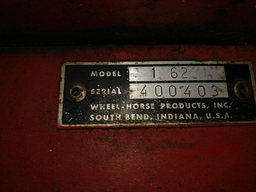

Joshn569 273 #5 Posted February 1, 2018 I man handled it into the basement ( luckily the wife is at work tonight ) and 10 min later it started rolling! Since its warm and there is light down there im gonna go over the old girl and check it out. Here is the engine tag And thanks too 1 1 Share this post Link to post Share on other sites
Ed Kennell 44,134 #6 Posted February 2, 2018 (edited) The B serial # dates the engine at 1966. Can you get the tractor plate numbers? Edited February 2, 2018 by Ed Kennell 2 1 Share this post Link to post Share on other sites
Ed Kennell 44,134 #8 Posted February 2, 2018 M/N 1-6231 is a 1968 model. And that is the engine listed for the 1968 Raider It appears 1968 was the last Raider with the starter/generator. No Raiders listed in 1969 and in 1970 Kohler K301-47371C and 47147C and Tecy HH120s were used. 3 1 Share this post Link to post Share on other sites

WHX?? 53,905 #13 Posted February 2, 2018 Yup my thoughts too Richard ...if thats the case this (might?) be a very special tractor. I was always under the impression all the S/G motors were used up in late 67 but who knows I was only 8 in '67!! I'm in conflict with Ed that '68s had any kind of of a S/G motor but i guess that would not be impossible? I think we need to get our files mod Garry in this @gwest_ca as he tracks the numbers closely and is trying to track serial nos. and when things changed. if we are confusing you abit her Joshn but still do take all of the well above advise ad let us know with any issues. We are always learning about these tractors as much as you are! Opps Garry has spoken..... He mentions early production... excuse me while I go study! 2 2 Share this post Link to post Share on other sites
gwest_ca-(File Mod) 11,932 #14 Posted February 2, 2018 Yes there was a mid-model year engine change but the tractor model numbers stayed the same. Had this happened a few years later with the increased volume and models produced the tractor model number would likely have changed with the engine. Garry 1 Share this post Link to post Share on other sites

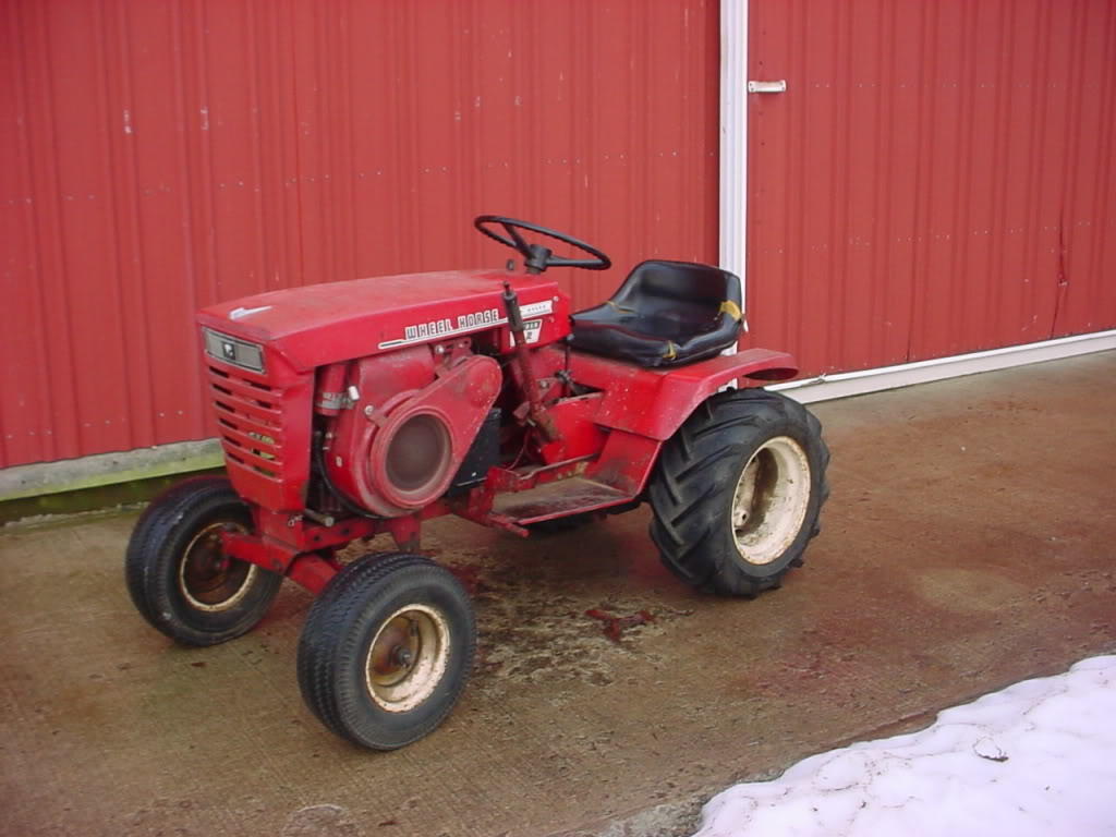

520HC 208 #15 Posted February 3, 2018 That is the factory engine. Have one just like it. Share this post Link to post Share on other sites
520HC 208 #16 Posted February 3, 2018 (edited) Also the 1968 Charger models had some with starter gen engines. Have one of them too. Here is the Raider Edited February 3, 2018 by 520HC 2 Share this post Link to post Share on other sites
