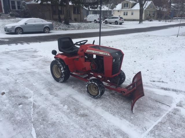

Danm1441 10 #1 Posted February 1, 2018 This is my first year with a Wheel Horse 312 8. I am using the machine to plow my driveway, but am mainly winging it as I have always used only a walk behind snow blower before. So I have a couple of questions that would help me do this the right way. When I am plowing, I use only reverse and high range 1st gear. I also run the throttle all the way up. I have noticed that at some points if I am turning, the tractor will try to go straight ahead even though the front wheels are turned. I can correct this by stopping then turning the wheels, but wonder if this is the correct way to handle this or if there is some other method that would do away with this tendency. Running the machine at full throttle in first gear or reverse makes me think the machine is moving faster than it needs to. My question in this regard is should the throttle be set at less than full , should I be using a lower gear, or am I just "gun shy" being a complete novice? On the plus side, I sure wish I had discovered these machines earlier in my life. I still don't like snow, but clearing it with the Wheel Horse certainly is a lot more fun than any other method I've done. Thanks for any help. 4 Share this post Link to post Share on other sites

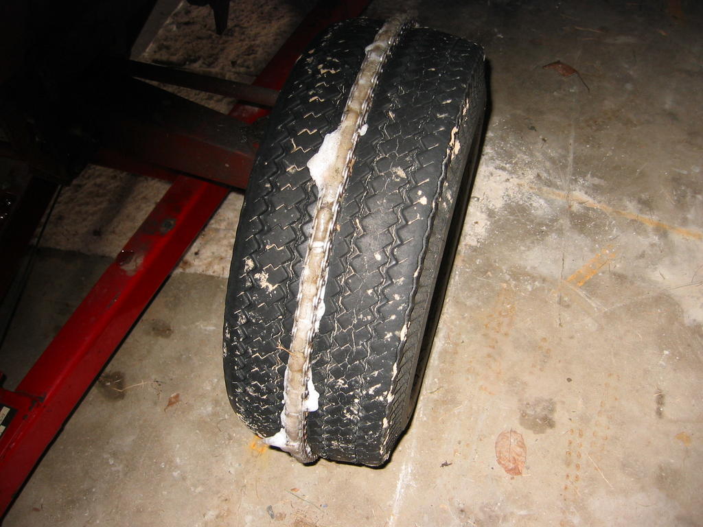

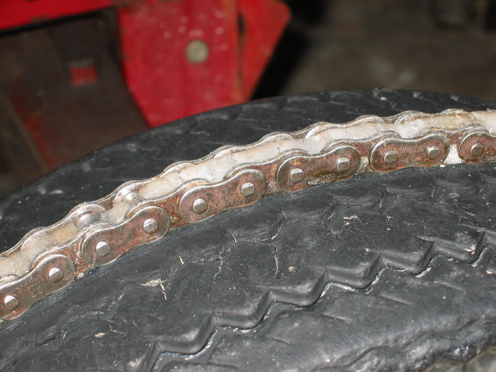

pfrederi 19,069 #2 Posted February 1, 2018 Usually you run out of traction before power. With a gear drive like yours i would run in 3rd and change the throttle to fine tune my speed. You want the snow to roll off the end of the plow. Down side of speed is if you have hidden obstacles hitting them at speed and break things. I plow the same are all the time so thatisn't a concern. If it was a stringer area I would probably drop down to 2nd. Front wheel sliding is a common problem. Front weights and chains help. I have good luck with roller chain on my fronts. 8 Share this post Link to post Share on other sites
