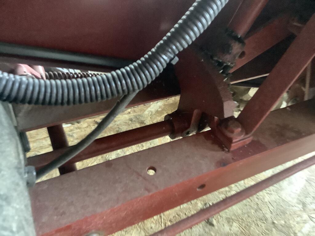

Pullstart 71,233 #101 Posted March 10, 2021 1 hour ago, WHX24 said: In my quest for front end parts for a '61 or 62 looks like that tractor has got full length tie rods instead of only one Kev. That would mean it has the triangle plate welded to the lower shaft and no drag link. I woulda thought that it would have shared the same front end parts as a say a 702? Which is just a single short tie rod and drag link. Your steering gear looks '63 ish. I need to look at the IPL for a 502 I guess. My ‘62 tractor has a ‘64 frame, ‘78 trans and rear wheels, and an air compressor engine 1 Share this post Link to post Share on other sites

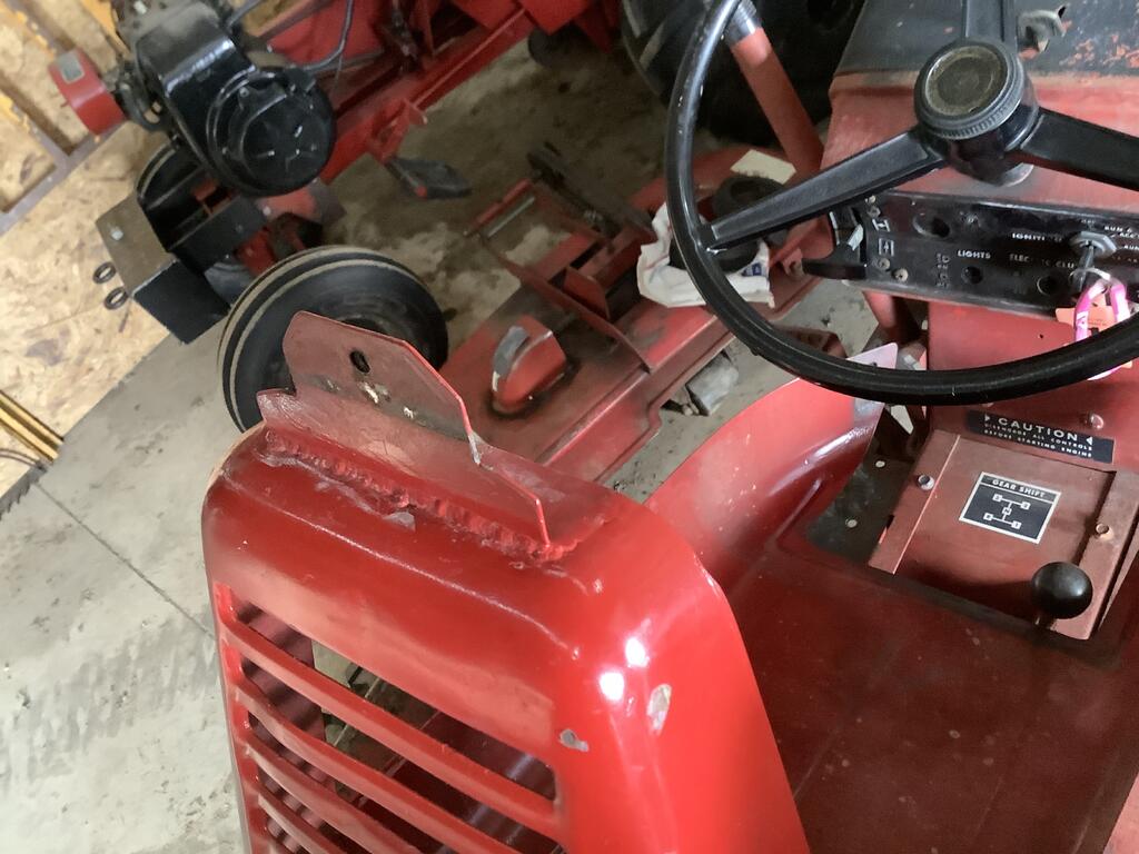

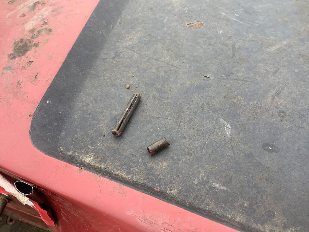

Pullstart 71,233 #104 Posted March 10, 2021 (edited) I noticed yesterday’s trail ride gave me about 1/4 turn of steering slop in the wheel under certain conditions of field operations. The roll pin in the fan gear was a bit shorter than it should be. Good to go now, ‘cept I’m sure Uncle Jim will flame me for using the WHRat’s hood for a work bench! Edited March 11, 2021 by pullstart 1 1 Share this post Link to post Share on other sites

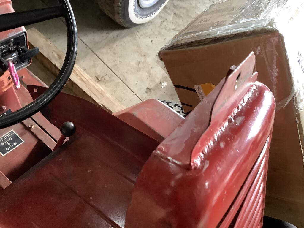

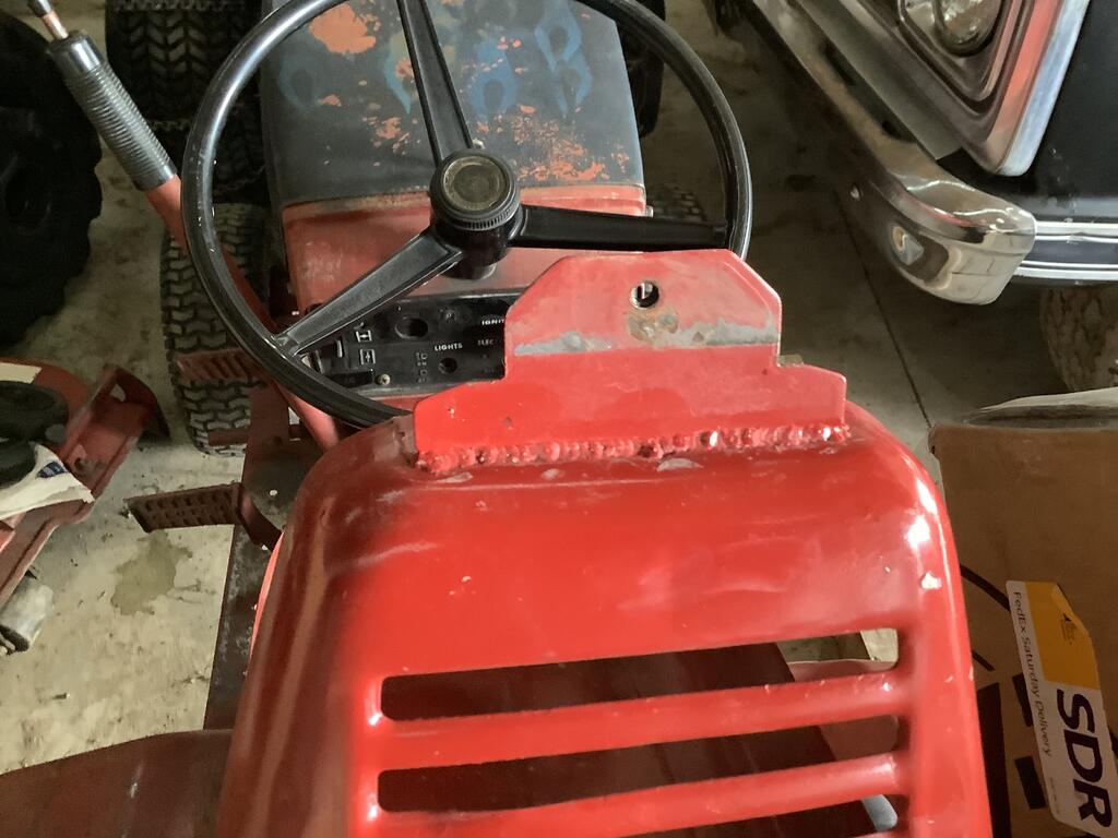

Pullstart 71,233 #107 Posted July 29, 2021 On 3/16/2018 at 8:27 AM, pullstart said: I cut the hood repair panel out of a box store yard cart/trailer tailgate that was dropped off for my scrap pile, then trimmed it to fit between the frame rails and rest on the edges of the angle iron. in reference to the lack of pictures in 2018... here are some more front hood mounting tab details. 1 1 Share this post Link to post Share on other sites

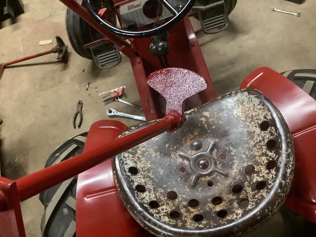

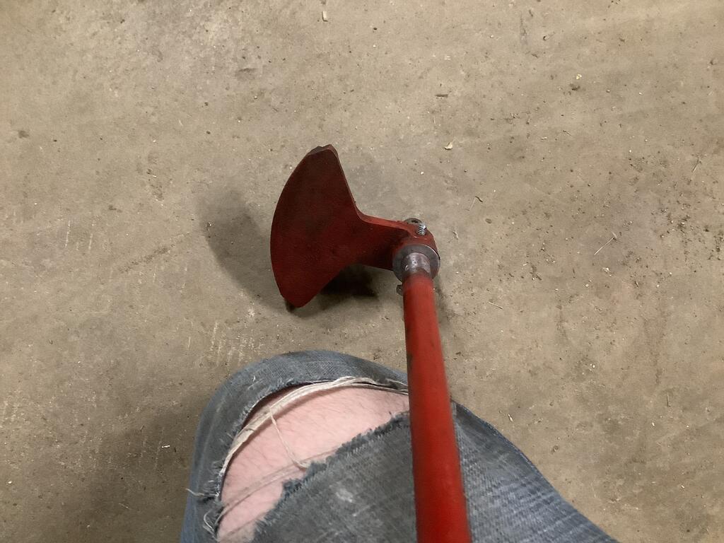

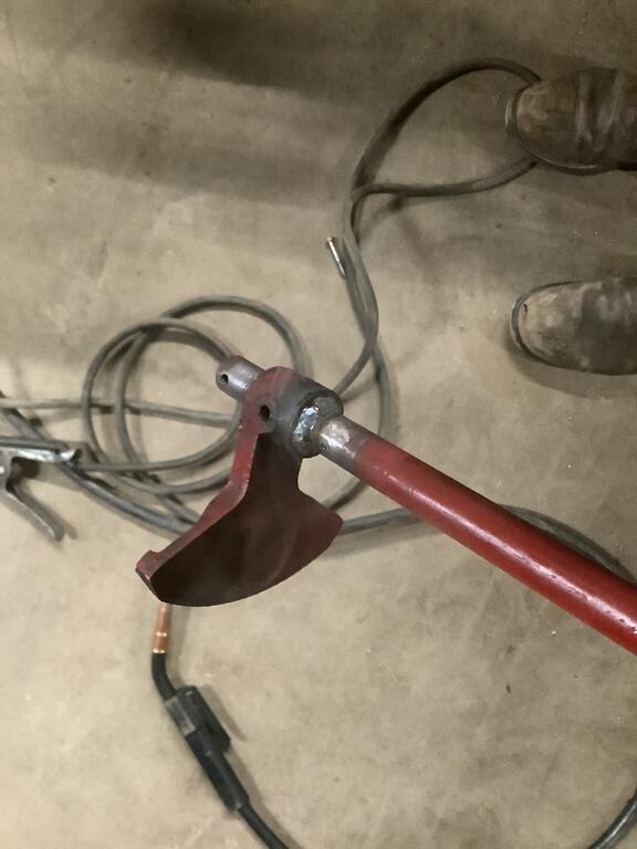

Pullstart 71,233 #124 Posted September 29, 2022 One of the last times running, I was a little over a mile away from home and the roll pin broke out and was nowhere to be found. I ended up driving the tractor in reverse, me standing in the front hanging weight and kicking the tires to steer it home. I stuck a 1/4” bolt through but knew it was temporary. 2 years and some change later, I decided to pull it apart, clean it up and weld it. 1 Share this post Link to post Share on other sites
