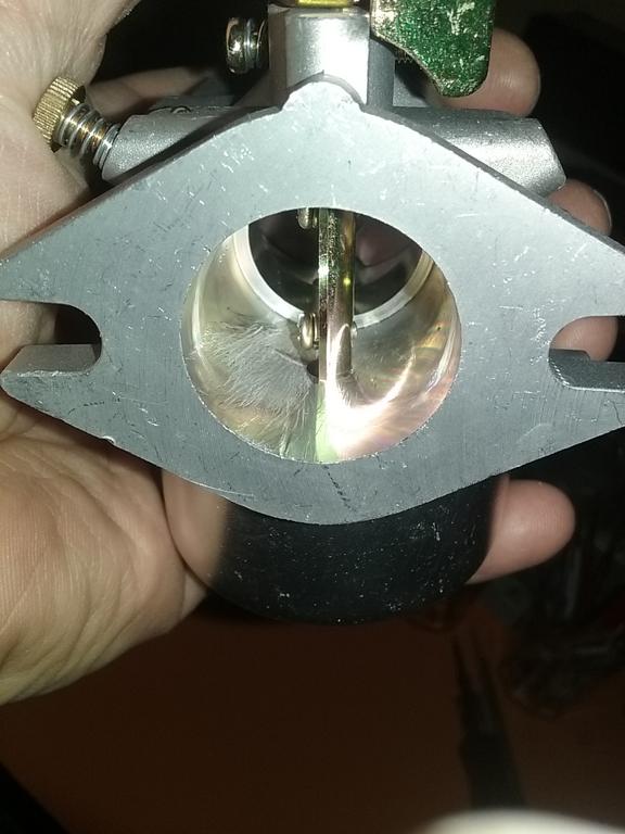

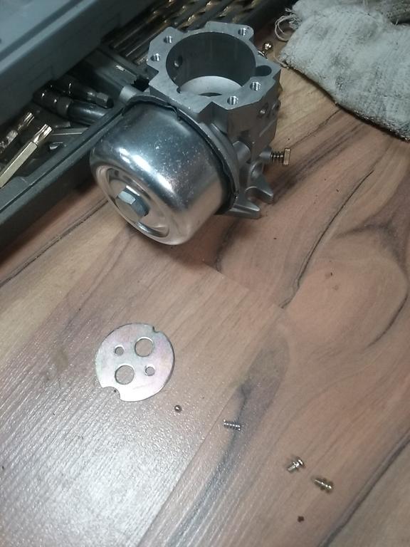

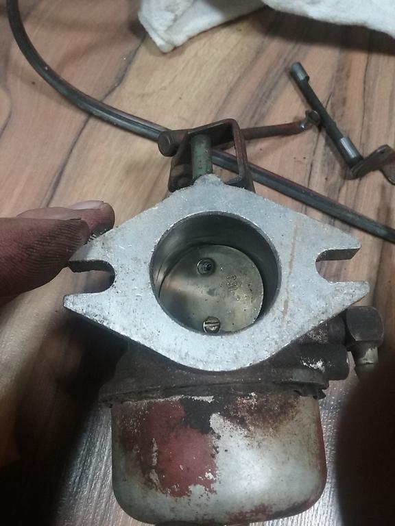

ebinmaine 77,684 #91 Posted February 7, 2018 (edited) Got the carb in the mail today. The main butterfly binds just a bit in the bore so I got out the hobby files and gave it a bit more freedom. You can see a small spot on the "floor" to the left of the shaft that was a rub point. I'm thinking I may remove the butterfly and fine sand the bore to smooth it out. Also, the screws on both butterflies are only held in with lock washers. No locktite. I'll be adding that before installation as well. Edited February 7, 2018 by ebinmaine 4 Share this post Link to post Share on other sites

ebinmaine 77,684 #93 Posted February 7, 2018 30 minutes ago, AMC RULES said: Did you look in the fuel bowl yet? Yep. Some filings in there from my fiddling but otherwise looks good. I'll throw a little carb clean through the passages. 4 Share this post Link to post Share on other sites
WVHillbilly520H 10,378 #94 Posted February 7, 2018 30 minutes ago, ebinmaine said: Yep. Some filings in there from my fiddling but otherwise looks good. I'll throw a little carb clean through the passages. Compressed air too if you have it ... 2 1 Share this post Link to post Share on other sites
Sarge 3,470 #95 Posted February 7, 2018 Make sure to look closely at the back side of those butterfly valve's screws - almost all carburetors the screws have been staked on the back side of the shaft to prevent them getting ingested into the engine if they work loose. If you have a Dremel - get a carbide burr for it and cut the excess part of the screw off before removing them or they can strip the shaft hole threads out. On some that I don't have the correct screws in stock since I worked on Weber carbs for years as well as been a mechanic you can re-stake them once you get the valve properly centered. I usually just put a good center punch in the vise, put the tips of the screws against it and give them a decent rap with a pin punch or opposite with the pin punch in the vise - either way works fine. Carburetors have fuel involved, eventually any sort of thread locker will come loose - it gets dissolved by the fuel in the thing, mostly when you shut off the ignition and stop the engine. If you don't stake those screws you risk ingestion into the engine - I've had to fix that too many times not to do it right, but that's me - up to you on yours. Don't be in a rush to sand/cut/file/grind that carb bore - the butterfly is simply not centered in the bore correctly from the factory - the Chinese one I put on the 16hp temporarily was way off being correct - it's probably a common thing with these and quality issues. Crack the screws loose but do not remove them first , then back off the idle stop screw completely so the butterfly can go fully shut. Poke around it a bit and maybe rotate it slightly to center it in the bore, then tighten/stake the screws correctly. All carburetor throttle valves of this type are oblong shaped - they are not round. The holes in those valves are also oval for a reason - it's to allow proper adjustment to the bore center once it's assembled, they just failed to assemble it properly. Given the price point - not a surprise as I'm sure they are knocking out hundreds an hour in that plant to make any profit. Also, just fyi - those throttle valves are also beveled slightly (sometimes as little as 5*) so they seal to the bore correctly since the valve itself is oval in shape - they only go in that bore one way correctly. Never alter that angle or do any sanding/filing in the bore - you'll lose the ability to control vacuum and engine idle as well as screw with it's ability to use the idle circuit correctly during throttle transition. There's a lot of geometry built into a carburetor - it's not just a hole in a tube with a valve in it so be aware of that . Just some things to know/learn - any questions, just ask . I've been doing this stuff almost 45yrs now - sometimes the cobwebs get knocked loose and the files stored in my skull break loose freely....lol. Not lecturing, just trying to educate - I'm here to pay the forum back for their help with issues I've ran into, such a great place. Sarge 6 Share this post Link to post Share on other sites

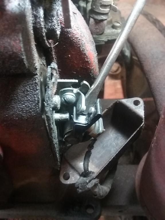

ebinmaine 77,684 #96 Posted February 10, 2018 I finally got around to cleaning the points and double-checking the Gap just under .020. Started with a file that was fundamentally garbage so I switched over to sandpaper. Cleaned off the cover and checked the bottom vent hole and put it back together. 7 Share this post Link to post Share on other sites

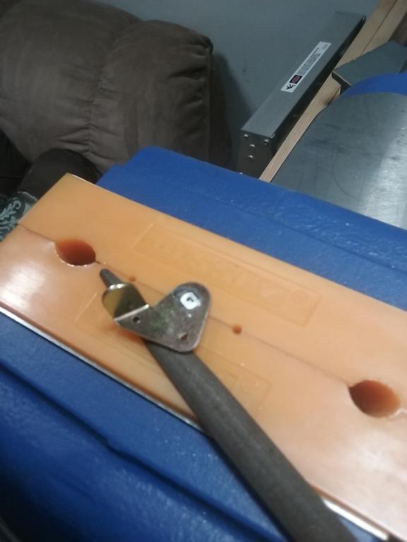

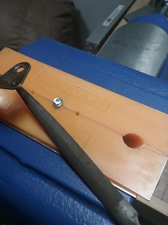

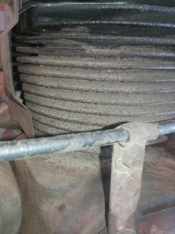

ebinmaine 77,684 #100 Posted February 11, 2018 Spent at least an hour cleaning the engine around the air fins and passages. Bolted the side cover, fan cover screen, coil back in place. Then I did some work on the new carb. Removed the choke butterfly and discovered I couldn't just flip it and put the screws back in. I ground the end off, filed the burrs off, turned over the mount for the choke cable, and jbwelded it back on. .. reversed. Sooooo..... here's the old carb throttle butterfly. Notice anything missing? ? I did check the engine bore while I had the head off and it's ok. ... Share this post Link to post Share on other sites
