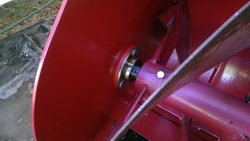

WVHillbilly520H
And here's what should sound/look like running...Jeff....BTW :text-welcomeconfetti: to :rs: and the cam-lock bearing

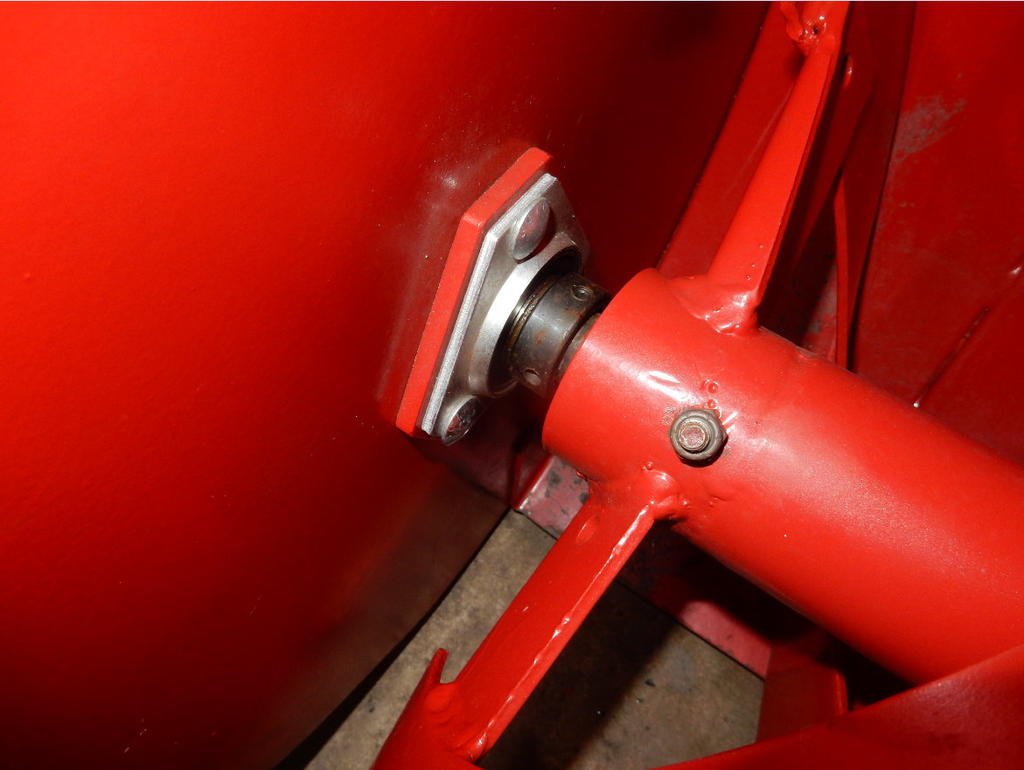

Kurt-NEPA
Or my version.  There are round and triangular versions.

WVHillbilly520H
Not sure, I'll have dig through my records I got mine through the "Big Bearing Store" online, and the 1/4" spacer has to be "custom" made, but you can get them (the bearing and flanges) at TSC just measure the auger diameter for the bearing I.D., Jeff.

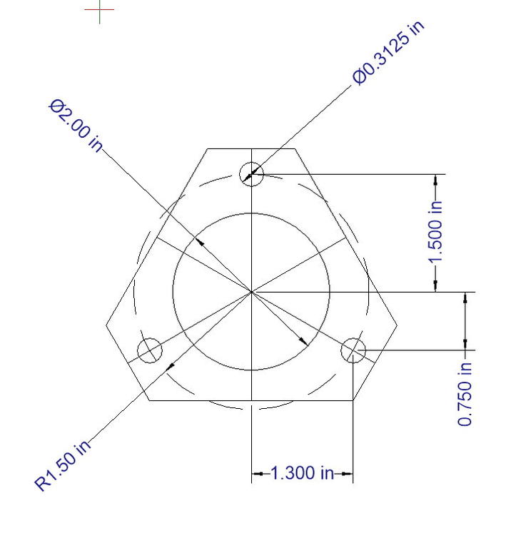

Kurt-NEPA
From my notes.
Auger Shaft is 1"
For my bearing modification I used Cam Lock Bearings no. SA205-16.  1" ID. Spherical OD  from US Bearing and Belt -  TSC has them as 1195167
Flanges are T52MSTRZP-1  TSC has them as 1198717.  I got them from Ebay as 52MSTR.  They are 52 mm ID flanges for 7/8 and 1" bearings.
The ones I ordered were Fafnir 52MSTR ZR
I had to fabricate a 1/4" spacer to move the auger shaft bearing inboard.  Without the spacer, the bearing came out past the end of the shaft.
Hope that helps.
I think Jeff used the same bearings, but with a round flange
Maybe this helps too,  This is the drawing for 1/4" spacer.  I think the round flange used the same bolt pattern.
