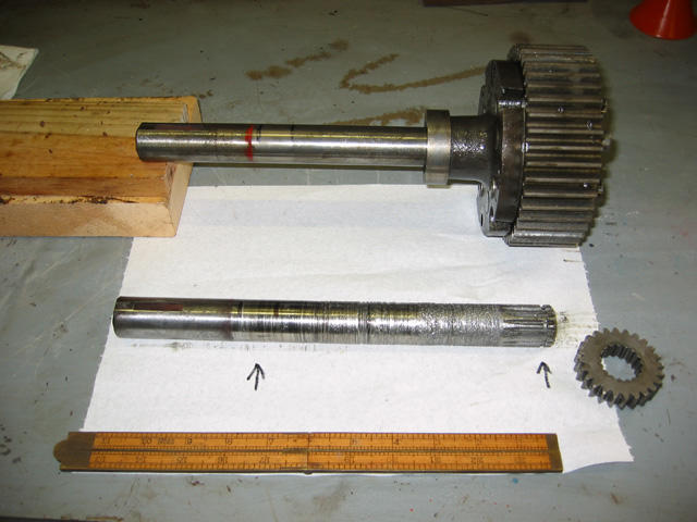

pfrederi 18,908 #10 Posted January 26, 2018 If the existing bearing is bad and you push it in it may fall apart and you will have something like this. (it took out the 1533 also) 1 1 2 Share this post Link to post Share on other sites
stevasaurus 23,448 #11 Posted January 26, 2018 Nothing good can happen from punching in an old, bad bearing, when it is so easy to fix it the right way. This is not a good idea. 2 2 Share this post Link to post Share on other sites
