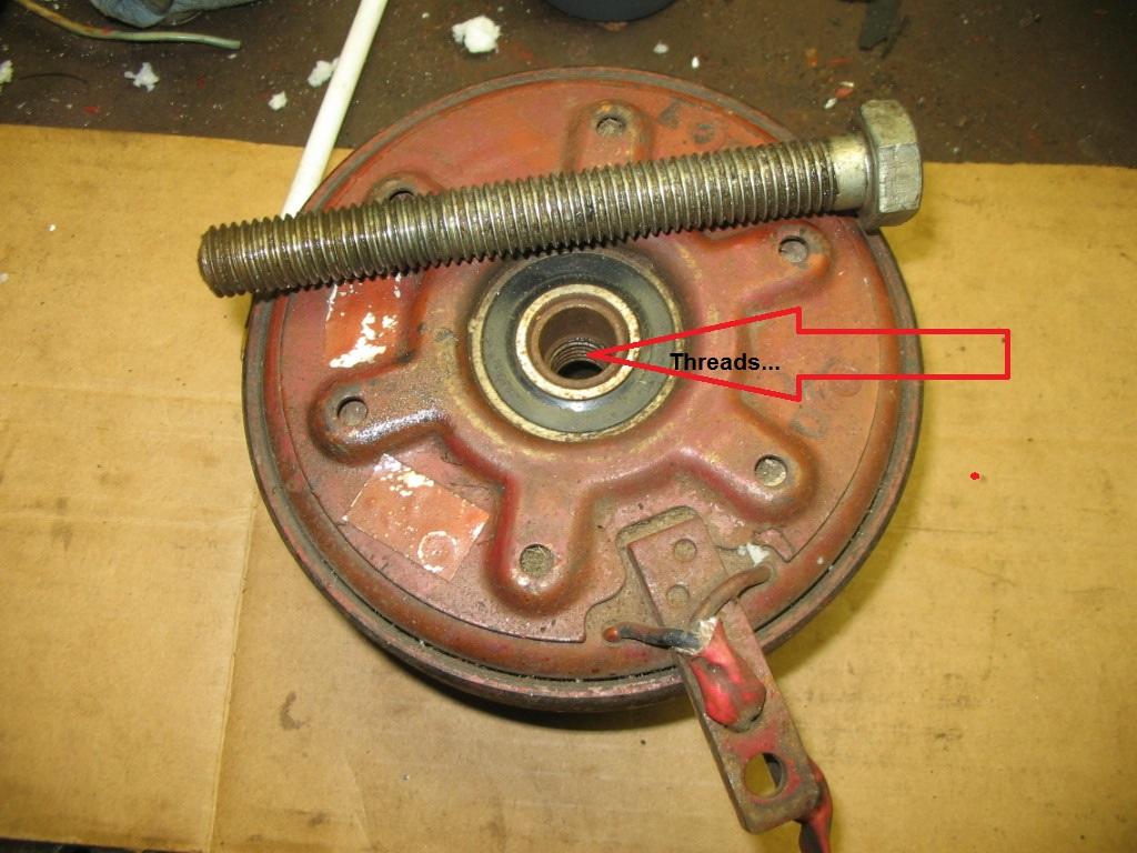

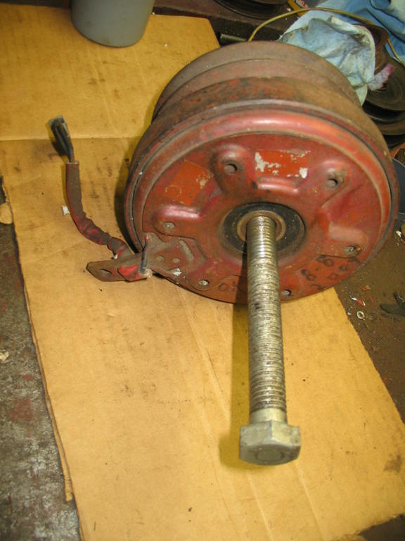

richmondred01 2,372 #1 Posted January 25, 2018 (edited) I’ve read some old post on how to safely remove the electric pto however, I still don’t really understand the concept of using longer bolt to remove the assembly. This is my first wheel horse electric pto. Can someone explain? thanks Edited January 25, 2018 by richmondred01 Share this post Link to post Share on other sites
Howie 900 #2 Posted January 25, 2018 It screws into the clutch and uses the end of the crankshaft to pull it off. Share this post Link to post Share on other sites
richmondred01 2,372 #3 Posted January 25, 2018 (edited) What size and thread of bolt.? I don’t recall any threads on the inside of the clutch field. the only treads I saw were the fine threads going into the crank shaft. Edited January 25, 2018 by richmondred01 Share this post Link to post Share on other sites
daveoman1966 3,883 #4 Posted January 25, 2018 There are threads inside the Elect PTO field. Here are two pics. The long bolt (6" or so) threads into these and presses against the end of the engind crankshaft, forcing the PTO to come of off the shaft. DO NOT USE A PULLER OF ANY SORT. There are threads inside the Elect PTO field. Here are two pics. The long bolt (6" or so) threads into these and presses against the end of the engind crankshaft, forcing the PTO to come of off the shaft. DO NOT USE A PULLER OF ANY SORT. 7 4 1 Share this post Link to post Share on other sites
richmondred01 2,372 #5 Posted January 25, 2018 Wow. Perfect. A picture says it all. Thanks again 1 Share this post Link to post Share on other sites
