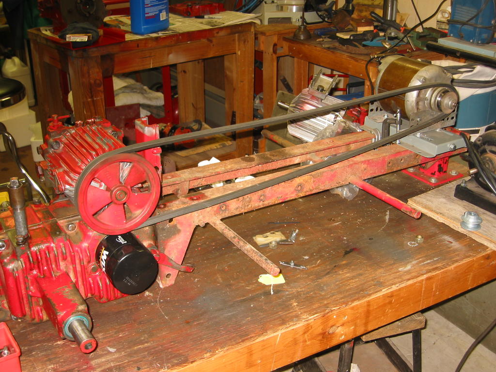

pfrederi 19,511 #18 Posted January 25, 2018 (edited) Set up a test system. So far so good no leaks. Really can't evaluate power I don't have a larger pulley for my electric motor. Probably tuning the pump at only 1000 rpm. This is really a spare unit to have if one of my workers has a problem. The slippers and piston block seemed to clean up nicely so hope she works in real life. see movie after picture Again appreciate all the help in getting the control arm off.. MVI_0160.AVI Edited January 25, 2018 by pfrederi 2 Share this post Link to post Share on other sites
Sarge 3,470 #19 Posted January 26, 2018 That's a great idea there, I've wanted to set up a test stand of sorts to test dead tractors and the Sundstrand pumps since most were neglected to an early death - just like to build a plate that can bolt to the trans, spring loaded tension arm and an electric motor...just at least enough to spin them up to rpm's and test for full function/pressure/noises. I've tried before to use a drill motor to spin those pumps, but none will give it enough rpm's and torque to fully test the pumps - it does take a fair amount of horsepower to even think of turning that Sundstrand unit. Thought I was going to fry my 36v Bosch industrial drill in high gear testing the D's pump system and priming before I put the engine back in place last time...not to mention it about broke both wrists when that thing finally primed itself. Sarge Share this post Link to post Share on other sites
Ed Kennell 44,134 #20 Posted January 26, 2018 22 hours ago, pfrederi said: Really can't evaluate power MVI_0160.AVI It wouldn't take much to make your test rig a true dyno Paul. I tested a Sundstrand once by ratchet strapping it to a 6x6 support and driving it with another tractor PTO. With the hubs in place, I locked one axle with an arm to the beam and measured the torque with a spring scale on a torque arm bolted to the other hub. Sorry I never got a pic of that rig. 2 Share this post Link to post Share on other sites
