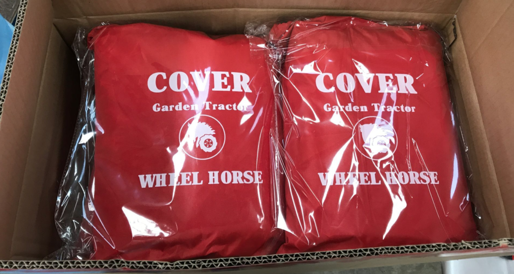

GlenPettit 1,718 #9 Posted January 18, 2018 (edited) Heat rises, take advantage of that. A cover or blanket will help trap and contain that heat, only takes a little heat, to raise the inside temperature to closer to 32º. Keeping the oil slightly warm, 32º, AND the battery slightly warm too helps starting a lot. We will be having some really nice Red custom Wheel Horse Covers with the name and logo printed on them in White in about 8-10 weeks. These UV and outdoor rainproof covers will have a dense silver lining inside (double layer) that will act as an insulator & a nice one-piece high-quality cover, -- elastic bottom, 100% coverage, vented ! Cost: about $50 (+ shipping). Will have them at the big PA show (save the $20 mailing cost), photo of the carrying bags below, . . . will post photos & details when they arrive. (to see size, click this > Scan copy 2.pdf ) Very proud of these Covers, quality and custom fit will be excellent, . . . fit is designed for C-series and 300 size tractors. Edited January 18, 2018 by GlenPettit 2 1 Share this post Link to post Share on other sites
classicdmax 190 #10 Posted January 18, 2018 What’s the cost of cover? Share this post Link to post Share on other sites
