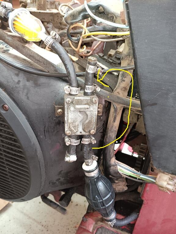

ebinmaine 81,047 #24452 Posted September 6, 2025 16 minutes ago, SylvanLakeWH said: Weird... Go with an electric pump and bypass it altogether? I could wire one in temporarily. I keep a Facet on the shelf. I don't wanna do much considering it's a parts tractor. 1 Share this post Link to post Share on other sites
Ed Kennell 47,750 #24453 Posted September 6, 2025 30 minutes ago, ebinmaine said: The way it sits right now I cannot use the primer to push fuel through. Then it is not connected correctly or one or both of the two check valves is frozen closed. If the two check valves are working properly, you should be able to blow air or pump fuel through any pump. 1 1 Share this post Link to post Share on other sites

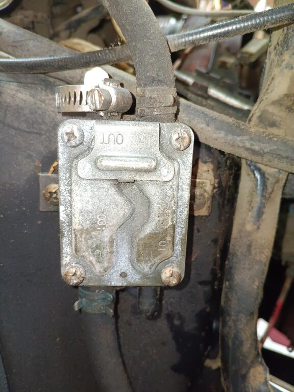

adsm08 5,231 #24454 Posted September 6, 2025 1 hour ago, ebinmaine said: Messing about with trying to start/ run/drive the 520H. Got the wiring connected. Turns over great. Fuel filter was cracked so I took th air cleaner off and changed the lines and filter from pump to carb. Here's how it WAS connected. Yes that's right side up. No it's not correct. I can't flip the pump because the holes are offset. Here's how it IS NOW. I want to believe that I have it connected right. But I don't. Or the fuel pump is not pumping enough. The way it sits right now I cannot use the primer to push fuel through. If I reverse the bottom two which makes it theoretically connected backwards, I can use the primer to fill the carburetor and it will run for a minute or two but then die when it's out of fuel because it's not sucking through the pump. Thoughts comments questions suggestions? I'll try again tomorrow... Eric, the first principle of any sort of wrenching is to assume any work you didn't do yourself was done wrong. The second is to assume any work you did do yourself was done wrong. I'm not familiar with that uinit butit has screws on the cover, that means it's removable. I don't know what the insides look like, but it's symmetrical. That means that cover can be installed backwards. Turning it 180 degrees would put the "in" marking where the hose from the tank was originally. 2 1 Share this post Link to post Share on other sites
ebinmaine 81,047 #24455 Posted September 6, 2025 5 minutes ago, adsm08 said: Eric, the first principle of any sort of wrenching is to assume any work you didn't do yourself was done wrong. The second is to assume any work you did do yourself was done wrong. I'm not familiar with that uinit butit has screws on the cover, that means it's removable. I don't know what the insides look like, but it's symmetrical. That means that cover can be installed backwards. Turning it 180 degrees would put the "in" marking where the hose from the tank was originally. I'd been thinking the same about all 3 above sentences. I may pop that top cover off tomorrow. 1 Share this post Link to post Share on other sites

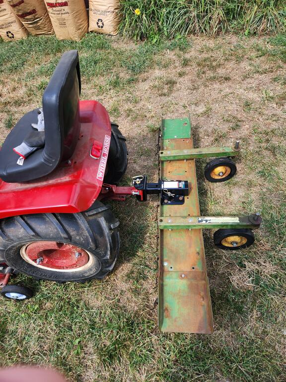

Goldnboy 1,155 #24457 Posted September 6, 2025 Today I removed the brackets from the front thatcher and bolted on a bump receiver hitch and inserted a sleeve hitch yoke. Should have thought of it sooner...it lifts easy and attaches quickly 6 Share this post Link to post Share on other sites

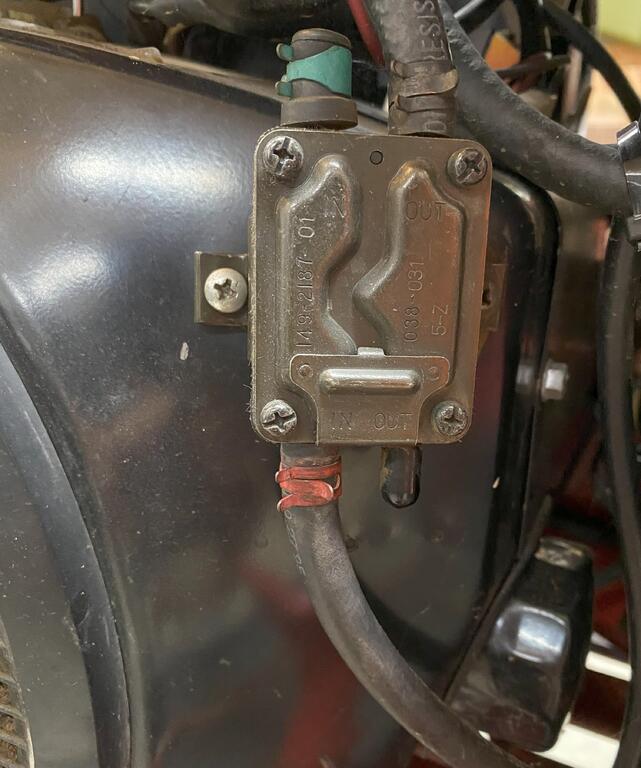

wallfish 20,724 #24458 Posted September 6, 2025 (edited) 31 minutes ago, ebinmaine said: I may pop that top cover off tomorrow. I believe you may need to swap these 2 lines. They are also marked IN and OUT Or, the one to the carb down next to the primer bulb On mine both in and out are in that position. The yellow line is from the tank the black to the carb, That horizontal bump on the cover is opposite postion and it also only has 3 ports Edited September 6, 2025 by wallfish 1 1 Share this post Link to post Share on other sites

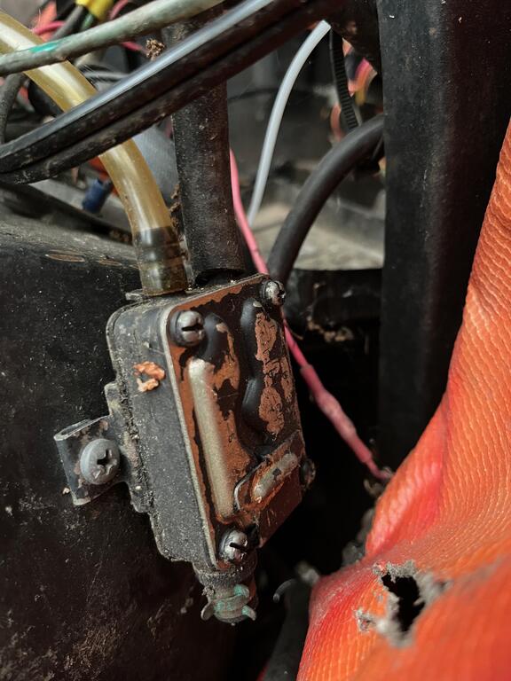

lynnmor 9,064 #24459 Posted September 6, 2025 2 hours ago, ebinmaine said: Yes that's right side up. No it's not correct. I can't flip the pump because the holes are offset. Here's how it IS NOW. Thoughts comments questions suggestions? I'll try again tomorrow... On the back side of the pump, under the cover, is the pulse hose, check that it is in good condition and connected. Mine has operated for the past 30 years just fine, here is today's photo: 1 1 1 Share this post Link to post Share on other sites
MainelyWheelhorse 3,170 #24460 Posted September 6, 2025 (edited) @ebinmaine I’d almost mount the pump as low as I could get it and try to gravity feed it into the filter which could be as low too. The pump may be struggling to push fuel out to the filter as is. Edited September 6, 2025 by MainelyWheelhorse 1 Share this post Link to post Share on other sites
953 nut 70,058 #24461 Posted September 6, 2025 3 hours ago, ebinmaine said: Thoughts comments questions suggestions? Doctor's orders. Put that Onan on an IV. Use a temporary tang gravity feeding the carburetor. 2 Share this post Link to post Share on other sites

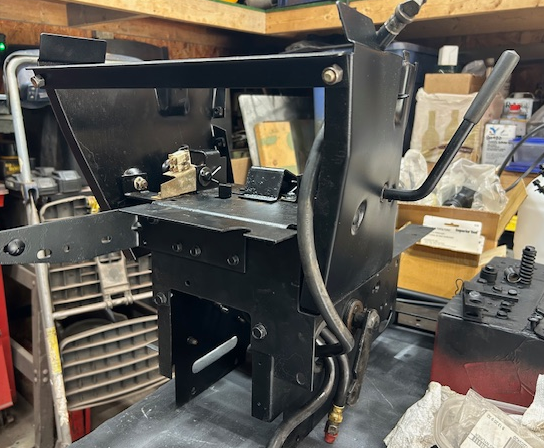

JoeM 10,317 #24470 Posted September 8, 2025 Started putting the tower together for the parts machine 512H. Really did not want to take it apart but it need rust removed and paint. Pro tip......leave all the bolts loose until all the pieces are in place then tighten. 8 2 Share this post Link to post Share on other sites
953 nut 70,058 #24471 Posted September 8, 2025 1 hour ago, JoeM said: Pro tip......leave all the bolts loose until all the pieces are in place then tighten. Good tip for assembling nearly anything. 4 Share this post Link to post Share on other sites

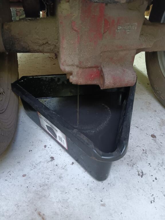

ebinmaine 81,047 #24472 Posted September 8, 2025 Found the drain plug under the parts 520H with a little help. Got the front end up and the transmission draining. 1 4 Share this post Link to post Share on other sites
Sparky-(Admin) 26,621 #24473 Posted September 8, 2025 28 minutes ago, ebinmaine said: Looks like it needs a serious pressure wash session 2 Share this post Link to post Share on other sites

ebinmaine 81,047 #24475 Posted September 8, 2025 5 minutes ago, Sparky said: Looks like it needs a serious pressure wash session This whole steed be a dusty pile. 2 Share this post Link to post Share on other sites
