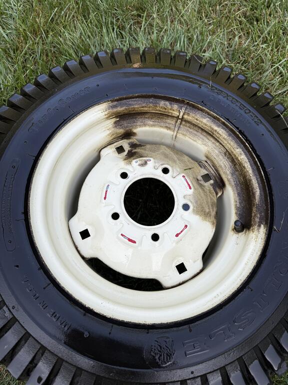

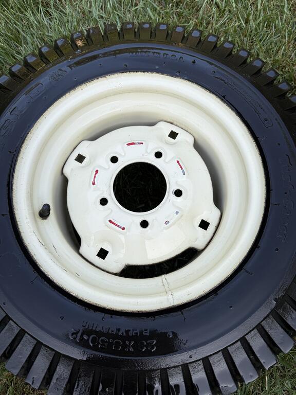

Sparky-(Admin) 26,621 #24302 Posted August 12, 2025 I thought the bearing grease covered front wheels on my C-85 were a bear to clean…I was WRONG! The grass stains on the rear wheels was so much harder to get off. Eventually using a toothbrush, Simple Green and Dawn dish soap I prevailed! 1 9 Share this post Link to post Share on other sites

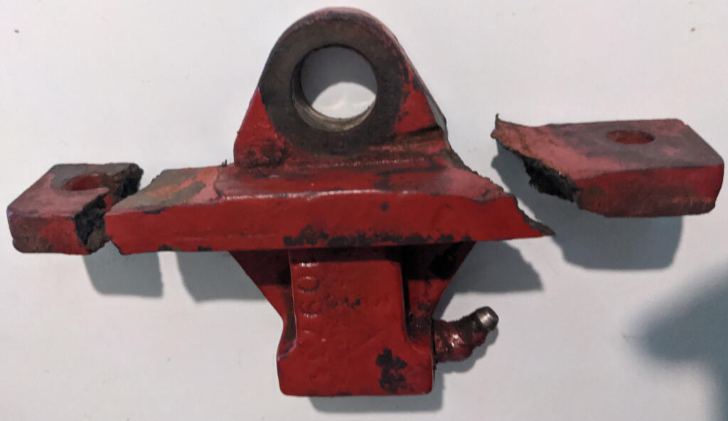

vogli 90 #24305 Posted August 13, 2025 My steering has been a bit iffy for a while...and just recently, I found I was unable to steer left. Today I finally took the time to look at it. 11 Share this post Link to post Share on other sites
Lane Ranger 12,159 #24306 Posted August 13, 2025 14 hours ago, vogli said: My steering has been a bit iffy for a while...and just recently, I found I was unable to steer left. Today I finally took the time to look at it. yes this happened quite often to those early steering fan gears! I have a spare 701 fan gear as i just want to have insurance! 1 Share this post Link to post Share on other sites
Ed Kennell 47,750 #24307 Posted August 13, 2025 I've repaired a few by vee crinding and welding the cast iron ends back on and then adding a thin steel plate across the top that is drilled and tapped to the center piece with two cap screws and bolted thru the plate, the end pieces, and the frame. 3 Share this post Link to post Share on other sites
ebinmaine 81,047 #24308 Posted August 13, 2025 12 minutes ago, Lane Ranger said: yes this happened quite often to those early steering fan gears! I have a spare 701 fan gear as i just want to have insurance! 3 minutes ago, Ed Kennell said: I've repaired a few by vee crinding and welding the cast iron ends back on and then adding a thin steel plate across the top that is drilled and tapped to the center piece with two cap screws and bolted thru the plate, the end pieces, and the frame. Are these different from a newer stronger style? Other than originality can other model pillow blocks be used? Share this post Link to post Share on other sites

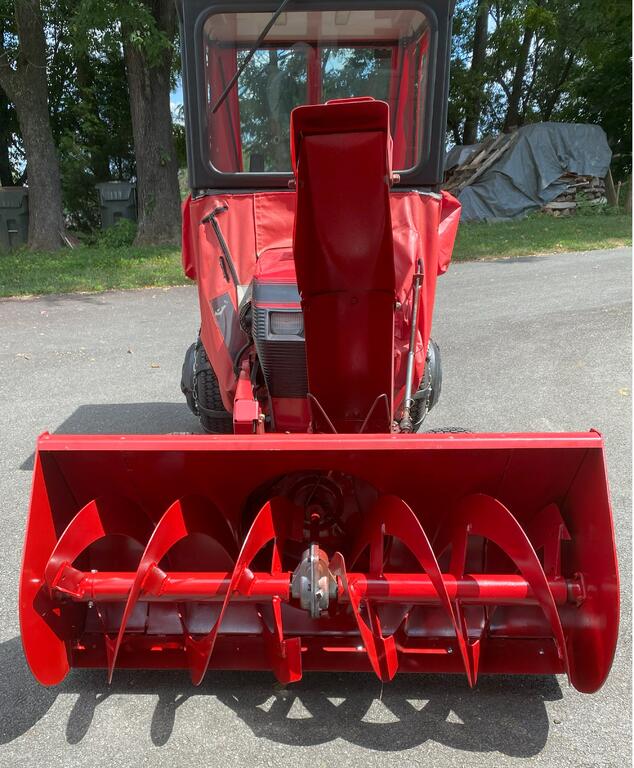

lynnmor 9,064 #24311 Posted August 13, 2025 It's barely getting into the 90's so I replaced the worn bearings and leaking seals in the two stage in case the snow is right around the corner. I had some Ace International red that was dark and didn't gloss at all. I went back to Ace and bought more that had the same part number but a bright red cap, it was real close to Toro red and worked well. 7 2 Share this post Link to post Share on other sites
Handy Don 17,634 #24312 Posted August 13, 2025 18 hours ago, Sparky said: grass stains on the rear wheels Who knew grass stains were such a great paint preservative?! 1 3 Share this post Link to post Share on other sites

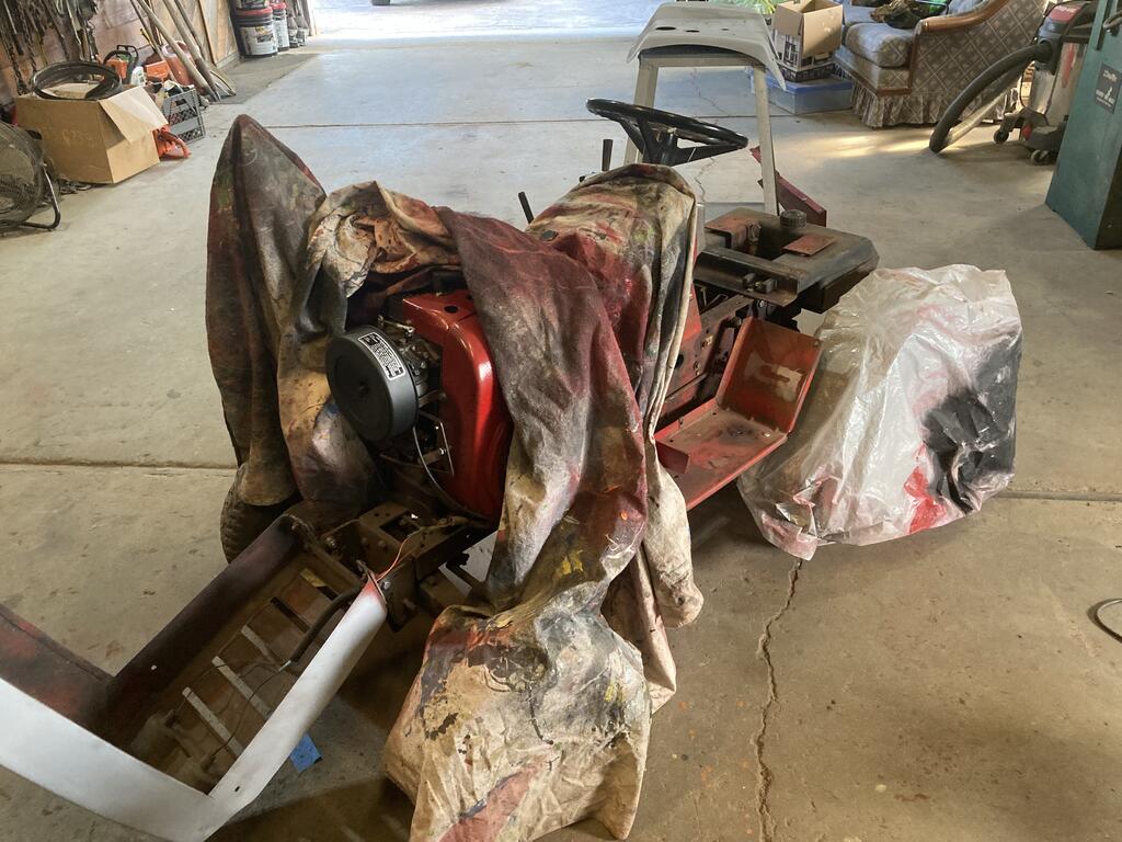

squonk 48,287 #24319 Posted August 13, 2025 On 8/10/2025 at 7:21 PM, ebinmaine said: Trina's 867 Pigpen and my Tecumsehorse are both in the new workshop space for engine swaps. The 867 will be a Kohler 8 HP direct swap. My tractor will be a fair amount more complicated. The OHV160 will be changed to a Briggs Vanguard 20 HP V twin engine. 1 6 Share this post Link to post Share on other sites

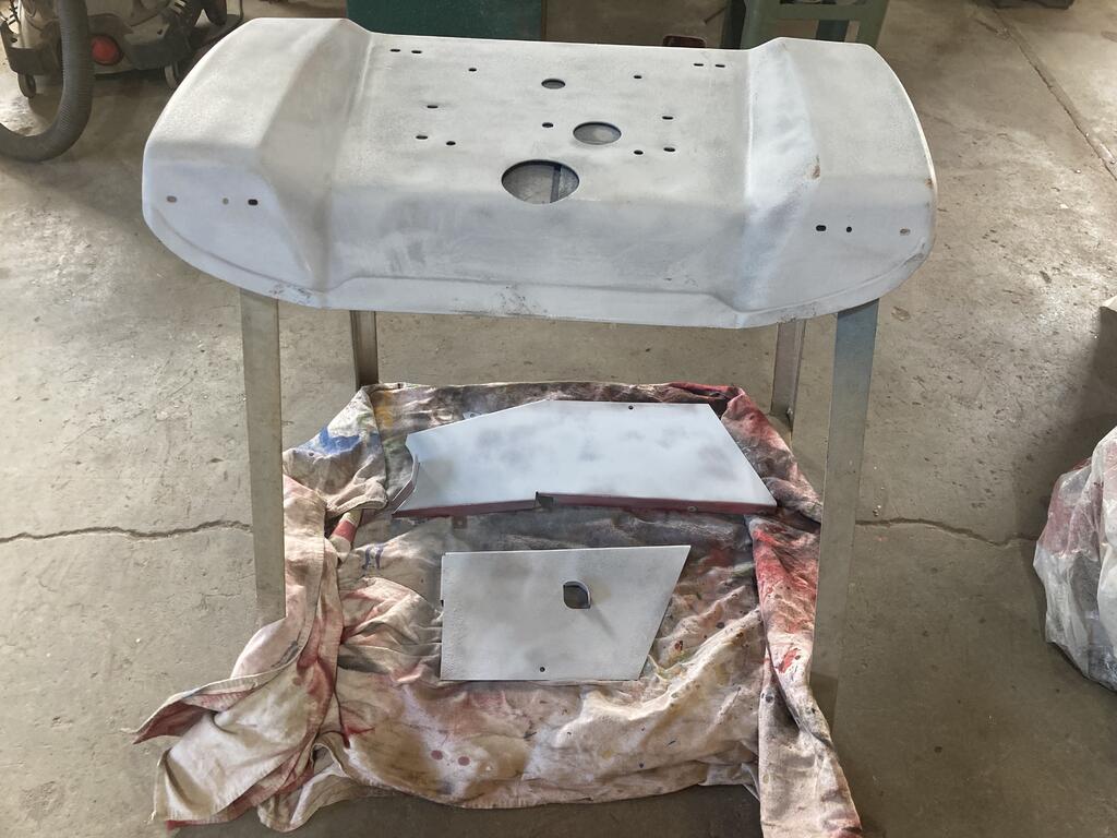

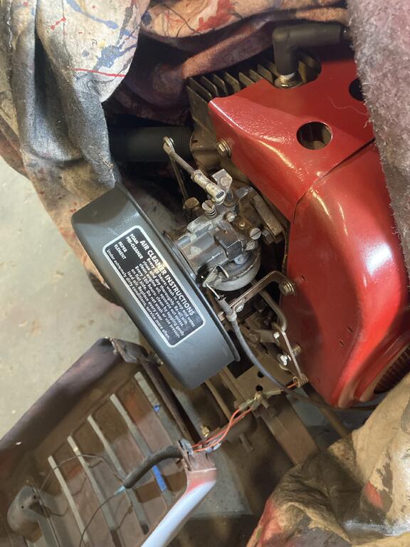

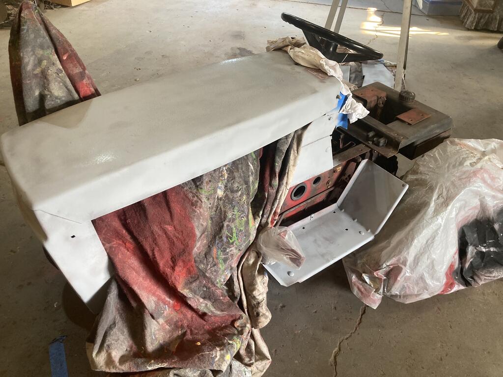

MainelyWheelhorse 3,170 #24325 Posted August 13, 2025 (edited) Today was paint prep, I primed and smoothed everything i could reach. I also finished up the Air Filter cover. I lucked out with a new Filter instructions sticker that was identical to the old one. It was in the new stickers I got for the M12. Next up, I have a half gallon of Rust Oleum IH Red for it to try out in my new paint gun. What is the setup you paint guys use for a Home Depot Husky gravity feed paint gun, with Rust Oleum IH red implement paint? Edited August 13, 2025 by MainelyWheelhorse 2 3 Share this post Link to post Share on other sites
