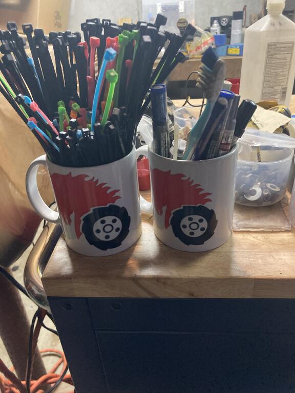

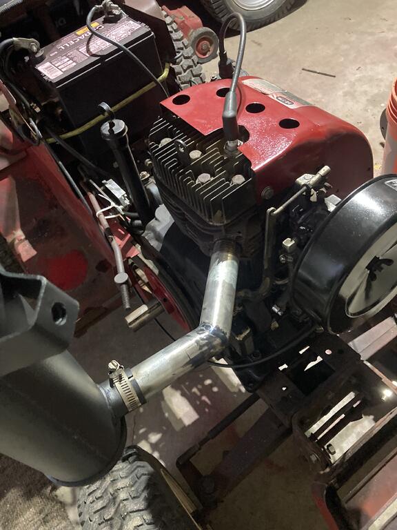

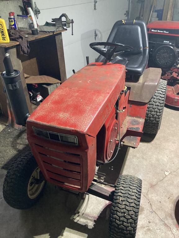

MainelyWheelhorse 3,170 #24205 Posted August 1, 2025 Today, I repurposed a few extra coffee cups for workshop stuff. I built an exhaust pipe with assistance from my father and mounted the new muffler to it for the C -141. And drove it over to my house. it’s been it’s been sitting at my parents next door for the last 2 months or so. Just little things and painting now. 7 1 Share this post Link to post Share on other sites

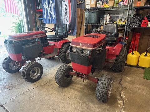

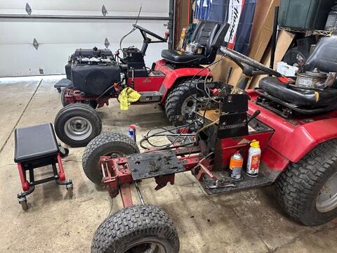

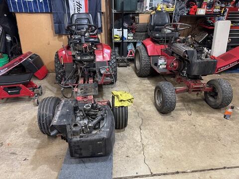

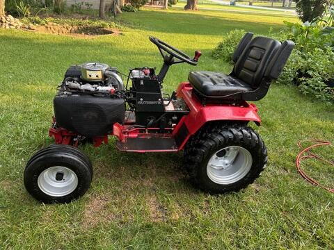

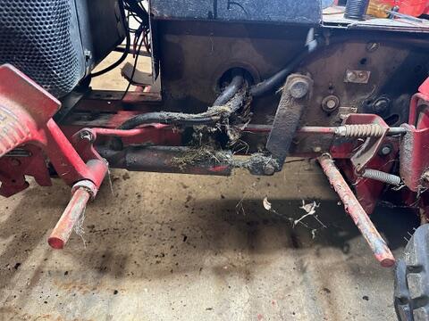

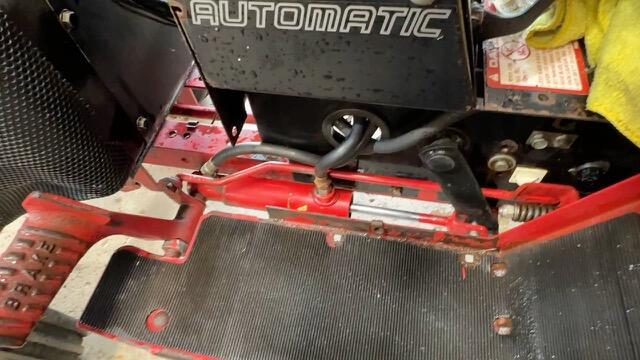

Andy N. 2,881 #24206 Posted August 2, 2025 Productive few days of doing an engine swap on my 418-A with one that I found locally that has a transmission issue. The original is worn out and starting to use alot of oil. It's all back together now and I mowed with it yesterday and the newer engine is working good so far. I also took the opportunity to replace the lift actuator with a unit that I rebuilt this past winter. 3 10 Share this post Link to post Share on other sites

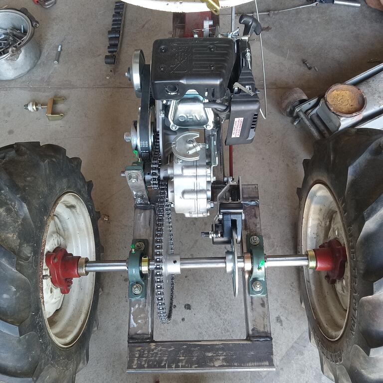

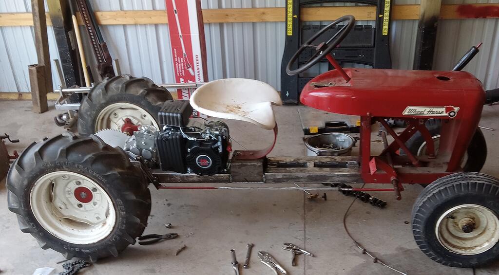

Shed 377 #24215 Posted August 5, 2025 Latest of my build the bed still not done 6 2 Share this post Link to post Share on other sites
Ed Kennell 47,750 #24216 Posted August 5, 2025 15 minutes ago, Shed said: Latest of my build the bed still not done Not sure if it will be a problem, but I would prefer to see that long brake rod in tension rather than compression. 2 1 Share this post Link to post Share on other sites

Pullstart 71,482 #24218 Posted August 5, 2025 @Shed that’s great! Any idea the load capacity of the axle? That’s 1”, correct? 1 Share this post Link to post Share on other sites
Shed 377 #24219 Posted August 5, 2025 46 minutes ago, Pullstart said: @Shed that’s great! Any idea the load capacity of the axle? That’s 1”, correct? I was told around 250 pounds Share this post Link to post Share on other sites
Shed 377 #24220 Posted August 5, 2025 1 hour ago, Ed Kennell said: Not sure if it will be a problem, but I would prefer to see that long brake rod in tension rather than compression. I would have to make another Z bar some how. I wanted it to pull but couldn't get it to work any ideas Share this post Link to post Share on other sites
8ntruck 9,368 #24221 Posted August 5, 2025 1 hour ago, Shed said: I would have to make another Z bar some how. I wanted it to pull but couldn't get it to work any ideas How about a cable instead of a rod? Share this post Link to post Share on other sites

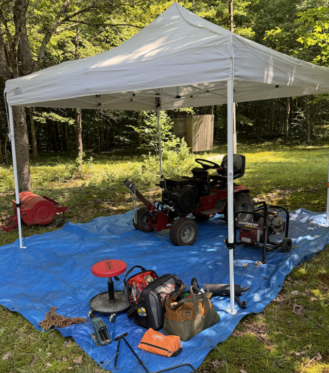

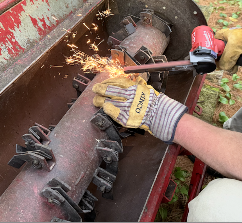

Handy Don 17,634 #24222 Posted August 5, 2025 (edited) Posting today because the work was last week at my son and daughter’s extremely remote and off-the-grid camp. “Clyde” (the camp tractor) needed some attention—reports from the field declared it was hard-starting, had grown loud, and was running poorly, requiring some choke always. I brought a replacement muffler, carb, and other parts it might need. Muffler had a number of rust-through holes. Replaced it and gained a 5 or 6db drop in sound level. Fuel was draining back from carb to tank after only a couple days. Added a primer bulb and starts are instantaneous. Rough running cause was revealed during the muffler swap—the Welch plug on the carb had fallen out. Amazingly, it was still there on top of the engine and I was able to clean out its port, wrangle it back into place and secure it. Going forward, I’ll be adding ⅜” Welch plugs to my spares kit as a guarantee that I’ll never need another one! Greased everything in sight and a lot of stuff that wasn’t. Topped up the oil in the engine and transaxle My “shop away from home.” A step up from relying on a shade tree. The tarp was a lifesaver when I inevitably dropped a nut, bolt, or washer. I took some heat about bringing a shop stool but by the end of the week all the assistants were converts. Sharpening one of the 80 knives on the flail mower. Had to replace six knives broken or lost due to overly enthusiastic attacks on saplings—I had some words for the operators on that 😉. Milwaukee’s ¾” x 18” M12 Bandfile is exactly the right tool for this job. I made a removable boom to fit into the 2” receiver of the front lift to help with moving around some heavy and awkward things. Until now, the lift was only used for the flail. Hoist.mov Edited August 5, 2025 by Handy Don 10 Share this post Link to post Share on other sites
chip61 666 #24223 Posted August 5, 2025 Tarp's a great idea, wish I had thought of that. Much better than searching the grass for a dropped nut or bolt. 2 Share this post Link to post Share on other sites
Ed Kennell 47,750 #24224 Posted August 5, 2025 5 hours ago, Shed said: any ideas You could use a rod that is less likely to bend. Maybe a length of 1/2" pipe and weld the 3/8" ends on. Share this post Link to post Share on other sites
kpinnc 19,036 #24225 Posted August 5, 2025 3 hours ago, Handy Don said: Sharpening one of the 80 knives on the flail mower. A flail mower, front or rear mount is one of the implements I hope to have one day. Definitely a useful tool! 1 Share this post Link to post Share on other sites
