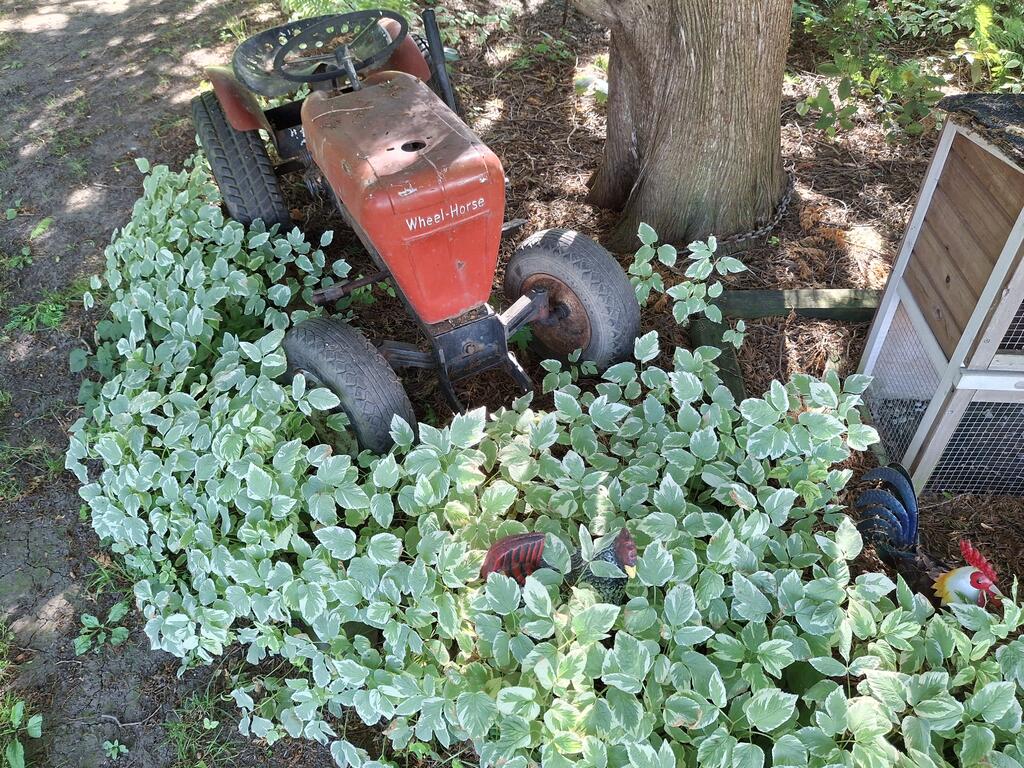

squonk 48,288 #24026 Posted June 30, 2025 Hosta's surround my yard art Suburban and fake chickens. See if you can spot Homer! 4 3 Share this post Link to post Share on other sites
ebinmaine 81,048 #24027 Posted June 30, 2025 3 hours ago, squonk said: Hosta's surround my yard art Suburban and fake chickens. See if you can spot Homer! Metal chickens don't seem to damage the greenery as much as regular types. 1 Share this post Link to post Share on other sites
sqrlgtr 4,155 #24028 Posted June 30, 2025 33 minutes ago, ebinmaine said: Metal chickens don't seem to damage the greenery as much as regular types. Don't eat near as many bugs either. 2 1 Share this post Link to post Share on other sites

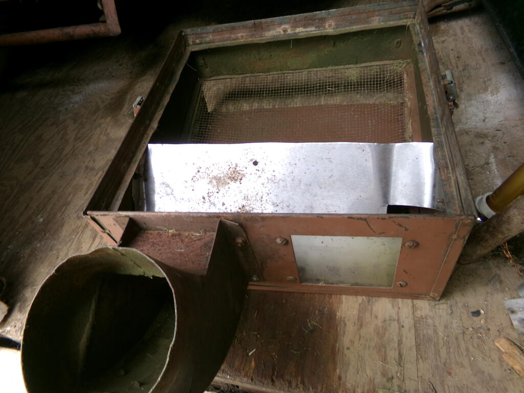

Ed Kennell 47,750 #24029 Posted June 30, 2025 I found the screen in the Trac Vac clogged pretty quickly. I added a full width baffle to direct the grass down away from the screen. Test to follow at next mowing. 5 2 Share this post Link to post Share on other sites

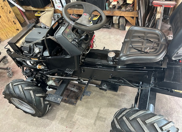

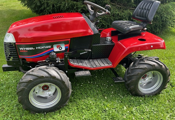

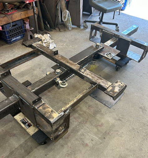

Damien Walker 297 #24030 Posted June 30, 2025 10 hours ago, JoeM said: Yes 4x4 522xi on a CadTrac style sub frame, loader ready. Two pumps one for traction the other is for the steering and loader. Last winters / spring project. No build thread, some details mixed into this thread. I reckon we need a video of this in action (please!). It looks amazing and I imagine the traction is too. 3 Share this post Link to post Share on other sites
