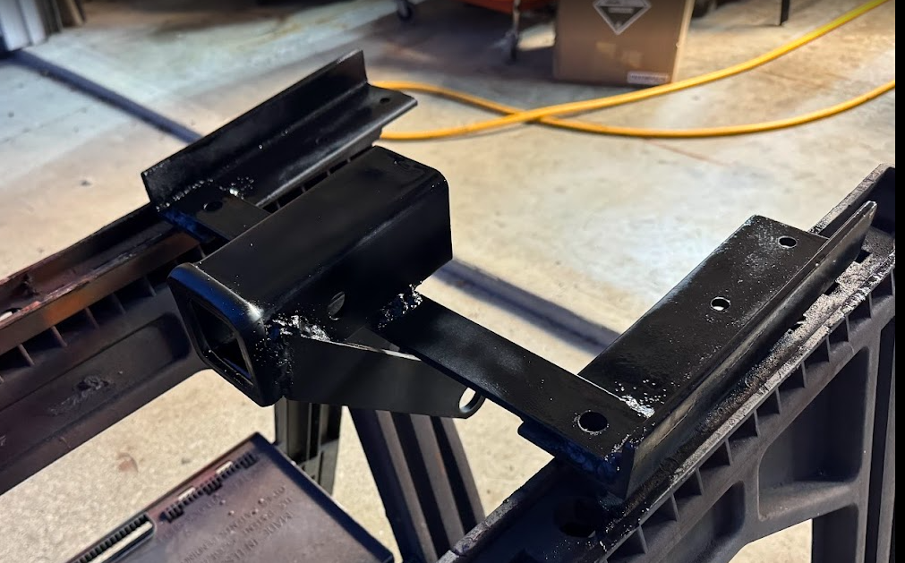

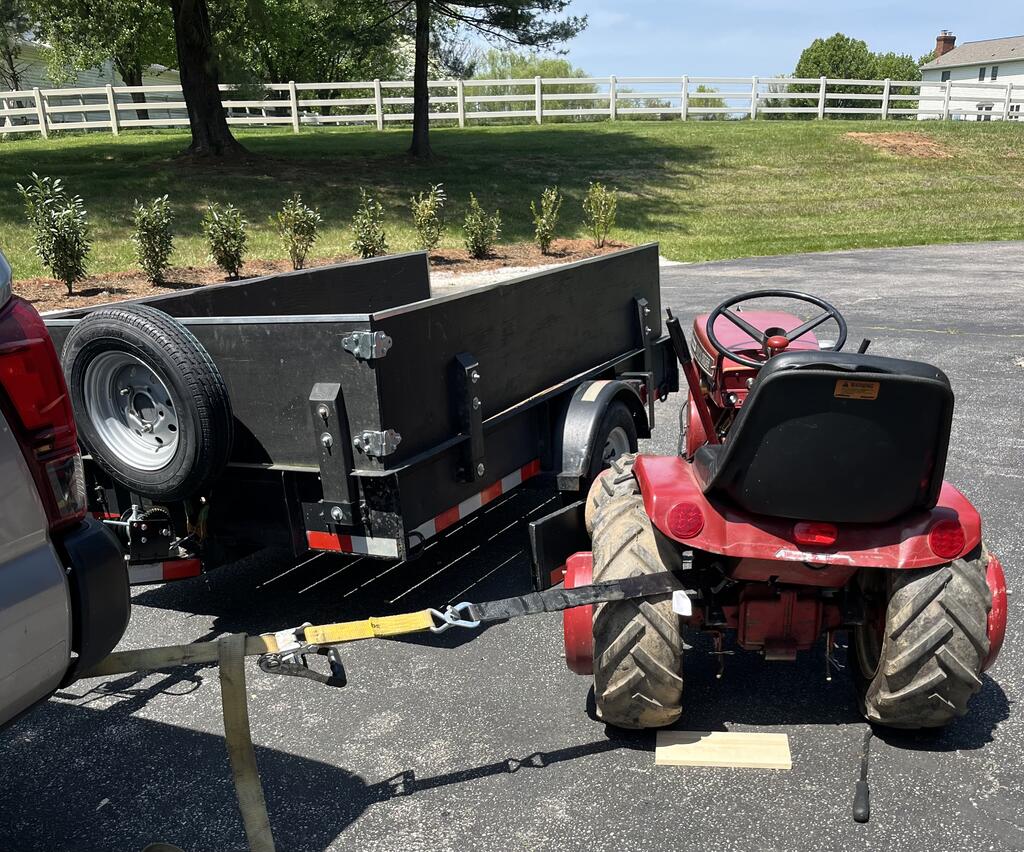

Bar Nuthin 3,043 #23401 Posted April 27, 2025 (edited) On 4/25/2025 at 9:17 PM, Bar Nuthin said: Last fall I did a quick fab up of a hitch for my Cyclone Rake that worked out great. Tonight, I decided to add a 2" receiver and supports. Welds aren't pretty but it passed jumping up and down on the hitch without flexing. Edited April 27, 2025 by Bar Nuthin 3 3 Share this post Link to post Share on other sites

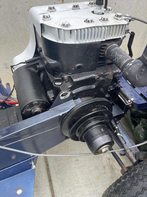

HyperPete 939 #23402 Posted April 27, 2025 3 hours ago, 953 nut said: I would be better to mount the electric fuel pump on the frame making it lower than the fuel tank outlet. Electric pumps are good at pushing fuel but they suck at sucking. 2 hours ago, ranger said: I was going to suggest the same. Also, if you have concerns regarding the reliability of the low cost pumps, it’s probably not a good idea to mount it to the engine, which has the potential to “Shake” it to bits!!! It should be simply to relocate it. I can just swap the location of the pump & the fuel filter. 3 Share this post Link to post Share on other sites

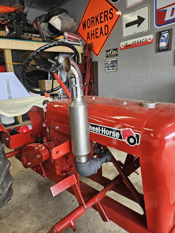

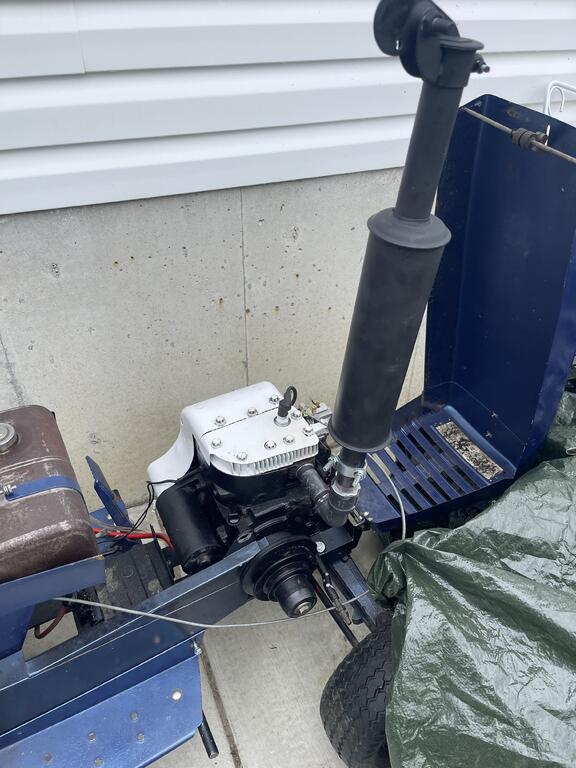

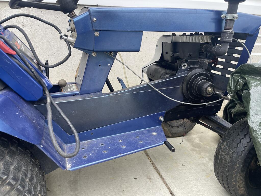

stvski80085 279 #23404 Posted April 28, 2025 Got the tacky back up and running. Cleaned it all up and head gasket. Runs great now. 6 1 Share this post Link to post Share on other sites
ebinmaine 80,325 #23405 Posted April 28, 2025 1 hour ago, stvski80085 said: I like those Stacks quite a lot but it's a fair decent amount of weight to be hanging off the side of the engine. Have you seen where folks recommend getting a brace or support off the bottom of those? 1 1 Share this post Link to post Share on other sites
stvski80085 279 #23406 Posted April 28, 2025 1 minute ago, ebinmaine said: I like those Stacks quite a lot but it's a fair decent amount of weight to be hanging off the side of the engine. Have you seen where folks recommend getting a brace or support off the bottom of those? I just put it on to test the motor. I know it will need a brace if I keep it that way! Thanks for the reminder though. Steve 2 1 Share this post Link to post Share on other sites
ebinmaine 80,325 #23407 Posted April 28, 2025 5 minutes ago, stvski80085 said: I just put it on to test the motor. I know it will need a brace if I keep it that way! Thanks for the reminder though. Steve Looks great from here. I have a nice tall stack on my 1975 C160-8 Cinnamon Horse. I like it all except for the fact that, this is now my semi-permanently mounted Mackissic chipper Horse and the spout points sideways so you have to be conscious which way you approach from. Share this post Link to post Share on other sites
stvski80085 279 #23408 Posted April 28, 2025 45 minutes ago, ebinmaine said: Looks great from here. I have a nice tall stack on my 1975 C160-8 Cinnamon Horse. I like it all except for the fact that, this is now my semi-permanently mounted Mackissic chipper Horse and the spout points sideways so you have to be conscious which way you approach from. I'm going to end up selling this one and not for much. I really want an rj or a small Wheel horse tractor at some point. I just want this one to be running and working when I send it down the road. I don't have a barn or anything so I can't keep everything I want. The 77 b-80 is my main worker and then a small little one for messing around. I am going to get a shed soon so I can put these in it. My neighbor is letting me use half her garage in exchange for cutting her grass and helping her out. 3 Share this post Link to post Share on other sites

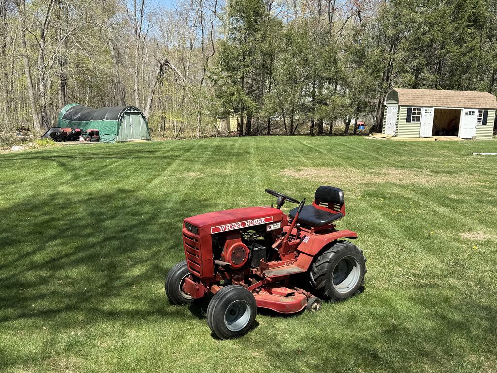

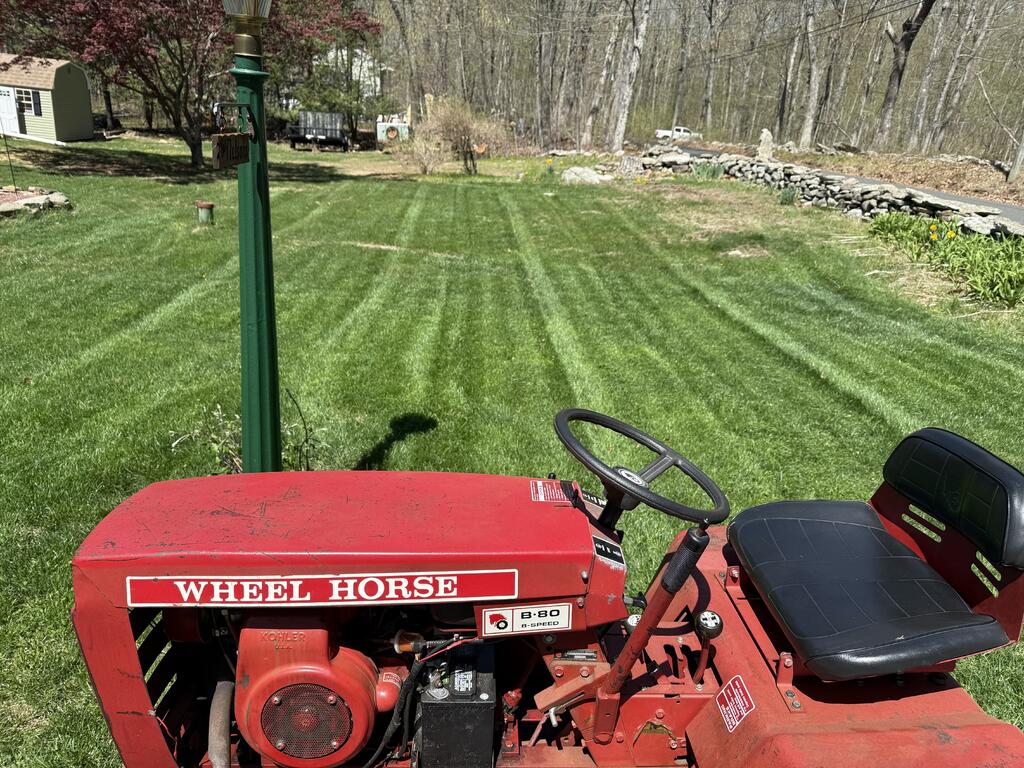

Sparky-(Admin) 26,218 #23409 Posted April 28, 2025 First full yard mow of the season..’77 B-80/8 speed with a 36” RD 9 4 Share this post Link to post Share on other sites
stvski80085 279 #23410 Posted April 28, 2025 39 minutes ago, Sparky said: First full yard mow of the season..’77 B-80/8 speed with a 36” RD You have the tires I'm looking to put on mine soon. Very nice. I'm gonna repaint mine over the winter but wanted to use it this summer and make sure everything was good to go. What size tire do you have on the back? brand? 1 1 Share this post Link to post Share on other sites
Sparky-(Admin) 26,218 #23411 Posted April 28, 2025 1 hour ago, stvski80085 said: You have the tires I'm looking to put on mine soon. Very nice. I'm gonna repaint mine over the winter but wanted to use it this summer and make sure everything was good to go. What size tire do you have on the back? brand? Carlisle is the brand, but I think they have changed their name to Carlstar, or something like that. The ones in the pics are 23 x 8.50’s. 2 Share this post Link to post Share on other sites
stvski80085 279 #23412 Posted April 28, 2025 5 minutes ago, Sparky said: Carlisle is the brand, but I think they have changed their name to Carlstar, or something like that. The ones in the pics are 23 x 8.50’s. Now I know that size won't hit the deck. I was asking about that in another thread. Thanks. 1 1 Share this post Link to post Share on other sites

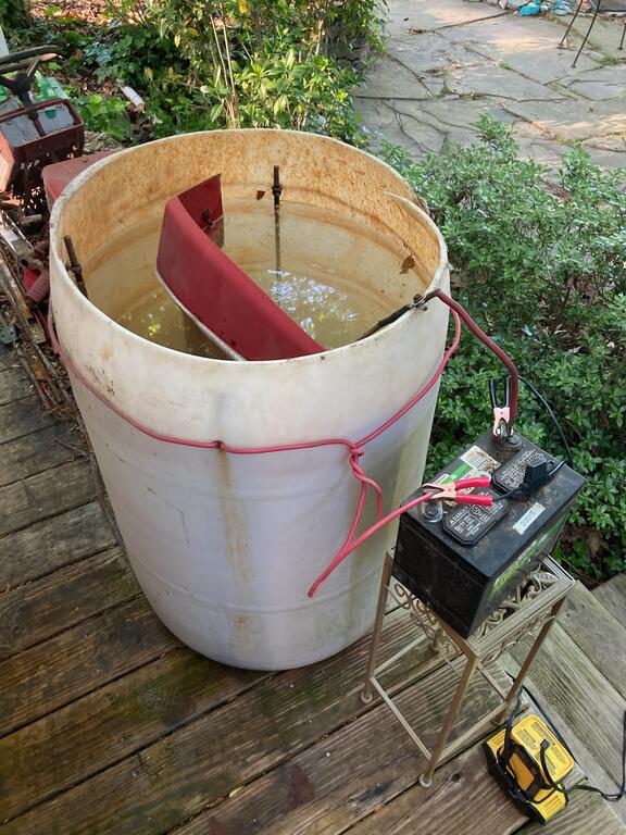

ineedanother 2,809 #23413 Posted April 28, 2025 Fired up the e-tank again. I'm gonna fit a 312 fender pan on an 16hp Electro 12 Frankentiller . I can almost submerge the whole thing but not quite. That will add a day or three to the process. 3 8 Share this post Link to post Share on other sites
ineedanother 2,809 #23414 Posted April 28, 2025 Cookin' nice and slow like a pork butt in a smoker. (that's a NC thang) 2 5 Share this post Link to post Share on other sites

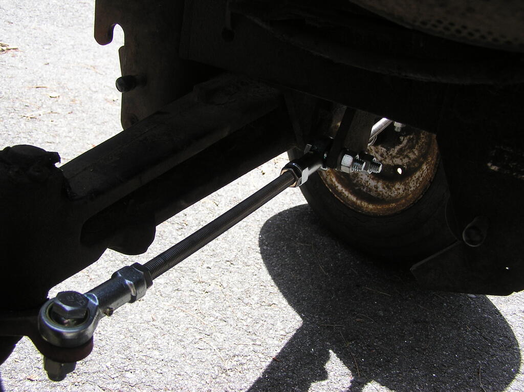

Wayne0 1,624 #23417 Posted April 29, 2025 (edited) Put new stainless tie rods on Ol' Rusty this morning. I hate to paint them, but they're so "out of character"! Edited April 29, 2025 by Wayne0 4 1 Share this post Link to post Share on other sites
kpinnc 18,886 #23418 Posted April 29, 2025 (edited) 13 minutes ago, Wayne0 said: Put new stainless tie rods on Ol' Rusty this morning. I hate to paint them, but they're so "out of character"! Just think of them as "grille decor"... Edited April 29, 2025 by kpinnc 7 Share this post Link to post Share on other sites

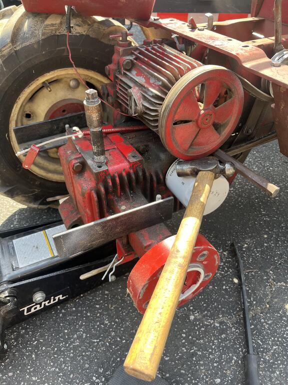

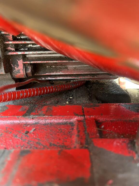

BrianKoch 370 #23420 Posted April 29, 2025 (edited) Gentlemen, Today I’ve been wrangling with replacing the lift cable on the ‘68 Charger 12. Can’t seem to pull it over that casting hump. Anyone experienced this before? Trying not to pull the pump. Attempt 1: Fail Attempt 2: Success Applied the old, “where there’s a wheel, there’s a way”, proverb and removed the wheel so I could punch the cable over the hump. Edited April 30, 2025 by BrianKoch 2 Share this post Link to post Share on other sites
rjg854 13,312 #23421 Posted April 29, 2025 5 hours ago, Wayne0 said: Put new stainless tie rods on Ol' Rusty this morning. I hate to paint them, but they're so "out of character"! Are you thinking of painting them like the rest of the tractor? 3 Share this post Link to post Share on other sites
