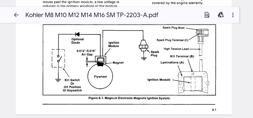

HyperPete 939 #23226 Posted March 30, 2025 5 minutes ago, squonk said: Take the points cover off and try drying the points. I've had the points get wet even with a good gasket and grommet. A few shots with a blow gun and it fires right up. Thank you. Where's the points cover on these guys? I was figuring I was going to have to pull the flywheel to access them. I think I have downloaded every manual for the M8 - I guess they aren't going to read themselves. 1 Share this post Link to post Share on other sites
HyperPete 939 #23227 Posted March 30, 2025 (edited) Yay! No points! I think I'll be going through this. Edited March 30, 2025 by Pete D 1 Share this post Link to post Share on other sites
MainelyWheelhorse 3,145 #23228 Posted March 30, 2025 4 minutes ago, Pete D said: Yay! No points! I think I'll be going through this. @Pete D You beat me to it! I was just going to say I didn't think the Magnums had points. 2 Share this post Link to post Share on other sites

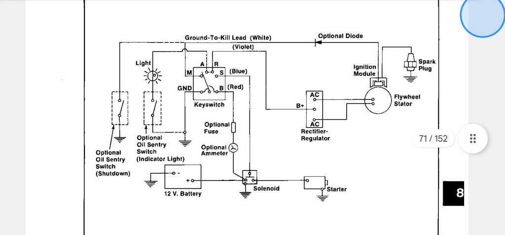

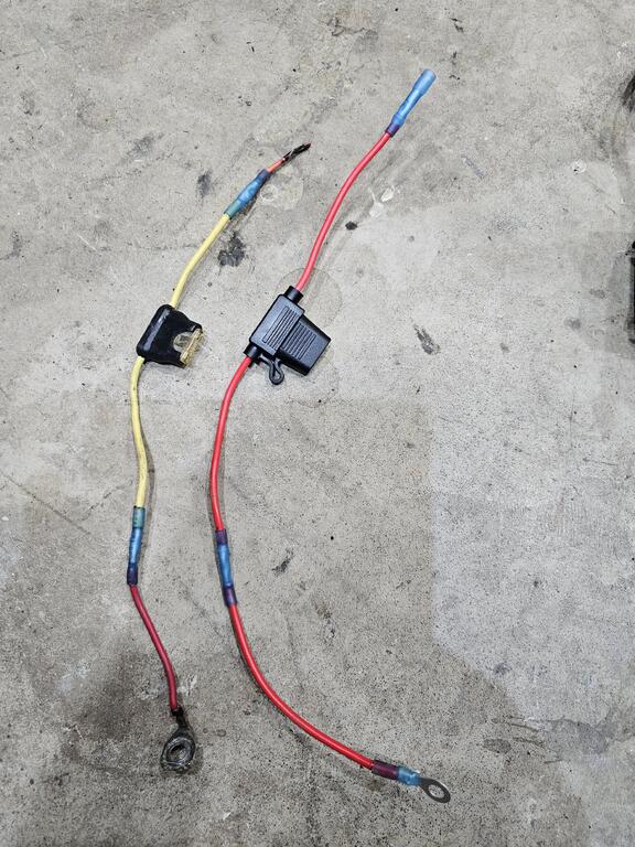

HyperPete 939 #23229 Posted March 31, 2025 Since I touched wiring, too, I'm going to completely replace the wire I re-spliced. I'm uncertain why a non-waterproof 30 amp fuse was installed in the solenoid control feed, but it's coming back out. (Just an additional point of failure to worry about.) I'm going through possibly problems, and I'm concerned about a possible high-draw starter. All grounds & connections have been cleaned to bare metal & protected with dielectric grease. I did not pull the starter bolts and clean the starter mounting surfaces, however. I guess I could remove the starter back cover to blow it out & check the brushes just to be safe. 1 Share this post Link to post Share on other sites

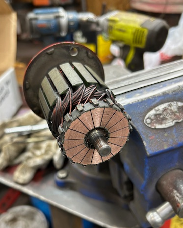

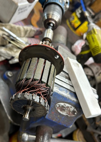

JoeM 10,317 #23231 Posted April 1, 2025 Cleaned up the C81 sluggish starter and got it working good. I did have to put a .010 shim under the front bolt. Brushes were good. Used a drill to turn the armature and cleaned the commutator with a stone. 5 3 1 Share this post Link to post Share on other sites
Handy Don 17,554 #23232 Posted April 1, 2025 (edited) 36 minutes ago, JoeM said: Used a drill to turn the armature and cleaned the commutator with a stone. Looks nice. Hoping you made sure to cut a bit of relief into the phenolic separating the commutator contacts and used compressed air to thoroughly remove any grinding/cleaning residue. Edited April 1, 2025 by Handy Don 3 Share this post Link to post Share on other sites
JoeM 10,317 #23233 Posted April 1, 2025 1 hour ago, Handy Don said: relief into the phenolic separating the commutator contacts and used compressed air Yep all good! 2 1 Share this post Link to post Share on other sites

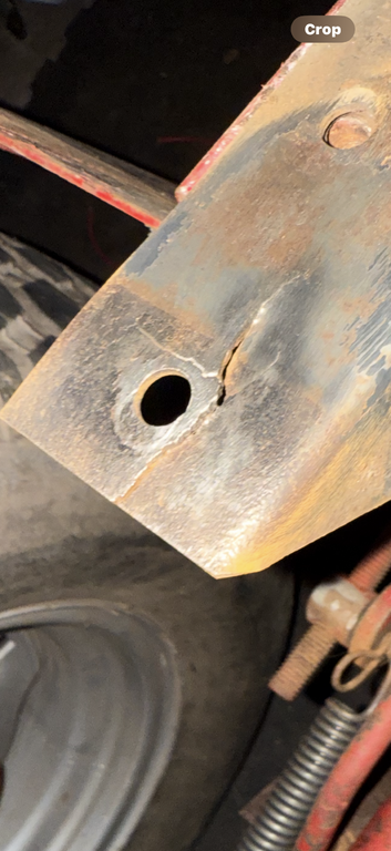

Sparky-(Admin) 26,489 #23234 Posted April 1, 2025 A buddy welded up the fuel tank/fender support rails in the 520-8. Both sides cracked. 4 7 Share this post Link to post Share on other sites

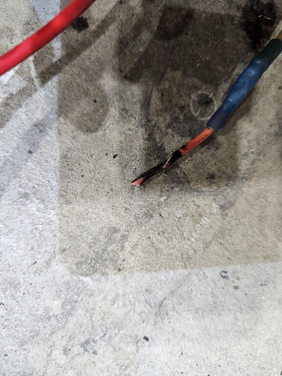

HyperPete 939 #23235 Posted April 1, 2025 (edited) I replaced the starter solenoid. The wiring diagram shows an optional fuse that was in line with the solenoid, so I installed a waterproof fuse and replaced the previous wiring. When I looked, there was some sloppy electrical tape which I unwrapped and found the wire had been burnt and most of these strands were broken. I cut back beyond the damage and ran the new wire. Everything should be waterproof now, and the engine cranks. I have spark now, but it doesn't start. I used clear nail polish around the Welch plugs, and I'm afraid it may have gotten past them and blocked the air passages. Major DUH moment. I'm quite angry with myself. I have a ton of incredibly small drills so I will clean them out and try again. Hopefully, my local small engine shop sells Welch plugs. The other possibility is the fuel pump. I don't smell gas when I crank, even with the choke on, so after I'm sure that the carb is attached tightly and getting vacuum, I may reach out for assistance with these old fuel pumps. I know nothing about them. Edited April 1, 2025 by HyperPete 2 Share this post Link to post Share on other sites

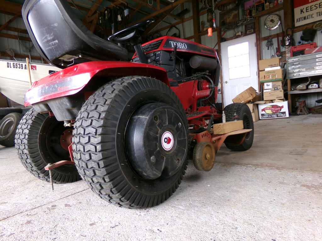

Ed Kennell 47,569 #23238 Posted April 2, 2025 Put the rear weights back on the 310-8. These new wider wheels required longer bolts, so I fired up the mig bolt extender and added an inch. I know, the carriage bolt head is supposed to be inside the wheel. But I don't like the nuts sticking out on the outside. 6 9 Share this post Link to post Share on other sites
SylvanLakeWH 32,692 #23239 Posted April 3, 2025 3 hours ago, Ed Kennell said: But I don't like the nuts sticking out on the outside. And it maximizes aerodynamic efficiency when traveling at high speeds... better fuel economy... very green... 1 1 7 Share this post Link to post Share on other sites

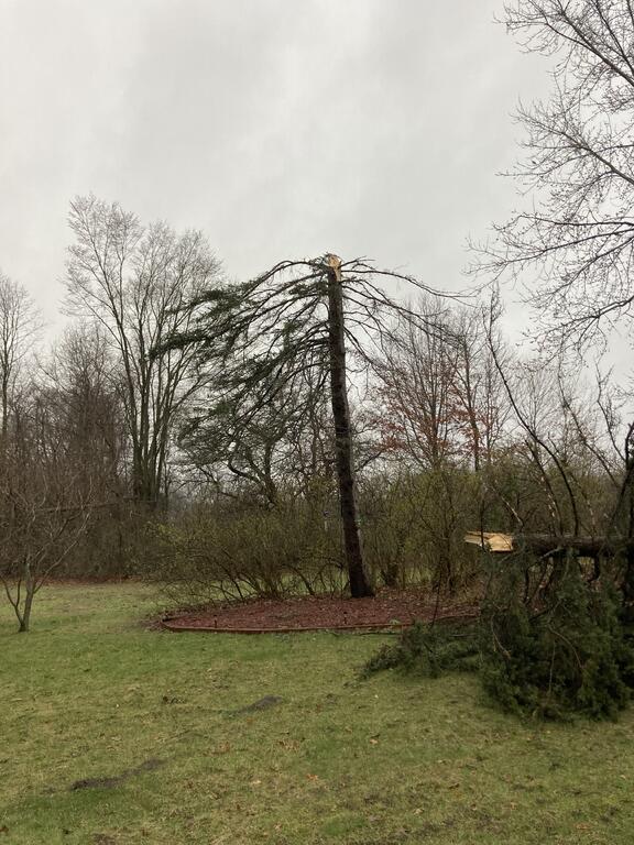

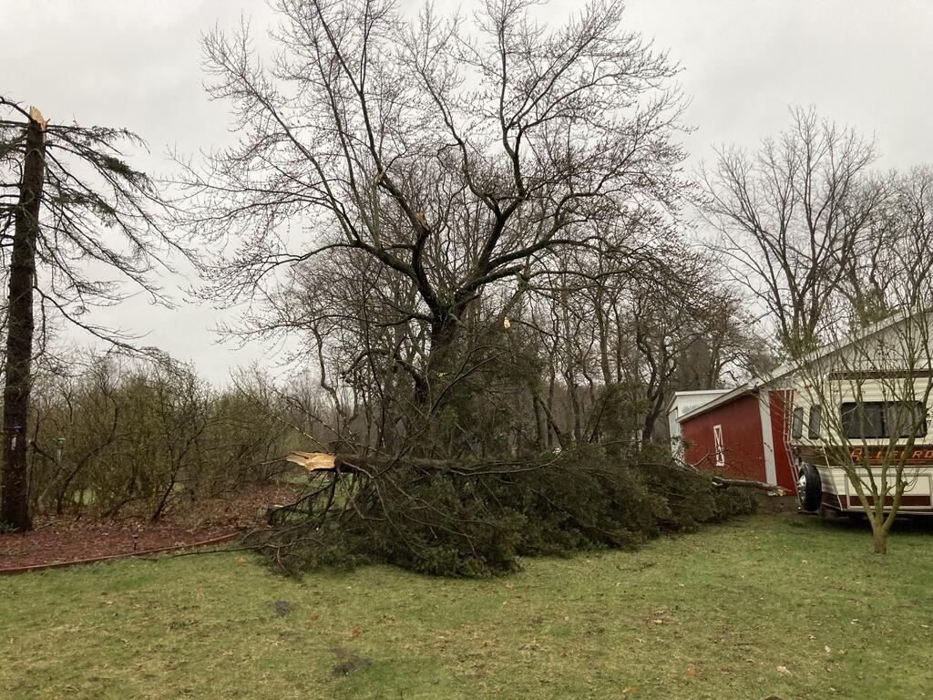

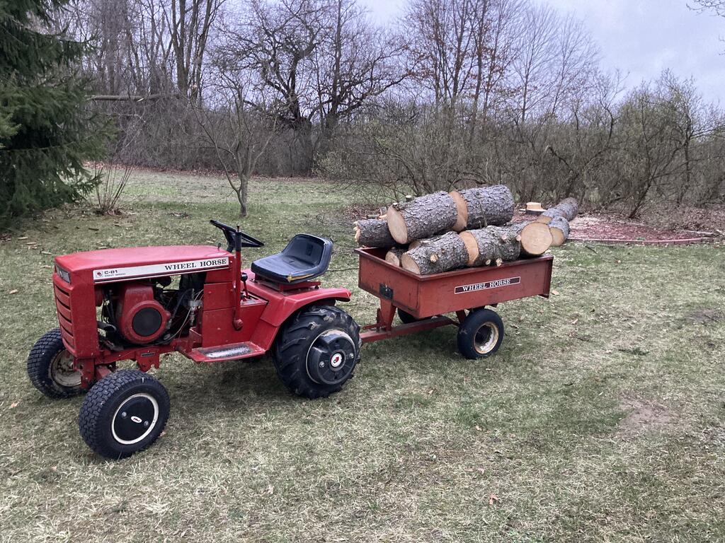

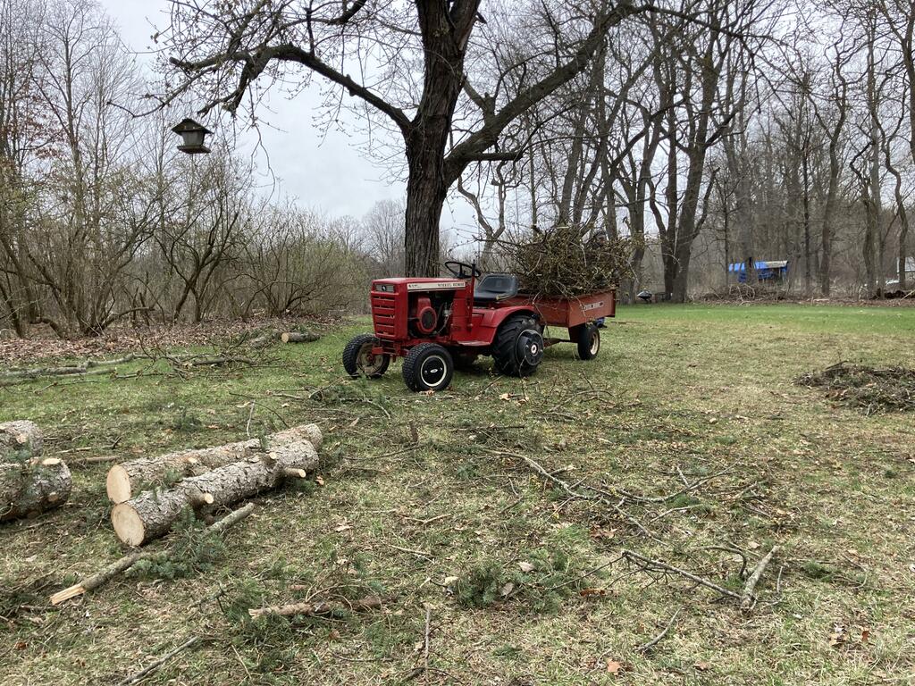

Blasterdad 3,168 #23240 Posted April 3, 2025 (edited) Sunday we had a severe thunderstorm with 80 mph winds roll through. It snapped the top off a big pine tree in my side yard, taking some branches of the maple tree next to it on the way down. Monday I bought bar oil and a new chain for the saw. Tuesday after work I got it all cleaned up wth help from the C-81. From plowing at @Pullstart's plow day on Saturday, to yard duty on Tuesday, she's been a happy . Edited April 3, 2025 by Blasterdad 6 13 1 Share this post Link to post Share on other sites
953 nut 69,756 #23241 Posted April 3, 2025 9 hours ago, Blasterdad said: snapped the top off a big pine tree in my side yard, taking some branches of the maple tree next to it on the way down. Glad it missed the camper and building. 1 1 Share this post Link to post Share on other sites
Blasterdad 3,168 #23242 Posted April 3, 2025 13 minutes ago, 953 nut said: Glad it missed the camper and building. It was close! I was standing on the front porch when it happened. It was LOUD! Sounded to me like something hit the roof of the house. I ran through the side yard to go in the back door & didn't even see it till later, it was raining so hard. Lol. Was quite relieved that nothing hit the house. 4 Share this post Link to post Share on other sites
Handy Don 17,554 #23243 Posted April 3, 2025 4 hours ago, Blasterdad said: It was close! I was standing on the front porch when it happened. It was LOUD! Sounded to me like something hit the roof of the house. I ran through the side yard to go in the back door & didn't even see it till later, it was raining so hard. Lol. Was quite relieved that nothing hit the house. Run outside in pouring rain. Check Run outside in pouring rain during high wind event near trees. Check Quite relieved nothing landed on YOU! 1 Share this post Link to post Share on other sites
Blasterdad 3,168 #23244 Posted April 3, 2025 (edited) 3 hours ago, Handy Don said: Run outside in pouring rain. Check Run outside in pouring rain during high wind event near trees. Check Quite relieved nothing landed on YOU! When I went out front it wasn't raining. When the front blew in it happend in seconds & the front door was locked. Not one of my better thought out plans for sure. Edited April 3, 2025 by Blasterdad 3 Share this post Link to post Share on other sites
