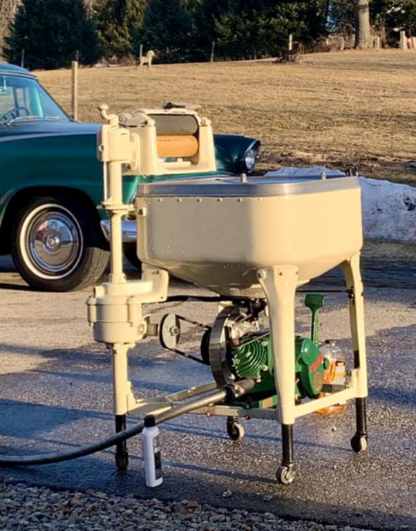

Stepney 2,356 #23178 Posted March 23, 2025 On 3/3/2025 at 4:37 AM, ebinmaine said: When I looked it up I knew immediately what it was for. And how dangerous they certainly can be. As kids we had a sort of third set of grandparents. They had a Ringer in their second home. I definitely don't recall ever being allowed to mess with it. Probably a good thing. @Stepney may even have one today. I did in fact own a Westinghouse electric ironing machine from a local hotel. It was scrapped after trying to give it away for several months.. Still have a pair of Maytag wringer/tub washers (one gas, one electric) and a twin tub Easy Spindrier in service though. On the subject of bodily harm.. if I had a nickel for every time at a show some elderly gent or lady offered a tale of fingers/hair lost to the power wringers, I .. well I could have a lot of things. Another rather unsettling story came from an elderly, long retired P.I. who recounted an even earlier story relating to using such a machine in .. more questionable ways to get a fella to talk.. but I cant go into much more detail on a family friendly forum lol. 5 1 Share this post Link to post Share on other sites

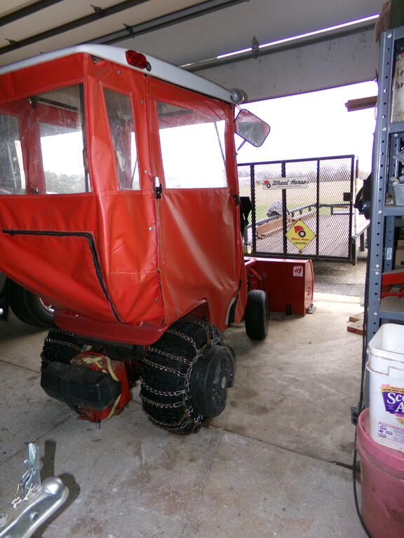

Ed Kennell 46,996 #23181 Posted March 24, 2025 On 3/23/2025 at 12:44 PM, Ed Kennell said: Might have to hire a gorilla to help with the installation. I didn't need the gorilla, just a jack and a lift. Easy Peasy. 5 Share this post Link to post Share on other sites
rjg854 13,311 #23182 Posted March 24, 2025 35 minutes ago, Ed Kennell said: didn't need the gorilla, just a jack and a lift. Easy Peasy. That's the advantage of wisdom vs brute strength 4 1 Share this post Link to post Share on other sites

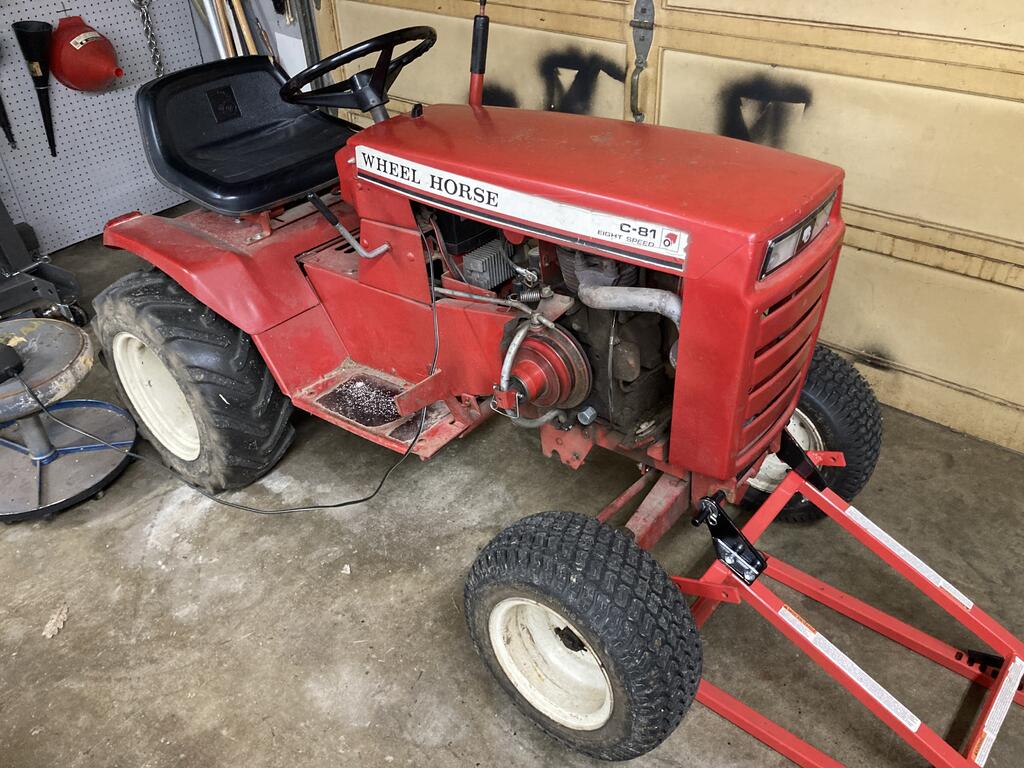

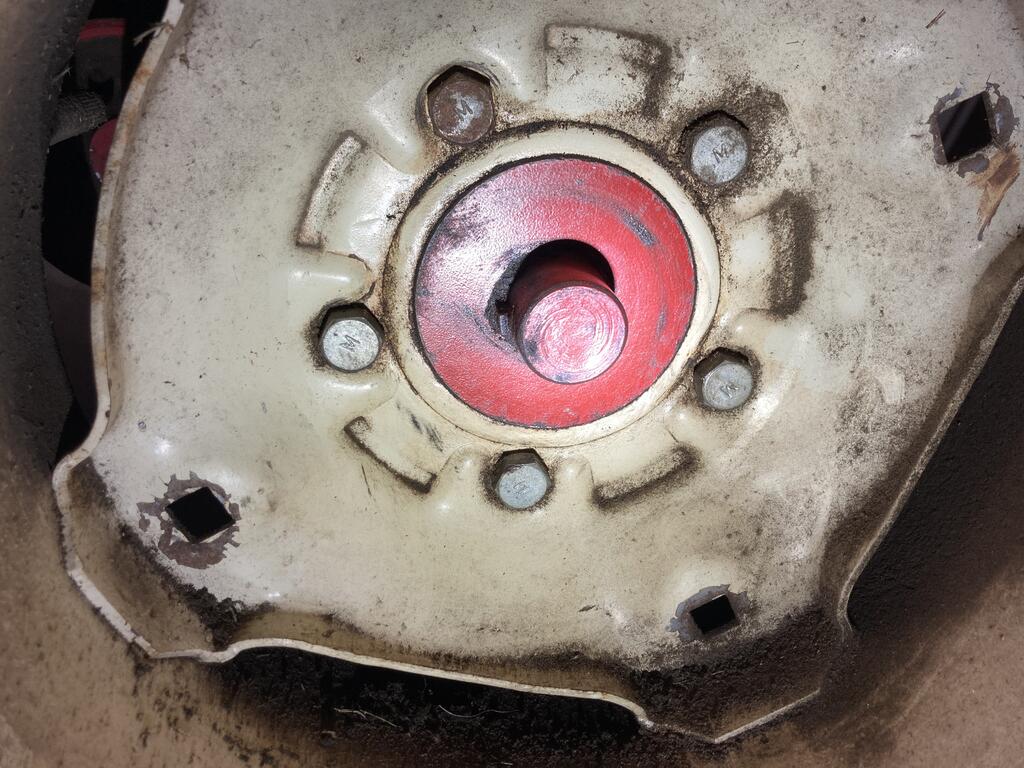

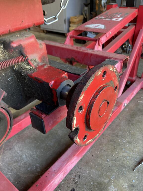

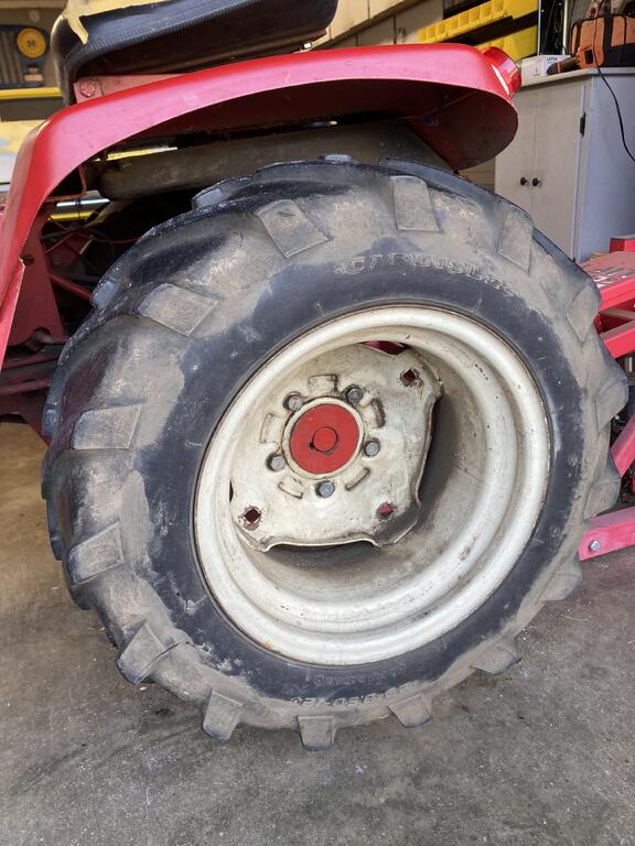

Blasterdad 3,167 #23183 Posted March 25, 2025 Started getting one of the C-81's ready for @Pullstart's plowday. Dropped the deck, changed the oil, & greased all the fittings. Gear oil checked, just changed last summer, no moisture. While switching out hitches I found a leaking axle seal & loose hub. I'll fix both tomorrow after work. 5 2 Share this post Link to post Share on other sites
Ed Kennell 46,996 #23184 Posted March 25, 2025 10 hours ago, Blasterdad said: I found a leaking axle seal & loose hub Loose???, what kept that wheel from falling off? 1 Share this post Link to post Share on other sites
ebinmaine 80,312 #23185 Posted March 25, 2025 9 minutes ago, Ed Kennell said: Loose???, what kept that wheel from falling off? I've had a couple got loose like that. For some reason they have a propensity to go inward. Not so much out. Even a damaged set screw will have a tendency to catch up on the outside of the key preventing it from falling off most of the time. @Blasterdad You got nice new set screws? 1 Share this post Link to post Share on other sites
WHX?? 57,810 #23186 Posted March 25, 2025 10 hours ago, Blasterdad said: & loose hub. Keyway bad Blaster lemme know I'll bring the broach set ... put a new one in. 1 1 1 Share this post Link to post Share on other sites
ebinmaine 80,312 #23187 Posted March 25, 2025 2 minutes ago, WHX?? said: Keyway bad Blaster lemme know I'll bring the broach set ... put a new one in. Is that broach set something your average guy like me could purchase and be able to use? Share this post Link to post Share on other sites

WHX?? 57,810 #23191 Posted March 25, 2025 11 minutes ago, ebinmaine said: s that broach set something your average guy like me could purchase Absolutely... A press is required but you know that. I got my set in the jungle. It is a complete set but a guy could get by with just the 1" & 1/18 bushings & broach for hubs. I think I only needed anything else but once. Cheaper sets are good nuff for hobby work. 2 1 Share this post Link to post Share on other sites
pfrederi 21,051 #23192 Posted March 25, 2025 41 minutes ago, WHX?? said: Absolutely... A press is required but you know that. I got my set in the jungle. It is a complete set but a guy could get by with just the 1" & 1/18 bushings & broach for hubs. I think I only needed anything else but once. Cheaper sets are good nuff for hobby work. I bought the broach set several years ago and have rehabbed several hubs. I am not a machinist or metal worker. I did find that for me it easier to drill and tap the new set screw hole first then line the broach up with it. 3 1 1 Share this post Link to post Share on other sites

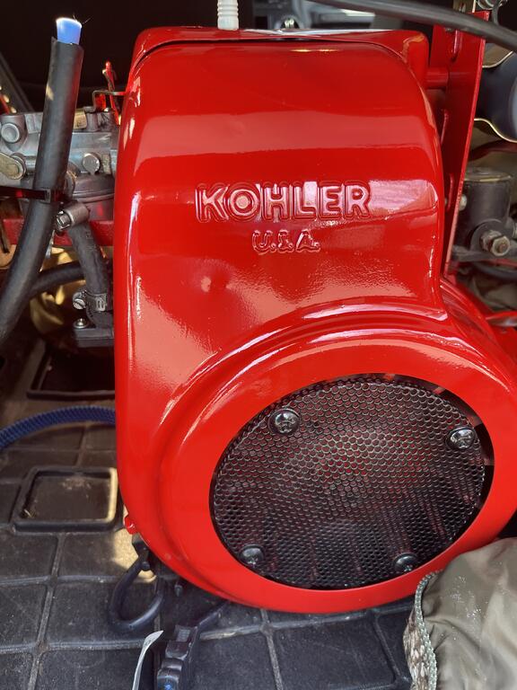

stvski80085 279 #23195 Posted March 25, 2025 (edited) K181s all nice a pretty. Rebuilt and going back in the B-80 this weekend. I still need to make sure my mower deck is working properly after taking it completely apart and painting it. Edited March 25, 2025 by stvski80085 9 Share this post Link to post Share on other sites
WHX?? 57,810 #23196 Posted March 25, 2025 5 hours ago, pfrederi said: easier to drill and tap the new set screw hole first then line the broach up with it. Same here. 1 Share this post Link to post Share on other sites

Blasterdad 3,167 #23199 Posted March 26, 2025 12 hours ago, Ed Kennell said: Loose???, what kept that wheel from falling off? Centrifical force, I only turn right when I mow. 1 2 Share this post Link to post Share on other sites

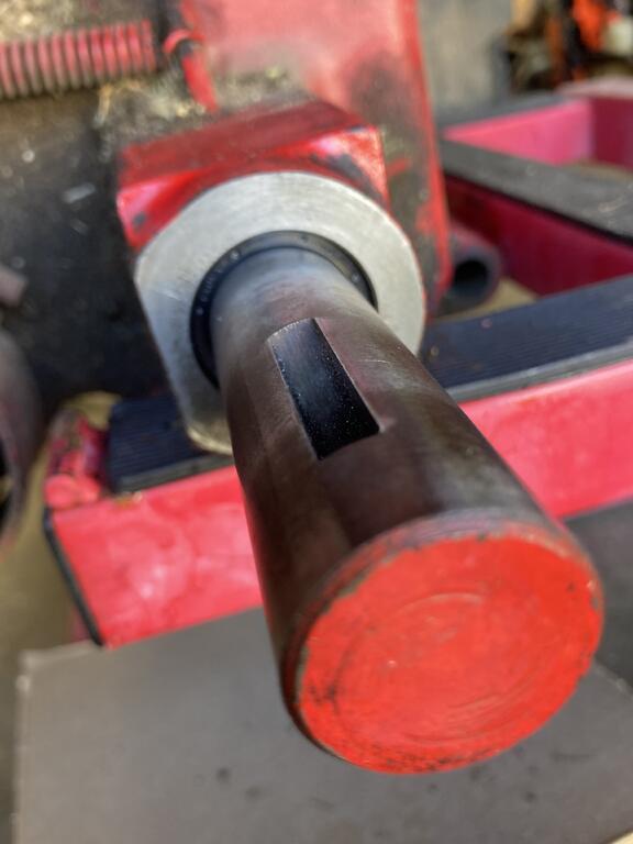

Blasterdad 3,167 #23200 Posted March 26, 2025 New seal in, everything cleaned up nice. Axle, hub, keyway, setscrew & captive nut were like new, (got lucky, plenty of gearlube preservitive,lol). 1 8 Share this post Link to post Share on other sites
