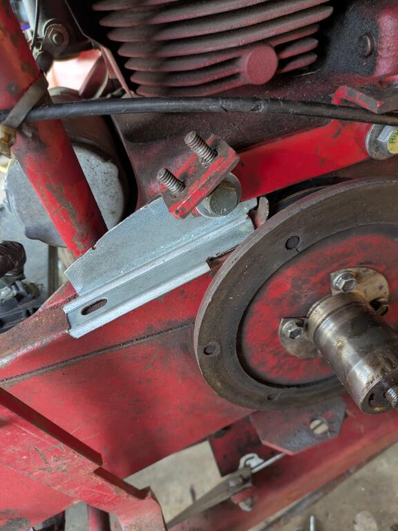

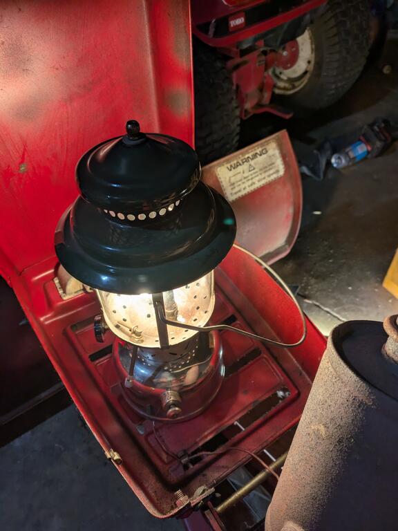

ohiofarmer 3,543 #22904 Posted February 3, 2025 Fixed a pesky belt guard. As you can see,I added some stronger metal to the transmission belt cover on a C- 160. The locator hole in the belt guard cracked and fractured away and then the guard bound itself to the pulley imitating a pooched battery and then a dragging starter. It didn't seem right as that tractor started in single digits with relative ease. It was fussy work,but the fact that the soothing hiss of the antique Coleman Lantern was serving as a finger warmer upper made the job bearable.A couple of rivets should bond the repair. Elon Musk can just eat his heart out over this perfectly balanced lantern burning clean without the benefit of mantles. Remarkable that a 1957 model can be fussed with a bit of effort into a useful companion Coleman and Wheel Horse seem to be cut from the same cloth 5 6 1 Share this post Link to post Share on other sites

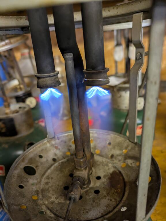

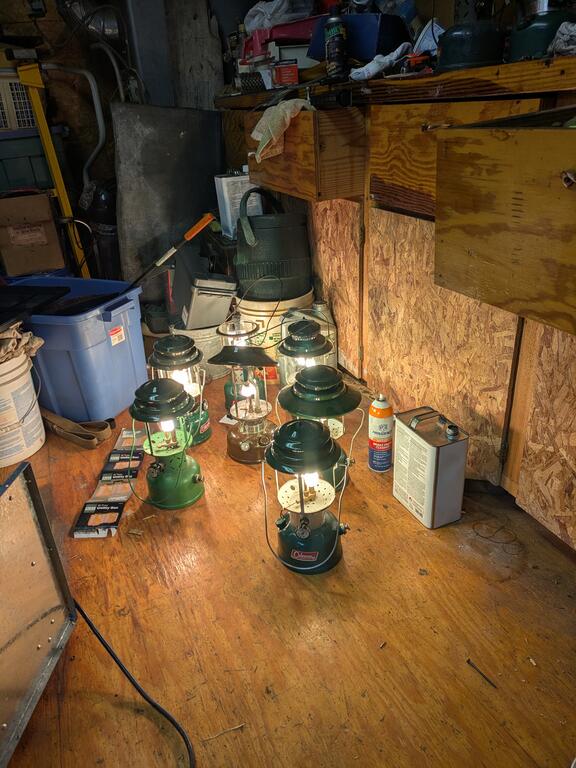

ohiofarmer 3,543 #22908 Posted February 3, 2025 9 minutes ago, Easton Rich said: I’ve got one in perfect shape along with the case ( also in great shape) that I found in an old hay barn. Who would such a nice lantern in there? You never know. My first one bought new is a brown lantern.Ugly . It's a 275 and the collectors want at least one "turd" model. I am finding out that the 220 D,E,and F models run well and quiet and can be workhorse lanterns. Original green sunrise globes are rare to survive and the red print originals get stored or displayed. I started to acquire twenty dollar lanterns just for parts. It was really good one day and I got six of them running. VID-20250129-WA0001.mp4 2 5 Share this post Link to post Share on other sites

ohiofarmer 3,543 #22910 Posted February 3, 2025 1 hour ago, Handy Don said: I’m quite happy to have two Colemans (one white gas and one propane) to use for emergency lighting. Is yours also usable with mantles to get brighter light? Sure is. It's just a sign of a good runner when they light up and run blue Pro tip. Peerless Mantles are brighter and less breakable than Coleman Share this post Link to post Share on other sites

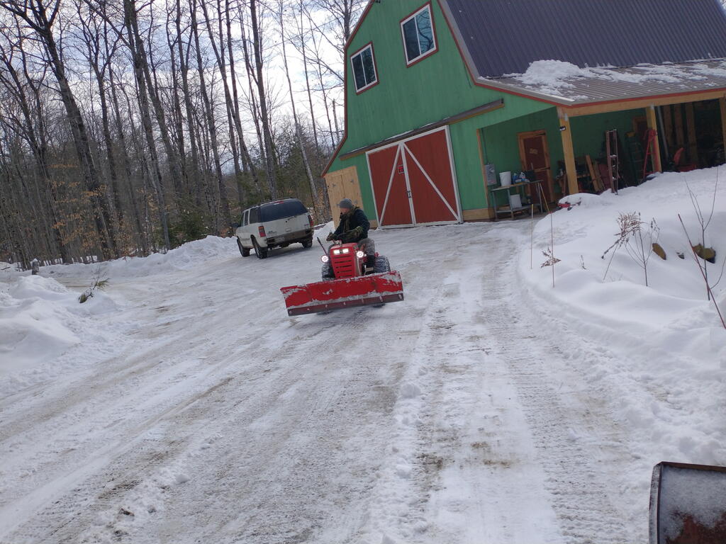

ebinmaine 81,282 #22913 Posted February 4, 2025 I had regular work today. Trina and our friend got to play snowplow duty on the Horses. The friend driving my '75 C160 Automatic. 6 6 Share this post Link to post Share on other sites
Thor27 899 #22914 Posted February 5, 2025 That is a colossal plow. 4 Share this post Link to post Share on other sites

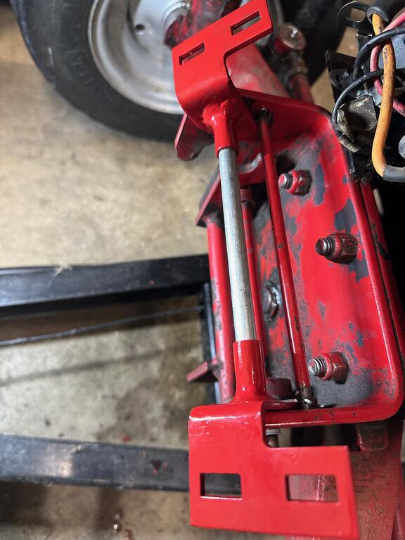

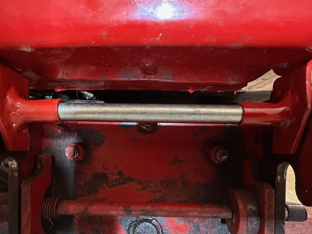

Andy N. 2,897 #22915 Posted February 5, 2025 Removed the old worn out hood hinge brackets on the 520-H. Installed the @Steve Janninck designed and modified hood hinge brackets. Will definitely last longer than the original '89 set! 4 9 Share this post Link to post Share on other sites
ebinmaine 81,282 #22916 Posted February 5, 2025 7 hours ago, Thor27 said: That is a colossal plow. 60" across the bottom. It'll move snow. Side to side pivot is a workout. It's easy to see how a second hydraulic circuit would be a benefit. 1 Share this post Link to post Share on other sites

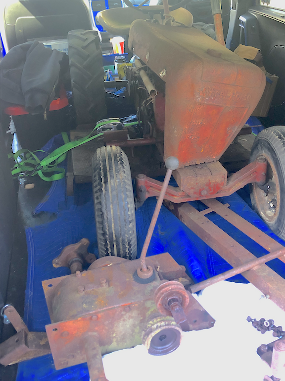

Handy Don 17,735 #22918 Posted February 5, 2025 (edited) Well, these rescued Suburban parts were mine for short time, but I am delighted to see them loaded up and headed off to a home with @Bill G who's anxious to put them to good use! (Note, he brought usable front wheels/tires to swap on instead of the rotted out originals so we could more easily roll it into his van.) Edited February 5, 2025 by Handy Don 14 5 Share this post Link to post Share on other sites
Chris G 3,402 #22919 Posted February 5, 2025 @Handy DonI'm glad u saved them and I'm looking forward to putting all useable parts back to work! Thanks again 1 Share this post Link to post Share on other sites
ebinmaine 81,282 #22920 Posted February 5, 2025 14 minutes ago, Chris G said: @Handy DonI'm glad u saved them and I'm looking forward to putting all useable parts back to work! Thanks again Wicked cool. 1 Share this post Link to post Share on other sites
oliver2-44 11,847 #22921 Posted February 6, 2025 Excellent. Looking forward to a Restoration thread. 1 Share this post Link to post Share on other sites
