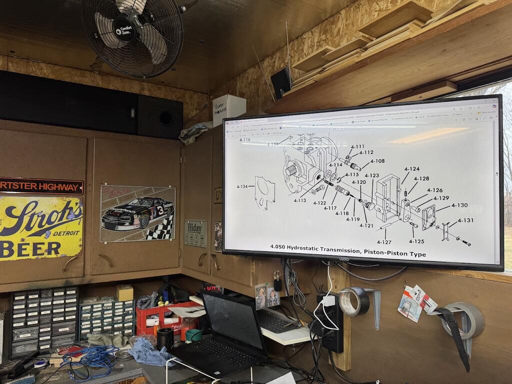

Bar Nuthin 3,043 #22601 Posted December 26, 2024 (edited) 10 hours ago, ebinmaine said: every once in awhile you just need to have a piece of paper in your hand Alexa, where the hell does this piece go? Edited December 26, 2024 by Bar Nuthin 7 2 7 1 Share this post Link to post Share on other sites
SylvanLakeWH 32,151 #22602 Posted December 26, 2024 @Bar Nuthin love the Strohs sign!!! 5 Share this post Link to post Share on other sites

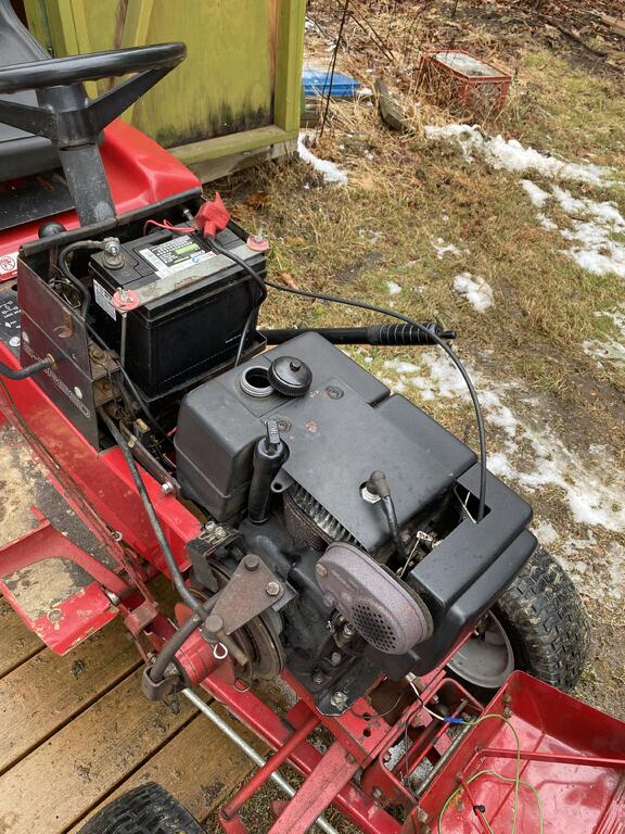

ML3 2,484 #22604 Posted December 27, 2024 Doing some almost mid winter inspection/maint on 654. No oil consumed. Grease all the fittings, etc. Ready for the next snowfall...... 10 4 Share this post Link to post Share on other sites

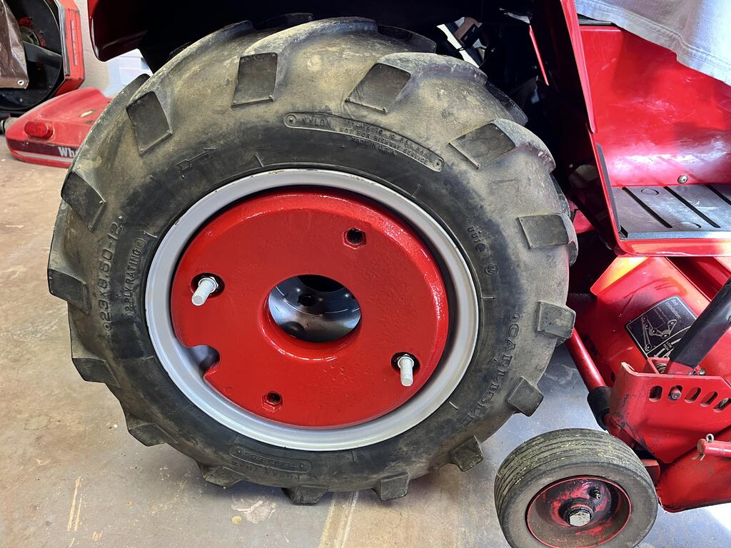

Wvtroutbum81 327 #22605 Posted December 28, 2024 Sandblasted and painted wheel weights for the 315-8 a few weeks ago. Installed them today😁 6 2 Share this post Link to post Share on other sites
Handy Don 17,316 #22606 Posted December 28, 2024 35 minutes ago, Wvtroutbum81 said: Installed them today😁 They look great. I’d need shin guards ‘cause being distracted I’d surely bang into the bolts 3 1 Share this post Link to post Share on other sites

Wvtroutbum81 327 #22608 Posted December 28, 2024 3 hours ago, Handy Don said: They look great. I’d need shin guards ‘cause being distracted I’d surely bang into the bolts Yeah im going to cut them off 2 1 Share this post Link to post Share on other sites

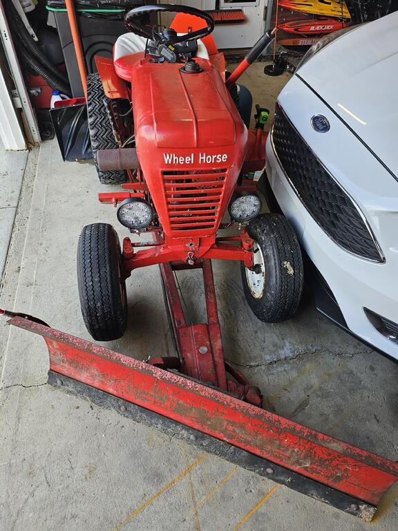

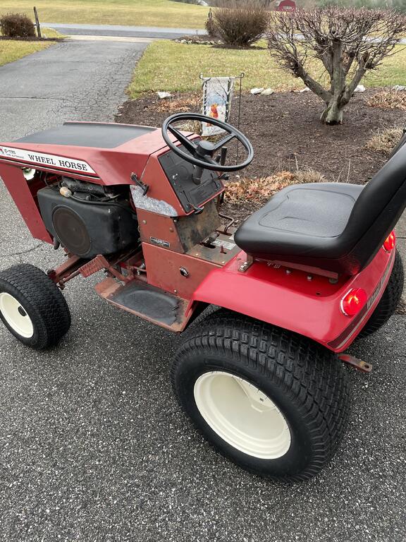

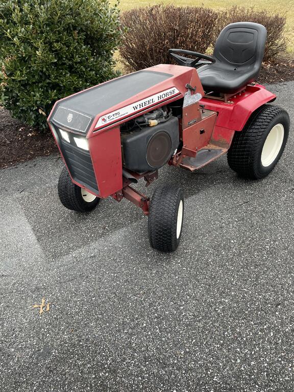

Sodaking27 1,318 #22609 Posted December 28, 2024 Took the C175 for a few laps around the driveway. Still haven’t put the weights, chains or blade on. Hoping it will entice a little snow at some point. 9 1 Share this post Link to post Share on other sites

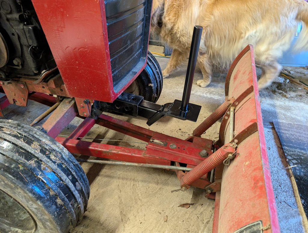

bassJAM 94 #22612 Posted December 30, 2024 Yesterday I welded up a couple plate weight holders, primed them, and put the final coat of paint on them this morning. The welds aren't pretty, I haven't touched a welder in 20 years and even then it was only for a few hours after a few minutes of instruction, but they held up to several whacks with a hammer! Now I'm just waiting for snow... 8 1 Share this post Link to post Share on other sites
c-series don 12,363 #22613 Posted December 30, 2024 @bassJAM I see the rod that pushes and pulls to angle your plow is connected to the top of the swing quadrant. It should be connected to the bottom of it, there is a hole directly underneath where it’s connected now. It’s a bit of a pain in the neck to get the cotter pin in the hole in the rod once it’s in the proper place. But it will swing much easier than the way it is now if you change it. 7 Share this post Link to post Share on other sites
bassJAM 94 #22614 Posted December 31, 2024 22 hours ago, c-series don said: @bassJAM I see the rod that pushes and pulls to angle your plow is connected to the top of the swing quadrant. It should be connected to the bottom of it, there is a hole directly underneath where it’s connected now. It’s a bit of a pain in the neck to get the cotter pin in the hole in the rod once it’s in the proper place. But it will swing much easier than the way it is now if you change it. Thanks I swapped it around today. It didn't seem to make much of a difference in how easily it swings but that certainly looks like the way it's suppose to fit! 6 Share this post Link to post Share on other sites

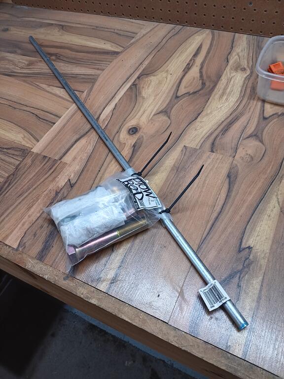

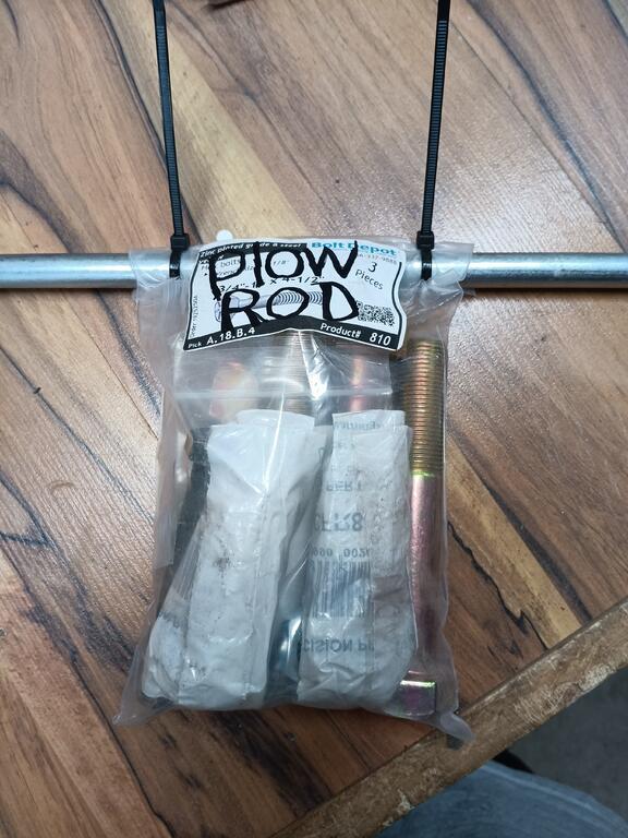

ebinmaine 80,310 #22615 Posted December 31, 2024 2 minutes ago, bassJAM said: Thanks I swapped it around today. It didn't seem to make much of a difference in how easily it swings but that certainly looks like the way it's suppose to fit! I'll tell ya what helps a fair amount is changing to a solid connection with heim joints on each end. Tightens the whole system up. 1 2 Share this post Link to post Share on other sites

bassJAM 94 #22617 Posted December 31, 2024 1 hour ago, ebinmaine said: I'll tell ya what helps a fair amount is changing to a solid connection with heim joints on each end. Tightens the whole system up. Honestly I think it turns side to side pretty smoothly already. Heim joints would probably be a lot easier to install though, I busted up my knuckles pretty good today trying to pull out the old cotter pin before I finally cut it out. Shouldn't need to mess with it again though. 5 Share this post Link to post Share on other sites
Handy Don 17,316 #22618 Posted December 31, 2024 (edited) 13 minutes ago, bassJAM said: Honestly I think it turns side to side pretty smoothly already. Heim joints would probably be a lot easier to install though, I busted up my knuckles pretty good today trying to pull out the old cotter pin before I finally cut it out. Shouldn't need to mess with it again though. I put Heims on the dozer I just refurbished. Partly because it came without the rod and lever, partly for the solid and easy operation, and partly because the hole at the quadrant had been wallowed out terribly (this plow has been worked HARD). Edited December 31, 2024 by Handy Don 3 Share this post Link to post Share on other sites

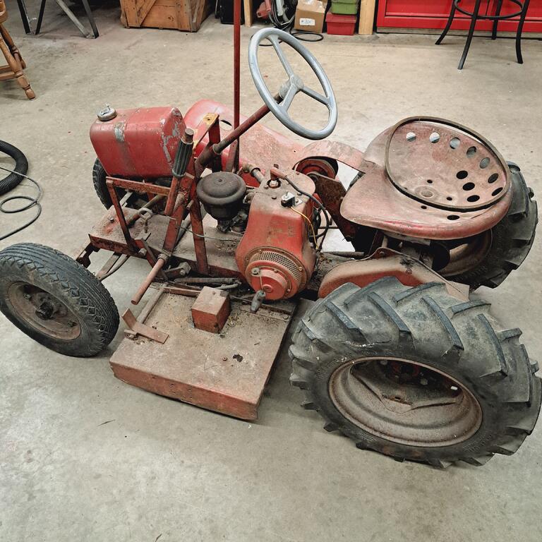

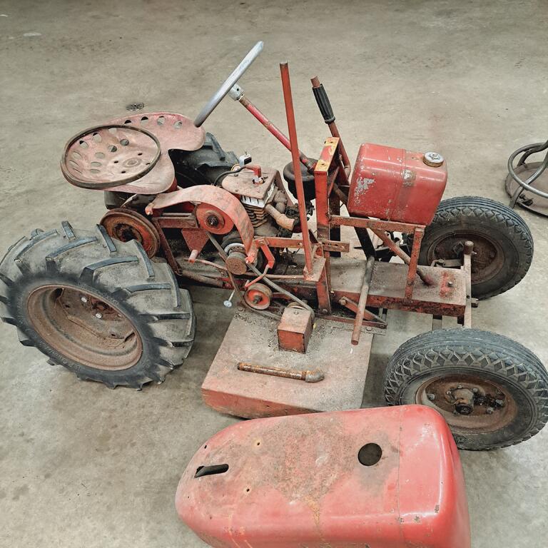

WHX?? 57,809 #22619 Posted January 1, 2025 (edited) Would love to stay up and ring in the new year but the balls here have dropped long ago. 'Sides up early to tie into a resto on this '56 RJ. The time has come Tom @Shynon. Edited January 1, 2025 by WHX?? 3 6 3 Share this post Link to post Share on other sites
Shynon 7,646 #22620 Posted January 1, 2025 6 hours ago, WHX?? said: 'Sides up early to tie into a resto on this '56 RJ. About time, hope you are doing a mechanical restoration only 1 Share this post Link to post Share on other sites
WHX?? 57,809 #22621 Posted January 1, 2025 1 hour ago, Shynon said: mechanical restoration Yep fer sure. Not sure how to clean things up. Dasn't dare take a washer to it take too much what little paint there is off. Dan's coming over today get some fatherly advice. Getting the Clinton running half way decent scares me abit along with the shape of the hubs & the drive pullies. I've never wrenched on one of these so will be tapping on the shoulders of the older RJ pros here. 3 1 Share this post Link to post Share on other sites

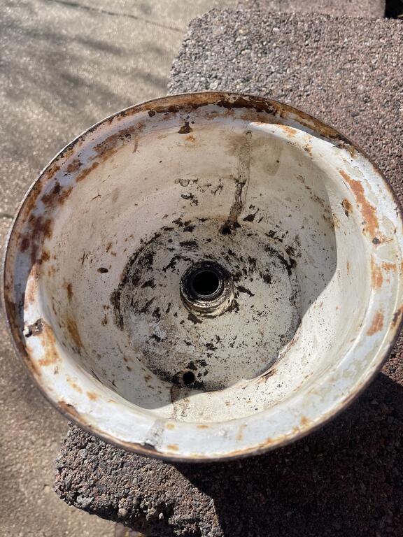

Wheelhorse#1 1,962 #22622 Posted January 1, 2025 Pulled off the front wheels on the 79 -C121 Needs new tires. Had to cut off the old tires off the rims. I was surprised to see so much rust on the inside of tubes tires but I think I can salvage. The left side wasn’t so bad. 3 4 Share this post Link to post Share on other sites
ebinmaine 80,310 #22623 Posted January 1, 2025 19 minutes ago, Wheelhorse#1 said: I think I can salvage Absolutely. Wire wheel. Extra time. Plenty of prep and acetone wiping. Good coat of paint. You may want to start with some really coarse (80 grit?) Paper to crunch the major stuff off. 2 Share this post Link to post Share on other sites
Handy Don 17,316 #22624 Posted January 1, 2025 3 minutes ago, ebinmaine said: Absolutely. Wire wheel. Extra time. Plenty of prep and acetone wiping. Good coat of paint. You may want to start with some really coarse (80 grit?) Paper to crunch the major stuff off. For heavy rust, I’ve had success with the purple paint remover disks. They won’t get into the nooks and crannies (for that I’m a fan of the e-tank) but where they can reach they do a good job. 5 Share this post Link to post Share on other sites
Wheelhorse#1 1,962 #22625 Posted January 1, 2025 10 minutes ago, Handy Don said: For heavy rust, I’ve had success with the purple paint remover disks. They won’t get into the nooks and crannies (for that I’m a fan of the e-tank) but where they can reach they do a good job. Thx Yes I have a bunch of these disk, work great for removing paint too. I’ve used a cupped wire wheel for an angle grinder works great for the nooks and crannies. 3 Share this post Link to post Share on other sites
