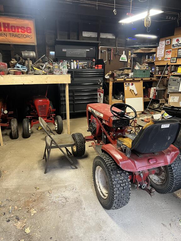

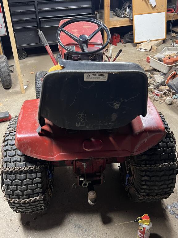

Colby G 248 #22401 Posted November 24, 2024 7 hours ago, oliver2-44 said: Yes, the Wisconsin is aftermarket. If the Wisconsin runs, they have lots of torque. Post a picture (or link like you did for the tractor) of the engine and any nameplate. Are those rear wheel weights steel or concrete? And the shifter won't go into 1st or 3rd at all, what would I do about that? Share this post Link to post Share on other sites
Colby G 248 #22402 Posted November 24, 2024 7 hours ago, oliver2-44 said: Yes, the Wisconsin is aftermarket. If the Wisconsin runs, they have lots of torque. Post a picture (or link like you did for the tractor) of the engine and any nameplate. Are those rear wheel weights steel or concrete? https://photos.app.goo.gl/bZXNq7WfZU1HDUMV7 Share this post Link to post Share on other sites

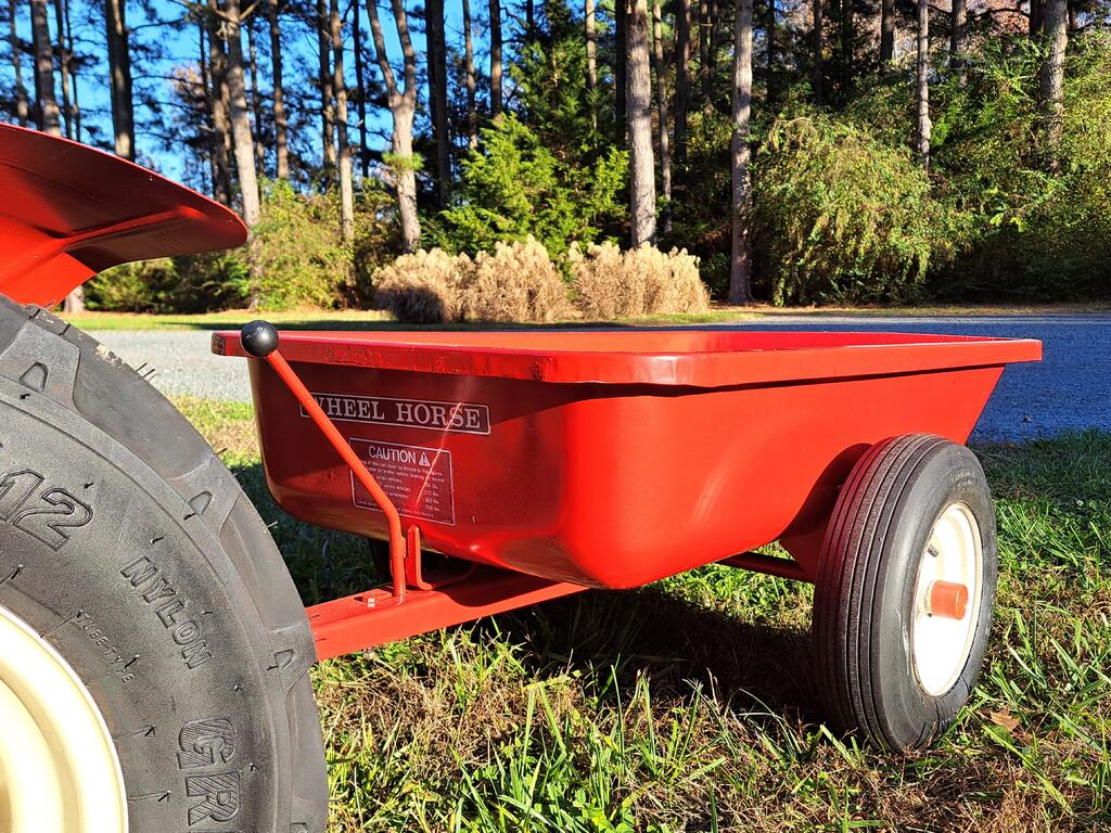

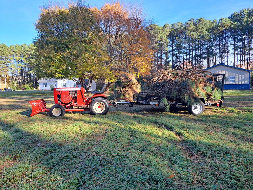

dmoore 1,042 #22404 Posted November 24, 2024 Pulled the C-101 off the show circuit long enough to put it to work after our latest blow. 6 9 Share this post Link to post Share on other sites

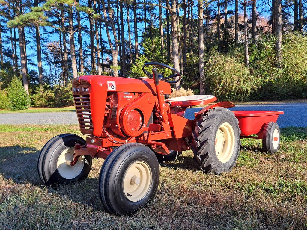

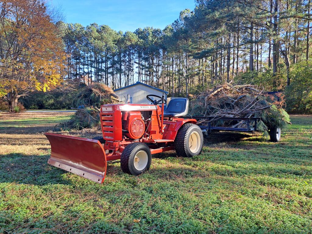

dmoore 1,042 #22405 Posted November 24, 2024 And so it wouldn't be jealous, I pulled out the 854. 3 12 Share this post Link to post Share on other sites

Chevy_59 20 #22409 Posted November 25, 2024 5 hours ago, dmoore said: And so it wouldn't be jealous, I pulled out the 854. what size and what brand of tri ribs are those Share this post Link to post Share on other sites
dmoore 1,042 #22410 Posted November 25, 2024 4.00 - 8 Deestone's bought from M.E.Miller Tire in Ohio. 1 Share this post Link to post Share on other sites
kpinnc 19,003 #22412 Posted November 25, 2024 On 11/24/2024 at 4:06 PM, dmoore said: And so it wouldn't be jealous, I pulled out the 854. That 854 is beautiful! 2 1 Share this post Link to post Share on other sites
dmoore 1,042 #22413 Posted November 25, 2024 (edited) Thanks! I like this pic better.. Edited November 25, 2024 by dmoore 2 7 Share this post Link to post Share on other sites
dmoore 1,042 #22414 Posted November 25, 2024 Or maybe this one.. 3 9 Share this post Link to post Share on other sites
kpinnc 19,003 #22415 Posted November 25, 2024 All of them look great! 1 1 1 Share this post Link to post Share on other sites
oliver2-44 11,771 #22416 Posted November 26, 2024 On 11/24/2024 at 10:50 AM, Colby G said: And the shifter won't go into 1st or 3rd at all, what would I do about that? Put the shifter in what feels like neutral. Pull the shifter out and look in the hole. The top of the forks should form a square. If the square looks like 2 offset pieces use a large screw driver or pry bar and move the pieces so the form a square. You may have to rock the tractor back and forth a little to help them move. Report back how it works out. 3 Share this post Link to post Share on other sites
