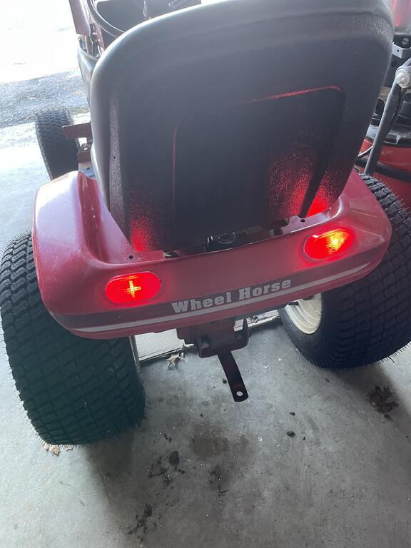

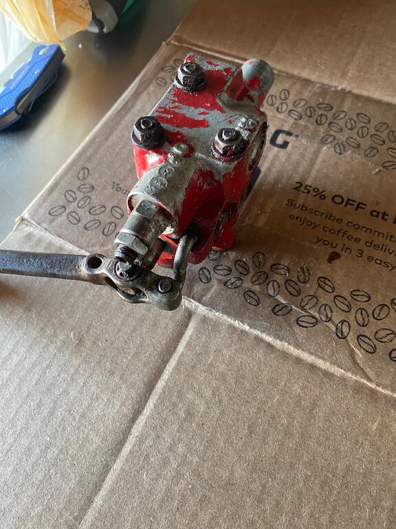

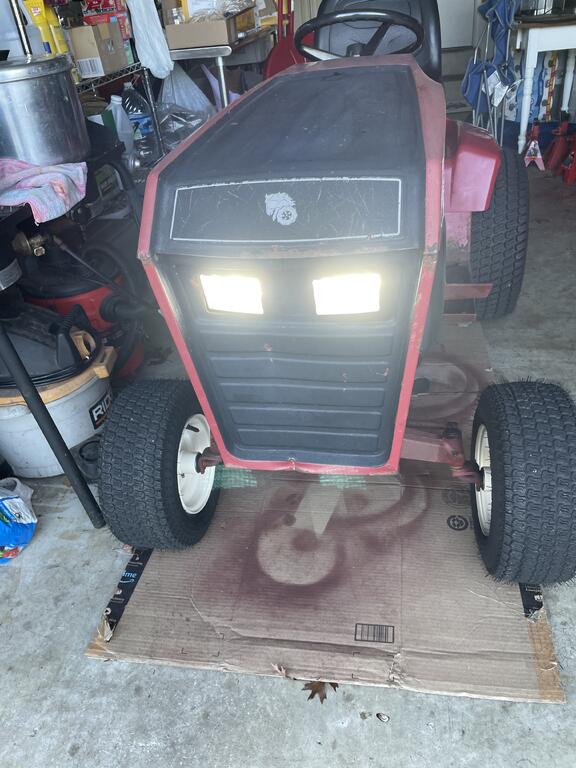

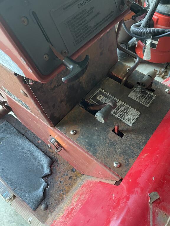

Greg Cullison 76 #22276 Posted November 12, 2024 3 hours ago, Sodaking27 said: Rebuilt the hydraulic lift valve for the second time today. Still have a small leak . At least it’s not as bad as the last attempt. May be time to see if someone has one to sale. Installed new LED head and tail lights. Going to give it a good workout with the leaf sweeper to ensure everything is okay before mounting the snow blade, weights and chains. Where can I get the LED headlights? They look great! Share this post Link to post Share on other sites
Sodaking27 1,292 #22277 Posted November 12, 2024 4 minutes ago, Greg Cullison said: Where can I get the LED headlights? They look great! Just google - PAR36 LED Landscape Light Bulbs 12W 1280LM 80W. I got mine from the jungle site. 3 Share this post Link to post Share on other sites

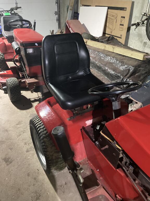

MainelyWheelhorse 2,891 #22278 Posted November 12, 2024 The 308 is coming along. One new Tractor Supply high back seat and it’s almost ready for winter. 3 3 Share this post Link to post Share on other sites
ebinmaine 79,728 #22279 Posted November 12, 2024 6 hours ago, MainelyWheelhorse said: The 308 is coming along. One new Tractor Supply high back seat and it’s almost ready for winter. Excellent! 1 Share this post Link to post Share on other sites
MainelyWheelhorse 2,891 #22280 Posted November 12, 2024 11 hours ago, Sodaking27 said: Just google - PAR36 LED Landscape Light Bulbs 12W 1280LM 80W. I got mine from the jungle site. That’s where I found mine too. Another place is Home Depot. Amazon is a bit cheaper though. 1 Share this post Link to post Share on other sites

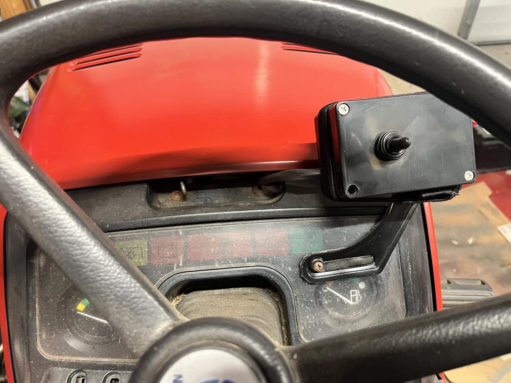

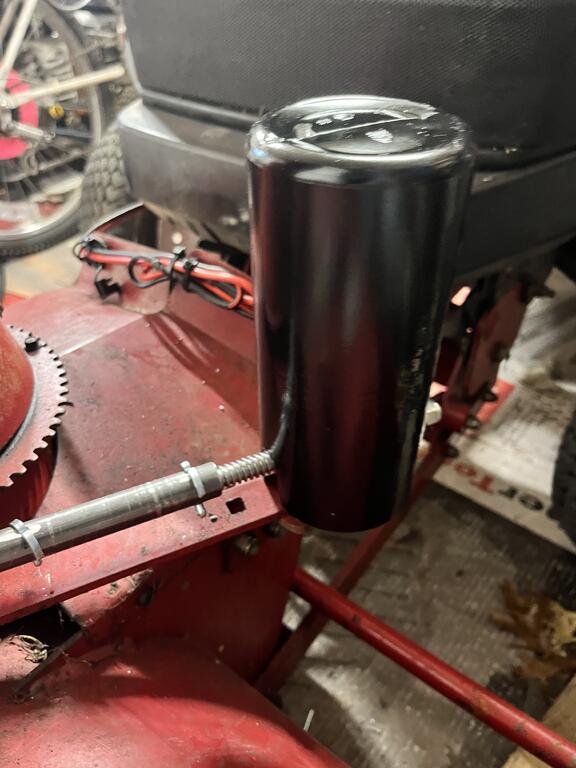

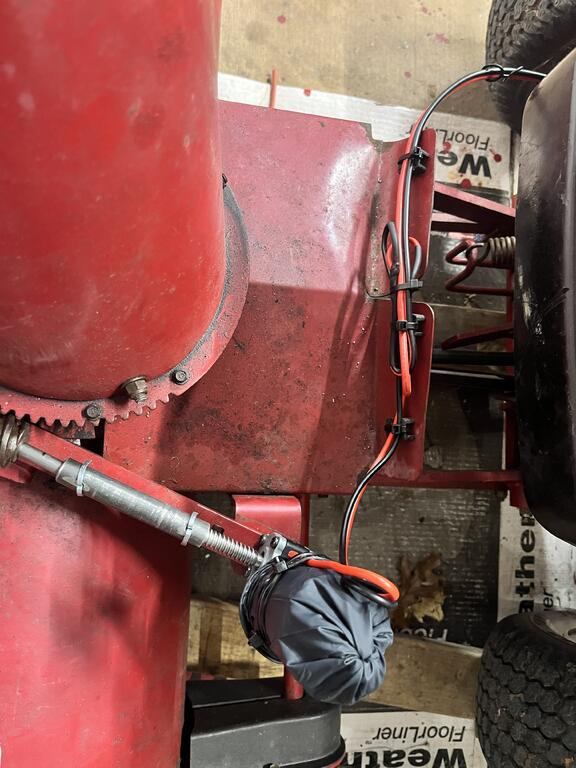

WNYPCRepair 1,924 #22281 Posted November 12, 2024 I put my snowblower on a couple of weeks ago. It’s a single stage blower for the XI series. I have a two stage but it is just to heavy for this old man to drag around. I had to make a connector for the chute rotation. It worked fine, but I wasn’t very impressed by how well it worked. so I dug around in some of my junk and found a power seat motor. So I made a new shaft to hook to the gear that rotates the chute. Ran the wiring, mounted a switch, and then tested it this morning. Works great. Now I think I’ll think about a cab. IMG_5935.MOV 3 3 Share this post Link to post Share on other sites
Handy Don 16,961 #22282 Posted November 12, 2024 2 minutes ago, WNYPCRepair said: Ran the wiring, mounted a switch, and then tested it this morning. Nothing I can tell someone in Buffalo about snow. I can suggest that a seat motor is not weatherproof and now that you have it working you take some time to be sure that this one is protected from snow/sleet/freezing rain and all that other “lake effect” wet stuff you folks seem to thrive on 😁 Share this post Link to post Share on other sites
WNYPCRepair 1,924 #22283 Posted November 12, 2024 2 hours ago, Handy Don said: Nothing I can tell someone in Buffalo about snow. I can suggest that a seat motor is not weatherproof and now that you have it working you take some time to be sure that this one is protected from snow/sleet/freezing rain and all that other “lake effect” wet stuff you folks seem to thrive on 😁 i assumed it wasn’t. Hopefully I have it waterproofed enough. I sealed all the wiring connectors with silicone, covered the entire motor with tightly wrapped electrical tape, covered that with a nitrile glove, and then found something to use as a cover. Hopefully it all keeps it dry. 2 7 Share this post Link to post Share on other sites

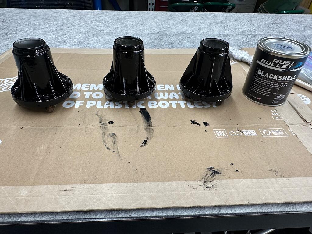

Andy N. 2,803 #22284 Posted November 13, 2024 Couple more 48" mower deck spindles cleaned and painted with new bearings installed. With @Steve Janninck. 10 Share this post Link to post Share on other sites

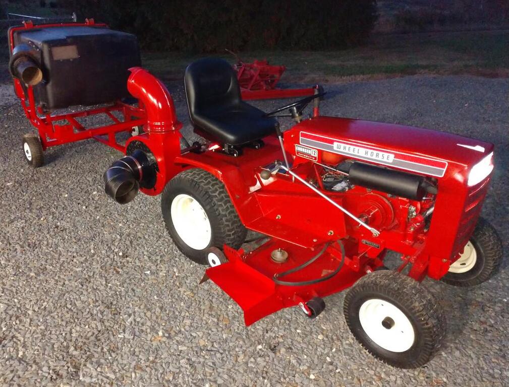

kpinnc 18,756 #22290 Posted November 14, 2024 (edited) Built one for my FIL a couple years ago. I don’t have pics with the hoses attached. Bin is from an old Kubota system to make dumps easy. He picked up 10 loads today with it. Gotta move the hoses around one of these days, move them to the center so the hose flexes less- but so far it works great. The vacuum works off the PTO as well. His only complaint has been hitting the hitch with his knee when not using the bagger. It’s all held on with a Reese hitch, so one pin and it drops off, but he tends to leave it on year round. Edited November 14, 2024 by kpinnc 2 10 1 Share this post Link to post Share on other sites

kpinnc 18,756 #22292 Posted November 14, 2024 53 minutes ago, ebinmaine said: All we do for leaves is blow them to the forest. Same here, but to the pasture. I got lucky with this place that the amount of leaves is so small that I don’t have to get them up anymore. My FILs home is much like where I lived previously, with multiple giant willow oak trees in his yard. They cover two acres in ankle-deep leaves in the fall. Way too much to mulch. They have to be picked up. 2 Share this post Link to post Share on other sites

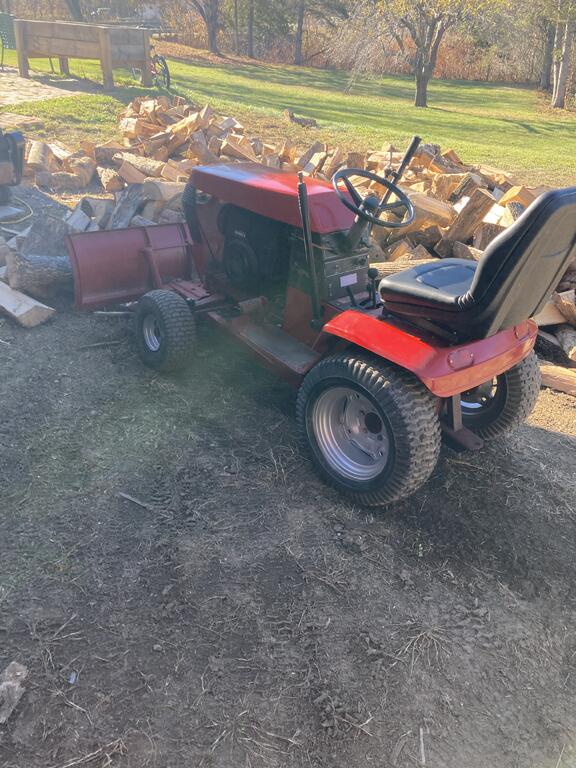

MainelyWheelhorse 2,891 #22296 Posted November 14, 2024 (edited) I put the 308 to work today pushing back a woodpile. Definitely needs a solid link and a counter weight/loaded tires and possibly AG or something grippier. The turf savers were iffy traction wise. Overall it worked pretty well. Better than doing it by hand. Edited November 15, 2024 by MainelyWheelhorse 4 1 Share this post Link to post Share on other sites

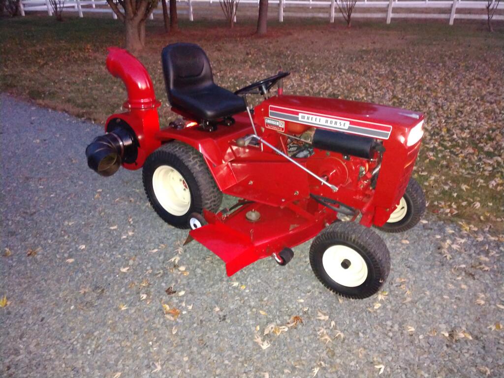

Lee1977 7,710 #22297 Posted November 14, 2024 (edited) Still wating for all my leafs to come down so I can get them all up at one time. I usually get my leafs up around Thanksgiven. I did get the blower mounted today so I'm 2 weeks ahead Edited November 14, 2024 by Lee1977 8 1 Share this post Link to post Share on other sites
kpinnc 18,756 #22298 Posted November 15, 2024 11 hours ago, Bill D said: Beautiful machine Kevin. Your fabrication work never ceases to amaze me. Thank you Don! It definitely would have been nice to have made money by the hour on that one. My FIL had several ideas as did I for making this work. He had an older gentleman tell us both that it was impossible to make it work this way for any decent period of time, so we simply had to prove the guy wrong. Two years and dozens of loads of leaves later- she’s still working! 4 Share this post Link to post Share on other sites
MainelyWheelhorse 2,891 #22299 Posted November 15, 2024 Today, I did more pushing back the woodpile with the 308. After initially starting like I did yesterday, I put chains on the rear tires and it made a huge difference in traction. The 8 horse Kohler on the 308 would probably break something before it would stop pushing. As long as the sticks were relatively loose I had no issues. But once the wood hooked together it was a brick wall. 2 Share this post Link to post Share on other sites
Handy Don 16,961 #22300 Posted November 15, 2024 7 minutes ago, MainelyWheelhorse said: 308 would probably break something before it would stop pushing At least one member has commented that their WH would climb a tree if it could get enough traction. 3 Share this post Link to post Share on other sites
