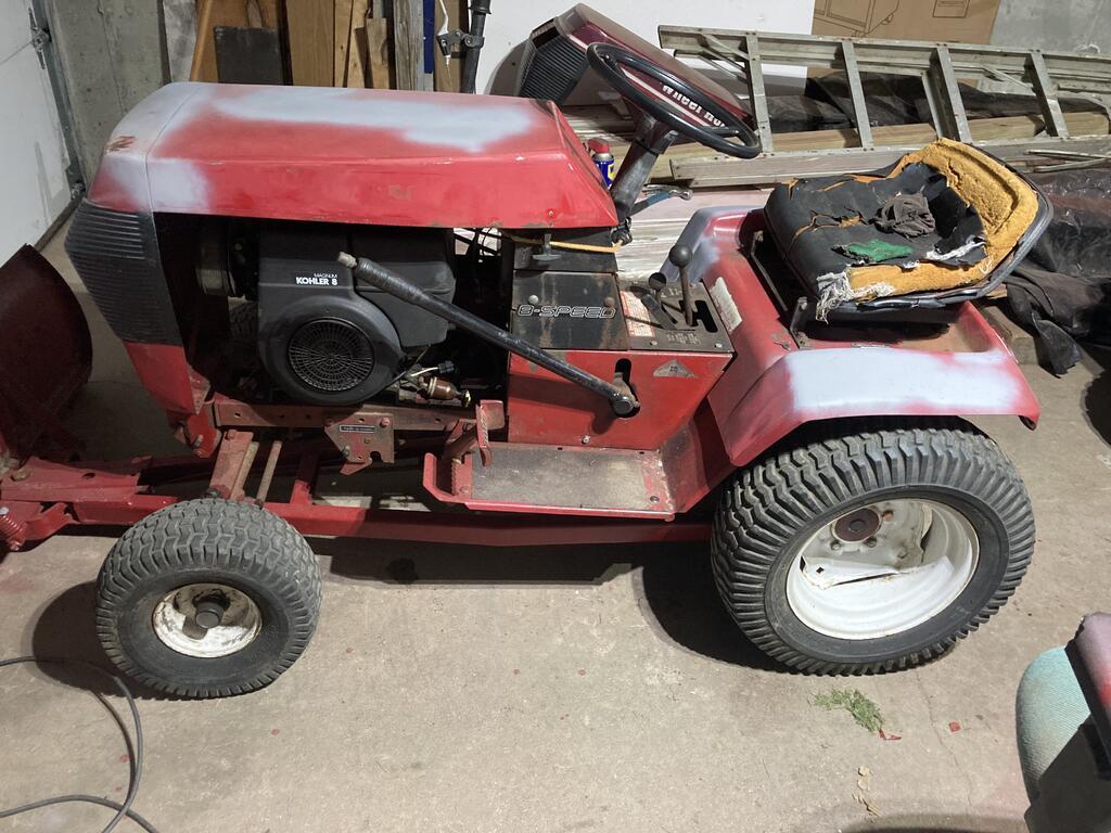

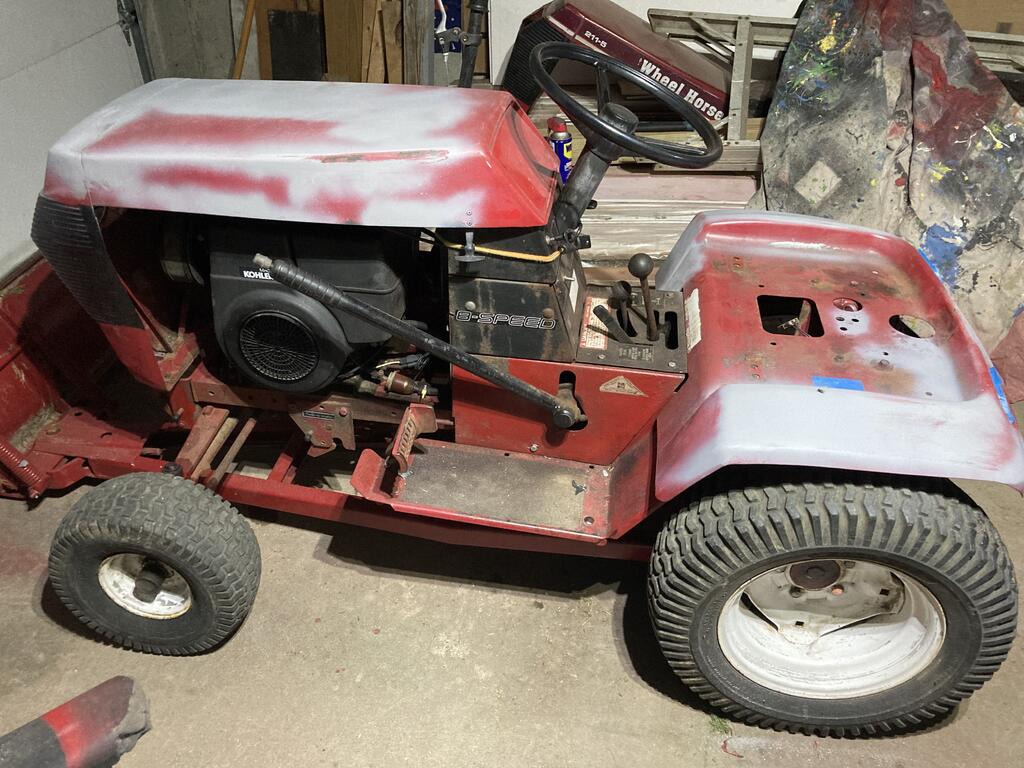

MainelyWheelhorse 3,044 #22158 Posted October 19, 2024 Worked on the 308 for a bit today. I peeled off the old hood stickers and got it ready for paint. I’m also waiting on some Amazon landscaping headlights. 7 1 Share this post Link to post Share on other sites

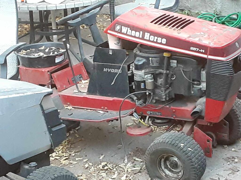

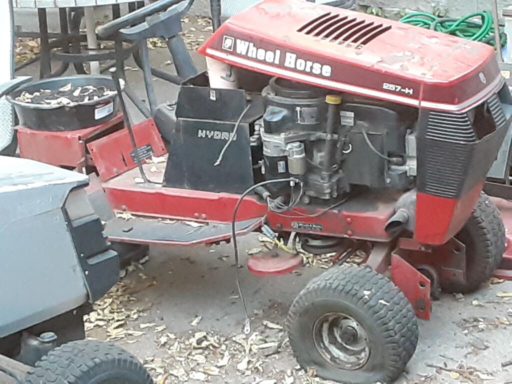

BBQVultureWings 160 #22161 Posted October 20, 2024 Today the 257-H got new shoes mounted. I received all my parts from scAmazon & I also got my replacement rim & Transmission cooling fan from A-Z Tractor. A-Z Tractor is a Great place for parts with excellent service. I am Really happy with finding that resource & I highly recommend them. Anyway, The new tires went on pretty easily & I have to reinstal the transmission tomorrow. I had to remove it to get the tire off the left side which was a real chore but it is done now. Gonna put my new drive belt on & see how things go. Hopefully it was just a low fluid situaation with the Hydro pump transmission. I will know more tomorrow. Also I found a C-145 with a snow Blade & mowing deck for $200 so I will be going to get that tomorrow evening. On my way to growing a "Herd" I can hardly wait. gonna get some zzzzzs for now 6 Share this post Link to post Share on other sites

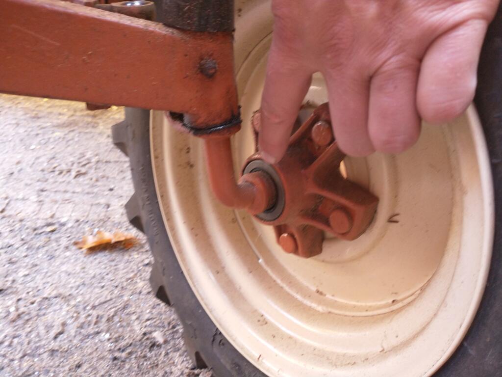

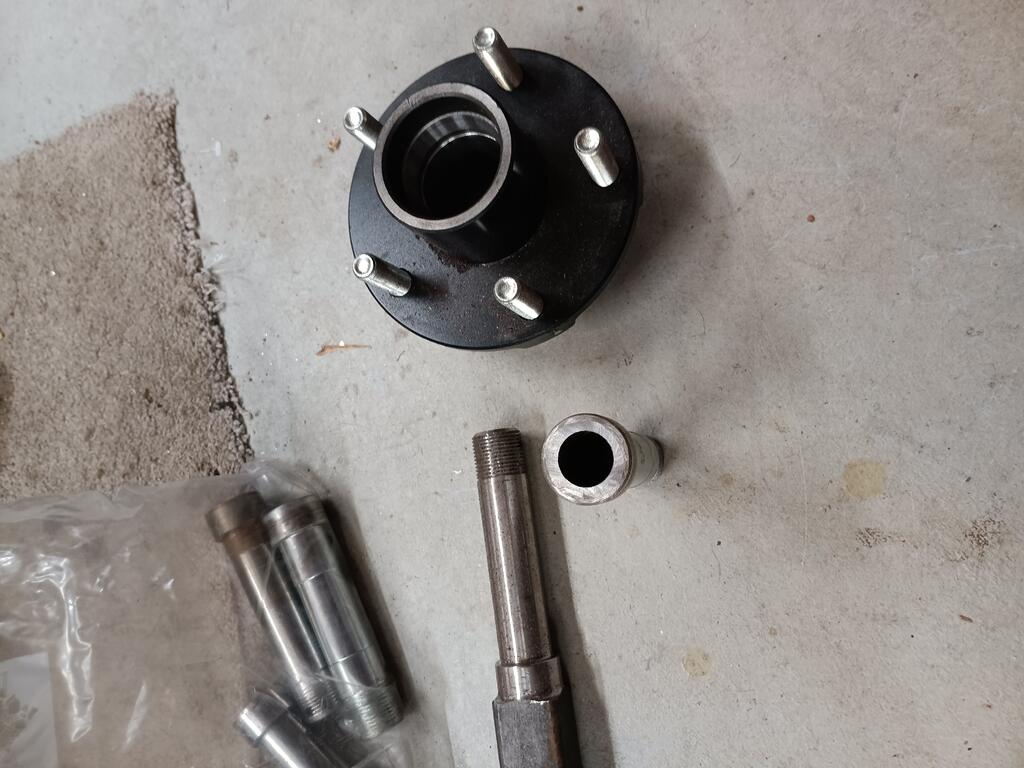

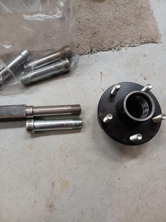

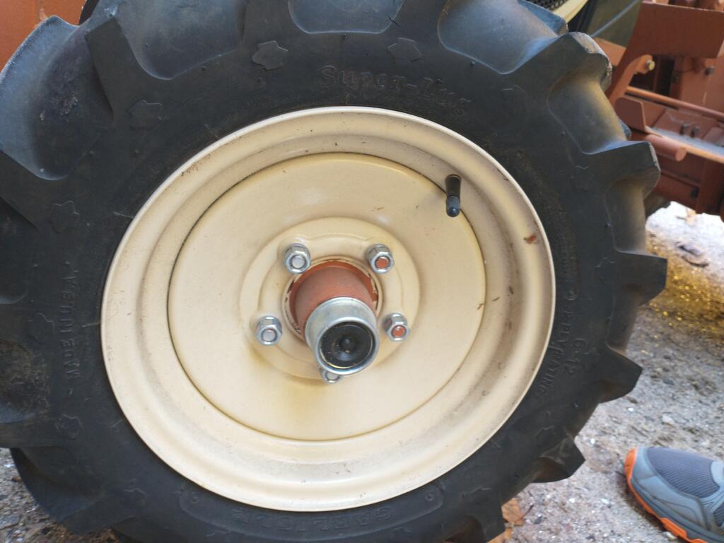

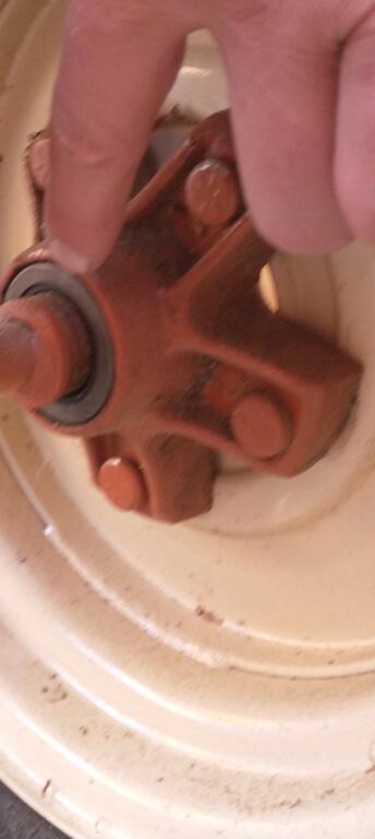

ebinmaine 80,307 #22164 Posted October 20, 2024 On 10/17/2024 at 6:45 PM, Lagersolut said: Can anyone point out a thread for upgrading the front wheels/axles for weight ? I'm curious about the process Here's what I did on my 1974 C160-8 Cinnamon Horse. Note: I have NOT YET added a 90⁰ brace as some of the later model HD spindles had. Still a future plan. These front wheels are 12" trailer wheels ordered from etrailer. The hubs are 2,000 lb axle rated trailer hubs. Same bolt pattern as the rears. 5 x 4.5. I bought a pair of the least expensive trailer axle stubs I could find. Like these: As you can see I cut the "trailer side" off. Had a friend with a lathe drill 3/4" holes (3" deep??) I used JB Weld to fasten the drilled trailer stub on to the stock Wheelhorse spindle. I know this Pic is a little tough to make out. The seal rides on the plain steel part where the stub axle was cut off. 2 3 Share this post Link to post Share on other sites

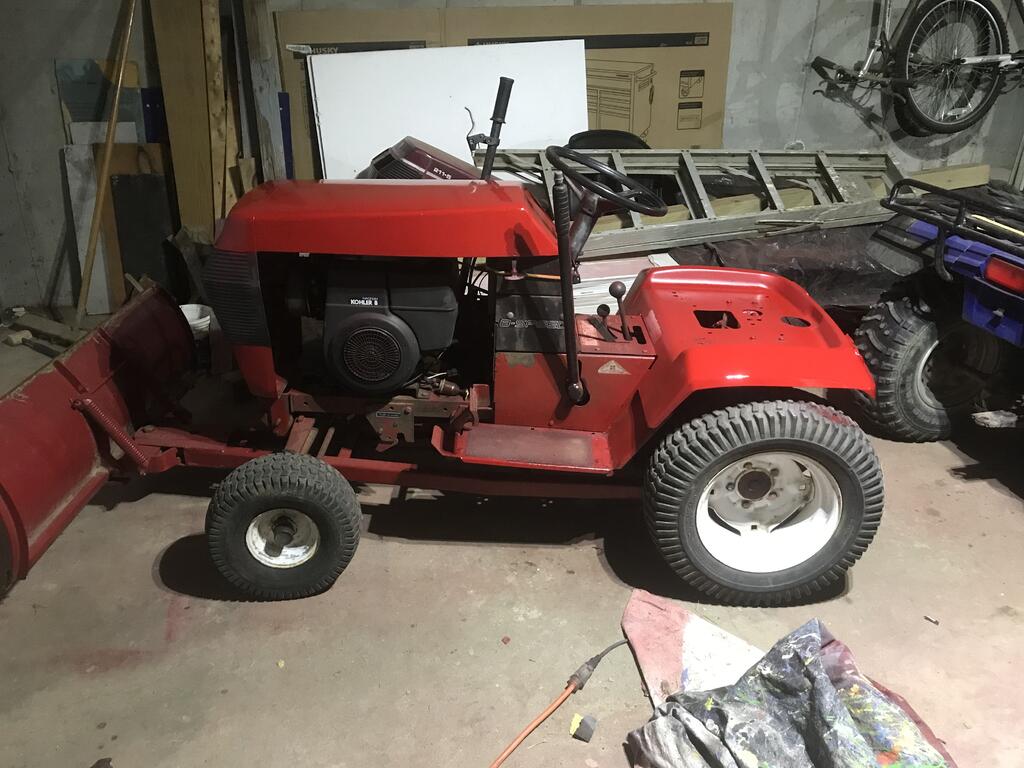

MainelyWheelhorse 3,044 #22165 Posted October 21, 2024 More work on the 308 after work. It’s a good 10 foot IH Red paint job, The tractor is a worker and was pretty rough to start with. I’m going to take off the panel on the side with the lift lever to paint as it has small stuff to mask off. 6 1 Share this post Link to post Share on other sites

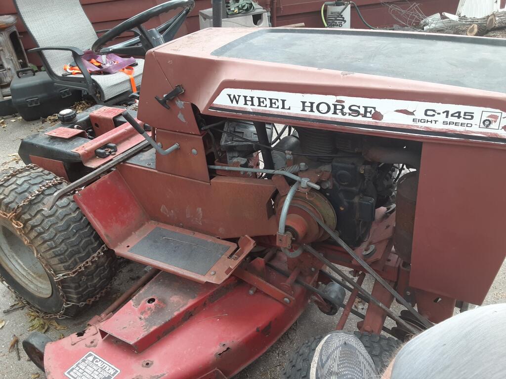

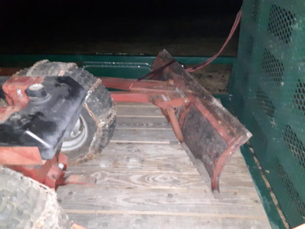

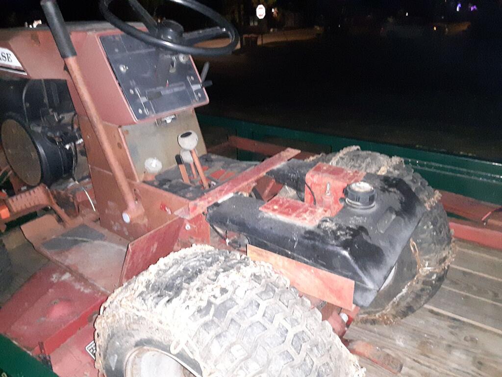

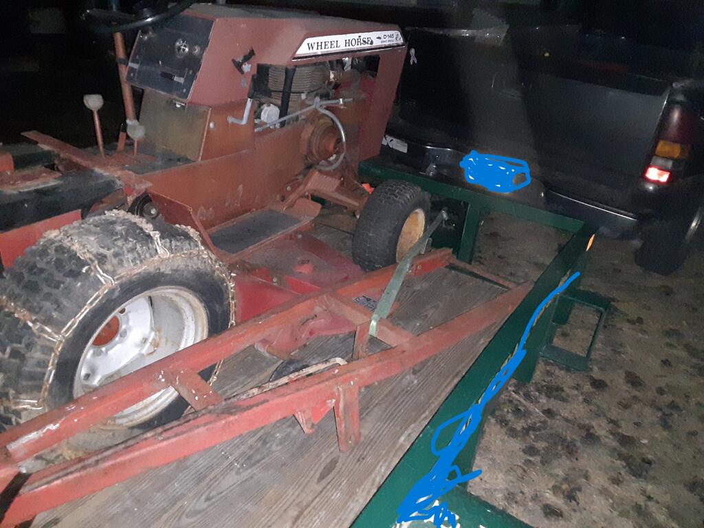

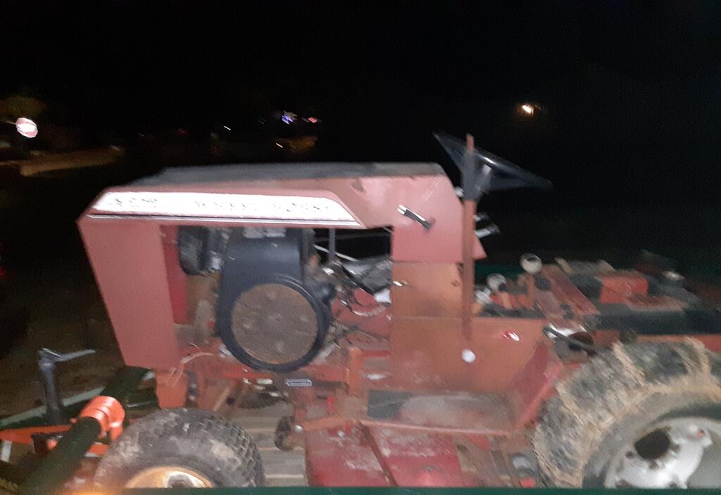

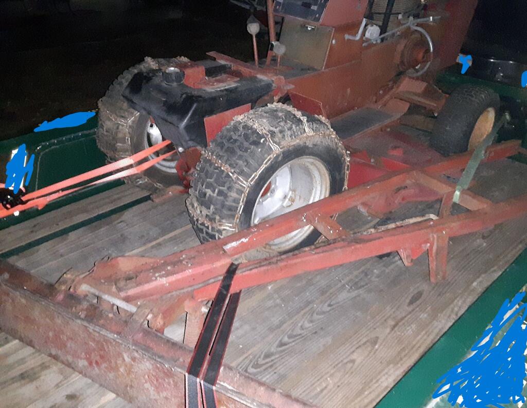

BBQVultureWings 160 #22166 Posted October 21, 2024 (edited) Well, Just got home from a road trip to pick up this 1980 C-145 with a deck & snow blade. The guy said he paid $100 to have a shop diagnose it & it needs a tuneup.... points & condenser,,,the P.O. was really sad to see it go & funny thing was, he actually said this, " send me pictures as you get it going again & I will probably by it back from ya..." little does he know that's probably Never gonna happen because 1 I really do Not want to sell 1 of these to someone who has No Idea how to take care of & or repair it. These are a piece of History much like classic cars but another realm.... 2 I doubt he will like the new Price when I am done nursing it back to health & the amount of time & labor involved to do anything like this weather it's a '69 Mustang or a 45 year old lawn mower.... & to those of us who Know, this aint just some old lawnmower. ok.... stepping off the soapbox now.... The Tune Up Should be easy enough as I was raised on that system. Gonna order that & a few other things tonight, The 257-H will get attention tomorrow. I am super stoked to have found this smokin' deal... the blade needs a few pieces of the necessary hardware but that won't hold Moo-Wah back.... The fender & seat are in the back of the truck. I didn't know the fender was plastic but ok maybe I can find a steel 1 somewhere.... the seat yeah that's gonna get replaced with a really nice 1 at some point. Just super happy to have another & a start on my "herd". Here are some pictures for All enjoy as well. More tomorrow.... Edited October 21, 2024 by BBQVultureWings 1 5 Share this post Link to post Share on other sites

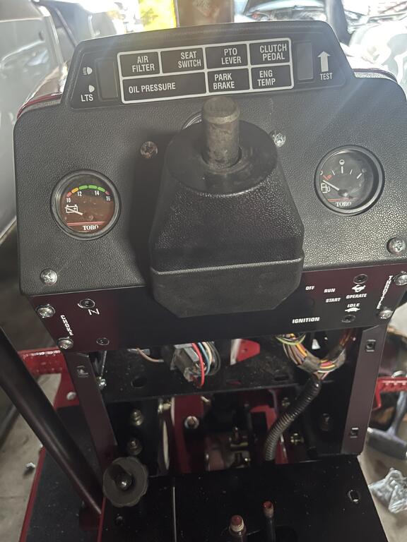

Desko 686 #22167 Posted October 21, 2024 Been working here and there on my 520-8 restoration and I had brand new stewart warner gauges but I guess they weren’t very good at cutting the holes out at the factory lol so I ended up buying used 520H gauges because they obviously combated the issue with a small diameter face ring. I toyed with the idea of cutting the holes out slightly larger to fit them properly but from the best I can find put the bezel is pretty much specific to the 520-8 so I don’t want to mess it up. I thought about a 518H bezel but the collar around the steering shaft is totally different where as this one uses a bolt on style much like the 520H 1 1 Share this post Link to post Share on other sites

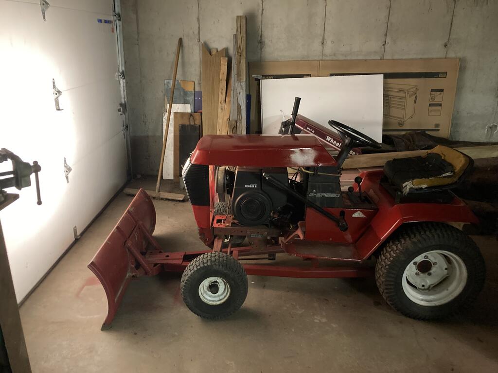

MainelyWheelhorse 3,044 #22170 Posted October 22, 2024 (edited) Today on Wheelhorse corner… the painting is done for now. There’s new LED headlights on the 308 and I painted the guards for the 42”RD deck on the 312. The paint on the guards was peeling off. It’s not pretty, but I plan on going through the deck and fixing issues this winter. Edited October 22, 2024 by MainelyWheelhorse 6 1 Share this post Link to post Share on other sites

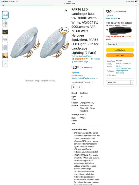

BBQVultureWings 160 #22171 Posted October 23, 2024 26 minutes ago, MainelyWheelhorse said: Today on Wheelhorse corner… the painting is done for now. There’s new LED headlights on the 308 and I painted the guards for the 42”RD deck on the 312. The paint on the guards was peeling off. It’s not pretty, but I plan on going through the deck and fixing issues this winter. Where did ya get the LED lights? How Much were they? Looks nice & Bright!! 1 Share this post Link to post Share on other sites
MainelyWheelhorse 3,044 #22172 Posted October 23, 2024 (edited) @BBQVultureWings Amazon, I did a search for PAR 36 landscaping lights. I tried to get the cheapest ones with the best reviews I could. The ones I got were a two pack and a little over $22 with tax and prime shipping. Edited October 23, 2024 by MainelyWheelhorse 3 Share this post Link to post Share on other sites
peter lena 10,016 #22173 Posted October 23, 2024 @BBQVultureWings as with any electrical improvement , would get some CONTRACTORS 3/8 electrical bolt on wire lugs , go from battery wire ground point , cleaned / dielectric enhanced to insure frame connection , then add a separate ground wire to your lighting , DO NOT COUNT ON EXISTING GROUND POINTS , that also replies to ENGINE COOLING TINS , known for rusty screw down points , like an ALLEGATOR CLIP ON TEST WIRE TO VERIFY AS i GO , INSURING / POWER / GROUND POINTS . have those LED lights on my stuff , tail lights too ,very bright , also very little amp draw , just as it should be , pete 2 Share this post Link to post Share on other sites
BBQVultureWings 160 #22174 Posted October 23, 2024 5 hours ago, peter lena said: @BBQVultureWings as with any electrical improvement , would get some CONTRACTORS 3/8 electrical bolt on wire lugs , go from battery wire ground point , cleaned / dielectric enhanced to insure frame connection , then add a separate ground wire to your lighting , DO NOT COUNT ON EXISTING GROUND POINTS , that also replies to ENGINE COOLING TINS , known for rusty screw down points , like an ALLEGATOR CLIP ON TEST WIRE TO VERIFY AS i GO , INSURING / POWER / GROUND POINTS . have those LED lights on my stuff , tail lights too ,very bright , also very little amp draw , just as it should be , pete Not a bad idea.... Retired Electrician here. I did Primarily Inndustrial Process control work as well as Some commercial & the dreaded residential wiring (dreaded as it is really pretty boring repetitive work mostly lights, light switches & plugs....) I don't have too much trouble with electrical systems & I Certainly do Not know Everything either as there is Always something else to learn... I haven't decided what all accessories or improvements will be added but I like the LEDs because they draw very little current & at 12V DC it can get to be an issue really fast with resistive loads like lights but the LED improvements in recent years have nearly eliminated that problem. By the way I would use NoAlox anti corrosion compound such as Ideal 30-030 or equivalent Rather than dielectric grease Thanks for the suggestion. 1 1 Share this post Link to post Share on other sites
