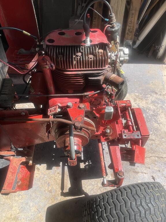

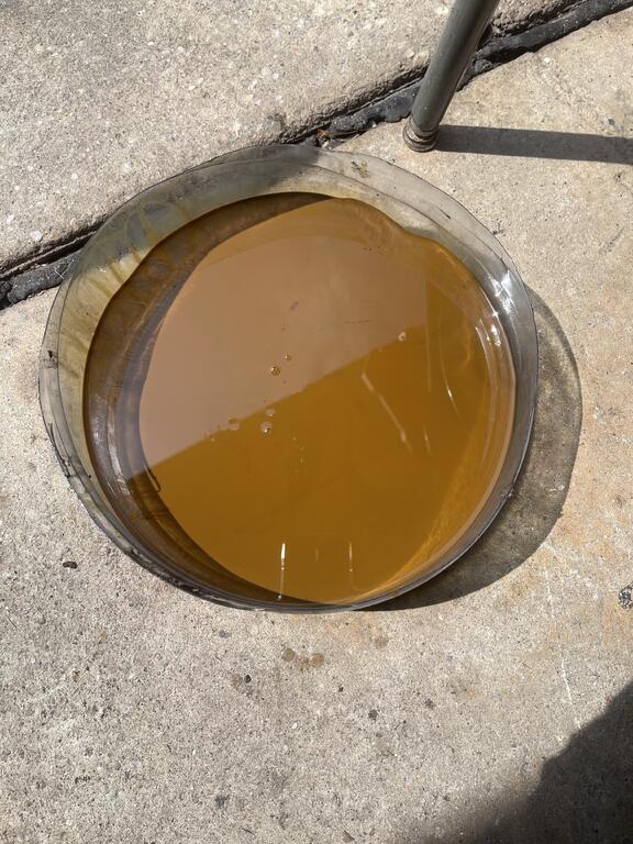

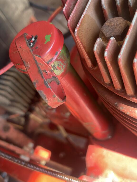

Wheelhorse#1 1,997 #21978 Posted September 4, 2024 Spent some time going through the recently purchased c-101 8 . Drained trans, and a half gallon of water drained out before the gear oil. Went over the k241 and got it running ,needs some maint items one being shaker plate mounts but runs great 👍 Is that the dreaded green paint of a JD I see 3 2 Share this post Link to post Share on other sites

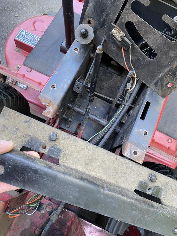

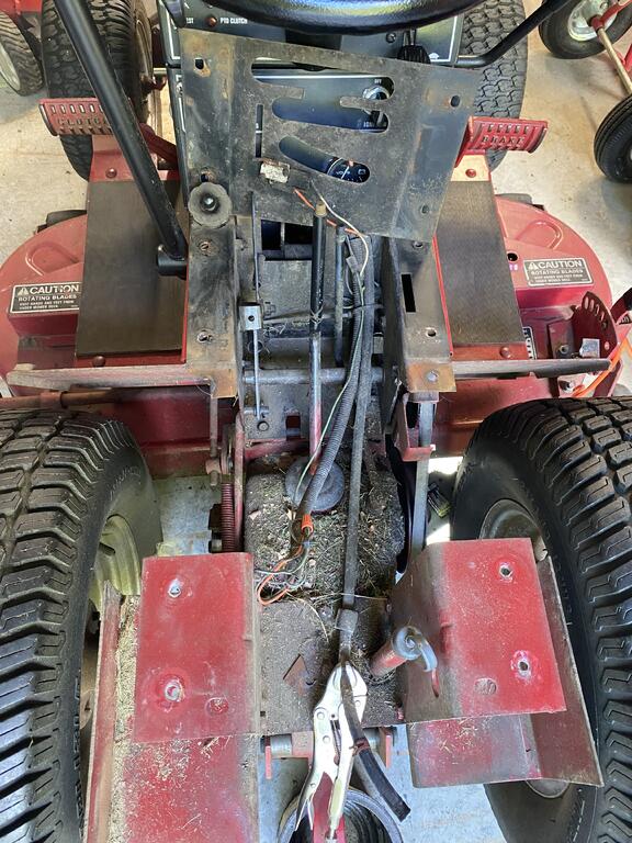

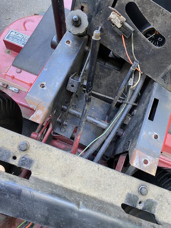

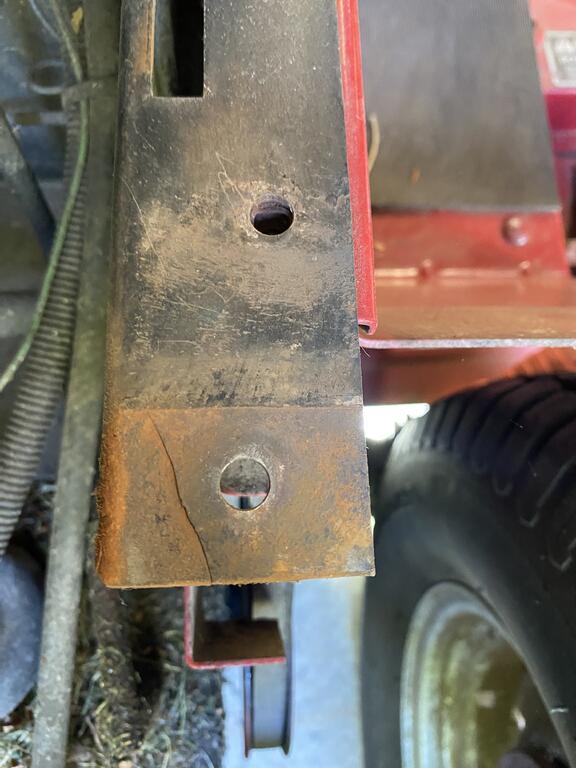

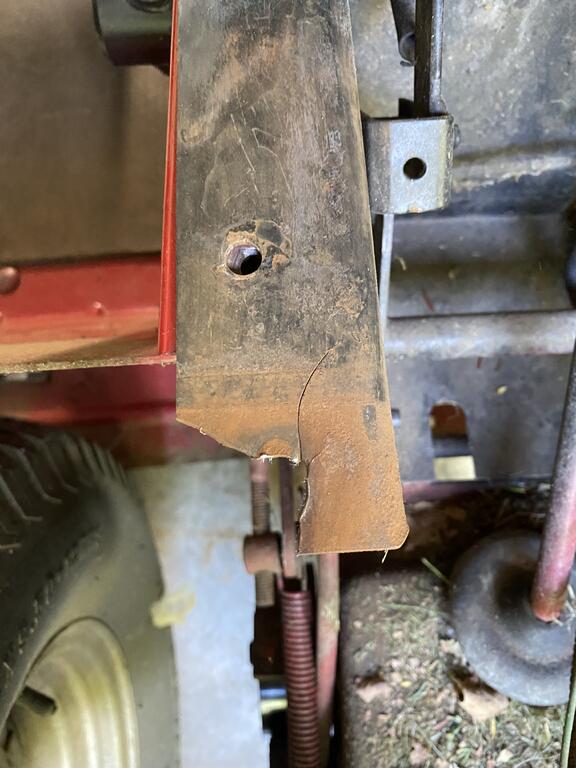

Sparky-(Admin) 26,478 #21987 Posted September 4, 2024 Discovered this “weak spot” has let go on my 414-8 today. One side is cracked and the other is busted with a chunk out. 1 1 Share this post Link to post Share on other sites
953 nut 69,719 #21988 Posted September 4, 2024 17 minutes ago, Sparky said: “weak spot” has let go on my 414-8 today. One side is cracked and the other is busted with a chunk out. Had that problem on my 418-c, solved it by buying a fender support from a 520. 1 2 Share this post Link to post Share on other sites
Handy Don 17,540 #21989 Posted September 5, 2024 1 hour ago, Sparky said: Discovered this “weak spot” has let go on my 414-8 today. I might have one of those off a 500. I’ll look tomorrow. 1 Share this post Link to post Share on other sites
ebinmaine 80,866 #21990 Posted September 5, 2024 1 hour ago, Sparky said: Discovered this “weak spot” has let go on my 414-8 today. One side is cracked and the other is busted with a chunk out. We helped that on the Workhorse by adding BIG fender washers. 2 Share this post Link to post Share on other sites

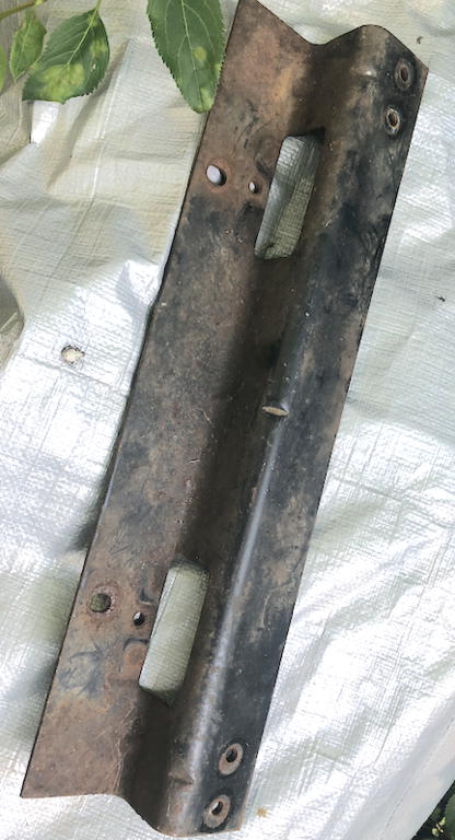

Handy Don 17,540 #21994 Posted September 5, 2024 15 hours ago, Handy Don said: I might have one of those off a 500. I’ll look tomorrow. @Sparky Found this in my pile this morning. I could bring it to @JCM’s M&G? Share this post Link to post Share on other sites

Sparky-(Admin) 26,478 #21996 Posted September 5, 2024 3 hours ago, Handy Don said: @Sparky Found this in my pile this morning. I could bring it to @JCM’s M&G? Thanks Don, I have that part and it’s fine. It’s the two rails that it bolts to that have cracked/rusted and broken. 1 1 Share this post Link to post Share on other sites
lynnmor 9,049 #21997 Posted September 5, 2024 21 hours ago, 953 nut said: Had that problem on my 418-c, solved it by buying a fender support from a 520. Note that the 520 part uses the two console cover screws in addition to the current ones. The cover on console cover on the 520's have a jog in them to allow for the additional height, washers or spacers will be needed. I had the same breakage on my 1991 520H because it was made before the update. I think that the 520C models had the improvement and all 520's made from 1992 and up had the update. For my 1991 I bought both the updated seat support and the console cover plus I added reinforcement under the break after it was welded. 4 2 Share this post Link to post Share on other sites

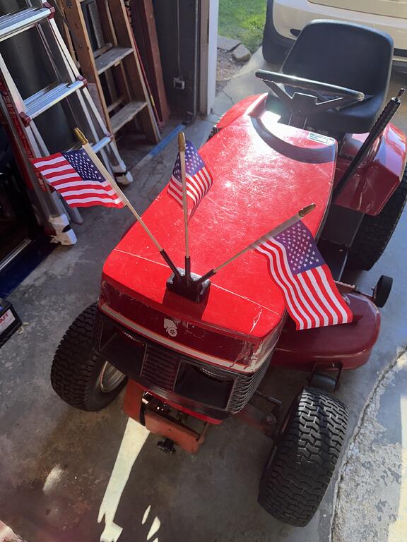

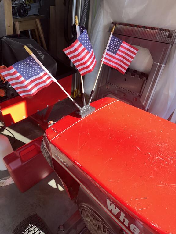

Steve Janninck 172 #21999 Posted September 7, 2024 Working on a little magnetic flag holder for the 414-8 hood. A few more tweaks and I think this will work perfectly! 10 1 Share this post Link to post Share on other sites

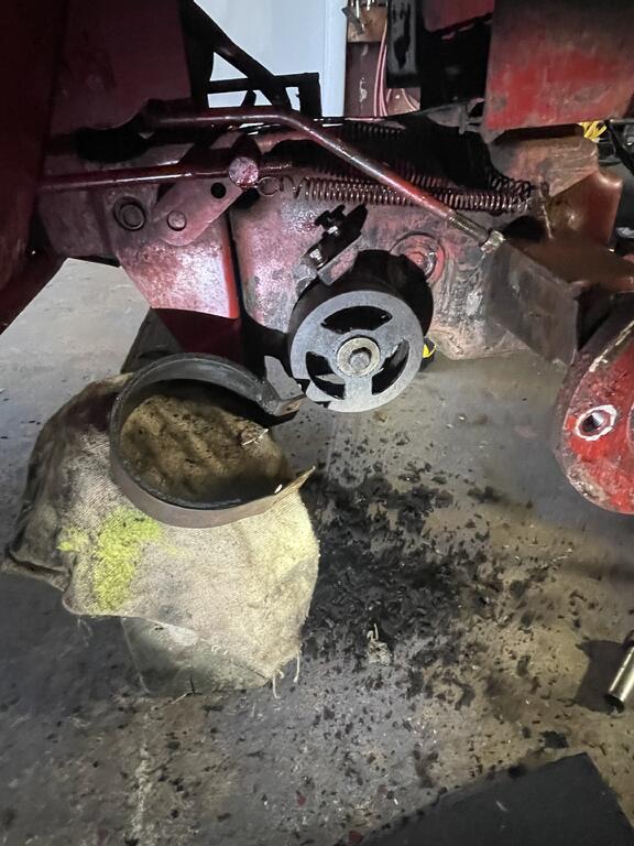

Wheelhorse#1 1,997 #22000 Posted September 8, 2024 Breaking down the new to me C-101 .Flushed the gear case with diesel twice .Removed break band ,needs to be replaced. Tomorrow the rest comes apart.The fun has just begun 5 1 Share this post Link to post Share on other sites
