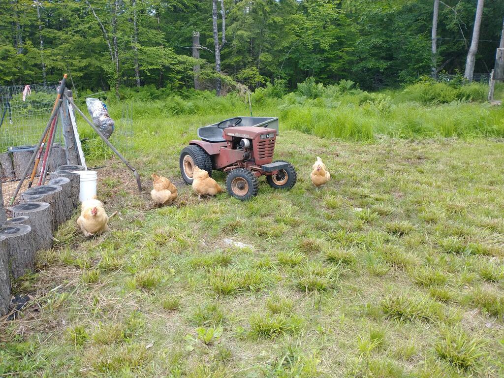

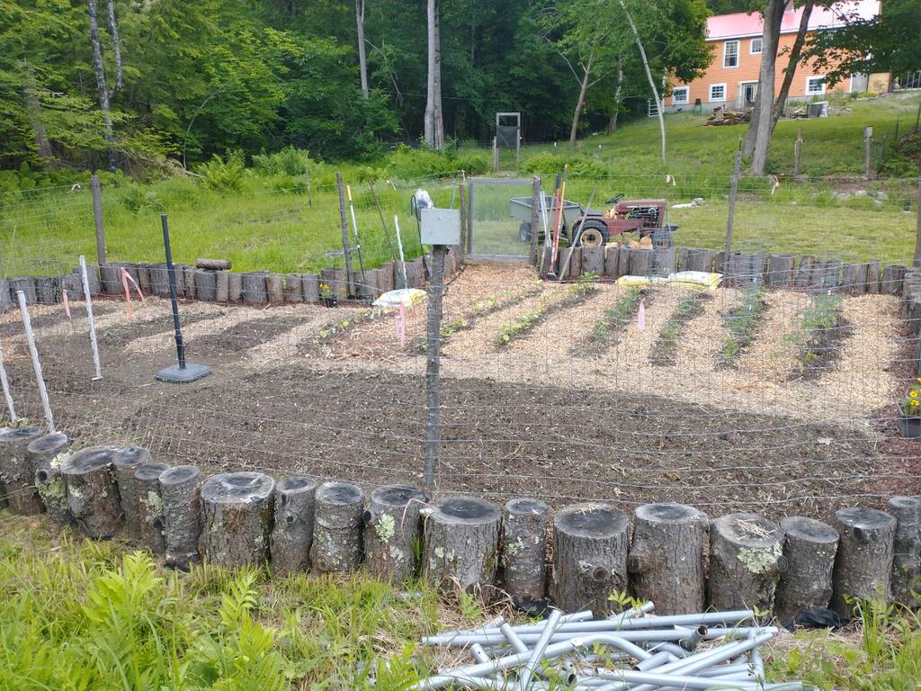

ebinmaine 80,878 #21520 Posted June 9, 2024 This afternoon Trina moved a trailer full of our own home made mulch to the garden. The chickens were out there to help. 8 4 1 Share this post Link to post Share on other sites

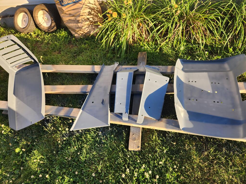

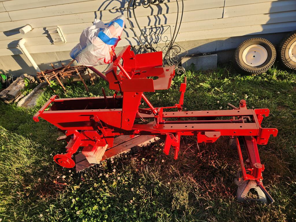

Goldnboy 1,154 #21521 Posted June 10, 2024 Did some painting yesterday! I used the new high flow setting on cans that have choice of 5 settings. Plus I painted the fronts too. And put primer on the tins.. Going to let in bake in the 90s several days this week. 8 1 Share this post Link to post Share on other sites
squonk 48,207 #21522 Posted June 10, 2024 52 minutes ago, Goldnboy said: Did some painting yesterday! I used the new high flow setting on cans that have choice of 5 settings. Plus I painted the fronts too. And put primer on the tins.. Going to let in bake in the 90s several days this week. You could have sprayed Chrystal Clear right over the last coat of red while it was still wet. Dries fast and retains the shine 2 Share this post Link to post Share on other sites
Goldnboy 1,154 #21523 Posted June 10, 2024 44 minutes ago, squonk said: You could have sprayed Chrystal Clear right over the last coat of red while it was still wet. Dries fast and retains the shine Last time I tried a clear coat the paint wrinkled on me! 1 Share this post Link to post Share on other sites
squonk 48,207 #21524 Posted June 10, 2024 I've sprayed dozens of items with Rustoleum Regal Red and sprayed the clear right over the wet final coat. Never an issue. 4 3 Share this post Link to post Share on other sites
