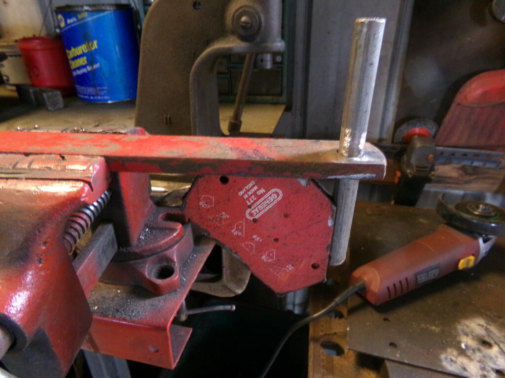

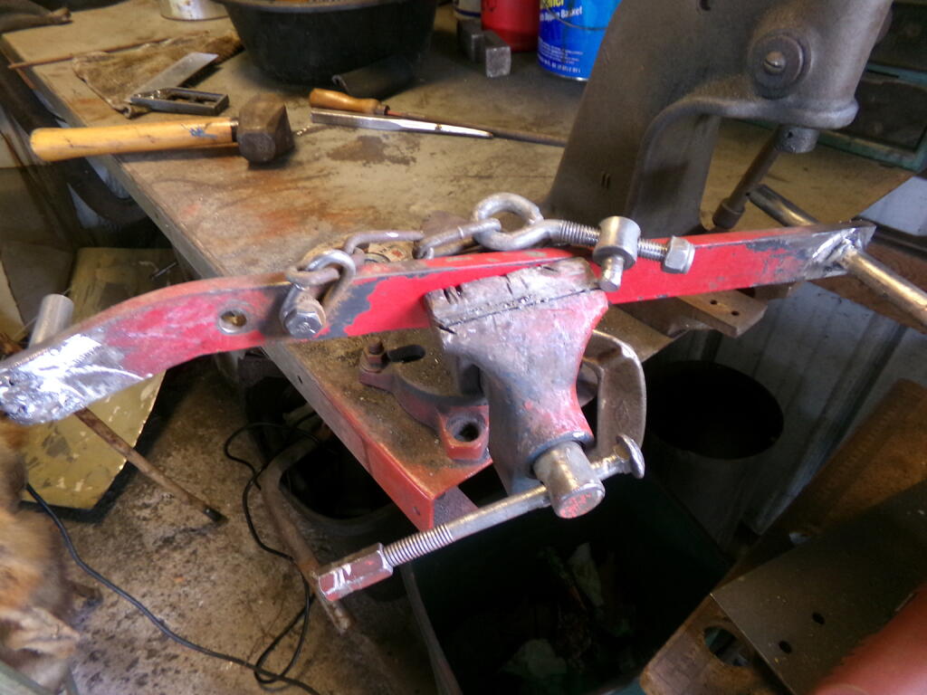

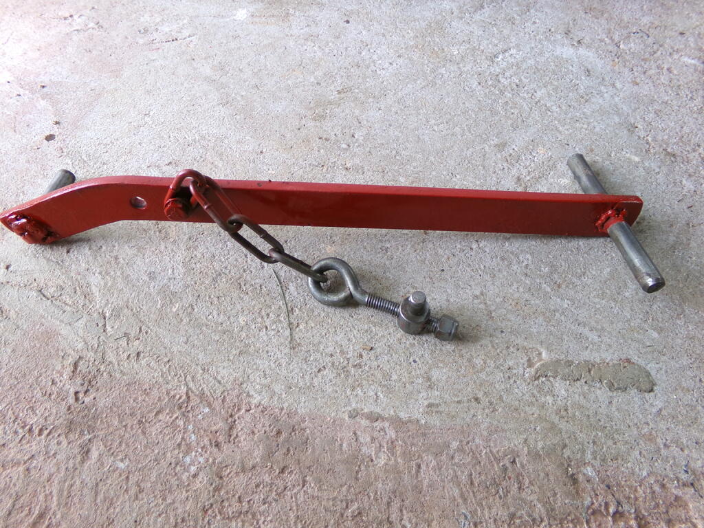

Ed Kennell 46,608 #21479 Posted June 6, 2024 Rebuilt a deck lift bar. Replaced the broken rear support rod and the front rod that was worn flat. Straightened the bent eye bolt and rethreaded the eye bolt and trunnion. Yeah I know, the my welds won't pass xray tests, but like my tractors, they work. 5 7 Share this post Link to post Share on other sites
kpinnc 18,756 #21480 Posted June 6, 2024 50 minutes ago, Ed Kennell said: my welds won't pass xray Looks great from here! If my welds had to pass xray inspection, none of my work would be worth mentioning... 7 Share this post Link to post Share on other sites
Handy Don 16,961 #21481 Posted June 6, 2024 (edited) 1 hour ago, Ed Kennell said: Yeah I know, the my welds won't pass xray tests, but like my tractors, they work. I'm not shy about grinding them smooth it they have a little too much weld. Nice work, overall! (but I’m VERY surprised you didn’t have one of those in a bucket somewhere!) Edited June 6, 2024 by Handy Don 4 1 Share this post Link to post Share on other sites
Ed Kennell 46,608 #21482 Posted June 6, 2024 8 minutes ago, Handy Don said: didn’t have one of those in a bucket You guys bought all my good ones and left me with this junker. Now I have a good spare. 3 3 Share this post Link to post Share on other sites

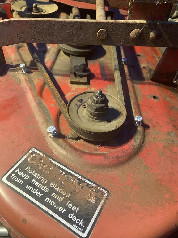

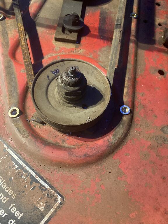

PWL216 1,235 #21483 Posted June 6, 2024 I had to take the pulley covers off of one of my decks. I got tired of having to reach underneath to do it. So I installed rivnuts. I bought the tool probably six months ago and this is the first time I’ve used it. Works great. 6 4 Share this post Link to post Share on other sites

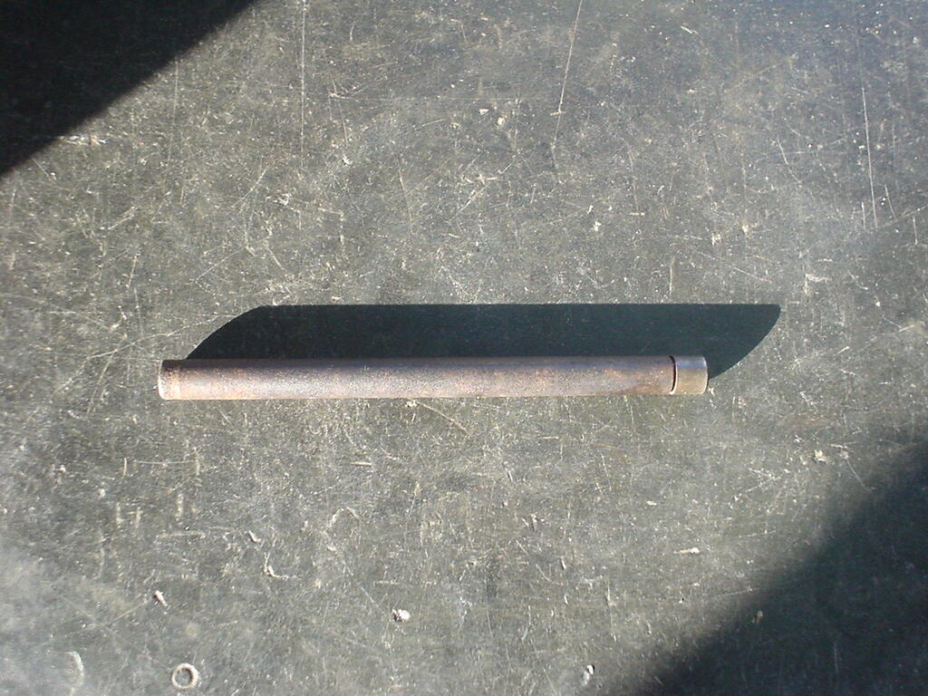

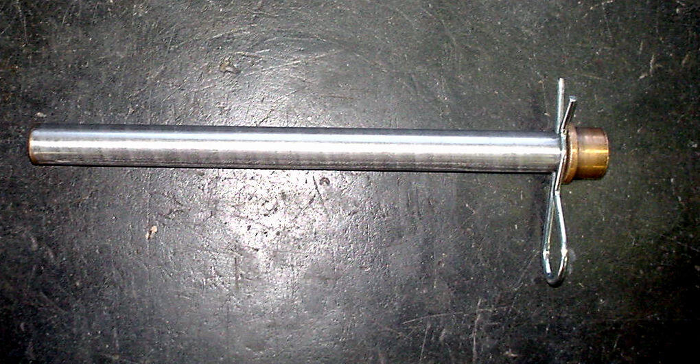

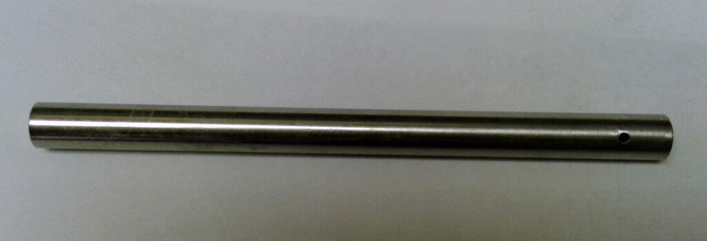

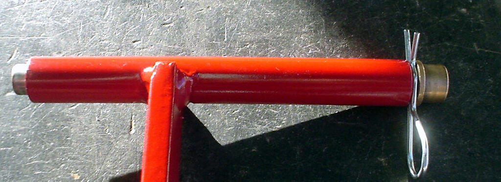

cleat 9,054 #21485 Posted June 6, 2024 (edited) 5 hours ago, Ed Kennell said: Rebuilt a deck lift bar. Replaced the broken rear support rod and the front rod that was worn flat. Straightened the bent eye bolt and rethreaded the eye bolt and trunnion. Yeah I know, the my welds won't pass xray tests, but like my tractors, they work. Great job rebuilding that bar. How is the rod retained in the frame ? When I replace that rod I drill a hole where the E clip groove is on the factory one and use a cotter pin to retain it. This is the heavy duty version but retention is the same. I also drill the front pin for the clip to prevent the bar from destroying the center spindle Grease fitting. Edited June 6, 2024 by cleat 3 4 Share this post Link to post Share on other sites

Handy Don 16,961 #21487 Posted June 6, 2024 (edited) 31 minutes ago, cleat said: How is the rod retained in the frame ? You slide the bushing (flange end first) onto the left end of the shaft about 2”. Put the left end to the shaft into the hole in the frame on the left side and then the right end into the pocket in the frame on the right side. Then slide the bushing into the left hole to hold the shaft. Add the e-clip to hold the bushing and shaft in place. Edited June 6, 2024 by Handy Don 1 Share this post Link to post Share on other sites
squonk 47,420 #21488 Posted June 6, 2024 4 hours ago, Ed Kennell said: Rebuilt a deck lift bar. Replaced the broken rear support rod and the front rod that was worn flat. Straightened the bent eye bolt and rethreaded the eye bolt and trunnion. Yeah I know, the my welds won't pass xray tests, but like my tractors, they work. I would have liked to see that eye bolt before straightening. I got one on my C-160 that looks like a pretzel. The power of hydraulics! 3 Share this post Link to post Share on other sites
cleat 9,054 #21489 Posted June 6, 2024 25 minutes ago, Handy Don said: You slide the bushing (flange end first) onto the left end of the shaft about 2”. Put the left end to the shaft into the hole in the frame on the left side and then the right end into the pocket in the frame on the right side. Then slide the bushing into the left hole to hold the shaft. Add the e-clip to hold the bushing and shaft in place. Yes that is how it goes with a factory made bar but with a home made pin that does not have a groove for an e-clip is where a simple drilled hole and cotter pin works well. 2 Share this post Link to post Share on other sites
Handy Don 16,961 #21490 Posted June 6, 2024 (edited) 6 minutes ago, cleat said: Yes that is how it goes with a factory made bar but with a home made pin that does not have a groove for an e-clip is where a simple drilled hole and cotter pin works well. Excellent point, I always thought the e-clip, bushing, pocket scheme was extremely clever engineering. Easy to assemble during manufacture since it could be done from the underside without needing access to the outside at all! Edited June 6, 2024 by Handy Don 2 Share this post Link to post Share on other sites

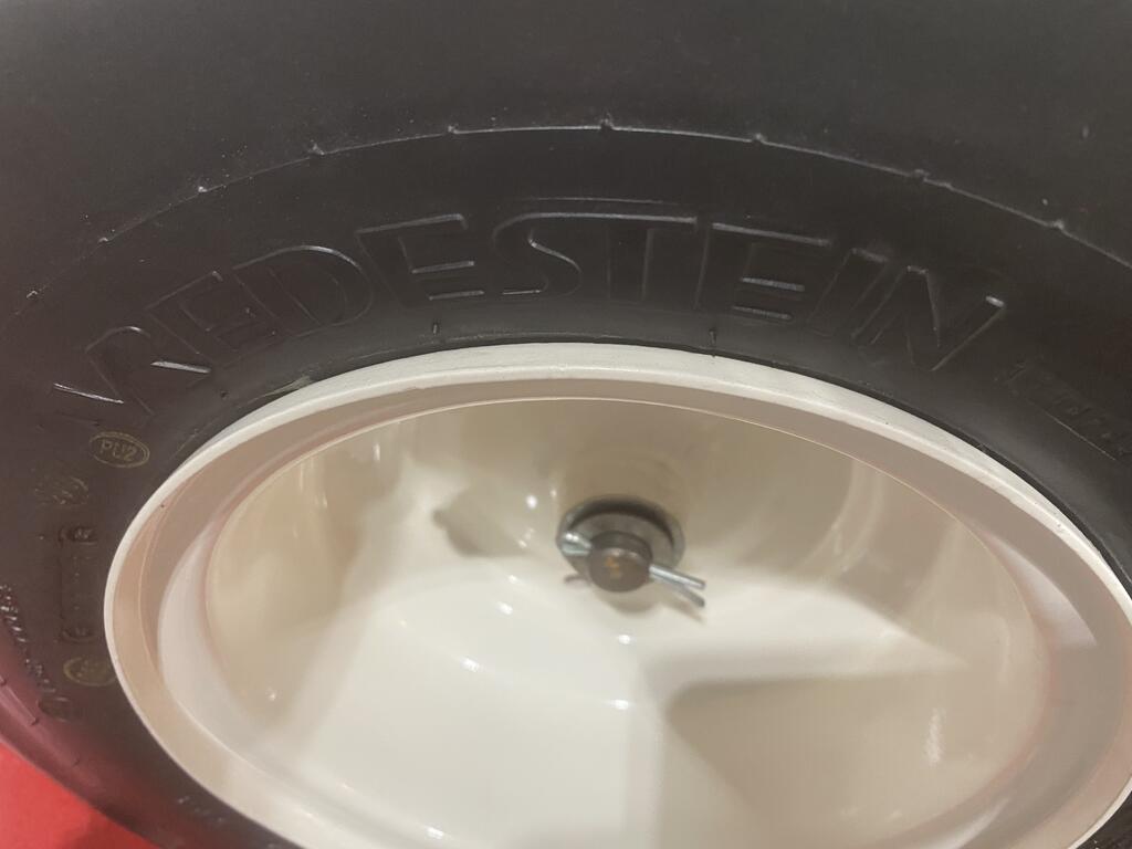

TonyToro Jr. 2,509 #21492 Posted June 7, 2024 21 hours ago, c-series don said: Finally completed my C-175 restoration tonight, when it’s light out I’ll take it outside for some better pictures. I’m super happy with the way it turned out and really have to thank my brother for all his help! I will be bringing it to the show as it is this year’s featured tractor. If you don’t mind me asking, What brand and size are those front tri ribs? I really like that look. I’m thinking of doing something like that for a C-161 twin I’m restoring. 1 Share this post Link to post Share on other sites
c-series don 12,139 #21493 Posted June 7, 2024 5 rib 16x6.50-8 3 1 1 Share this post Link to post Share on other sites
