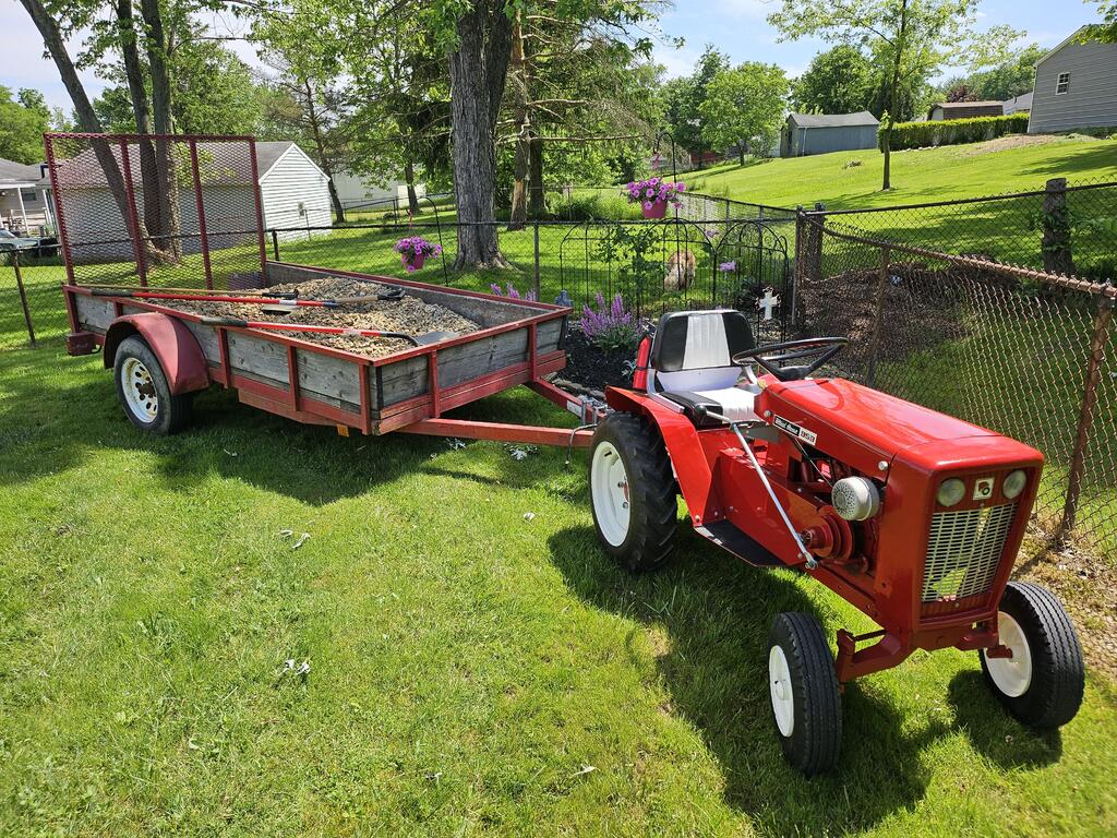

ML3 2,533 #21406 Posted May 23, 2024 Spreading some #57 crushed riverstone in prayer garden for my girlfriend. Also putting it a few other places in yard. Started with 1 ton of stone. The 953 pulled all that weight without too much trouble. Front end was a little light when I was loaded full & going uphill into backyard. Probably gotta get at least another ton tomorrow. 11 7 Share this post Link to post Share on other sites

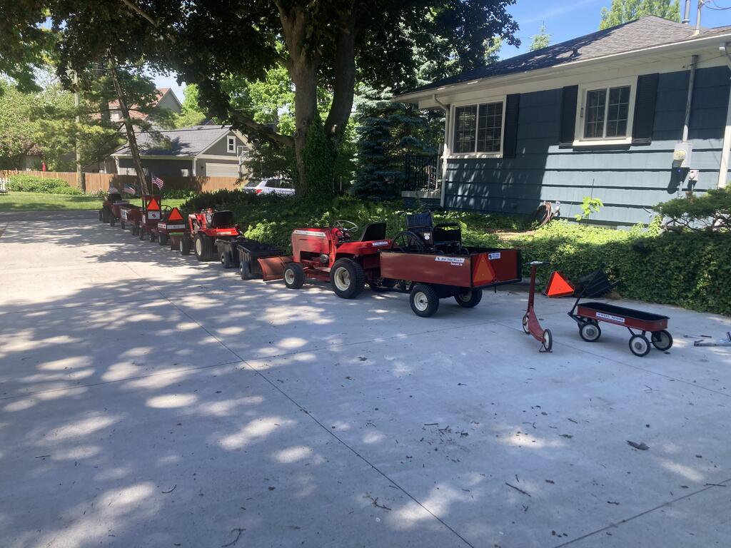

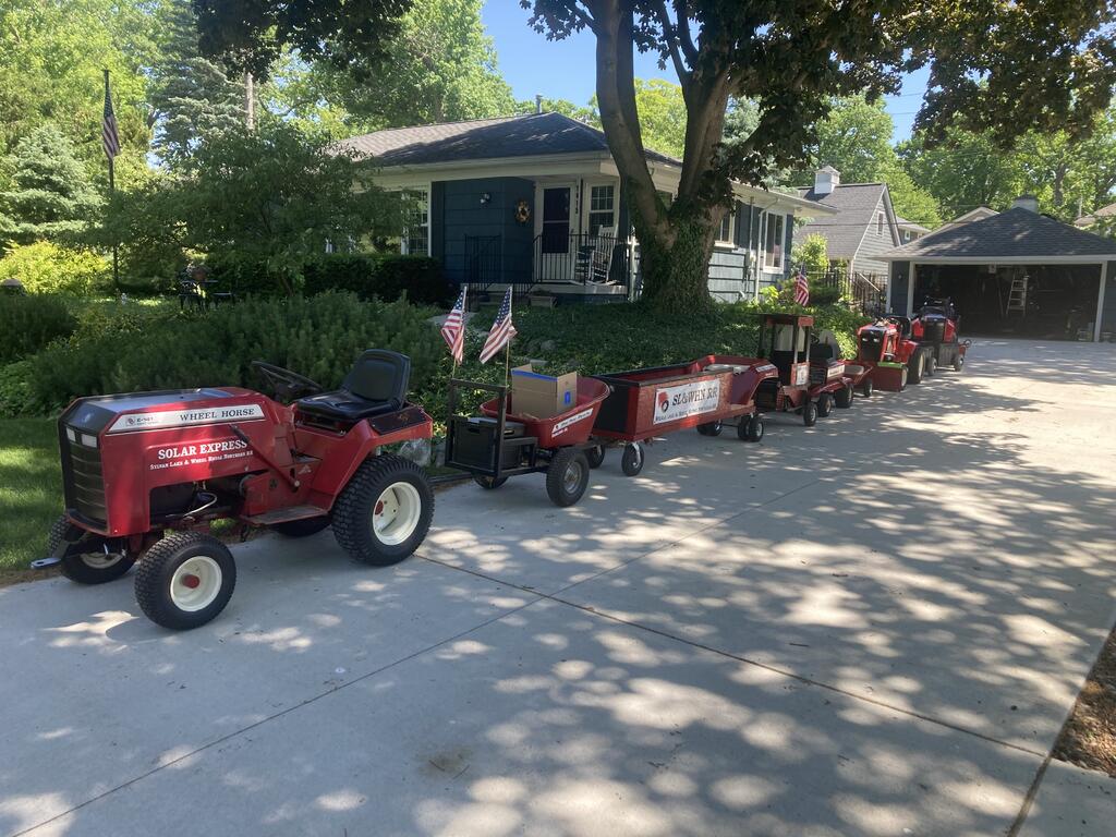

SylvanLakeWH 32,685 #21415 Posted May 24, 2024 Got ready for the Memorial Day Parade!!! Only one flat tire... not bad for this rig...!!! All set for 15 little riders... including one wheelchair... 5 3 6 Share this post Link to post Share on other sites

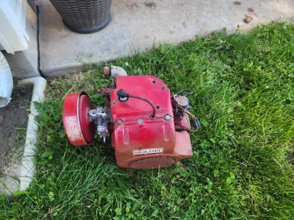

Goldnboy 1,154 #21416 Posted May 25, 2024 Removed all the sheet metal and that...that tecky! M12 has been painted and is drying... Noticed I need new clutch sprung #1014 not sure source to locate... 1 Share this post Link to post Share on other sites
ebinmaine 80,878 #21417 Posted May 25, 2024 58 minutes ago, Goldnboy said: Removed all the sheet metal and that...that tecky! M12 has been painted and is drying... Noticed I need new clutch sprung #1014 not sure source to locate... If this is on a mid 70s C series that spring is a Toro 108035. Multiple sources on the interwebs. Should be able to get one for less than $15 shipped to your door. 1 1 Share this post Link to post Share on other sites
squonk 48,207 #21418 Posted May 25, 2024 (edited) 2 hours ago, Goldnboy said: Removed all the sheet metal and that...that tecky! M12 has been painted and is drying... Noticed I need new clutch sprung #1014 not sure source to locate... 1014 spring changed to 83-2730. Available on E bay or McMaster -Carr 9433k111 Edited May 25, 2024 by squonk 1 Share this post Link to post Share on other sites

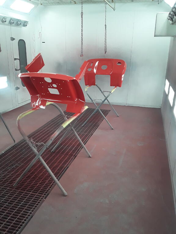

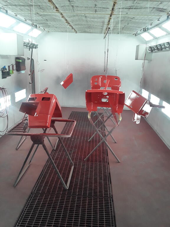

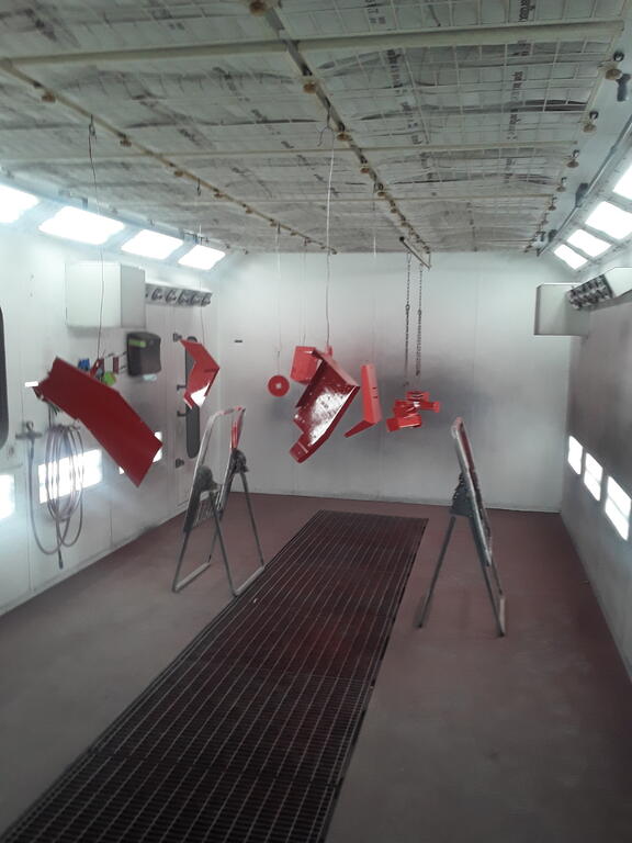

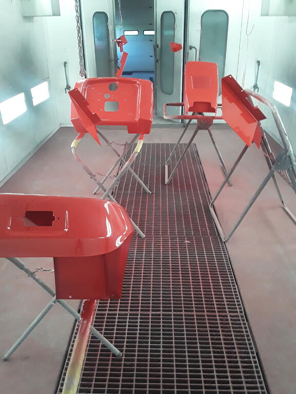

76c12091520h 4,290 #21420 Posted May 25, 2024 Spent my morning at the office: 2 12 Share this post Link to post Share on other sites
adsm08 5,186 #21421 Posted May 25, 2024 1 hour ago, 76c12091520h said: Spent my morning at the office: Brian, your office looks like more fun than my office. 3 1 Share this post Link to post Share on other sites

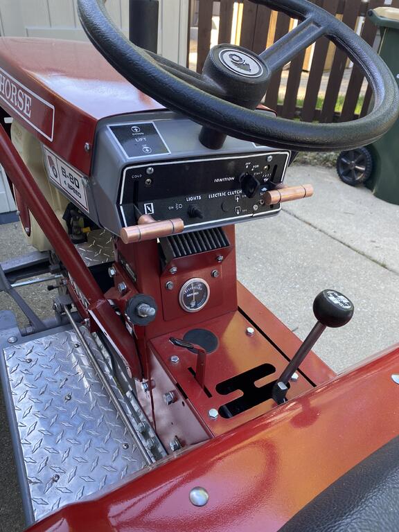

Heatingman 977 #21422 Posted May 25, 2024 Throttle and choke knobs broke on my B-80. Ordered some reproduction ones, in the mean time I made up some from some copper tee’s with a wood dowel fit into the bull of the tee’s. slotted the dowel to match the levers, and contact cemented them in place. I’ll see how they hold up. But they look pretty cool, if you ask me. 7 8 Share this post Link to post Share on other sites
adsm08 5,186 #21423 Posted May 25, 2024 20 minutes ago, Heatingman said: Throttle and choke knobs broke on my B-80. Ordered some reproduction ones, in the mean time I made up some from some copper tee’s with a wood dowel fit into the bull of the tee’s. slotted the dowel to match the levers, and contact cemented them in place. I’ll see how they hold up. But they look pretty cool, if you ask me. I think I'd keep those if they hold up. 4 Share this post Link to post Share on other sites
ebinmaine 80,878 #21424 Posted May 25, 2024 14 minutes ago, adsm08 said: I think I'd keep those if they hold up. Agreed. I like em. 2 Share this post Link to post Share on other sites
cleat 9,380 #21425 Posted May 25, 2024 1 hour ago, Heatingman said: Throttle and choke knobs broke on my B-80. Ordered some reproduction ones, in the mean time I made up some from some copper tee’s with a wood dowel fit into the bull of the tee’s. slotted the dowel to match the levers, and contact cemented them in place. I’ll see how they hold up. But they look pretty cool, if you ask me. Give them a coat of clear so they stay shiny. Or you could paint them black. Either way good job. 3 Share this post Link to post Share on other sites
