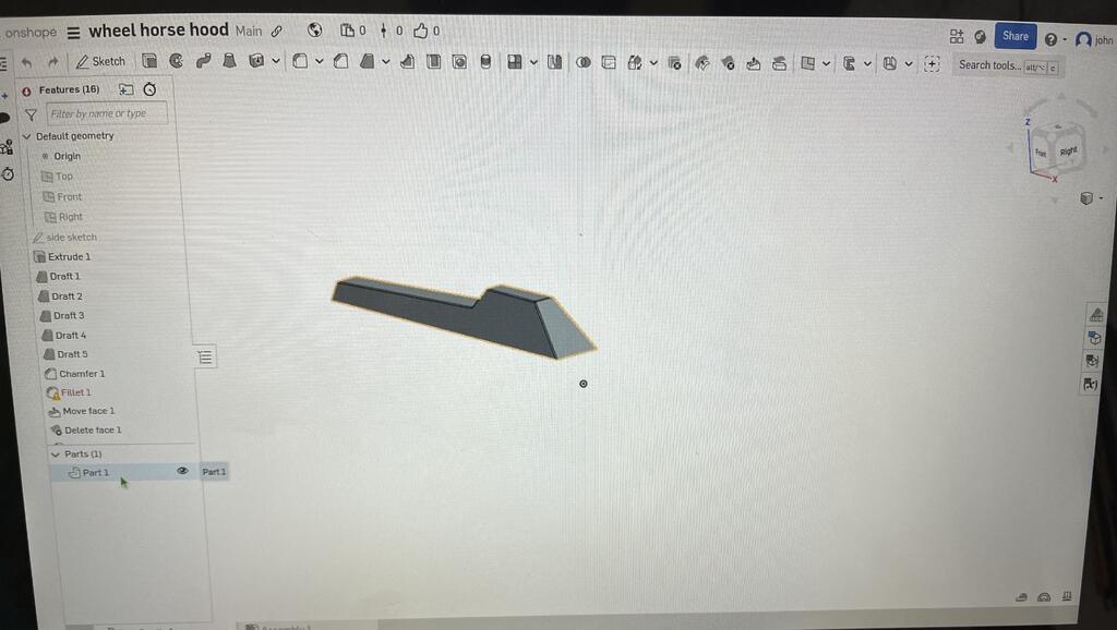

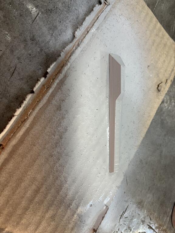

87 416-8 horse 430 #21308 Posted May 8, 2024 I wasn’t feeling the greatest today so instead of wasting a good day inside and doing nothing I decided to practice a bit of CAD. I designed up this hood ornament then sent it over to my 3d printer. Once it was done I sanded it and primed it. Next up is paint. 11 Share this post Link to post Share on other sites

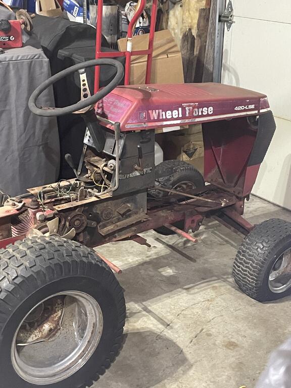

whtractors24 3,572 #21310 Posted May 9, 2024 Getting the 420 show ready 3 5 6 Share this post Link to post Share on other sites
Sodaking27 1,358 #21311 Posted May 10, 2024 On 5/9/2024 at 11:14 AM, whtractors24 said: Getting the 420 show ready I’ve got a long way to go before mine’s ready. 5 1 1 Share this post Link to post Share on other sites

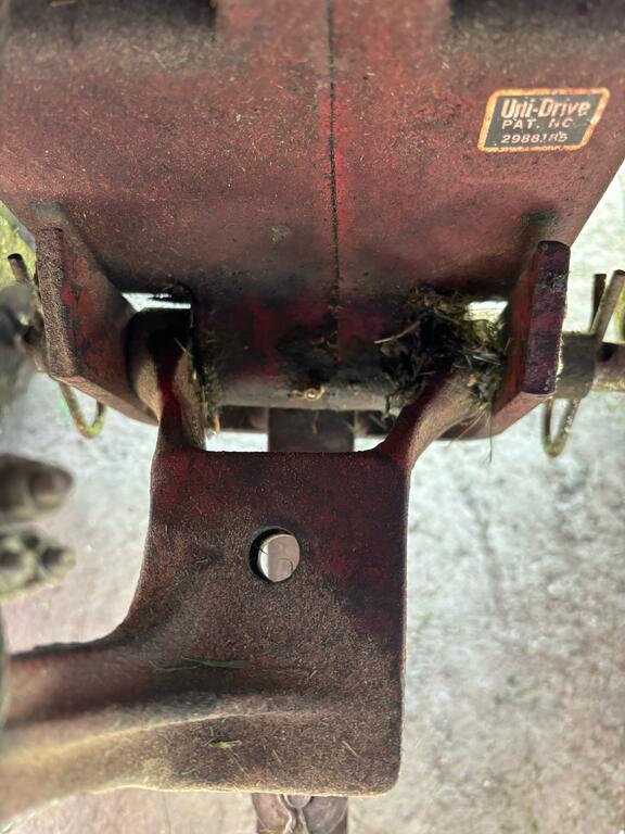

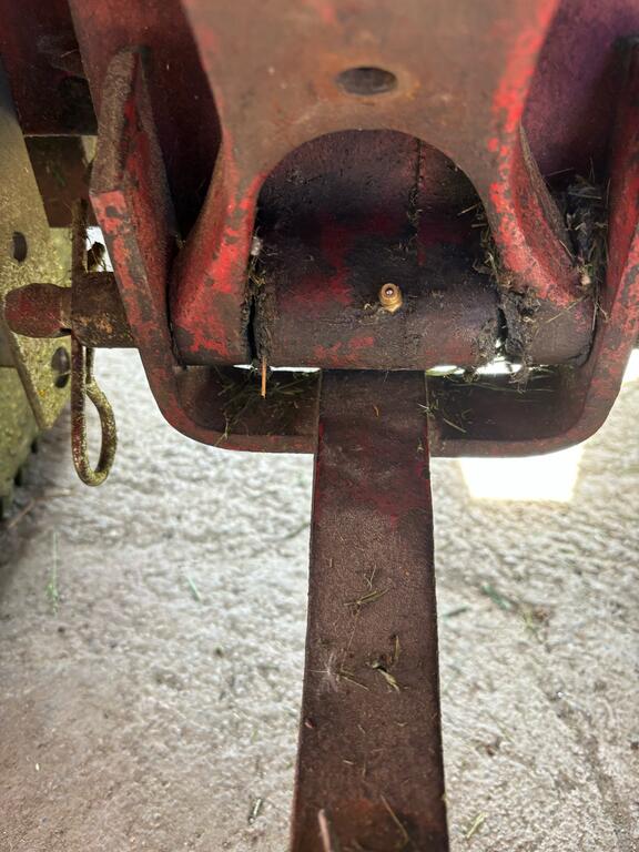

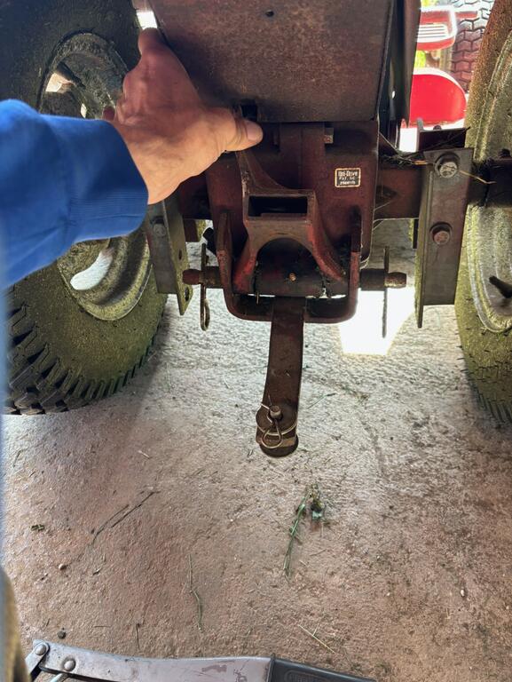

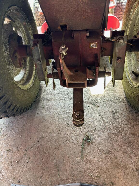

Tractorhead 9,217 #21313 Posted May 12, 2024 Because there was several issues with seized Hitch Bolts, that‘s the Way i prevent this.. Remove the old Bolt, drilled a 4,8mm hole into the Holder on the Gearbox. than i taped a thread in and at least i screwed a zerk fitting into that thread. Additionally i use an Standart 19mm Bolt we get here for Agri machinery fixed with 2 Clips. A great decision was the Angle of 48 degrees to fit easily with the Greasepump. Each time i do my regular Greasing routine i cleaned the zerk and refill it after with one pump of fresh grease. So it is even better covered with the hitch itself against rip up 8 7 Share this post Link to post Share on other sites

87 416-8 horse 430 #21315 Posted May 13, 2024 (edited) The hood ornament is painted and installed! I think It turned out pretty good for my first useful CAD design. Edited May 13, 2024 by 87 416-8 horse 5 4 Share this post Link to post Share on other sites
