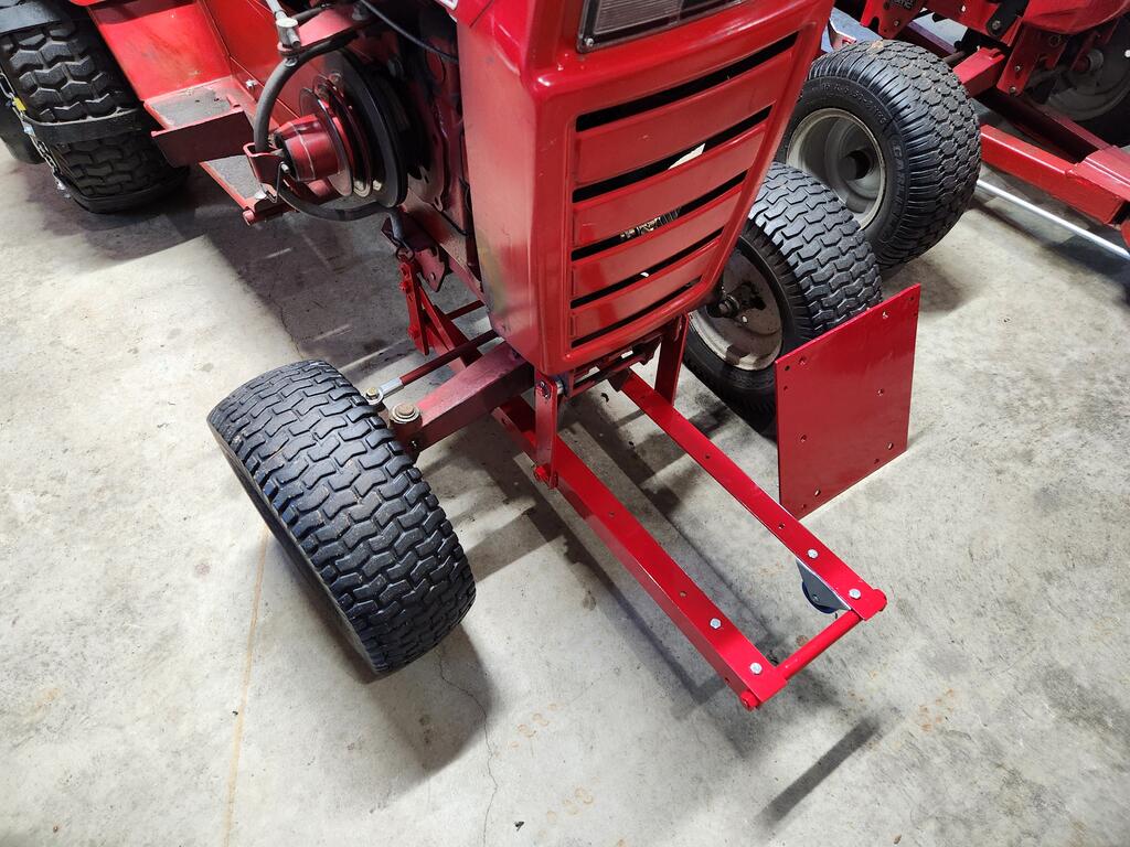

Racinbob 13,111 #21001 Posted March 17, 2024 For years I've been wanting to build a pto driven leaf blower but just never got too serious about it. I did have a blower in Florida but for some reason it stayed in the garage attic when we moved I've had my eyes peeled for another one but it's been more like if one stumbles in front of me I'll grab it. That hasn't happened yet. I decided to go ahead and rig up a frame to mount it. I made a couple modifications to a frame that I've had since the Big Show in 2018 and I'm sure @squonk will recognize it. The weather has been exceptionally warm recently so I had a chance to throw some paint on it. My wife asked me what it was for so I told her and she said 'you don't have a blower'. I said I WILL have one before the leaves fall again. With the frame complete and having options as to how I mount the blower I will be real serious about finding a blower now. BTW, the bar that fits up into the front mount is 5/8". I didn't have a rod that size and I was just going to get one when I happened across the original tie rods (worn out) for this very tractor. A couple of cuts, a 3/8"-24 rod coupling and a perfectly good 5/8" rod. 13 Share this post Link to post Share on other sites
squonk 47,887 #21002 Posted March 17, 2024 Whatever you do Bob, regulate the the speed at which it will turn and how much air flows thru it or it will blow apart like @87 416-8 horse blower did. These belt drive blowers are getting harder to come by with most home units going to direct drive years ago. Most of the ones you will find are well past their service life with rusted worn out vanes 3 Share this post Link to post Share on other sites
Racinbob 13,111 #21003 Posted March 17, 2024 13 minutes ago, squonk said: Whatever you do Bob, regulate the the speed at which it will turn and how much air flows thru it or it will blow apart like @87 416-8 horse blower did. These belt drive blowers are getting harder to come by with most home units going to direct drive years ago. Most of the ones you will find are well past their service life with rusted worn out vanes I was wondering about that Mike. The little research I've done seems to indicate about 17-1800 rpm. Right now I'm thinking size the pulley for running the engine wide open. Part of me was thinking sizing it for a lower rpm on the engine but sure enough I'd accidently rev it up too high. 1 Share this post Link to post Share on other sites
Lee1977 7,750 #21004 Posted March 17, 2024 (edited) 1 hour ago, Racinbob said: I was wondering about that Mike. The little research I've done seems to indicate about 17-1800 rpm. Right now I'm thinking size the pulley for running the engine wide open. Part of me was thinking sizing it for a lower rpm on the engine but sure enough I'd accidently rev it up too high. If you used the 5" out side pulley you will need a 10" pulley on the blower to get down to 1800. I Edited March 17, 2024 by Lee1977 1 Share this post Link to post Share on other sites

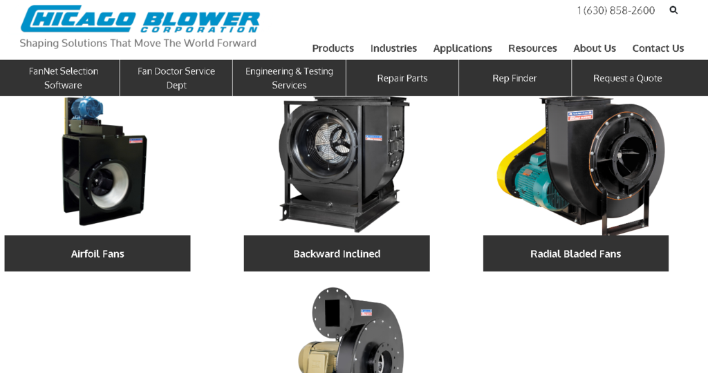

JoeM 10,155 #21009 Posted March 18, 2024 If your really wanting to blow stuff (and have deep pockets) you can look these guy up. 2 Share this post Link to post Share on other sites

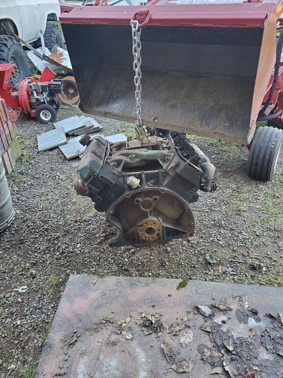

Thor27 892 #21010 Posted March 18, 2024 Terrible picture, but this is a 440 chrysler with iron intake & exhaust, and front accessories about a foot in the air. I need a weight box, it moved it fine, but didnt have the traction to push the front tires over the transition to garage slab.. 11 Share this post Link to post Share on other sites

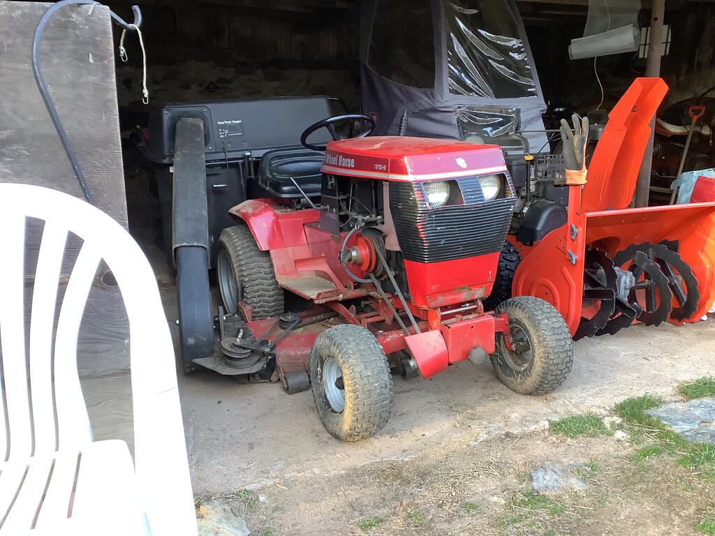

TonyToro Jr. 2,523 #21011 Posted March 18, 2024 Took the snowplow off my 310-8 and put the 42in SD mower deck and power flow bagger system on. Added a little oil, and greased. All ready for mowing season! 10 1 Share this post Link to post Share on other sites
953 nut 68,503 #21012 Posted March 19, 2024 22 hours ago, JoeM said: really wanting to blow stuff (and have deep pockets) you can look these guy up. And a VERY LONG extension cord! 2 2 Share this post Link to post Share on other sites

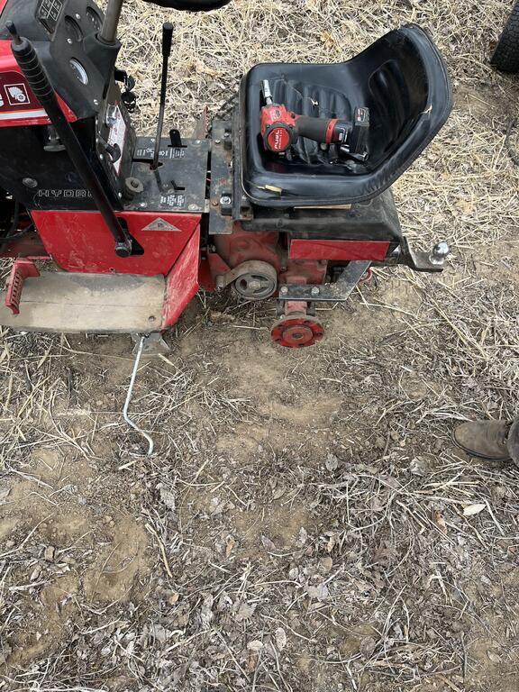

OutdoorEnvy 1,817 #21013 Posted March 19, 2024 (edited) Well this is one that falls under "any reason is a good reason to get a tractor out..." So Jack and his friends were making a small wiffle ball field in the woods behind our house and wanted dirt baselines...I couldn't watch them with a rake and shovel any longer so out came the Wheel Horse garden tractor implement system! Had to take off the snow plow that I never got to use this year. Then put together the cultivator and put on the old rear tires on the 312-8 and it was ready to go. Ended up adjusting the tines close together for a narrower line. Edited March 19, 2024 by OutdoorEnvy 5 9 Share this post Link to post Share on other sites

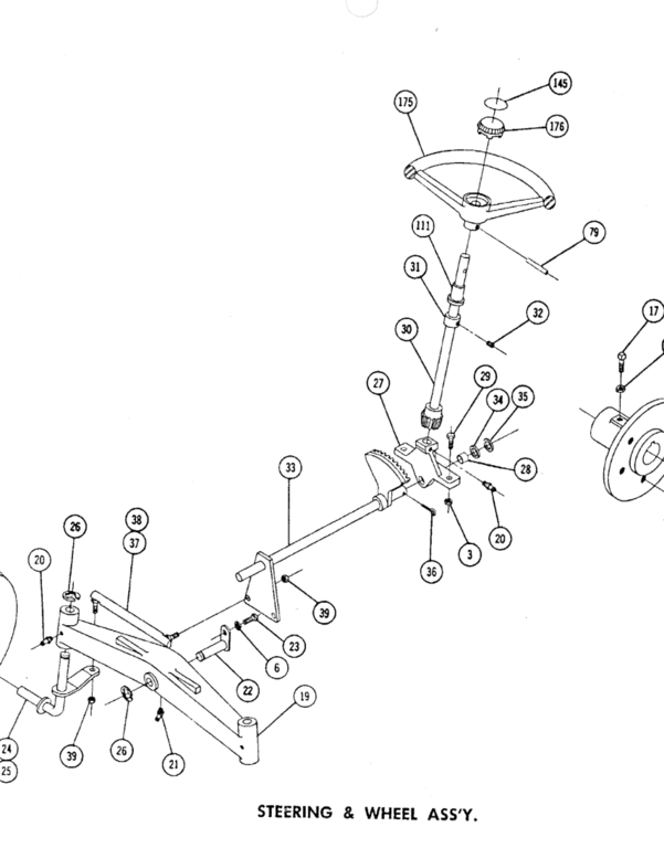

Colby G 248 #21018 Posted March 22, 2024 Hello everybody, I have a lot of play in my steering, does anybody know how to fix it? VID_20240322_152331.mp4 Share this post Link to post Share on other sites
pfrederi 21,046 #21019 Posted March 22, 2024 (edited) Remove cotter pin #36 add a washer between pin and housing 27 (like washers 34 and 35 to take out end play) Edited March 22, 2024 by pfrederi 4 Share this post Link to post Share on other sites
Colby G 248 #21020 Posted March 22, 2024 44 minutes ago, pfrederi said: Remove cotter pin #36 add a washer between pin and housing 27 (like washers 34 and 35 to take out end play) This works for any wheel horse? Share this post Link to post Share on other sites

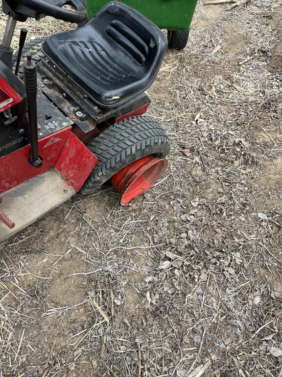

87 416-8 horse 430 #21021 Posted March 22, 2024 My brother was driving the 518 along the field and the tire had a small leak and popped off the bead. We pulled it off and got it back on the bead. We just nearly made it to the shop before it was flat again. I guess tires are next on the list. 1 3 Share this post Link to post Share on other sites
ebinmaine 80,279 #21022 Posted March 22, 2024 5 minutes ago, 87 416-8 horse said: guess tires If you don't have any sharp aggressive plants around.. throw a tube in it. 2 Share this post Link to post Share on other sites
87 416-8 horse 430 #21023 Posted March 22, 2024 31 minutes ago, ebinmaine said: If you don't have any sharp aggressive plants around.. throw a tube in it. I didn’t think about that. Thanks Eric 1 Share this post Link to post Share on other sites
ebinmaine 80,279 #21024 Posted March 22, 2024 22 minutes ago, 87 416-8 horse said: I didn’t think about that. Thanks Eric We have no sharp plants here. ALL our tire swaps get tubes now. No. More. Concerns about getting the bead to set. 1 Share this post Link to post Share on other sites
pfrederi 21,046 #21025 Posted March 22, 2024 The WHs used the same steering mechanism for many years 2 Share this post Link to post Share on other sites
