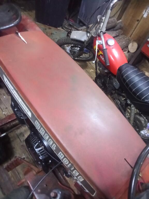

Colby G 248 #20876 Posted February 23, 2024 Hello everybody, it's been awhile since I've posted, but I've just sanded down the hood on the 1969 charger 12 to look like patina, don't know how good of a job I did, but the idler pulley also went, so I replaced that as well. Got some chains put on it for the remaining months of winter too. 13 2 Share this post Link to post Share on other sites

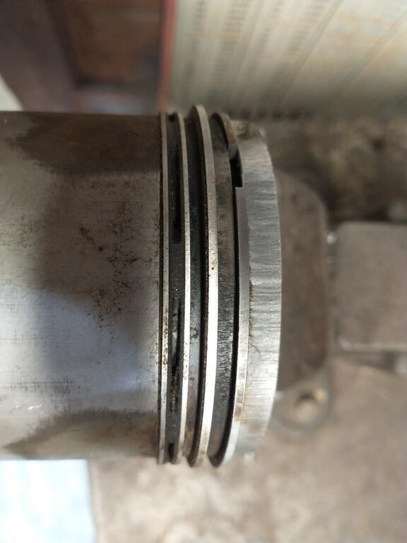

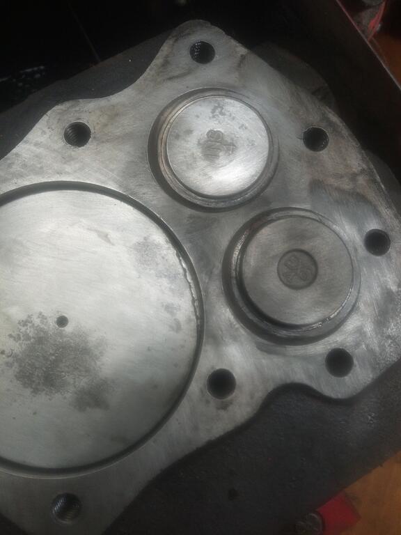

ohiofarmer 3,504 #20878 Posted February 25, 2024 (edited) I have been busy cleaning up and organizing my shop. It got pretty cold out there, so as a reward for uncovering a couple if engines I had stuffed under a table, They went inside the heated room for review. Here is a 14 HP shaker. She shook enough that the coil blew a hole in the tin.. Also, there is some erosion at the edge of the piston bad enough that the top piston ring is visible by almost an eighth of an inch. If you line it up with the exhaust valve the eroded edge is evident. The bore feels tight and round, but maybe it's just a cheap piston because it looks like a replacement stamped .003 Edited February 25, 2024 by ohiofarmer 3 1 Share this post Link to post Share on other sites
lynnmor 9,049 #20879 Posted February 25, 2024 7 hours ago, ohiofarmer said: The bore feels tight and round, but maybe it's just a cheap piston because it looks like a replacement stamped .003 Some engines had .003 oversize pistons from the factory. 2 Share this post Link to post Share on other sites
ebinmaine 80,878 #20880 Posted February 25, 2024 10 hours ago, ohiofarmer said: there is some erosion at the edge of the piston bad enough that the top piston ring is visible by almost an eighth of an inch Seems I've been told in the past that may have been because a PO ran the engine very lean for an extended time period. I have a K341 here like that. Very likely it'll want a .030 over bore. I may go even more with my own. Share this post Link to post Share on other sites

squonk 48,207 #20882 Posted February 25, 2024 13 hours ago, ohiofarmer said: I have been busy cleaning up and organizing my shop. It got pretty cold out there, so as a reward for uncovering a couple if engines I had stuffed under a table, They went inside the heated room for review. Here is a 14 HP shaker. She shook enough that the coil blew a hole in the tin.. Also, there is some erosion at the edge of the piston bad enough that the top piston ring is visible by almost an eighth of an inch. If you line it up with the exhaust valve the eroded edge is evident. The bore feels tight and round, but maybe it's just a cheap piston because it looks like a replacement stamped .003 All pretty common. The coils busted off a lot of them. I have seen a dozen or so pistons eroded away like that. That .003 is probably factory to correct a assembly error. 1 Share this post Link to post Share on other sites

ohiofarmer 3,504 #20891 Posted February 26, 2024 16 hours ago, squonk said: All pretty common. The coils busted off a lot of them. I have seen a dozen or so pistons eroded away like that. That .003 is probably factory to correct a assembly error. Share this post Link to post Share on other sites
ohiofarmer 3,504 #20892 Posted February 26, 2024 (edited) The bore on the block looks good I evaluated it by inserting a piece of 3 inch PVC and it showed no visible wear. This looks like a candidate for a re-ring and new piston. I had previously welded a long crack in the engine tin so all it needs is a backup piece cut from an old piece of sheet metal and held in place with sheet metal and a JB weld patch/body filler. I absolutely cannot tear it down until the two cycle carb builds on some chain saws and trimmers is complete. Spring is coming and medical appointments for my wife post op is tomorrow. It has been a year of big medical care around here, so I hope we get some breathing room.. That piston being oriiginal would be good news. That would mean the engine has low hours, so I will check the bore with a bore gauge Edited February 26, 2024 by ohiofarmer 1 Share this post Link to post Share on other sites
Tractorhead 9,217 #20893 Posted February 26, 2024 Depending on how the bore itself looks, i allway‘s would give it a new gently honespurs. to prevent the Engine becomes an oilpump. 1 Share this post Link to post Share on other sites
ohiofarmer 3,504 #20894 Posted February 26, 2024 3 hours ago, Tractorhead said: Depending on how the bore itself looks, i allway‘s would give it a new gently honespurs. to prevent the Engine becomes an oilpump. i agree. there are a few vertical microscratches , but not deep enough to feel them. with a fingernai. Share this post Link to post Share on other sites

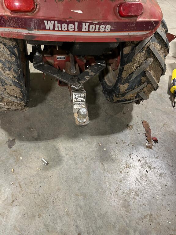

87 416-8 horse 430 #20897 Posted February 26, 2024 I just finished building a custom rear hitch for my 1987 416-8. I didn't want to take a chance at breaking the ear off or punching a hole in the bottom of the diff. I made it so I can put any kind of hitch in it. 1 8 Share this post Link to post Share on other sites
ebinmaine 80,878 #20898 Posted February 26, 2024 19 minutes ago, 87 416-8 horse said: I just finished building a custom rear hitch for my 1987 416-8. Niiiiice 1 Share this post Link to post Share on other sites
Pullstart 71,350 #20899 Posted February 26, 2024 @87 416-8 horse 1 1 Share this post Link to post Share on other sites

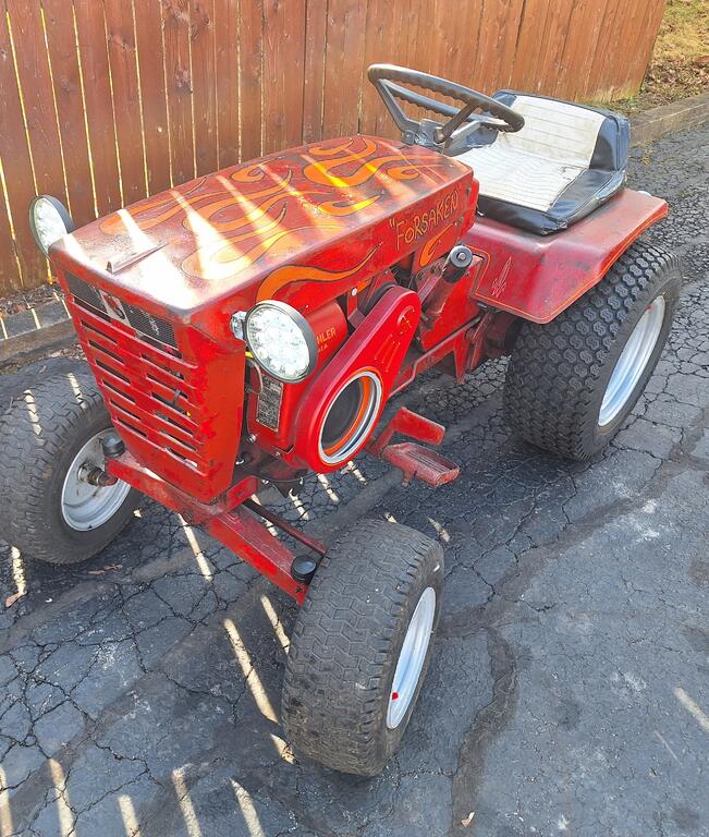

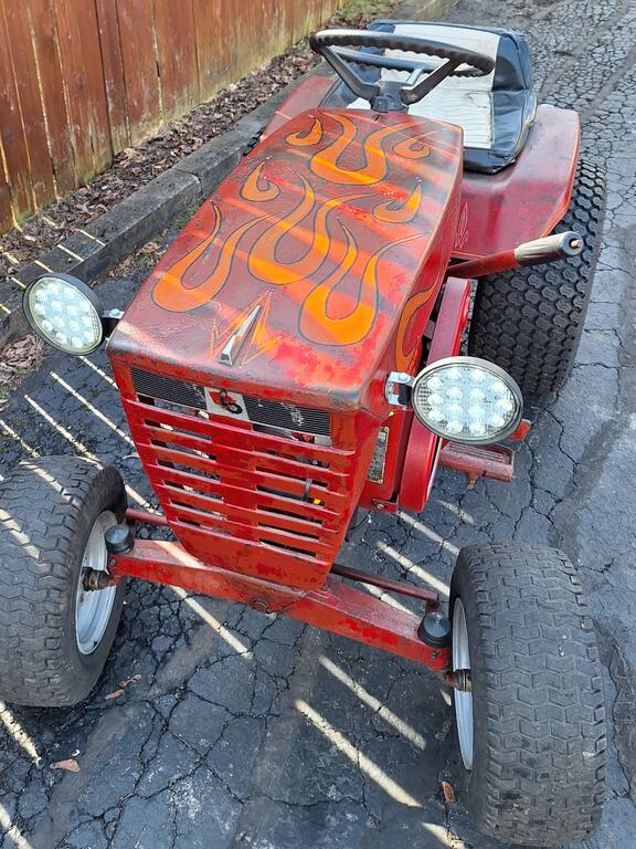

D_Mac 9,339 #20900 Posted February 26, 2024 Woke up the 856 "Forsaken" today. Its been sleeping in the garage for a while now. It fired right up and I cruised around the backyard for a few minutes. 6 2 Share this post Link to post Share on other sites
