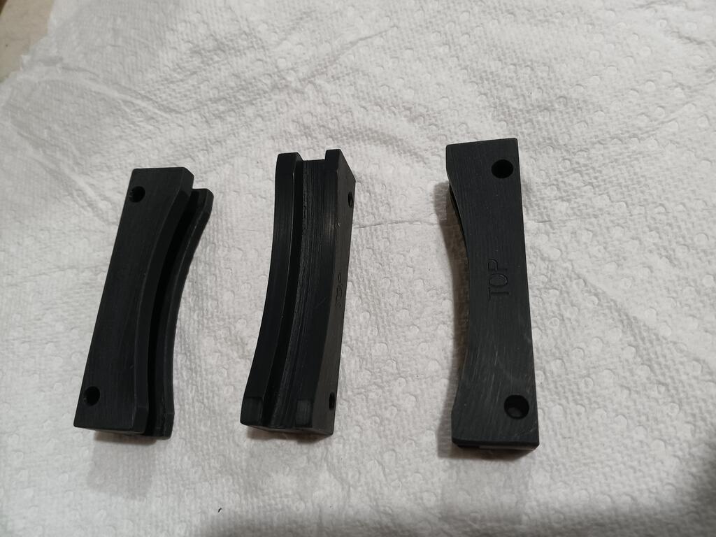

ebinmaine 81,032 #20552 Posted January 6, 2024 Got something neat in the post 📫 today. 4 1 Share this post Link to post Share on other sites

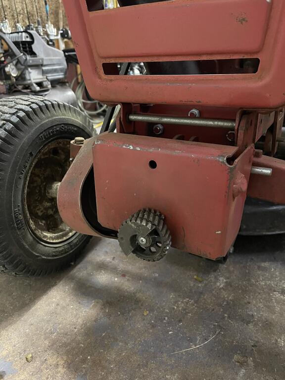

Wheelhorse#1 1,998 #20554 Posted January 7, 2024 Found another use for a balance gear ⚙️ 2 5 2 6 Share this post Link to post Share on other sites
davem1111 2,432 #20555 Posted January 7, 2024 3 hours ago, ebinmaine said: Got something neat in the post 📫 today. Probably showing my stupidity here, but.... WHAT ARE THOSE? 1 Share this post Link to post Share on other sites
ebinmaine 81,032 #20556 Posted January 7, 2024 3 minutes ago, davem1111 said: Probably showing my stupidity here, but.... WHAT ARE THOSE? I wouldn't have known either. 😁 These are the base Chute pivot blocks for a Tall Chute snowblower. 3 1 Share this post Link to post Share on other sites

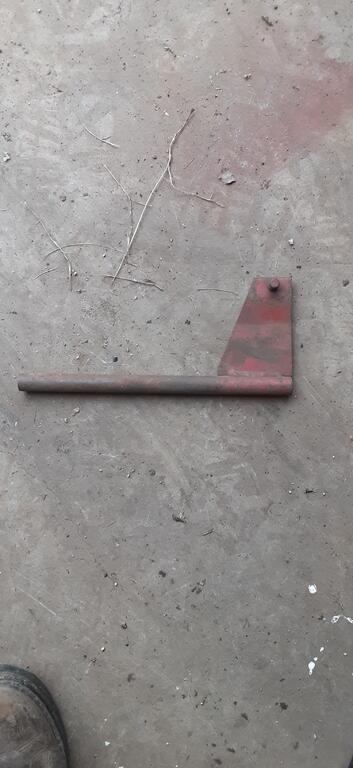

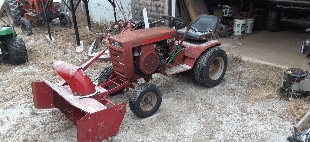

Oldskool 6,678 #20557 Posted January 7, 2024 I just acquired this tractor. Added the snowblower I've had sitting here. I know I'm missing something to lift it but not sure what. Attached a pic of the one piece I have. 3 1 Share this post Link to post Share on other sites
Ed Kennell 47,729 #20558 Posted January 7, 2024 Lucky you have the "flag". Now you need the lift/push rod. This can be a length of 3/4" pipe with the blower end mashed flat and a drilled hole to fit on the lug at the bottom rear of the blower. The flag rod slips in the other end and attaches to the top hole in the lower lift lever. 1 Share this post Link to post Share on other sites
Ed Kennell 47,729 #20559 Posted January 7, 2024 I just noticed, the front housing extensions are on backwards on your blower. The tractor will steer much better if you flip them side to side so the front leading edge of the extension is slicing into the snow and not pushing the tractor to the side. 2 2 Share this post Link to post Share on other sites

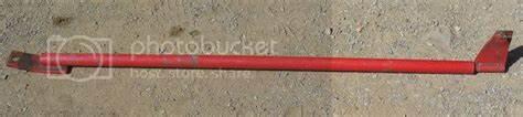

wallfish 20,718 #20560 Posted January 7, 2024 33 minutes ago, Oldskool said: I know I'm missing something to lift it but not sure what. Here's what the original tube looks like. 1 1 Share this post Link to post Share on other sites
Oldskool 6,678 #20561 Posted January 7, 2024 1 minute ago, wallfish said: Here's what the original tube looks like. You wouldn't by any chance have any dimensions for that do you? Share this post Link to post Share on other sites
wallfish 20,718 #20562 Posted January 7, 2024 6 minutes ago, Oldskool said: You wouldn't by any chance have any dimensions for that do you? Not sure for that tractor but you can attach the flag and measure from the pin on the blower to the edge of the flag. I would prop the blower up about 4" and leave the lift lever in the up position too. That should give you a "good enough" measurement to allow the blower to float with the ground and definitely be raised with the lever. 1 2 Share this post Link to post Share on other sites
wallfish 20,718 #20563 Posted January 7, 2024 If you do it with the blower down and the lever down it won't allow the blower to go down any further and it will also lift too high and hit the front axle before being able to lock the lever in the up position. Afterwards you can fine adjust the height a little bit if needed by adding washers or shaft collar to the flag rod. Probably shouldn't need to. 1 2 Share this post Link to post Share on other sites
Ed Kennell 47,729 #20564 Posted January 7, 2024 (edited) Like John said. For the couple tubes and flags that I have made, I started with a pipe that was longer than needed. I never welded that flat bar on mine. I flattened the end, drilled the hole, and bent the angle. Then with the tube connected to the blower and the flag connected to the lower lift lever, held them side by side and marked the tube at the front of the flag. Another mod I always did to single stage blowers. After shearing off cotter pins and hairpin clips, I drilled out the pin hole on the blower lug for a 1/4" bolt and nylock nut to hold the lift tube on the lug. Use a flat washer above the 1/4" bolt. Edited January 7, 2024 by Ed Kennell 2 2 Share this post Link to post Share on other sites

Oldskool 6,678 #20568 Posted January 7, 2024 (edited) 30 minutes ago, ebinmaine said: @Oldskool Thanks. I was just looking that over. I noticed the flag part in that file is a bit offset. Mine is flat. Will that be an issue for me? Sorry. Disregard this. Mine is offset. Edited January 7, 2024 by Oldskool Share this post Link to post Share on other sites
wallfish 20,718 #20569 Posted January 7, 2024 2 hours ago, Ed Kennell said: After shearing off cotter pins and hairpin clips, Yeah, that area for the lift connection to the blower certainly wasn't their best design. Wouldn't it work better if the rod were horizontal? Like 2 tabs on the blower and a 1/2" pin could go through all 3 holes (2 tabs and the lift pole ) Or maybe even a smaller version similar to the plow hitch with a horizontal bar on the end of the pole. 2 little swinging clamps to keep it in the slots. 1 Share this post Link to post Share on other sites
Ed Kennell 47,729 #20570 Posted January 7, 2024 (edited) 2 hours ago, wallfish said: Yeah, that area for the lift connection to the blower certainly wasn't their best design. Wouldn't it work better if the rod were horizontal? Like 2 tabs on the blower and a 1/2" pin could go through all 3 holes (2 tabs and the lift pole ) Or maybe even a smaller version similar to the plow hitch with a horizontal bar on the end of the pole. 2 little swinging clamps to keep it in the slots. You Monday Morning quarterbacks......where were you 50 60 years ago when Elmer needed back yard coaching. Edited January 8, 2024 by Ed Kennell 1 5 Share this post Link to post Share on other sites
rjg854 13,407 #20571 Posted January 7, 2024 Wasn't the best design, but it's lasted 50 years. 2 Share this post Link to post Share on other sites
Ed Kennell 47,729 #20572 Posted January 7, 2024 21 minutes ago, Oldskool said: Mine is flat. Will that be an issue for me? All the flags I built were flat. Some of the flags and poles were made from unistrut. 1 Share this post Link to post Share on other sites

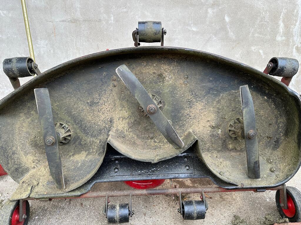

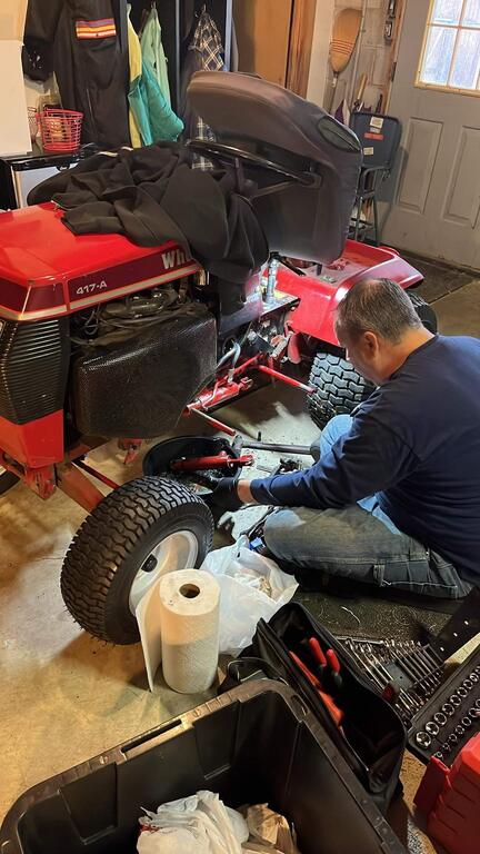

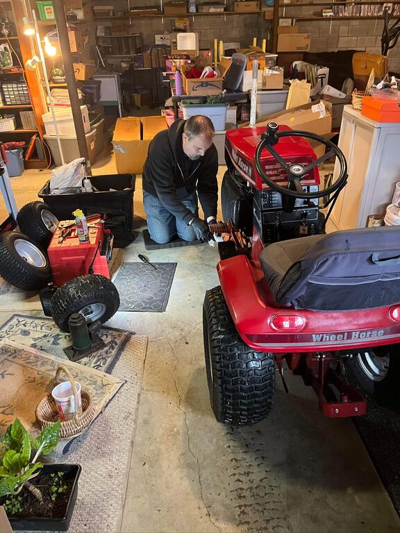

Andy N. 2,875 #20574 Posted January 8, 2024 (edited) Went to my sister's house this past weekend in KY for a holiday visit. While I was there, I did some routine and non routine maintenance on her '86 417-A. Routine included oil and filter changes, chassis and deck lubes, and blade sharpening. Non routine included changing out the front 6" wheels that it came with, to 8" wheels that it should've had. I also changed out the lift actuator with one that i rebuilt due to typical shaft leaking. I bought this machine for her 2 years ago and she's put 30 hours on it since then. I was impressed with how good the POR-15 head up on the deck underside and how quiet the spindles still were after being rebuilt with new bearings 2 years ago. IMG_4366.mp4 Edited January 8, 2024 by Andy N. 6 2 Share this post Link to post Share on other sites
