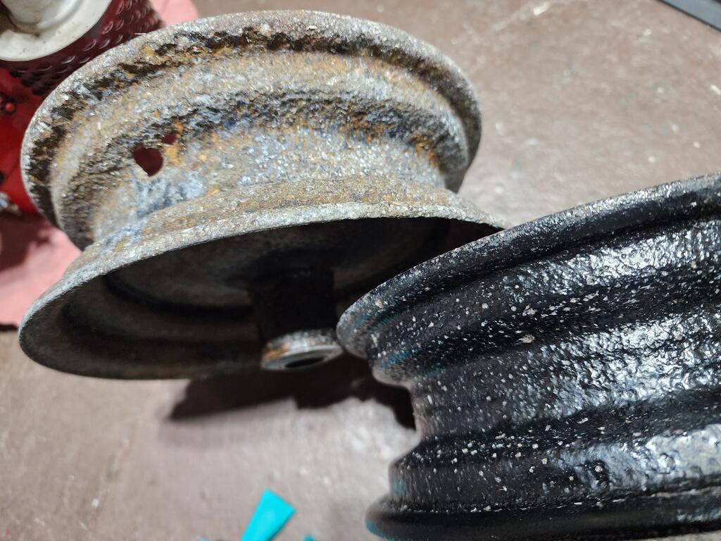

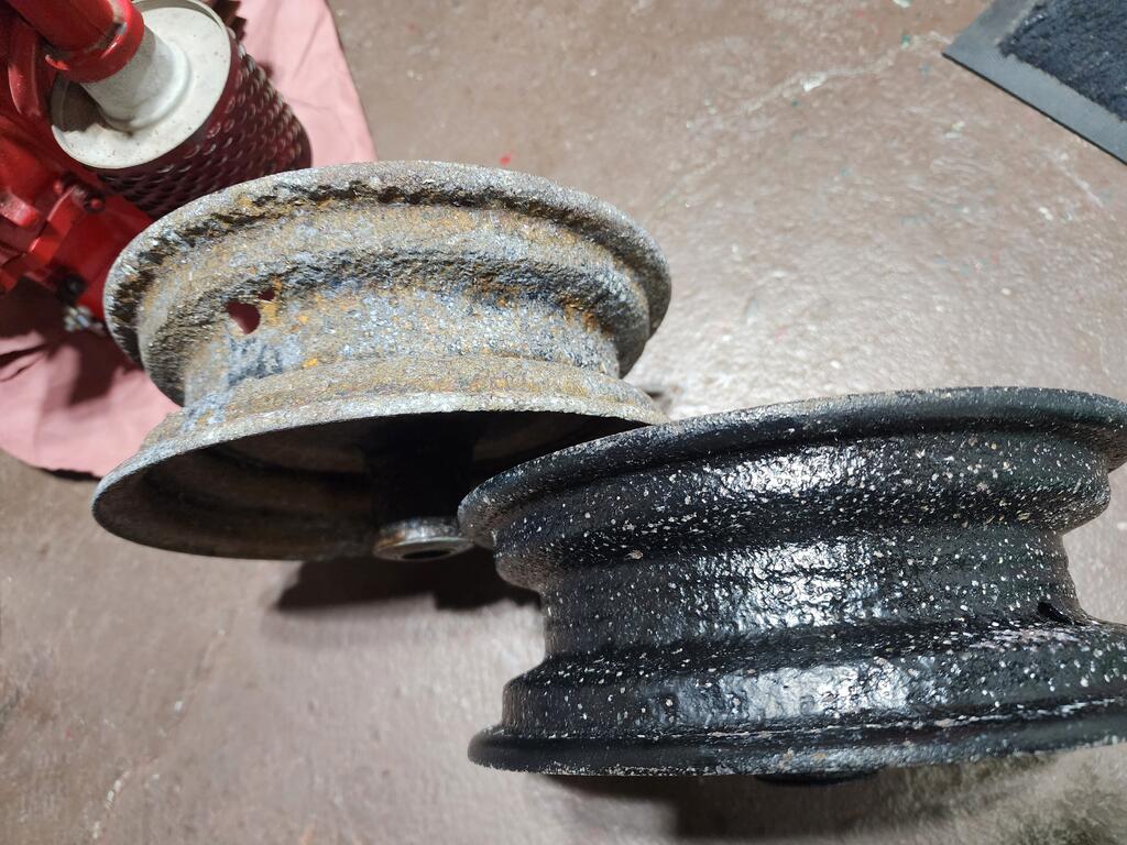

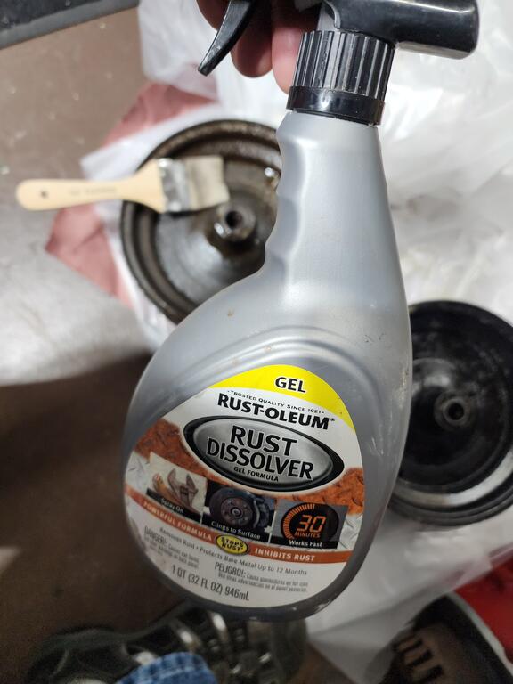

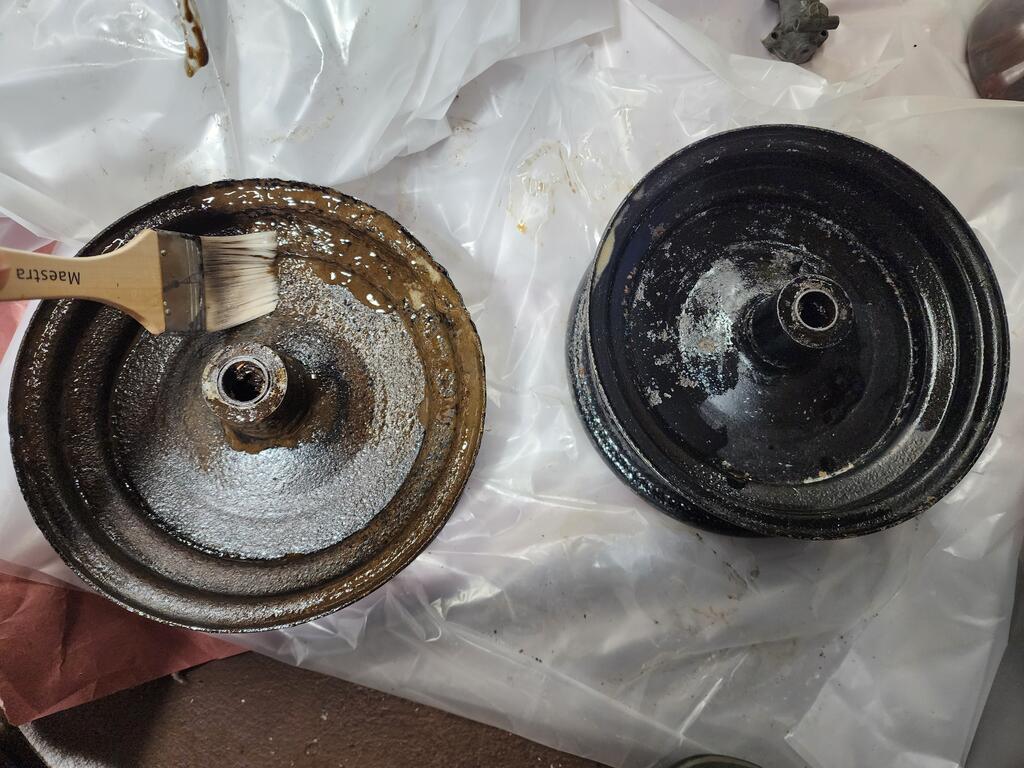

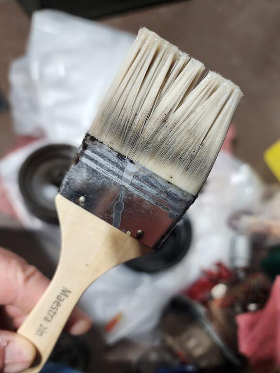

AMC RULES 37,260 #20501 Posted December 30, 2023 3 hours ago, ebinmaine said: E tank Craig? Nope... disposable paint brush. 3 Share this post Link to post Share on other sites
AMC RULES 37,260 #20502 Posted December 30, 2023 Quick 20-30 minute process. 3 Share this post Link to post Share on other sites
AMC RULES 37,260 #20503 Posted December 30, 2023 6 1 Share this post Link to post Share on other sites

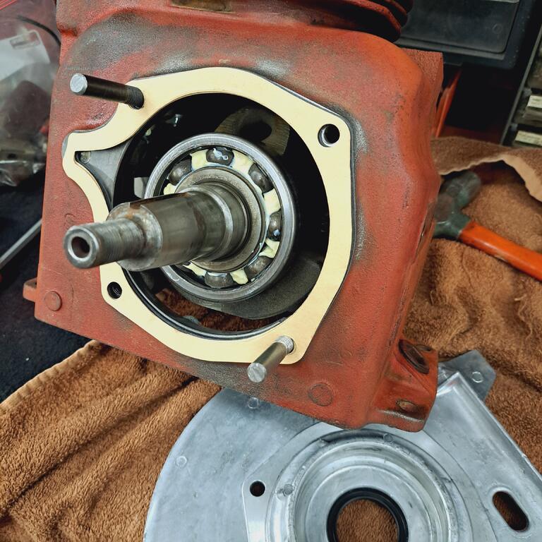

WHX?? 58,310 #20504 Posted December 30, 2023 (edited) And here you guys thought hanging paper was passing a bad check ... A smooth move for installing bearing plates. Edited December 31, 2023 by WHX?? 7 Share this post Link to post Share on other sites

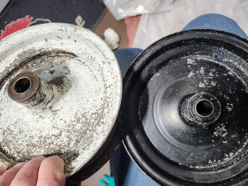

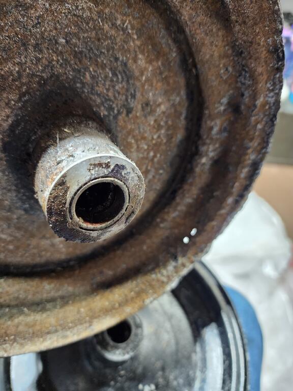

AMC RULES 37,260 #20505 Posted December 31, 2023 Full disclosure... What I discovered... Saving these things isn't even going to be a challenge. 5 1 1 Share this post Link to post Share on other sites

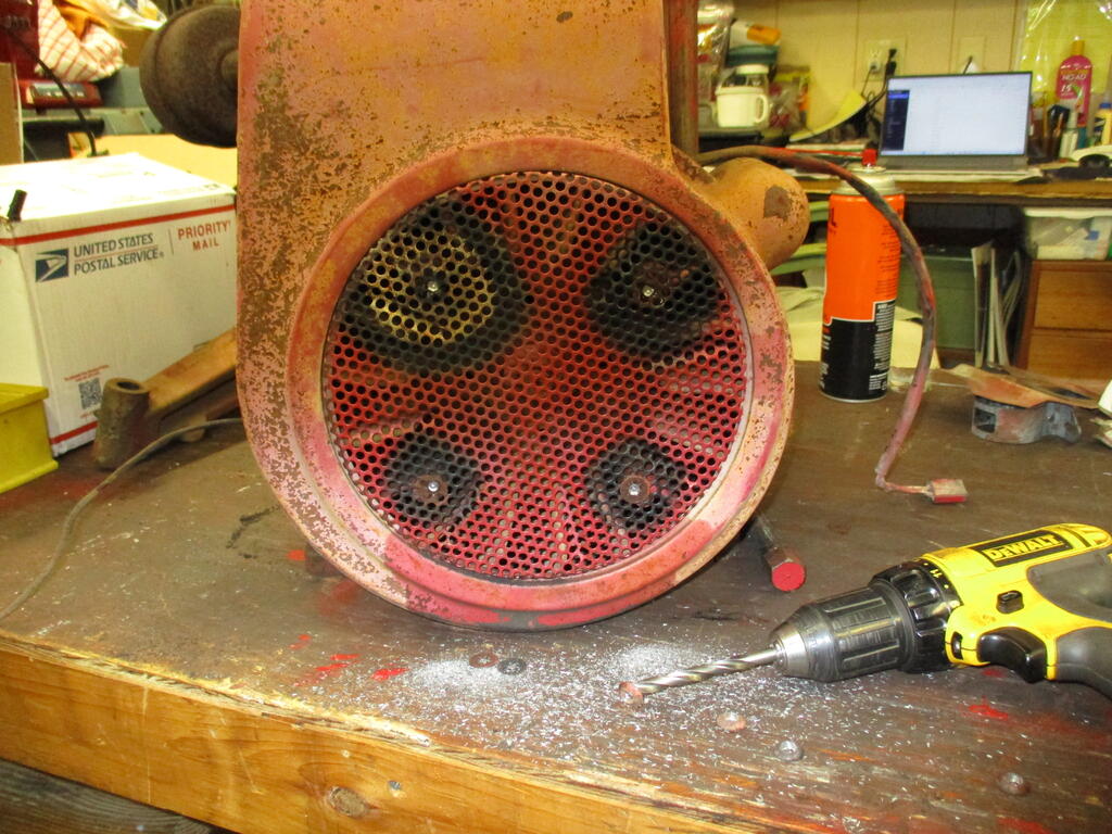

953 nut 69,997 #20506 Posted December 31, 2023 5 hours ago, Ed Kennell said: Time to throw it on the drill press? Much easier to center the drill bit in a phillips head than a broken off 1/4-20. Drill them out to 1/8" and then 3/16" then chase the threads. 3 Share this post Link to post Share on other sites

oliver2-44 11,790 #20510 Posted December 31, 2023 2 hours ago, AMC RULES said: Full disclosure... What I discovered... Saving these things isn't even going to be a challenge. Fill them with some JB Weld. Them mount them in your drill press with a long 1/2” bolt and some spacers. Run drill press on slowest speed and easily sand them smooth. 1 Share this post Link to post Share on other sites

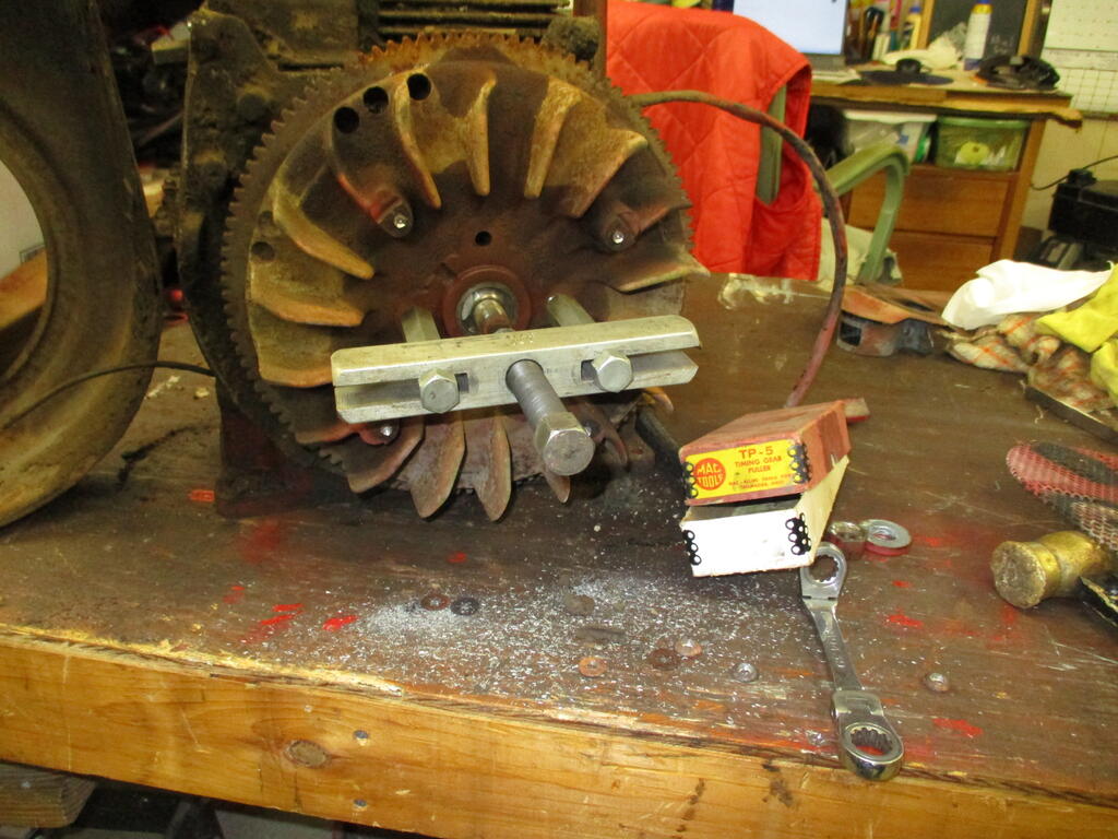

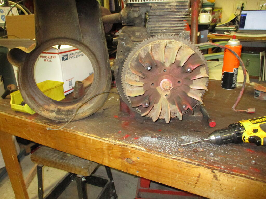

pfrederi 21,268 #20512 Posted December 31, 2023 Sucess with drilling. Now i can get the flywheel off and use the drill press to go the helicoil route 3 2 Share this post Link to post Share on other sites

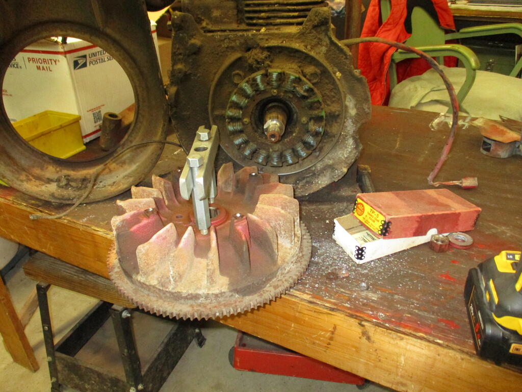

pfrederi 21,268 #20513 Posted December 31, 2023 More success 6 Share this post Link to post Share on other sites

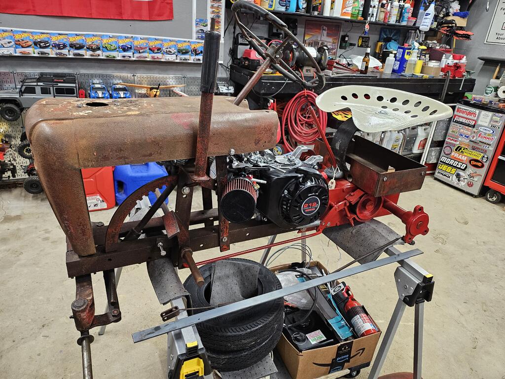

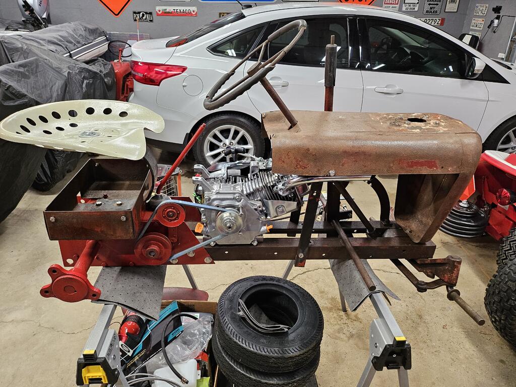

ML3 2,551 #20514 Posted December 31, 2023 Making some more headway on Suburban rat rod. 4 3 Share this post Link to post Share on other sites
953 nut 69,997 #20515 Posted January 1, 2024 5 hours ago, pfrederi said: use the drill press to go the helicoil route Should be able to start with 1/8" bit and sneak up on to a 13/64 without needing a helicoil. A 1/4-20 tap will knock out the remaining threads. 1 Share this post Link to post Share on other sites

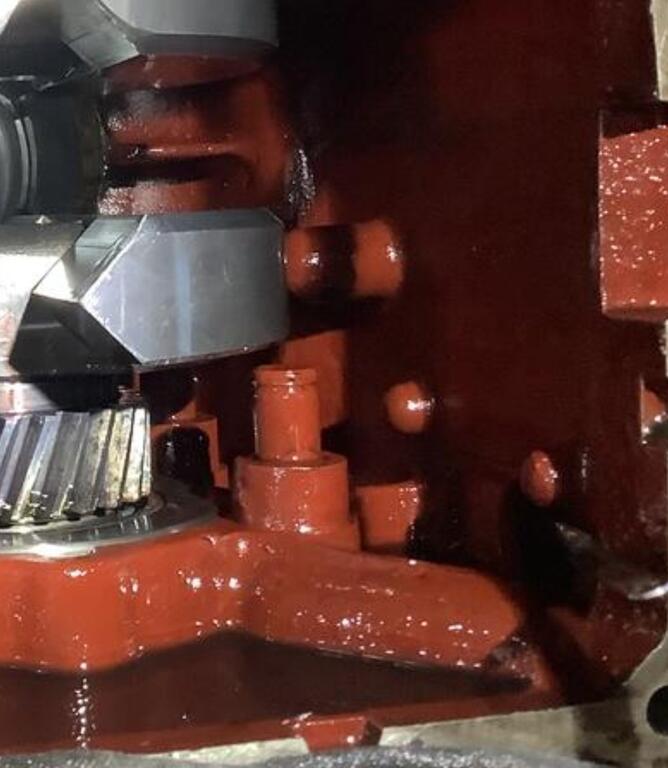

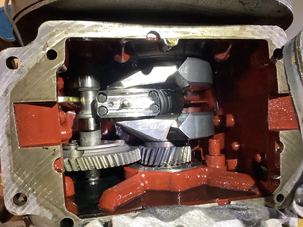

TonyToro Jr. 2,547 #20516 Posted January 1, 2024 Me and my dad @TonyToro ripped apart the engine in one of my pulling tractors “lunch money” it’s a Raider 14 with a Kohler K-series 14hp. We figured out that it has a good piston connecting rod and crank that is not stock and are all parts from Midwest Super Cub. So now all I have to get is a new aftermarket cam, and new valves then I should be ready for the next pulling season. 1 7 Share this post Link to post Share on other sites
ebinmaine 81,032 #20517 Posted January 1, 2024 24 minutes ago, TonyToro Jr. said: Me and my dad @TonyToro ripped apart the engine in one of my pulling tractors “lunch money” it’s a Raider 14 with a Kohler K-series 14hp. We figured out that it has a good piston connecting rod and crank that is not stock and are all parts from Midwest Super Cub. So now all I have to get is a new aftermarket cam, and new valves then I should be ready for the next pulling season. And NO balance gears. Niiiiice. Share this post Link to post Share on other sites
TonyToro Jr. 2,547 #20518 Posted January 1, 2024 (edited) 10 minutes ago, ebinmaine said: And NO balance gears. Niiiiice. What does that do? Edited January 1, 2024 by TonyToro Jr. Share this post Link to post Share on other sites
ebinmaine 81,032 #20519 Posted January 1, 2024 4 minutes ago, TonyToro Jr. said: What does that do? Balance gears were installed by the Kohler factory to reduce the inherent vibration of the single cylinder engines. After 35+ years we've been seeing more and more of these sets of balance gears causing catastrophic damage to the engines. Some believe in removing them. Some replace them. I took them out of the K341 Kohler that's on my '75 C160 Automatic. The vibration is a little more prevalent at higher RPM where the tractor doesn't operate anyway. I'll be removing them from my other Kohler K-series as well. 2 1 Share this post Link to post Share on other sites

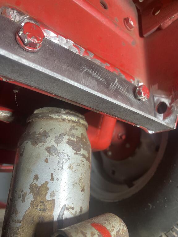

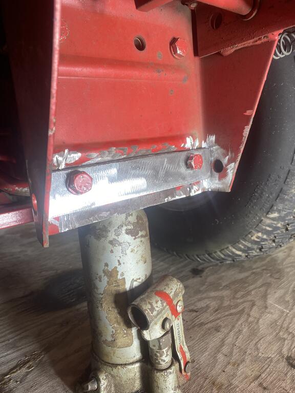

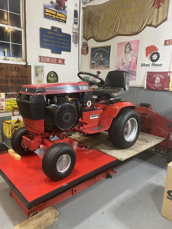

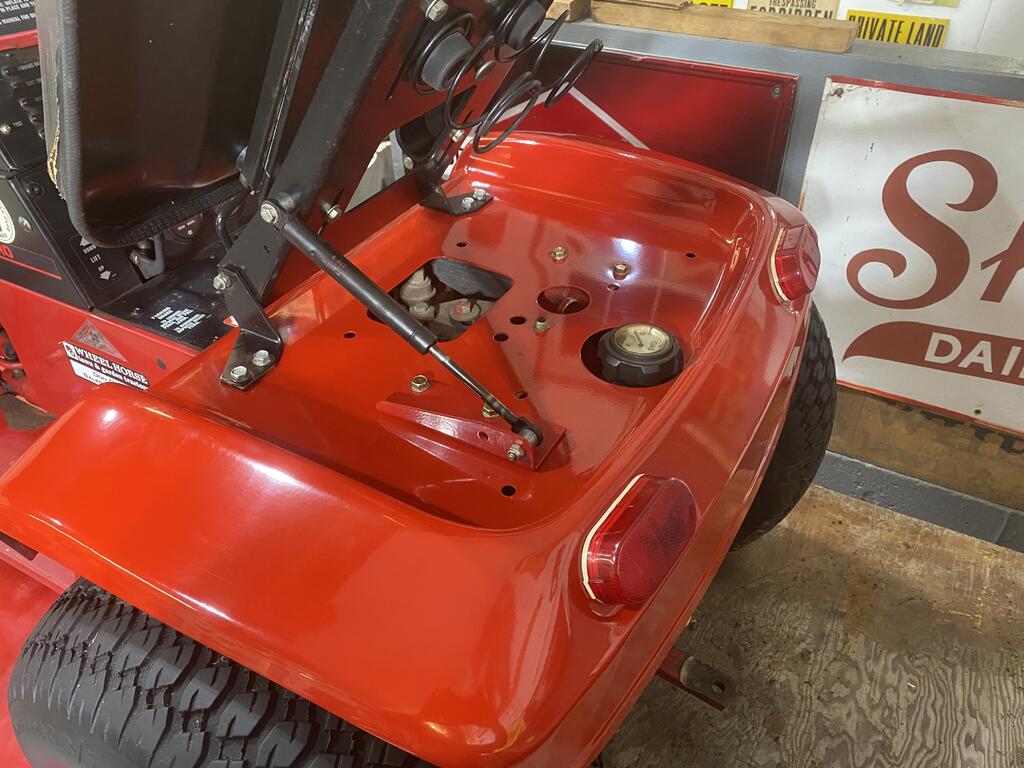

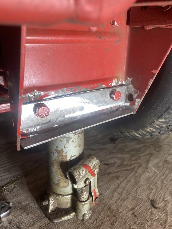

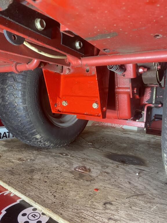

c-series don 12,600 #20520 Posted January 2, 2024 (edited) Today I fixed the cracked transmission frame plate on my 416-H. I run a 60” deck and a Peco vacuum system on this tractor, and when the bins are full of grass they are HEAVY. So every year when I service and put it away for the winter I check that plate, I know this is the weak link and many have had it crack. Well, it finally happened. I ground out the cracks, welded them shut. Next I replaced the broken 3/4”x1/8” flat stock that was used as a big washer with a piece of 1-1/8x1/8” and added a piece of 3/4”x1/8” as a gusset. While I had it on the lift I replaced the fender pan with a NOS one I picked up at the show this past year. Next I have to fix the throttle cable that keeps creeping down. Tomorrow I will get some nylon washers, drill out the rivet and replace with a nut and bolt. Edited January 2, 2024 by c-series don 2 10 Share this post Link to post Share on other sites

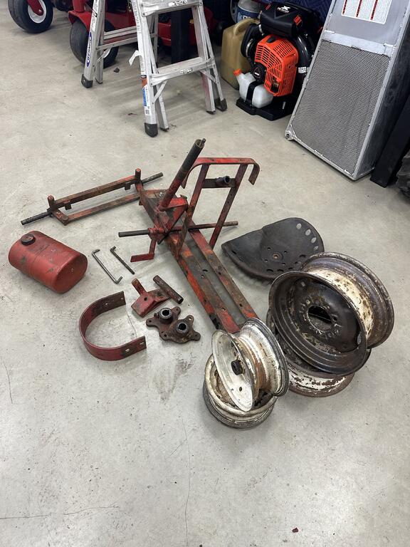

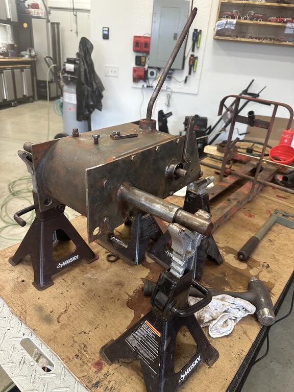

whtractors24 3,572 #20521 Posted January 2, 2024 Today I started on a 1958 Rj build . This one will be a little different than patina or red paint . I always wanted to do something unique as a show cruiser . The water in the transmission was no extra charge ! IMG_1833.mov 1 5 1 Share this post Link to post Share on other sites
8ntruck 9,358 #20522 Posted January 2, 2024 On 12/30/2023 at 7:36 PM, 953 nut said: Much easier to center the drill bit in a phillips head than a broken off 1/4-20. Drill them out to 1/8" and then 3/16" then chase the threads. Good place to use a left hand twist drill, too - provided your drill press is reversible. 2 Share this post Link to post Share on other sites
Wild Bill 633 941 #20523 Posted January 2, 2024 (edited) On 1/1/2024 at 3:46 PM, ebinmaine said: And NO balance gears. Niiiiice. They do not run balance gears in pulling motors due to running high RPMs. And they re-balance the crankshaft to the new piston and connecting rod weight. FYI, The MWSC rod is an I-beam design whereas, the Vogel Manufacturing is a H-beam design, which is better at capturing the splashed oil to lubricate the rod bearing. Edited January 4, 2024 by Wild Bill 633 1 2 Share this post Link to post Share on other sites
ebinmaine 81,032 #20524 Posted January 2, 2024 1 minute ago, Wild Bill 633 said: They do not run balance gears in a pulling motors due to running high RPM. And they balance the crankshaft to the new piston and connecting rod weight. Interesting stuff Bill. Thank you. I figured it might have been something like that. I've seen those balancing plates advertised on one of the websites. 1 Share this post Link to post Share on other sites
Brockport Bill 2,489 #20525 Posted January 2, 2024 19 hours ago, c-series don said: Today I fixed the cracked transmission frame plate on my 416-H. I run a 60” deck and a Peco vacuum system on this tractor, and when the bins are full of grass they are HEAVY. So every year when I service and put it away for the winter I check that plate, I know this is the weak link and many have had it crack. Well, it finally happened. I ground out the cracks, welded them shut. Next I replaced the broken 3/4”x1/8” flat stock that was used as a big washer with a piece of 1-1/8x1/8” and added a piece of 3/4”x1/8” as a gusset. While I had it on the lift I replaced the fender pan with a NOS one I picked up at the show this past year. Next I have to fix the throttle cable that keeps creeping down. Tomorrow I will get some nylon washers, drill out the rivet and replace with a nut and bolt. i appreciated C-Series Don's comments and photos for the frame plate repair he did -- so i have a few questions to see any other insights and suggestions how others have addressed this problem???? I don't weld, but i had a neighbor weld one plate for me on a 312-8 that i still have to put back together. I have a another with a similar crack - see photo........ looking at Don's photos earlier in the thread of the bar Don installed i had a few questions?? Don said he got thicker metal material stock than the flat bar stock that's factory?? I assume he welded it on and also used longer bolts? How about as solution me getting a 90 degree piece of angle iron to go under the 2 bolts similar to what Don did -- but installing it as one piece so the angle part of the bar that faces the ground would provide a stronger sheer strength than the "flat" piece that only faces the plate and tranny? Also do you think I would still need to weld the crack?? Do you think the angle iron bar has to be welded on, or would just attaching the angle iron with the 2 bolts be sufficient to create strength and stability across the plate? thanks, Bill 1 Share this post Link to post Share on other sites
