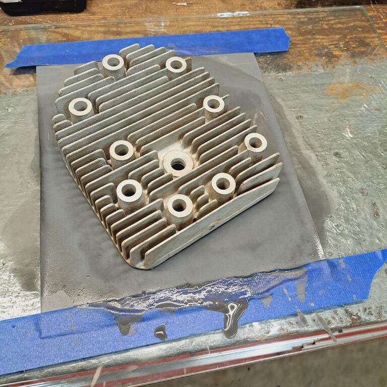

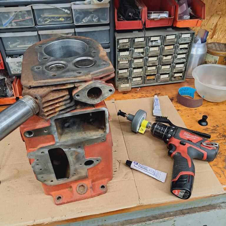

WHX?? 57,878 #20485 Posted December 26, 2023 Nothin like spending Christmas out in the shop. Glassed a head and worked on a K301 build. My fav a SG motor. Valves looked a little dicey after lapping so new ones on the way. Just a re-ring on the bore. 7 8 Share this post Link to post Share on other sites

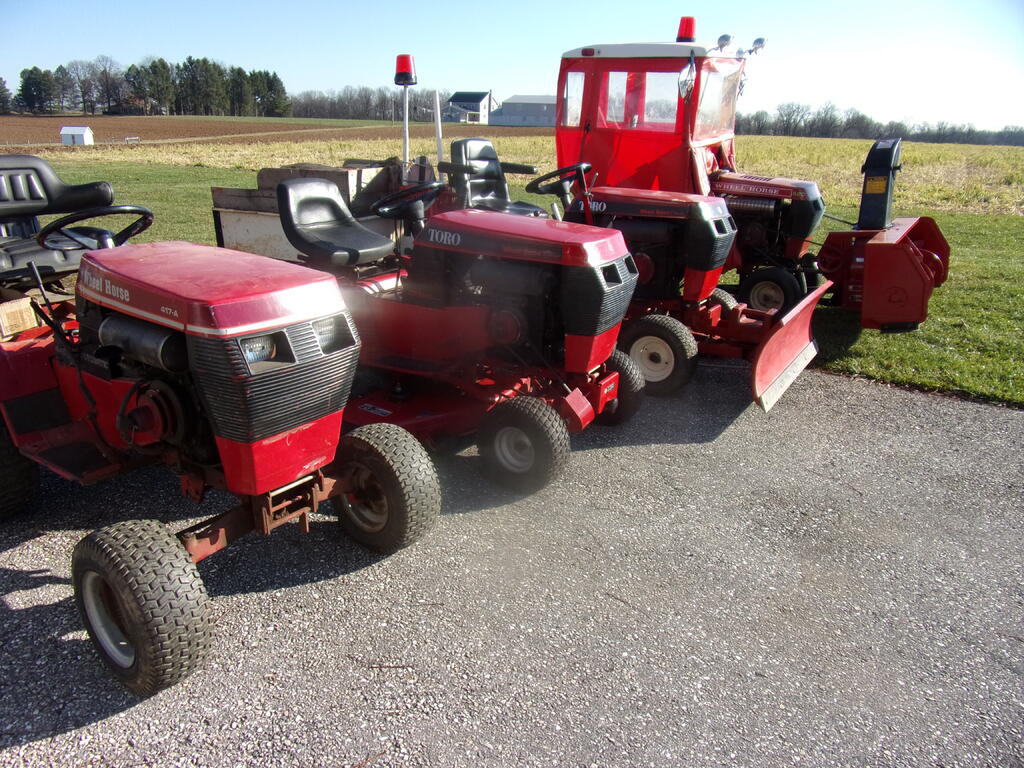

Ed Kennell 47,096 #20486 Posted December 29, 2023 Brought a few out in the sun and left them run a while for their year end warm up. 417A 310-8 312H 520H 7 8 Share this post Link to post Share on other sites

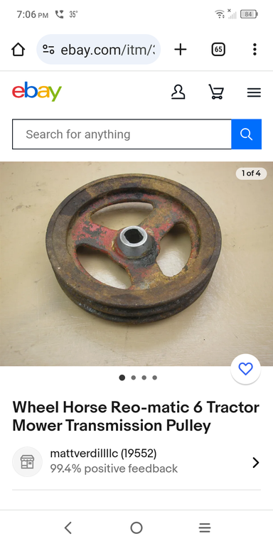

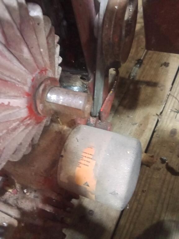

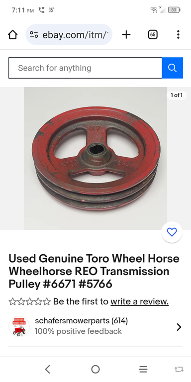

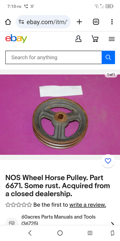

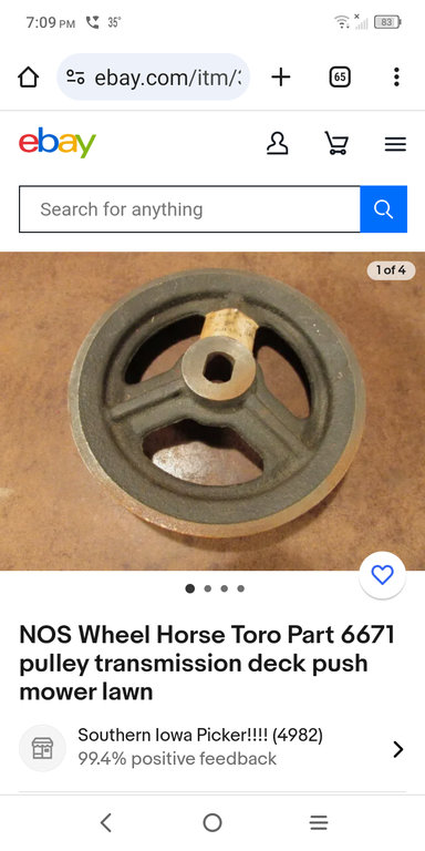

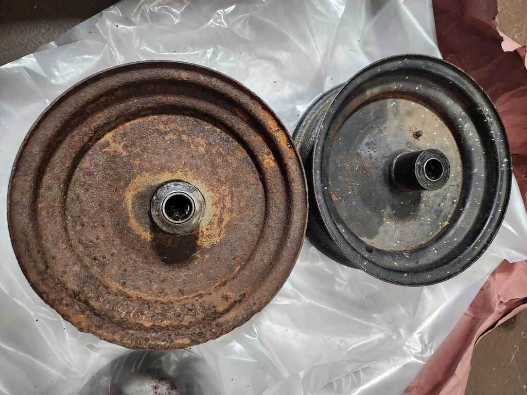

Colby G 248 #20487 Posted December 30, 2023 Could any of these pulleys work on the rear end of my charger 12? (Yes, I'm still stuck on this project. Can't figure out what rear end it is yet... In case anyone out there can, the model number of the hydro is 90-2070) I will also include pictures of the hydro shaft. Any info would be greatly appreciated. 1 Share this post Link to post Share on other sites
76c12091520h 4,282 #20488 Posted December 30, 2023 3 hours ago, Colby G said: Could any of these pulleys work on the rear end of my charger 12? (Yes, I'm still stuck on this project. Can't figure out what rear end it is yet... In case anyone out there can, the model number of the hydro is 90-2070) I will also include pictures of the hydro shaft. Any info would be greatly appreciated. The pulleys in these pictures are for rear engine riders...... 1 Share this post Link to post Share on other sites
Colby G 248 #20489 Posted December 30, 2023 13 minutes ago, 76c12091520h said: The pulleys in these pictures are for rear engine riders...... Goes to show how much I know 😂 I was thinking they might work because they had the same keyway. Do you know which one would work? I have a guy looking for one for me but I'm looking around in the meantime in case it's not the right one. 1 Share this post Link to post Share on other sites

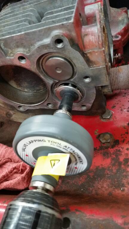

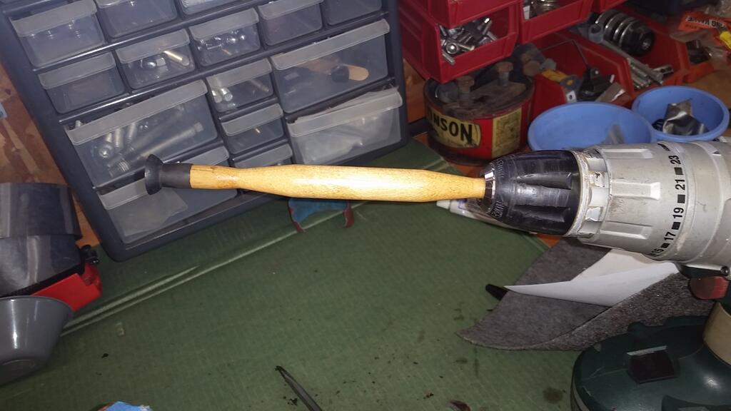

oliver2-44 11,708 #20490 Posted December 30, 2023 On 12/25/2023 at 6:23 PM, WHX?? said: Valves looked a little dicey after lapping @WHX?? I’m interested in the valve lapping attachment you have in you drill. I’ve never seen one like that. Looks like it sure would beat a hand lapped. 3 1 Share this post Link to post Share on other sites
WHX?? 57,878 #20491 Posted December 30, 2023 (edited) 3 hours ago, oliver2-44 said: @WHX?? I’m interested in the valve lapping attachment you have in you drill. I’ve never seen one like that. Looks like it sure would beat a hand lapped. It was cheap in the jungle. Works just ok. There is a clutch of sorts in it that likes to slip. It came with a bunch of suction cups but mostly for very large valves. Getting the cup to stick to the valve is problematic. I got it mainly to do a poor man's seat re-facer. This works too a guy just needs to shorten the hand lapper. A short wood dowel. Edited December 30, 2023 by WHX?? 5 Share this post Link to post Share on other sites
19richie66 17,932 #20492 Posted December 30, 2023 12 hours ago, Colby G said: Goes to show how much I know 😂 I was thinking they might work because they had the same keyway. Do you know which one would work? I have a guy looking for one for me but I'm looking around in the meantime in case it's not the right one. I found it. Pm’ed you pictures. Share this post Link to post Share on other sites

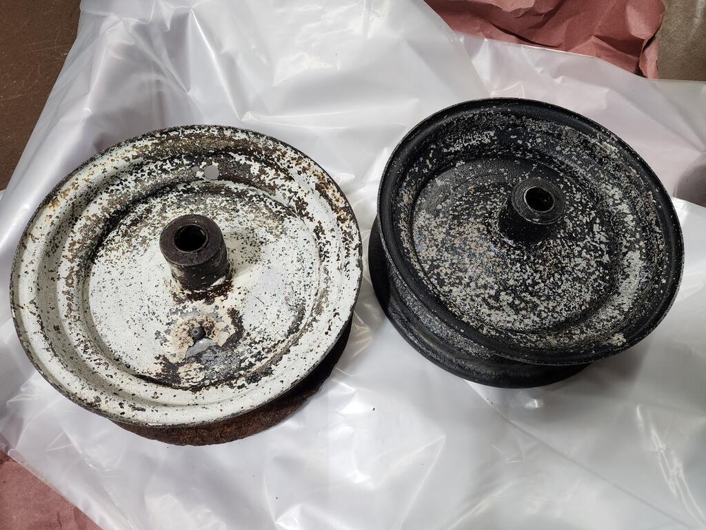

AMC RULES 37,259 #20493 Posted December 30, 2023 Started the process of saving these '55 rims. Can already tell... they will be sexy. 5 1 2 Share this post Link to post Share on other sites

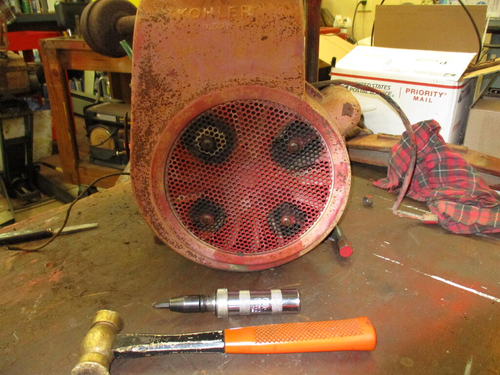

pfrederi 21,091 #20494 Posted December 30, 2023 (edited) I have been working on a C-160-8 that i got cheap at auction last Spring. Got her running and put her away to be this winter project. Drove her back up here a couple weeks ago and started disassembly. I have worked on a bunch of WHs but the "stuckiness" of just about every part on this one is really getting old. Absolutely nothing comes apart with out a lot of effort. Latest road block is the flywheel screen. i actually managed to get all the shroud bolts out with out breaking any but I can't move any of the screen screws. A few days of Kroil, heat, whacking with a brass hammer and several tries with the impact driver ...nada... Edited December 30, 2023 by pfrederi 4 Share this post Link to post Share on other sites
Ed Kennell 47,096 #20495 Posted December 30, 2023 7 minutes ago, pfrederi said: A few days of Kroil, heat, whacking with a brass hammer and several tries with the impact driver ...nada... Time to throw it on the drill press? 1 Share this post Link to post Share on other sites
Handy Don 17,370 #20496 Posted December 30, 2023 12 minutes ago, pfrederi said: Kroil, heat, whacking with a brass hammer and several tries with the impact driver ...nada... Those impact drivers are very cool and my last resort before cutting, drilling and grinding. There have been fails, however. Try tightening to see if you get any movement? 1 1 Share this post Link to post Share on other sites
ebinmaine 80,448 #20497 Posted December 30, 2023 16 minutes ago, Handy Don said: Try tightening to see if you get any movement? That's my go-to as well. If the screws are beyond saving you could also weld a nut to the outside of the screw head. The nut allows MUCH better grip and the heat will often help breaking the rust. 5 Share this post Link to post Share on other sites
ebinmaine 80,448 #20498 Posted December 30, 2023 1 hour ago, AMC RULES said: Started the process of saving these '55 rims. E tank Craig? 1 1 Share this post Link to post Share on other sites
pfrederi 21,091 #20499 Posted December 30, 2023 Had to back off on the heating...started some stuff inside the shroud to smoldering Good idea on tightening will reverse the impact driver when the smoke clears.... 5 Share this post Link to post Share on other sites
