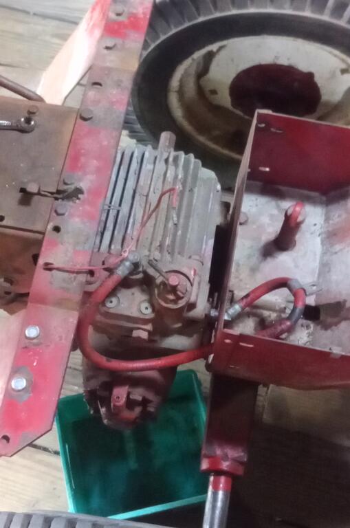

Colby G 248 #20183 Posted November 4, 2023 5 minutes ago, 953 nut said: What type hydro do you have? Sundstrand? Eaton 700? Eaton 1100? What model Wheel Horse are we talking about? I'm not quite sure what kind of hydro, but it's not the original, I just put it in a 1969 charger 12. I will attach a picture if that will help. Share this post Link to post Share on other sites

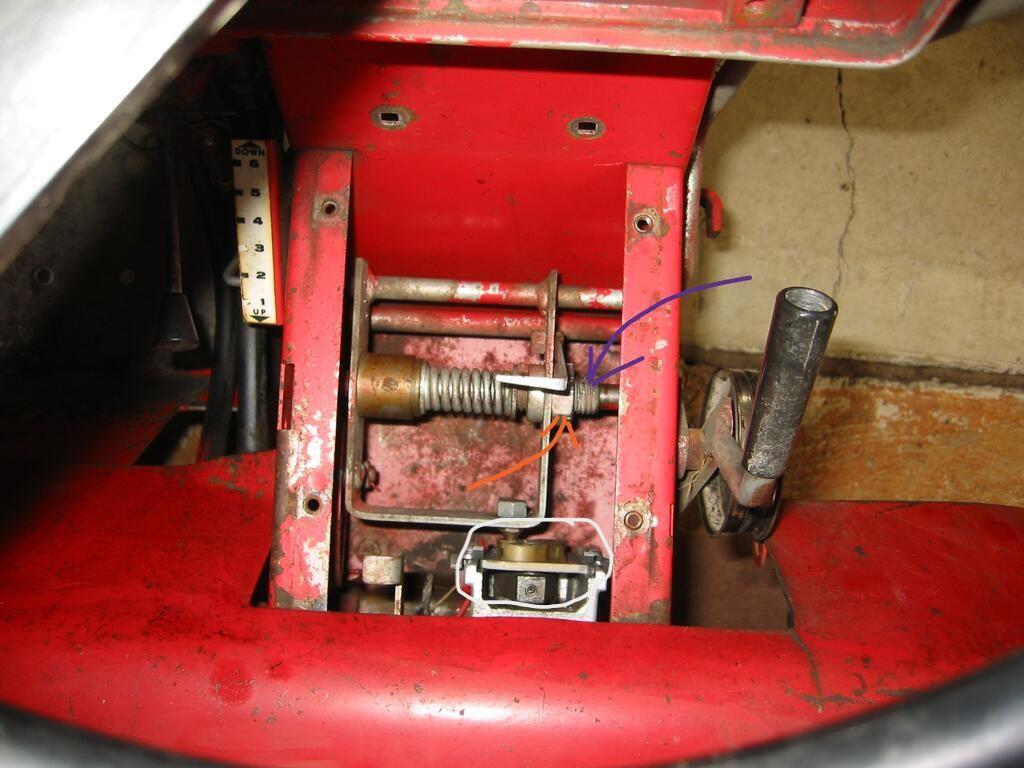

pfrederi 21,091 #20184 Posted November 4, 2023 (edited) Sunstrand Hydrogear That type was used on Chargers and electros. You want some resistance on the forward backward control Maintains speed,, If it is very hard to move loosen the big nut (orange arrow) use 5/8' wrench to loosen the squared threaded shaft Blue arrow . Edited November 4, 2023 by pfrederi 1 2 Share this post Link to post Share on other sites

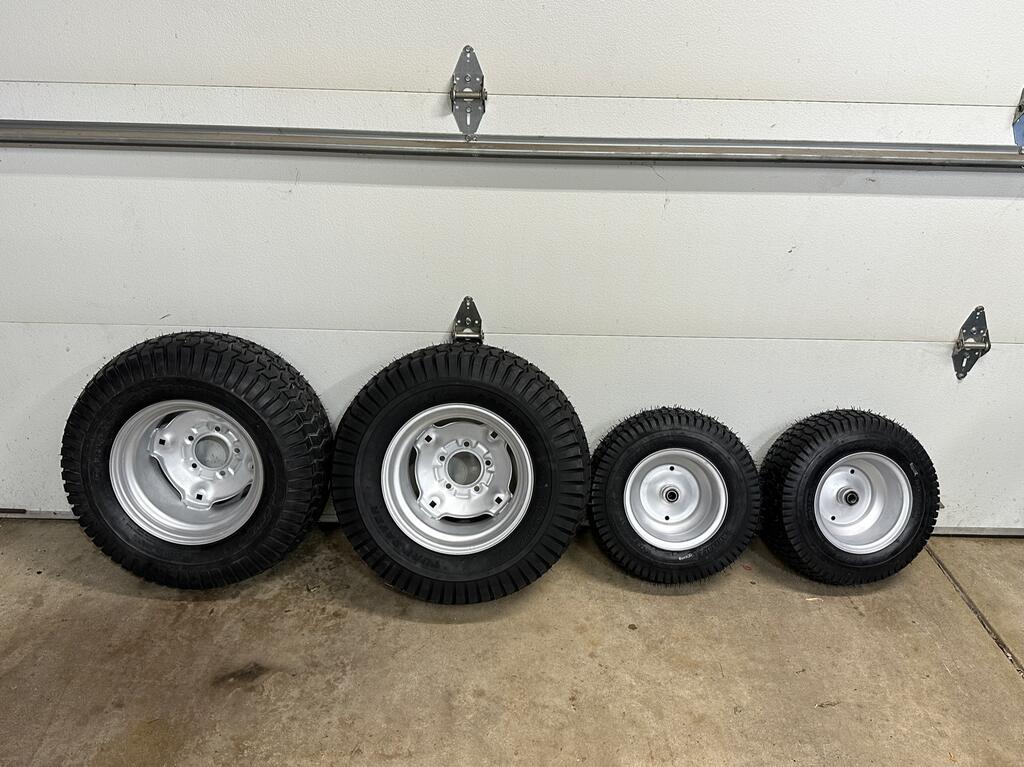

Andy N. 2,806 #20185 Posted November 4, 2023 Cleaned up some wheels and put on new shoes! And new bearings on the fronts! 6 5 Share this post Link to post Share on other sites

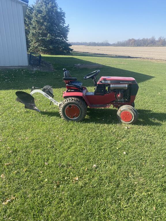

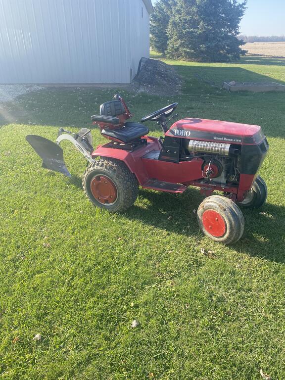

Tonytoro416 1,380 #20186 Posted November 4, 2023 Finally got enough time to try out my Brinly plow. Bought it last fall for 25 bucks I think. Refurbed it last winter and put it in the dirt today for the first time. It was a blast and the 416 pulled it no problem 1 7 Share this post Link to post Share on other sites

Colby G 248 #20188 Posted November 4, 2023 (edited) 4 hours ago, pfrederi said: Sunstrand Hydrogear That type was used on Chargers and electros. You want some resistance on the forward backward control Maintains speed,, If it is very hard to move loosen the big nut (orange arrow) use 5/8' wrench to loosen the squared threaded shaft Blue arrow . That didn't seem to do anything. It moves a little bit, but then stops. Edited November 4, 2023 by Colby G Share this post Link to post Share on other sites

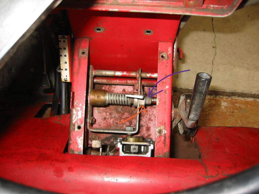

pfrederi 21,091 #20190 Posted November 5, 2023 16 hours ago, Colby G said: That didn't seem to do anything. It moves a little bit, but then stops. When you move the speed control lever does the white plastic plate (circled) move up and down? Take a picture of yours 2 1 Share this post Link to post Share on other sites
953 nut 68,735 #20191 Posted November 5, 2023 22 hours ago, Colby G said: I just put it in a 1969 charger 12. 37 minutes ago, pfrederi said: When you move the speed control lever does the white plastic plate (circled) move up and down? Was the shifter working properly on the tractor you removed the hydro from? If the plastic cam follower is not aligned properly or has cracked that would be the most likely problem. Share this post Link to post Share on other sites
Colby G 248 #20192 Posted November 5, 2023 1 hour ago, pfrederi said: When you move the speed control lever does the white plastic plate (circled) move up and down? Take a picture of yours No it does not. Share this post Link to post Share on other sites
953 nut 68,735 #20193 Posted November 5, 2023 you have a LOT of tension in that spring. compare it to the photo Paul @pfrederi sent of his. You may want to start by backing off on the sprind a few turns. 2 Share this post Link to post Share on other sites
Colby G 248 #20194 Posted November 5, 2023 6 minutes ago, 953 nut said: you have a LOT of tension in that spring. compare it to the photo Paul @pfrederi sent of his. You may want to start by backing off on the sprind a few turns. How do I do that? Share this post Link to post Share on other sites
Ed Kennell 47,091 #20195 Posted November 5, 2023 On 11/4/2023 at 2:02 PM, Colby G said: I'm not quite sure what kind of hydro, but it's not the original, I just put it in a 1969 charger 12. I will attach a picture if that will help. You also need to close the tow valve. It should be L-R for towing and front-rear for driving. If that doesn't work, try the reverse. Been a long time since I had a Sundstrand. 1 Share this post Link to post Share on other sites
Colby G 248 #20196 Posted November 5, 2023 8 minutes ago, Ed Kennell said: You also need to close the tow valve. It should be L-R for towing and front-rear for driving. If that doesn't work, try the reverse. Been a long time since I had a Sundstrand. So this may sound like a dumb question, but how do I close the tow valve, and what is the tow valve? Share this post Link to post Share on other sites

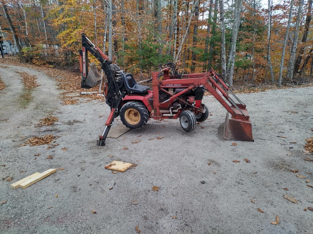

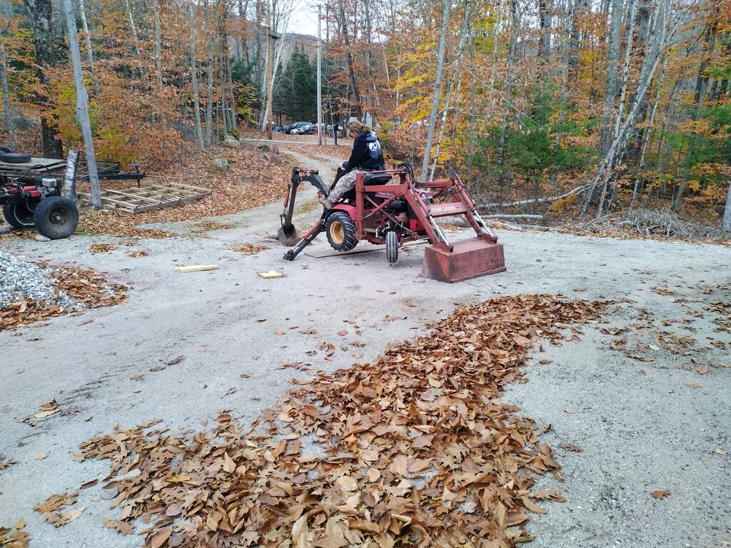

ebinmaine 80,445 #20199 Posted November 5, 2023 We've been digging out several stumps that were in a cluster where the driveway used to border the forest. After the barn was built the trees stayed in place because I wanted to keep them. Issue there was the power company couldn't run the incoming line unless those trees were cut out. For a few months the stumps have been a minor bump in the yard. We want to get em out before snowfall so it'll be easier to plow. Made some headway. Started with the backhoe. Rest of the work is with shovels, hand hoe, and huge crowbar. Roots will be cut with a sawzall. 4 3 1 Share this post Link to post Share on other sites
