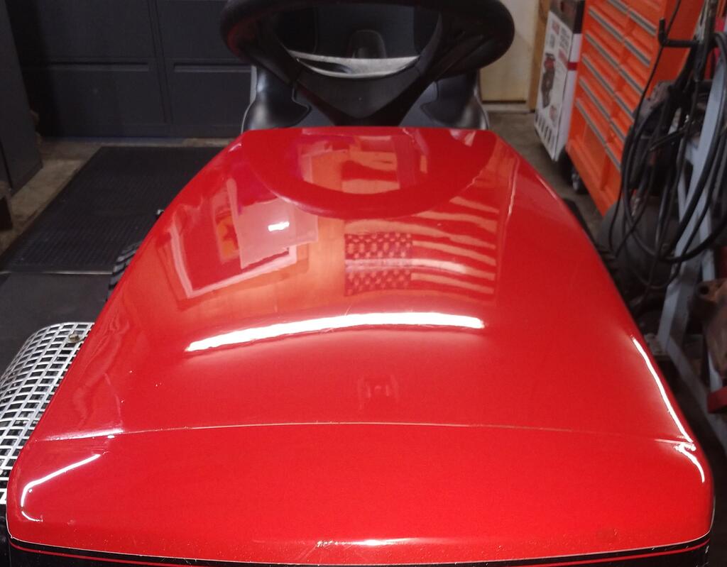

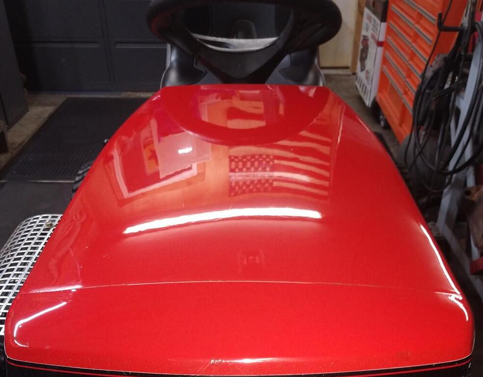

kpinnc 19,033 #20126 Posted October 28, 2023 I polished another hood today. Not perfect, because it's 25 years of scrapes and dings. But still pretty awesome for 20 minutes worth... 1 12 Share this post Link to post Share on other sites

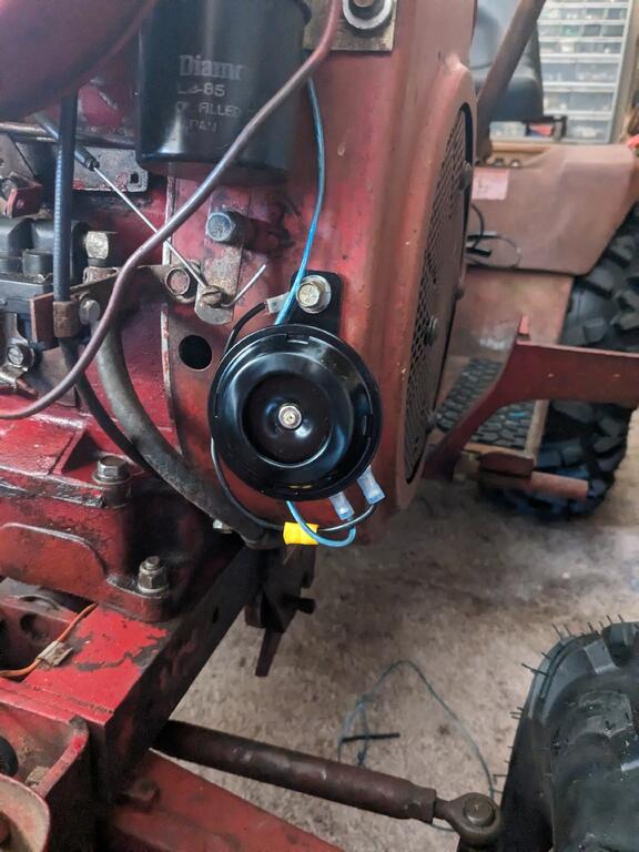

Treepep 1,151 #20130 Posted October 28, 2023 Unnecessary. Ole C 120 has a horn now 4 6 1 Share this post Link to post Share on other sites
ebinmaine 81,032 #20131 Posted October 28, 2023 11 minutes ago, Treepep said: Unnecessary. Ole C 120 has a horn... A horn... Not necessary? Oh no no. Gotta have a horn. Or bell. 5 Share this post Link to post Share on other sites

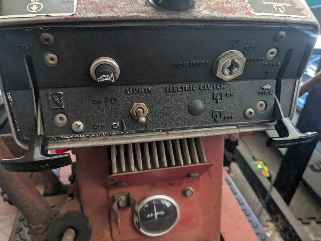

Handy Don 17,623 #20132 Posted October 28, 2023 1 hour ago, Treepep said: Unnecessary. Ole C 120 has a horn now 1 hour ago, ebinmaine said: Oh no no. Gotta have a horn. Or bell. And who needs a cigarette lighter anymore?! 3 Share this post Link to post Share on other sites

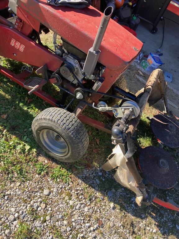

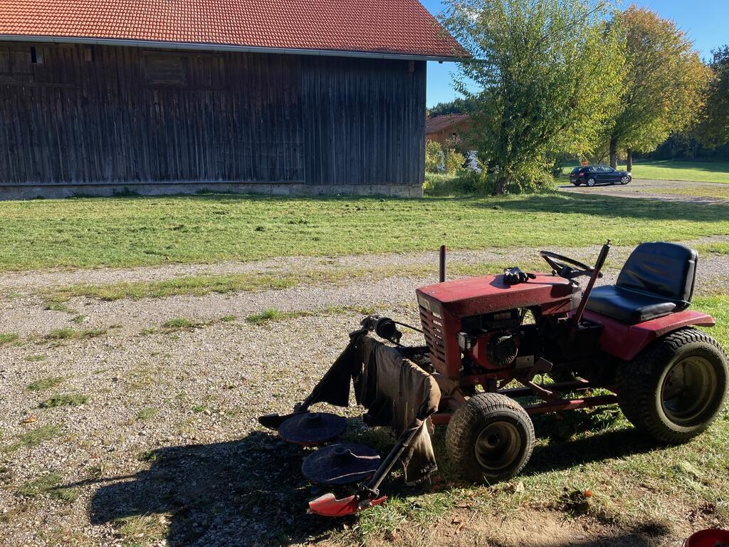

Tractorhead 9,218 #20133 Posted October 28, 2023 Main Mowerdeck was hard at its limit with the extremly high and wet Grass. Chewed it more than mowing.. At least i decide to stop it and cleaned up the Mowerdeck for its Winterbreak. Than i mounted the Plow frame under the Horse for the „Massacre Mower“. Finalized it‘s massacre in the Background. With a new Belt all is fine. 1 9 1 Share this post Link to post Share on other sites
ebinmaine 81,032 #20134 Posted October 28, 2023 2 hours ago, Handy Don said: And who needs a cigarette lighter anymore?! Gotta have a place to charge yer phone while mowing..... 🙄 2 1 Share this post Link to post Share on other sites
Handy Don 17,623 #20135 Posted October 28, 2023 23 minutes ago, ebinmaine said: Gotta have a place to charge yer phone while mowing..... 🙄 I was waitin’ for someone to bring that up. I added a socket to the camp tractor because there is no electricity there. Mowing time is charging time! 3 2 Share this post Link to post Share on other sites

8ntruck 9,358 #20144 Posted October 29, 2023 @Tractorhead what is the story on the muffler on your 'massacre mower' machine? Looks like it might have been one of your projects. Any details on how you built it? 1 Share this post Link to post Share on other sites

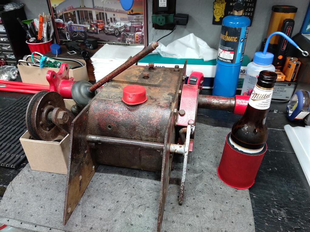

ML3 2,551 #20145 Posted October 29, 2023 Transmission I bought at the big show. Started working on it. Using it in my rat rod Suburban. Transmission I got w/tractor was shot- full of water. Still have some parts to strip off the old/bad transmission. 5 Share this post Link to post Share on other sites
peter lena 10,100 #20146 Posted October 29, 2023 @ML3 like the LUCAS CLIMBING GEAR LUBE , tried it on one horse , now in all 3 of them , very quiet / smooth , also put a tye wrap just above the inside greased shifter boot , on the metal shifter stick , holds it in place , makes them last , pete 1 1 Share this post Link to post Share on other sites

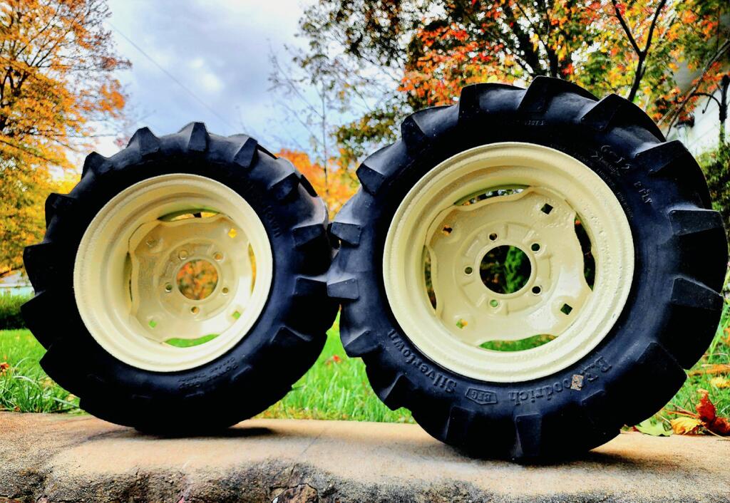

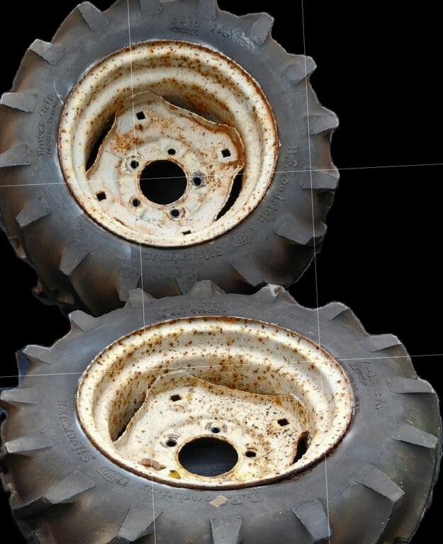

AMC RULES 37,260 #20147 Posted October 29, 2023 Rescued another set. 4 10 Share this post Link to post Share on other sites
ebinmaine 81,032 #20148 Posted October 29, 2023 5 minutes ago, AMC RULES said: Rescued another set. Well done Craig. You dismount the tires or clean everything as is? 1 Share this post Link to post Share on other sites
ML3 2,551 #20149 Posted October 29, 2023 On 10/28/2023 at 2:13 PM, ebinmaine said: A horn... Not necessary? Oh no no. Gotta have a horn. Or bell. I have put a horn on my C105. My girlfriend knows when I blow horn that I most likely need another beer 🍻! Lol 7 Share this post Link to post Share on other sites
Tractorhead 9,218 #20150 Posted October 30, 2023 12 hours ago, 8ntruck said: @Tractorhead what is the story on the muffler on your 'massacre mower' machine? Looks like it might have been one of your projects. Any details on how you built it? Yap, was one of my Projects. when i started the Engine swap, i find the Original Muffler on this Engine too Trashy for a nice looking it should be an typical pipe up in the Air. After porting the Outlet and ad bigger exhaust valve on the Engine, i more have also the need for a little bigger Exhaust. Sadly not much picts, but i hope a simple description is enough. on my horse was a half rotten mini muffler pepperbox on, but that sounds for me too flat. i like to have a deeper and more voluminous Sound.. so i decided to do a Testdrive, if i can solve my wish. As base i use the inlet of the old Original muffler what was a metalpipe with 3/4“ dia and about10cm in lenght. This Pipe was pitted with holes with about 3mm in dia and each 1/4“ in lenght arround the pipe. but it was not complete so i used it as template to make me a 3/4“ pipe and redo it like the original was. Than i cut it in half in the middle of its lenght about 5 cm and build 2 Chamber sections. the Rectangle pipe was a piece of Steelpipe i had laying arround with about 2“ diameter. The inlay was a Pipe with 1“ and be welded into the Rectangle pipe to give it more nice lookout. The resonance chamber is 8 cm after the intake from bottom than first chambersection is welded in than a couplerplate and again a chamber with 28,5 cm is set on top for forming the Accoustic. To flatened the typical Pipesound i need an additional silencer what is simply a 3/4“ pipe with 4cm length screwed into the outet it is at 31cm from the second chamber begin where it results in its best Accoustic. so i got a very nice Soundambiente, until i opened the throttle to full. Than it „barks“ as it should in a warm deep sound. Simple straight forward. 3 Share this post Link to post Share on other sites
