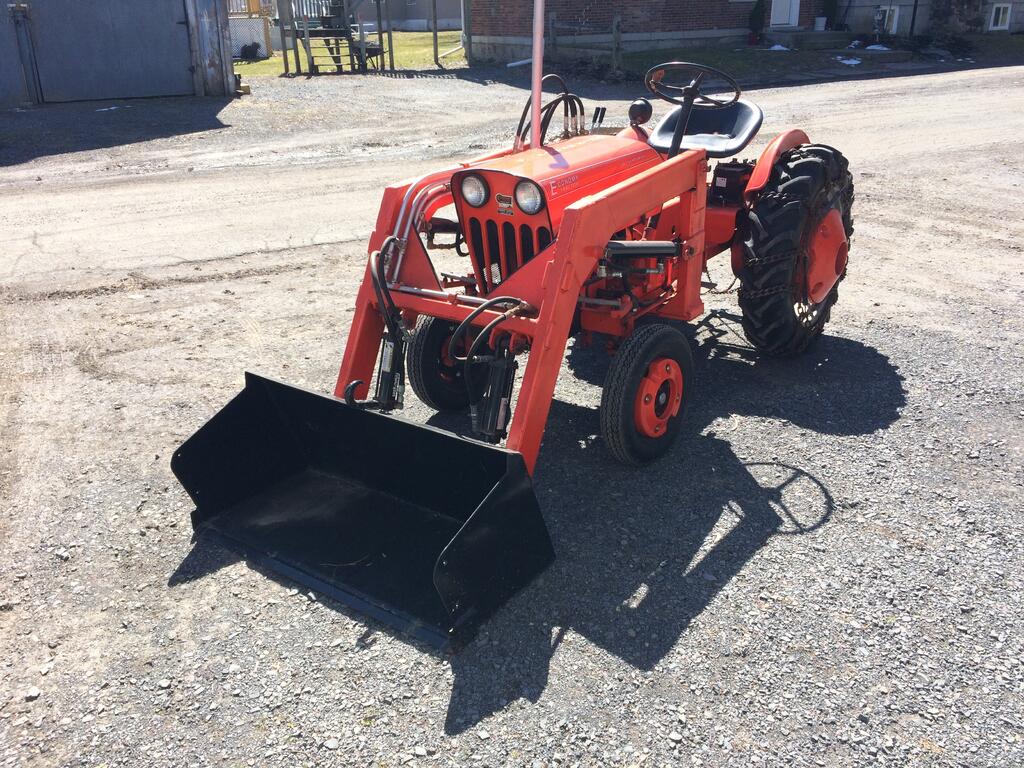

squonk 48,277 #19852 Posted August 28, 2023 (edited) 57 minutes ago, Ed Kennell said: Have Billy Bob grind a vee to the inside, weld it, grind it flush, then weld on a scab plate. Then It won't break like this one did in only 50 years. It should last for ~ . This guy is a certified welder, Vietnam vet, former Air Marshal, and Former Foundry foreman. Patches decks back together and the only way you can tell is by the paint. He races go karts and builds 2 cycle race motors. A'int much he doesn't know. He built my Power King Loader Edited August 28, 2023 by squonk 1 12 Share this post Link to post Share on other sites

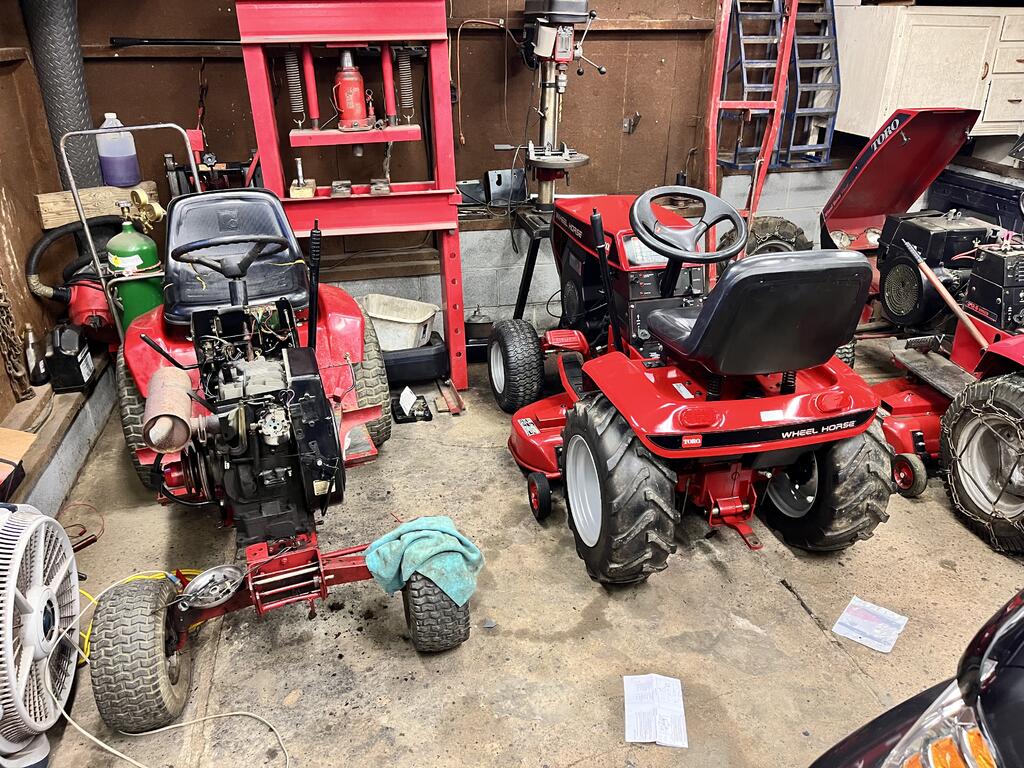

ineedanother 2,885 #19853 Posted August 28, 2023 4 hours ago, squonk said: I've noticed the hood on my C-160 doesn't always want to fit on the hood stand correctly. The other day when lowering the heavy recycler deck I noticed the hood and hood stand moving in different directions. I knew exactly where I had to look. Hood stand cracked right below the lift arm. Had to remove the running board, brake rod and brake pedal, hyd. lift control and cylinder to get enough access. I have an appt. with Billy Bob the welder on Thursday. I picked up a used hood stand for mine since my welding skills are about as good as my ex-wife's credit score and I don't have anyone local with any time for small jobs. My F-bracket is cracked too so I'm just having to bite the bullet and dig deep for work space to take care of it all at once. I love the c-series regardless of a few weak points in the engineering. 3 1 2 Share this post Link to post Share on other sites

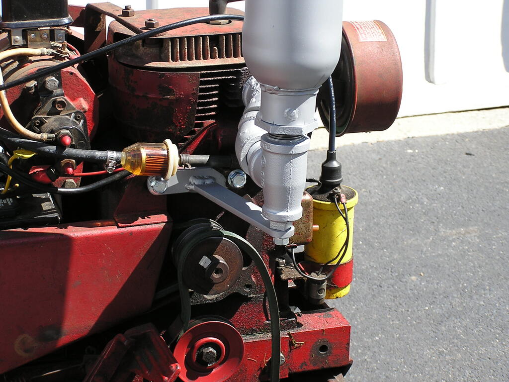

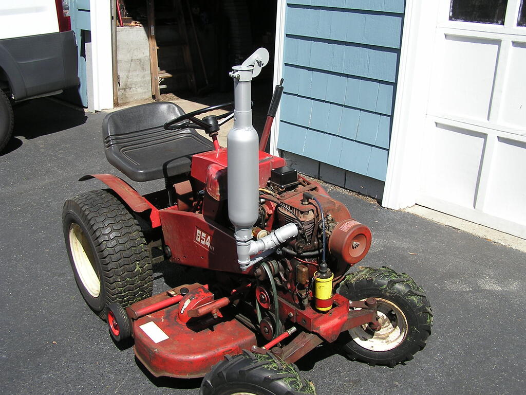

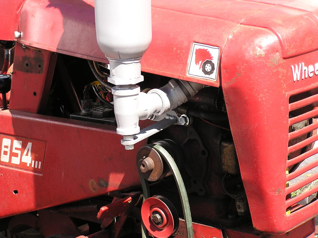

ri702bill 13,259 #19857 Posted August 31, 2023 Finally finished the homemade stack muffler for the 854. Consists of a 12" MagnaFlow glasspack muffler, cut down 1.75 ID x 1.75 OD extension, various 1" pipe fittings and the all important lower bracket to the engine to support it. Decided to do the "tink-tink-tink" rain cap instead of a turnout. What is NOT shown is the device inside to give the engine a bit of necessary back pressure. Looks & sounds fine. You need the double 45 degree fittings to drop the pipe to get it away from the hood. You DO need to readjust the carb after installing one of these. Bill 8 7 Share this post Link to post Share on other sites

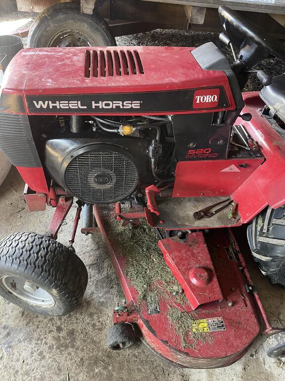

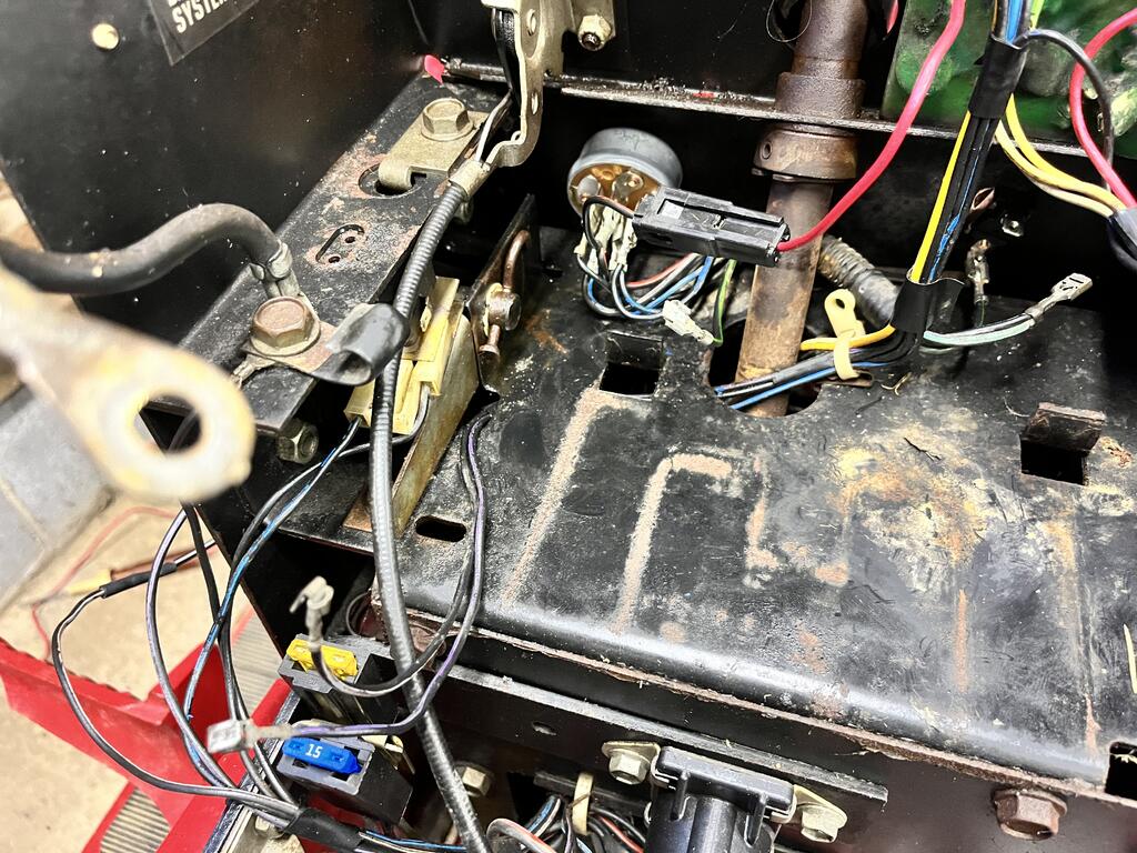

Wvtroutbum81 327 #19858 Posted September 1, 2023 Got the 1987 312-8 to run for a few seconds on carb cleaner after rebuilding the systems. Need to clean tank and get a new cap. The old ignition switch was a 6 pin, i put a five pin in it but do not have it wired correctly and cant figure it out. I have the wiring diagram but its greek to me😂 oh yeah this thing sat in a field for 20+ years. 5 Share this post Link to post Share on other sites

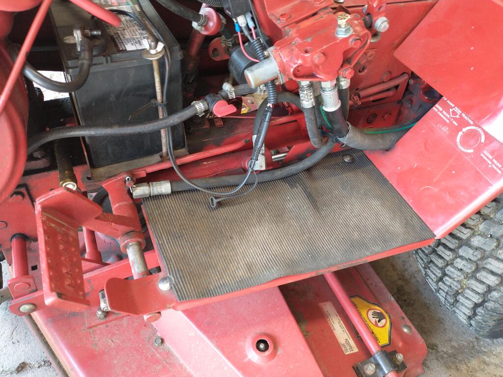

squonk 48,277 #19859 Posted September 1, 2023 (edited) My appt. with Billy Bob was delayed a day due to medical issues. Billy was still off of his feed today but he managed to get the C-160 welded back together. He used a heavy washer as a plate. More surface area to weld on and he explained the roundness will be harder to break than just another flat piece of metal. Just got to metal finish it and it will be ready for primer and paint. Edited September 1, 2023 by squonk 6 2 Share this post Link to post Share on other sites

squonk 48,277 #19862 Posted September 1, 2023 All back together. Ready to mow. 6 Share this post Link to post Share on other sites

ebinmaine 81,032 #19864 Posted September 1, 2023 9 hours ago, Wvtroutbum81 said: The old ignition switch was a 6 pin, i put a five pin in it but do not have it wired correctly and cant figure it out. I have the wiring diagram Wiring schematics seem to challenge a LOT of people. They really aren't that complicated if you separate out all the individual circuits. To begin with.... get the right switch. It might solve the problem. Might not. But you really should start the repair with the correct parts instead of wondering why the wrong ones don't work. 3 Share this post Link to post Share on other sites

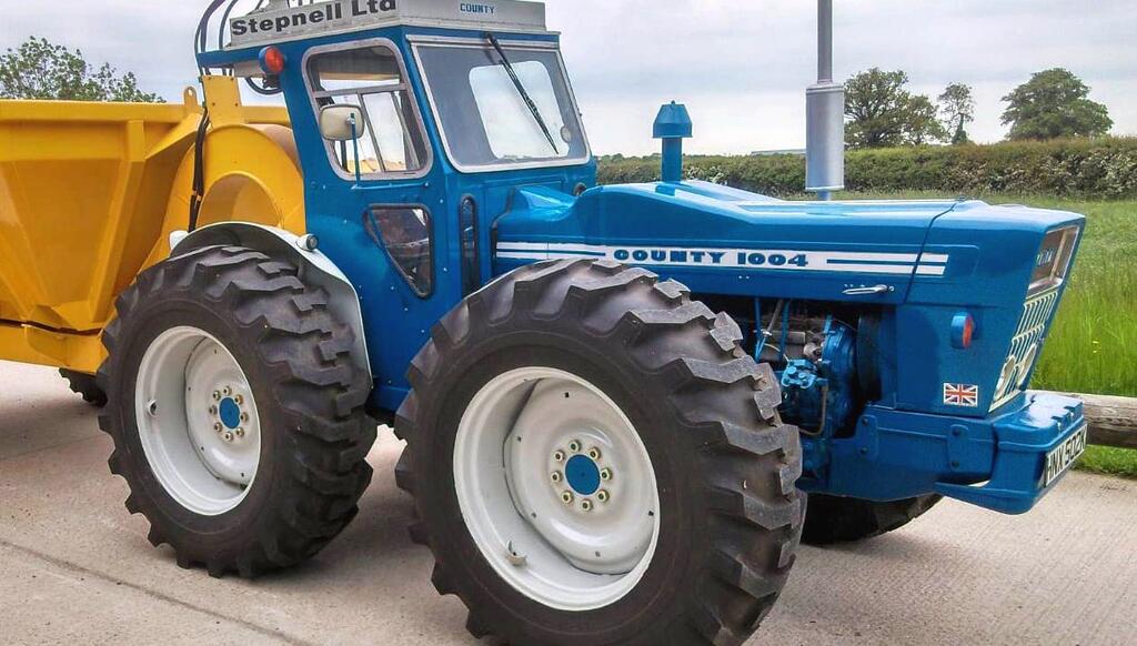

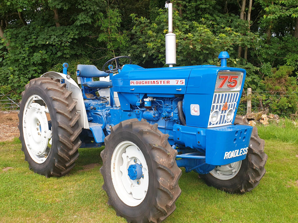

sjoemie himself 3,263 #19867 Posted September 2, 2023 The horn and the face, classic Been thinking what the cinnamon horse reminded me of, now it hit me; Ford County/roadless. 2 Share this post Link to post Share on other sites
ebinmaine 81,032 #19868 Posted September 2, 2023 18 minutes ago, sjoemie himself said: Been thinking what the cinnamon horse reminded me of, now it hit me; Ford County/roadless. What is that ? Share this post Link to post Share on other sites
sjoemie himself 3,263 #19869 Posted September 2, 2023 (Ford) County (Ford) Roadless 2 2 1 Share this post Link to post Share on other sites
