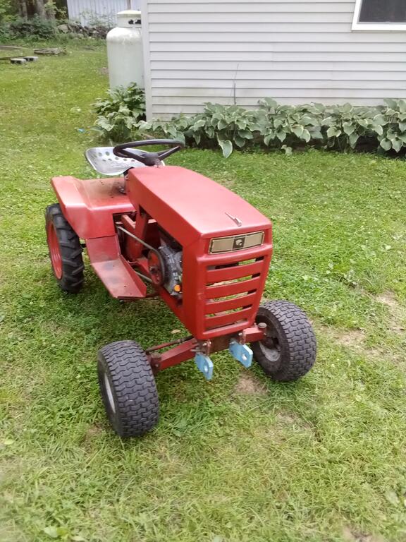

Colby G 248 #19727 Posted July 31, 2023 Got new headlights and hood ornament installed 7 4 Share this post Link to post Share on other sites
Sparky-(Admin) 26,004 #19728 Posted July 31, 2023 27 minutes ago, Colby G said: Those are some SKINNY rear tires. What size are they? Share this post Link to post Share on other sites
Colby G 248 #19729 Posted July 31, 2023 2 minutes ago, Sparky said: Those are some SKINNY rear tires. What size are they? 5-12. They are the ones I bought it with. 1 Share this post Link to post Share on other sites

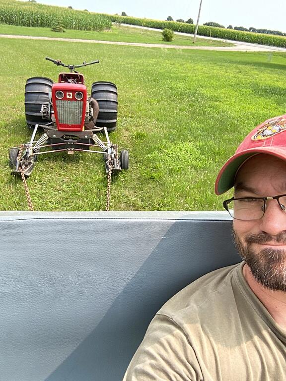

Pullstart 70,847 #19730 Posted August 1, 2023 Took my snowmowtractor for a ride… 1 Share this post Link to post Share on other sites
wallfish 20,251 #19731 Posted August 1, 2023 41 minutes ago, Pullstart said: Took my snowmowtractor for a ride… You know very well that didn't happen without supplying a video! LoL Still slipping? Did the ride give you any motivation to get back at again? 1 Share this post Link to post Share on other sites

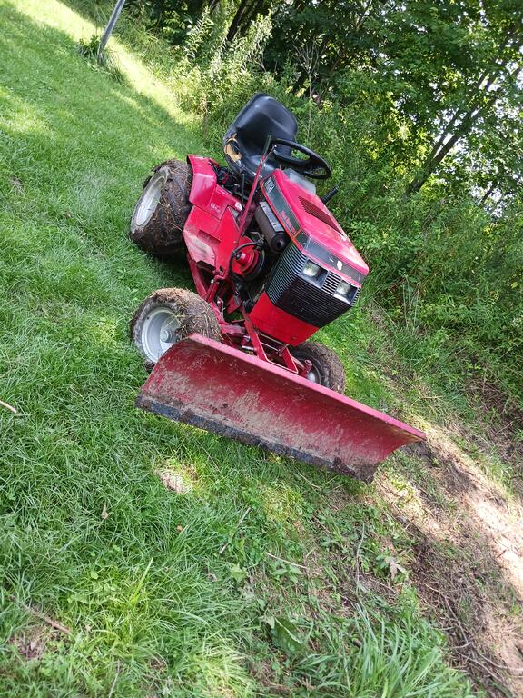

TJ5208 1,841 #19732 Posted August 1, 2023 Leveled more ground today 4 2 Share this post Link to post Share on other sites
Pullstart 70,847 #19733 Posted August 2, 2023 5 hours ago, wallfish said: You know very well that didn't happen without supplying a video! LoL Still slipping? Did the ride give you any motivation to get back at again? you’re getting ahead of yourself! 2 9 Share this post Link to post Share on other sites
Colby G 248 #19734 Posted August 2, 2023 29 minutes ago, Pullstart said: you’re getting ahead of yourself! Omg, that thing is awesome! 1 Share this post Link to post Share on other sites
Pullstart 70,847 #19735 Posted August 2, 2023 35 minutes ago, Colby G said: Omg, that thing is awesome! Thanks! It started as an idea and 2 weeks later it rolled out of the shop! 1 Share this post Link to post Share on other sites

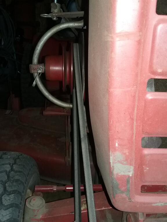

8ntruck 9,101 #19737 Posted August 3, 2023 (edited) Dropped the SD deck off of the C-195 today and put it under the 14-8. No PTO clutch problems with the SD deck when I mowed today. This means I'll need to get into the RD deck to see what is dragging and was causing the PTO clutch to slip on the 14-8 last time I went to mow. While changing the decks, I did notice that the pullies on the mule drive seem to be offset towards the frame, causing the side of the belt to rub on the pulley flange as it exits the pulley. Got a strange wear pattern on the pulley flange. Will have to figure out some spacers for the mule drive to get this corrected. Edited August 3, 2023 by 8ntruck 1 Share this post Link to post Share on other sites

oliver2-44 11,651 #19741 Posted August 4, 2023 On 8/2/2023 at 7:22 PM, 8ntruck said: Dropped the SD deck off of the C-195 today and put it under the 14-8. No PTO clutch problems with the SD deck when I mowed today. This means I'll need to get into the RD deck to see what is dragging and was causing the PTO clutch to slip on the 14-8 last time I went to mow. While changing the decks, I did notice that the pullies on the mule drive seem to be offset towards the frame, causing the side of the belt to rub on the pulley flange as it exits the pulley. Got a strange wear pattern on the pulley flange. Will have to figure out some spacers for the mule drive to get this corrected. The mule drive has 2 spacers and they are different lengths. I don’t have the measurements, but maybe someone on here can post the correct spacer lengths and what order they install Share this post Link to post Share on other sites
8ntruck 9,101 #19742 Posted August 4, 2023 (edited) I had the mule drive apart giving it the Greasy Pete treatment last fall. I'm pretty sure I got the spacers back in the right order, but...... Just by eyeball, it looks like the pulleys need to come out somewhere on the order of 1/4 to 3/8 inch. Edited August 4, 2023 by 8ntruck 1 Share this post Link to post Share on other sites
Lee1977 7,720 #19743 Posted August 4, 2023 There are two spacers a5/8" Share this post Link to post Share on other sites
Lee1977 7,720 #19744 Posted August 4, 2023 (edited) There are two spacers a 5/8" between the pulleys abd a 1/2" on the out side that is not your problem . There is a 5/8" spacer behind the v-groove pulley that is welded to the shaft, I think the weld has broken loose that will allow that spacer to move back 3/8" to 7/16". Some heavy handed must have over tightened and broken that weld as one of mine is just spot welded. Edited August 4, 2023 by Lee1977 2 Share this post Link to post Share on other sites

peter lena 9,971 #19747 Posted August 5, 2023 @8ntruck looks like the pulleys were installed wrong , that inner down drive belt , should be going to a v notch pulley , the other return side should be the flat idler, easy swap . always lay that out , as was built , easy fix pete Share this post Link to post Share on other sites
8ntruck 9,101 #19748 Posted August 5, 2023 3 hours ago, peter lena said: @8ntruck looks like the pulleys were installed wrong , that inner down drive belt , should be going to a v notch pulley , the other return side should be the flat idler, easy swap . always lay that out , as was built , easy fix pete I've got the V pulley on the inside and the flat pulley on the outside of the mule drive. Bad picture. I had intended to include the pulleys in the bottom of the picture. Didn't notice that I missed them until I posted the picture. Share this post Link to post Share on other sites

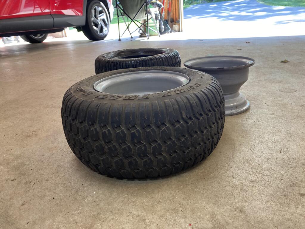

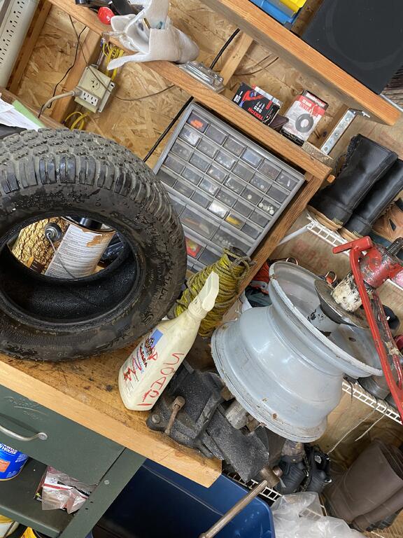

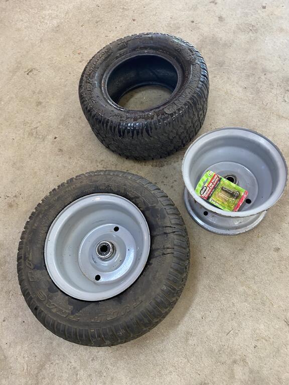

Sparky-(Admin) 26,004 #19750 Posted August 6, 2023 Mounted up front tires on wheels I bought from @squonk at this years WHS. Thanks Mike! Just might be the nicest wheels in my small fleet 3 4 Share this post Link to post Share on other sites
