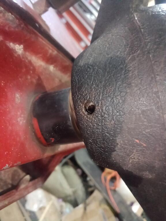

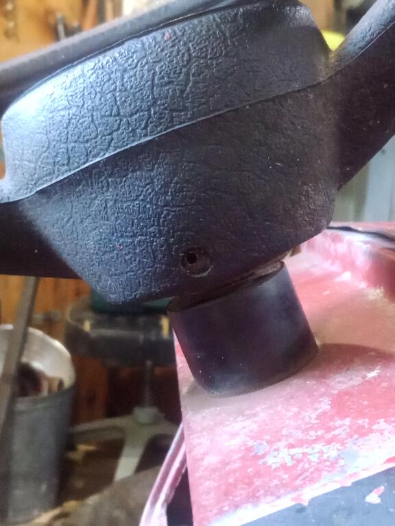

Colby G 248 #19655 Posted July 27, 2023 22 hours ago, Handy Don said: Yes. Search this site for “remove steering wheel” or “steering wheel removal” (flip the “use all my keywords” switch on and choose “Topics” as the area to search Numerous threads with info. There is either a Spirol or a Roll Pin through the hub of the wheel and the steering shaft. Removing one that’s nature welded (rusted) in place can be a real challenge--one of the WH rites of passage, I’d say, along with a stuck wheel hub or a stuck rear hitch pin. Is this what I need to get out? If so, how do I get it out? 1 Share this post Link to post Share on other sites

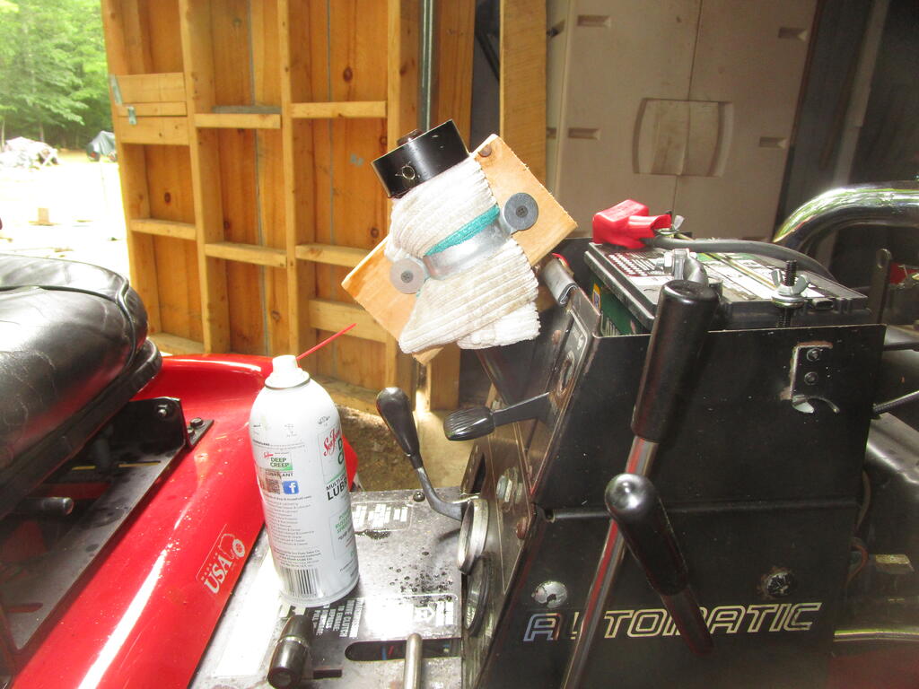

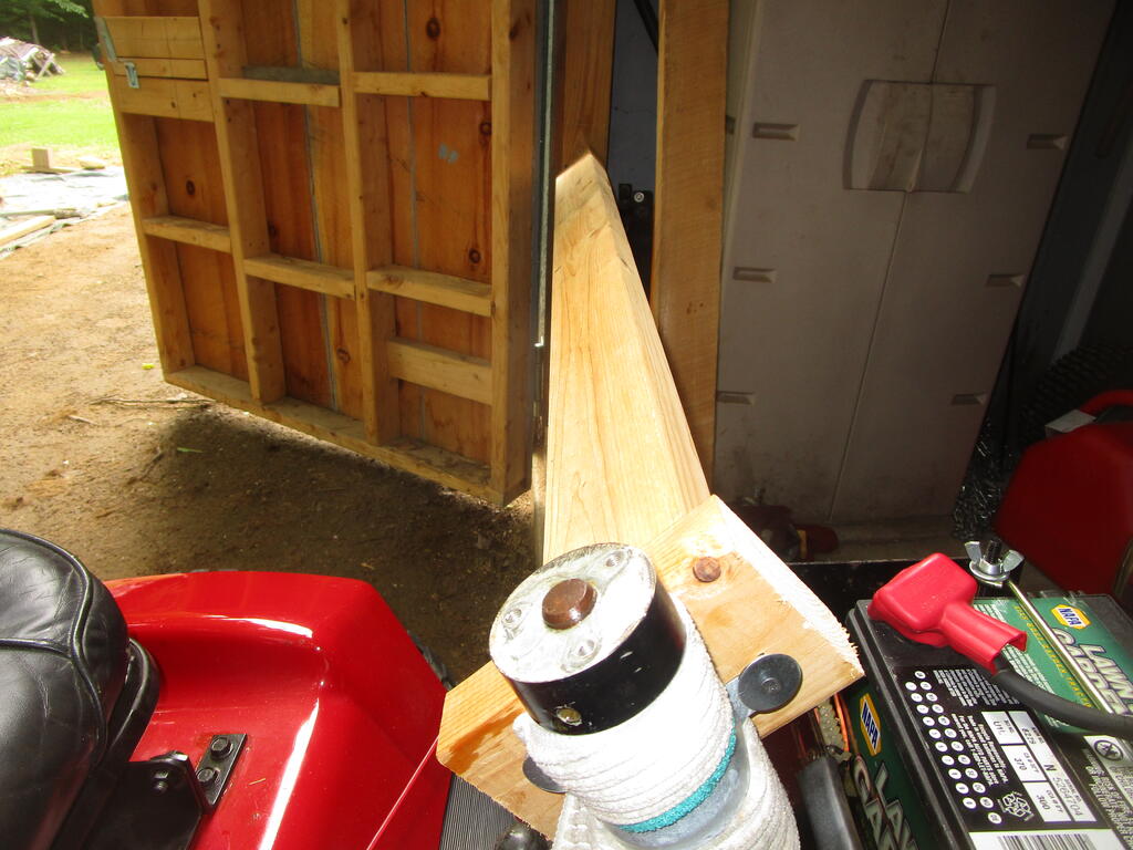

pfrederi 21,268 #19658 Posted July 27, 2023 1/4" roll pin pinch after lots of soaking with the bug juice of your choice. Use a 2x4 to brace the steering column against the wall as you beat on the punch 3 Share this post Link to post Share on other sites
JCM 11,419 #19659 Posted July 27, 2023 10 minutes ago, pfrederi said: 1/4" roll pin pinch after lots of soaking with the bug juice of your choice. Use a 2x4 to brace the steering column against the wall as you beat on the punch Brace makes quite a difference. Different tractor, same procedure. 2 6 Share this post Link to post Share on other sites

ebinmaine 81,032 #19662 Posted July 27, 2023 28 minutes ago, JCM said: Brace makes quite a difference. Different tractor, same procedure. @Colby G Jim's pic. This is the way. 2 Share this post Link to post Share on other sites
Handy Don 17,623 #19663 Posted July 28, 2023 It is likely that you’ve mushroomed the end of the roll pin using the flat-ended punch. Now it’ll be that much harder to move it and probably easier from the other side. You can be lucky, like @Evguy, but most of the time there is no shortcut. @JCM’s way is THE way--this is the way that worked for me after a week of letting it soak with penetrant. At least one other member has simply cut the steering shaft, dealt with the wheel on a press, and then welded the shaft back together. As I noted earlier, take some minutes to search the site and read others’ approaches and experiences. There are around 15 years of useful knowledge posted here by folks who know their stuff. 3 Share this post Link to post Share on other sites

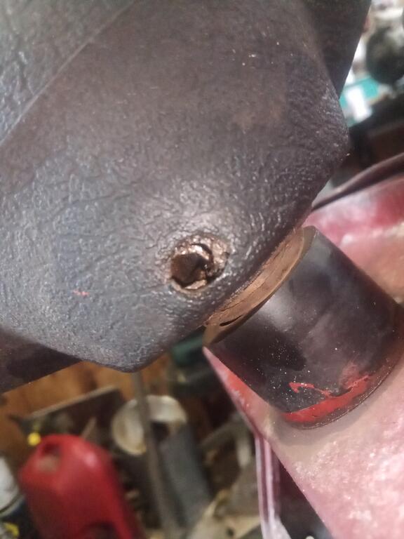

Colby G 248 #19664 Posted July 28, 2023 (edited) 14 minutes ago, Handy Don said: It is likely that you’ve mushroomed the end of the roll pin using the flat-ended punch. Now it’ll be that much harder to move it and probably easier from the other side. You can be lucky, like @Evguy, but most of the time there is no shortcut. @JCM’s way is THE way--this is the way that worked for me after a week of letting it soak with penetrant. At least one other member has simply cut the steering shaft, dealt with the wheel on a press, and then welded the shaft back together. As I noted earlier, take some minutes to search the site and read others’ approaches and experiences. There are around 15 years of useful knowledge posted here by folks who know their stuff I don't think the pin is full, there isn't anything on the other end. And how do I set up @JCM 's way with the wheel still on? And how would I do it? Edited July 28, 2023 by Colby G Share this post Link to post Share on other sites
Handy Don 17,623 #19665 Posted July 28, 2023 (edited) 9 minutes ago, Colby G said: I don't think the pin is full, there isn't anything on the other end. If the wheel isn’t spinning on the shaft, the pin is in there. From your picture, it doesn’t look like it was all the way centered. A roll pin (or Spirol pin) isn’t like a bolt. It expands outward to press against the sides of the hole nearly all the way around and for its entire length. That is why when they rust in they can be extremely hard to remove. Better for you, then, if the other side isn’t protruding so you’ll be able to get the correct size roll pin punch to seat right on the pin with the hole in the steering wheel shell to help guide it. Too small a punch will mess up the pin or break. Too large will jam in the hole. You NEED the right tool to be sure to do this right. Friendly warning--haste in this matter will frustrate you. This is where patience pays. Edited July 28, 2023 by Handy Don 5 Share this post Link to post Share on other sites
Colby G 248 #19666 Posted July 28, 2023 (edited) 5 minutes ago, Handy Don said: If the wheel isn’t spinning on the shaft, the pin is in there. From your picture, it doesn’t look like it was all the way centered. A roll pin (or Spirol pin) isn’t like a bolt. It expands outward to press against the sides of the hole nearly all the way around and for its entire length. That is why when they rust in they can be extremely hard to remove. Better for you, then, if the other side isn’t protruding so you’ll be able to get the correct size roll pin punch to seat right on the pin with the hole in the steering wheel shell to help guide it. Too small a punch will mess up the pin or break. Too large will jam in the hole. You NEED the right tool to be sure to do this right. Friendly warning--haste in this matter will frustrate you. This is where patience pays. Well as you may be able to see in one of my previous posts, the pin has been mushroomed. Could the tool still be used? And how do you use the tool? Edited July 28, 2023 by Colby G Share this post Link to post Share on other sites
Handy Don 17,623 #19667 Posted July 28, 2023 (edited) The roll pin isn’t intended to stick out on either side. It is intended to fit through the steering wheel collar (on both sides) and the steering shaft and be flush on both ends. Someone has been there before you and left the pin pushed partly to one side. This is not like a cotter or other pin that would allow the wheel to have some looseness on the shaft. You should google roll pins or spirol pins to get an understanding of what you are facing. Using the roll pin punch (a decent set is not expensive on Amazon or other places) is still the best option. Use it from the OTHER side where it’ll fit into the hole in the steering collar and, depending on how off-center the pin is, maybe even into the steering shaft. My guess is that the pin is about ½ inch or so off center. This topic is really for mentioning things you’ve done today to your horse. You should start a new thread with an appropriate topic to have an interactive conversation. Again, I recommend heartily doing some searching on this side and reading up on what you are attempting. Edited July 28, 2023 by Handy Don 1 1 Share this post Link to post Share on other sites
Colby G 248 #19668 Posted July 28, 2023 1 minute ago, Handy Don said: The roll pin isn’t intended to stick out on either side. It is intended to fit through the steering wheel collar (on both sides) and the steering shaft and be flush on both ends. Someone has been there before you and left the pin pushed partly to one side. This is not like a cotter or other pin that would allow the wheel to have some looseness on the shaft. You should google roll pins or spirol pins to get an understanding of what you are facing. Using the roll pin punch (a decent set is not expensive on Amazon or other places) is still the best option. Use it from the OTHER side where it’ll fit into the hole in the steering collar and, depending on how off-center the pin is, maybe even into the steering shaft. My guess is that the pin is about ½ inch or so off center. Well something else I should mention is that I did try the flat end punch a little bit on the other side, but not much. I cannot see how much damage it did, but I don't know if the tool would fit. Would it be better to drill it out? Share this post Link to post Share on other sites
