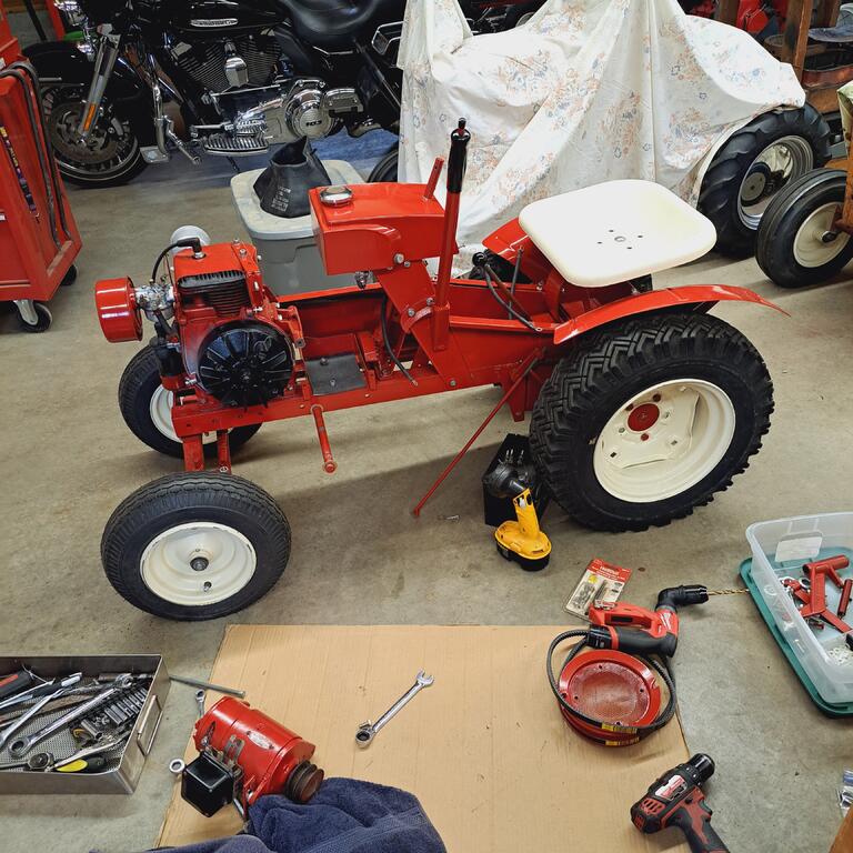

TJ5208 1,841 #19606 Posted July 24, 2023 Got a deck put on the 520-8 3 3 Share this post Link to post Share on other sites

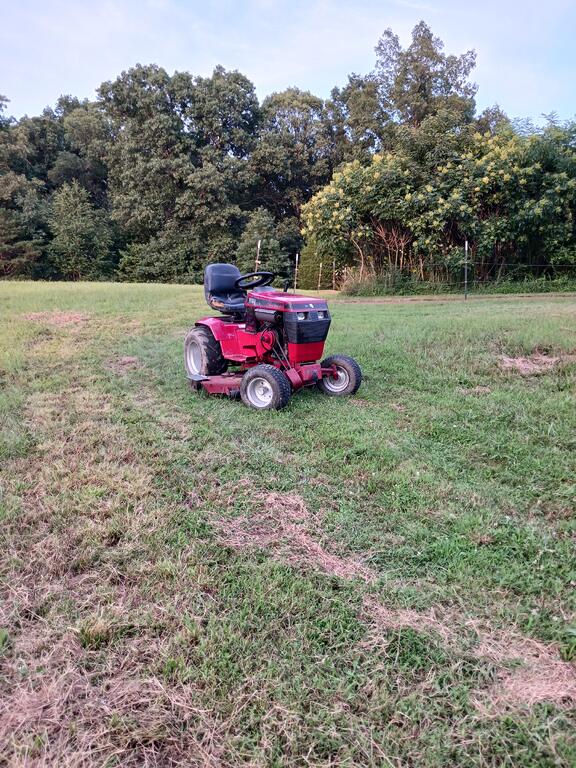

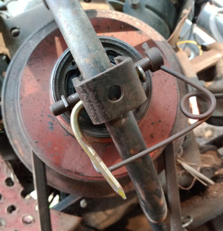

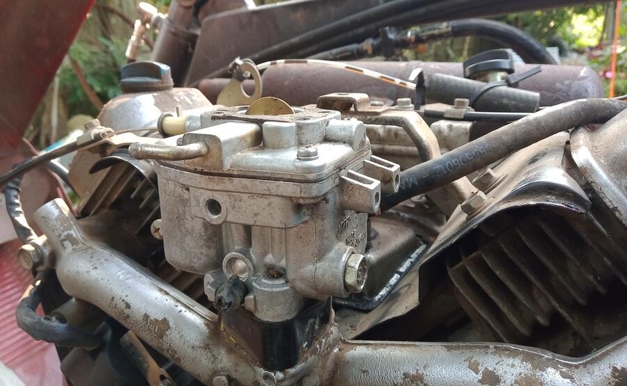

nyquil junkie 333 #19615 Posted July 25, 2023 I found a new roll pin. It works for now. I de greased the disk and it catches better. Then it was carb time. The engine had to be run at half choke all the time and didn't want to start and... sometimes was puking gas out of the overflow. So I just bought a new $25 chinesium special on Amz. What can go wrong with that Idea? I've bought other cheapniese carbs and they mostly worked, some needing a little adjustment. Not this one... Huffed black smoke on startup, would huff black smoke under a load if it was more than half throttle. I tweaked it a little, stil wasnt right. I put the new set of coils on it, because the old ones were msmatched and really old crusty beat up things that I thought would help the problem. After a couple take aparts and put togethers, I gave up and stripped the old carb down and cleaned it. it had a fair amount of crud and clogs... I flushed and cleaned it all out. Stuck it back on the engine and there ya go.... runs like a new one. No more misses, smoke chokes or hard starts. As far as I can tell the china carbs main jet was way too big and the idle jet screw didnt feel right. Something in that new carb wasn't right at all. The old carb back in place. The Old Nikki carb trumps General Tso's POS carb. Next up.. a new hydro filter and maybe some new fluid. The hydrostat has an annoying whine, louder than the normal not so annoying whine it had. When my skid steer does that it time to change the filter. We'll see how it goes. 6 Share this post Link to post Share on other sites
kpinnc 18,916 #19616 Posted July 25, 2023 43 minutes ago, nyquil junkie said: We'll see how it goes. I see you're running a Vanguard. I have several, and they are very good engines. Far superior to any of the "current" engines out there. Not as bulletproof as a Kohler K -series or Magnum, but as close as you can get... One issue with the Vanguards: the gaskets are the weak spot, and depending on which one goes can create issues that appear to be carb problems. When a gasket fails (typically a head gasket), the case gets overpressure and makes the pulse pump flood the carb. Point being, if you have a carb problem that makes no sense, check both the head haskets as well as the oil pan gasket on the PTO side. I've had two where that was all that was wrong, and it took a long time to figure it out. 5 Share this post Link to post Share on other sites
ebinmaine 80,449 #19617 Posted July 25, 2023 21 minutes ago, kpinnc said: gaskets You feel like I should change mine as a preemptive? 1 Share this post Link to post Share on other sites
kpinnc 18,916 #19618 Posted July 25, 2023 3 hours ago, ebinmaine said: You feel like I should change mine as a preemptive? No. Most are good, just sometimes a gasket failure shows up with strange symptoms. I wouldn't expect a leaky gasket to make the carb drown out, but it does. Later Vanguards had improved head gaskets with a ring around the cylinder. 2 Share this post Link to post Share on other sites
nyquil junkie 333 #19619 Posted July 25, 2023 This one has an electric fuel pump... and the repairs seem to have cured all its ills. So far. But I will keep the gasket thing in mind. Thanks! The new hydro filter took all the whine away and now it even has more power than before. The filter was dated 6-30-1 I cant read the last number..so at best this thing has had the same filter in it since 2019. I think its ready to go to the barn and dig some manure sand pack. I'd give it a bath but considering where its headed... I don't see the point. 1 2 Share this post Link to post Share on other sites

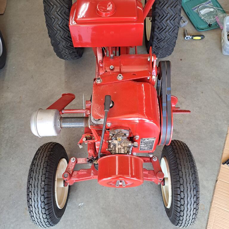

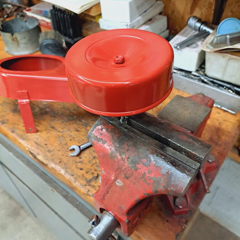

WHX?? 57,878 #19623 Posted July 25, 2023 (edited) 20 minutes ago, elcamino/wheelhorse said: @WHX?? Hope the air cleaner has a better color of red. Your nail looks like red oak stain. Air cleaner looks much better Waldo... BTW what kind of junk did you sell me @Pullstart...I want my money back...... what's wrong with this pic... round hood mind you! OK a better view... I shoulda knew this wasn't gonna work so I'll blame it on @Achto Kev... Edited July 26, 2023 by WHX?? 1 2 1 Share this post Link to post Share on other sites
Pullstart 71,145 #19624 Posted July 26, 2023 854 air cleaner on a 701? My apologies I’ll have to take the engine back with it! 1 3 Share this post Link to post Share on other sites
