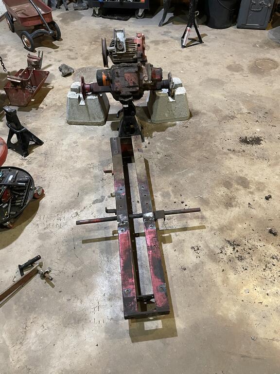

Thatoneguy 197 #19479 Posted July 8, 2023 I got all my parts pressure washed! Of course the rear end/hydro pump now has a small leak so it looks like i will be separating them… 4 2 Share this post Link to post Share on other sites
ebinmaine 80,439 #19480 Posted July 8, 2023 16 minutes ago, mower said: I got all my parts pressure washed! Of course the rear end/hydro pump now has a small leak so it looks like i will be separating them… I might have the gasket for that. I can check Sunday. 1 2 Share this post Link to post Share on other sites

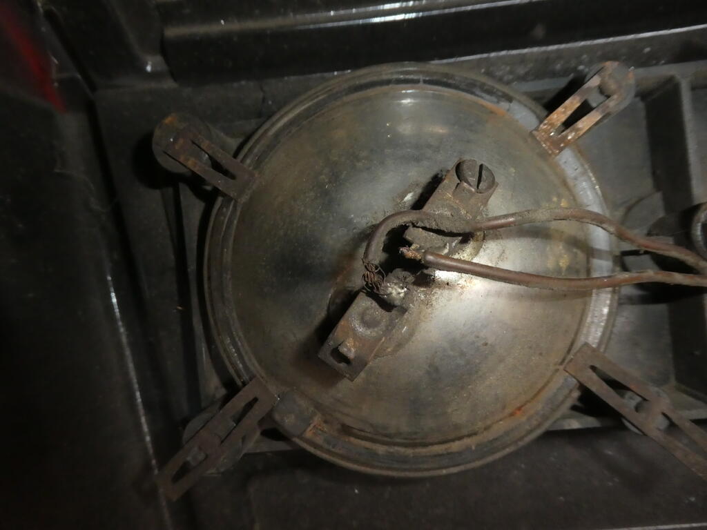

squonk 47,975 #19482 Posted July 8, 2023 15 hours ago, Stormin said: Found on of the headlights on the C-125 was hanging off. Two of the securing clips had broken. Now the chances of replacing them will be zero over here. Can't see how you can really. Looking at them I wondered of they would turn round. Nothing to lose, so a pair of pliars, (English spelling), were brought into play. Luck was with me and they did turn 180 degrees. Head light secured once more. I'm putting pliars in my little book next to plough! 1 5 Share this post Link to post Share on other sites

peter lena 10,029 #19485 Posted July 8, 2023 @mower that bare frame , is practicly asking for a steel tube fuel line , inside of frame angle , run it the length , extend 6" vinyl cap off . as you build up it would be easy to add clear vinyl fuel line / filters , virtually eliminating fuel line break down debris . just an idea, pete 1 2 Share this post Link to post Share on other sites

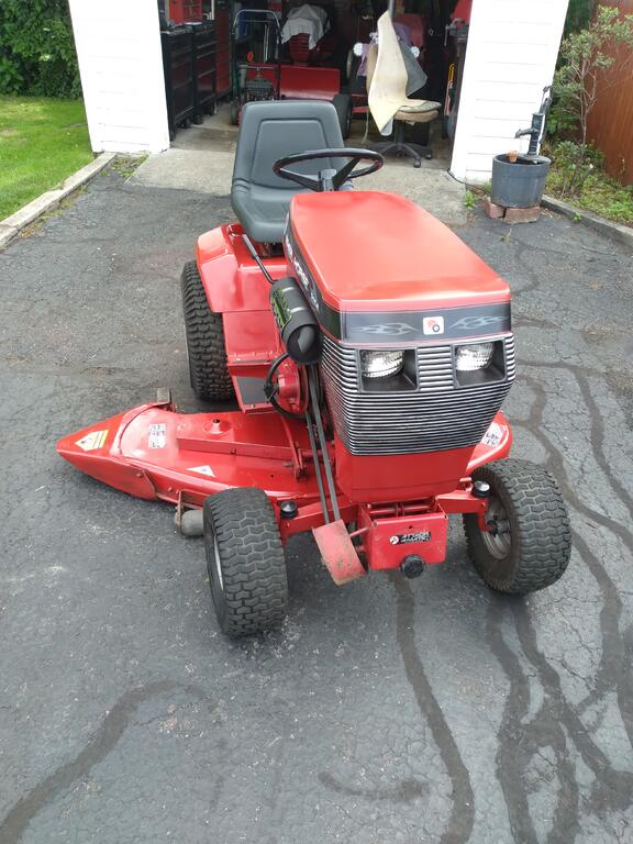

D_Mac 9,339 #19488 Posted July 8, 2023 (edited) Put the deck on the Free10-8 for the first time. Fired it up and engaged the blades and it is whisper quite. I was also able to squeeze it into the garage with the other 3 Horses even with the deck on. I couldn't be happier. Edited July 8, 2023 by D_Mac 3 10 1 Share this post Link to post Share on other sites

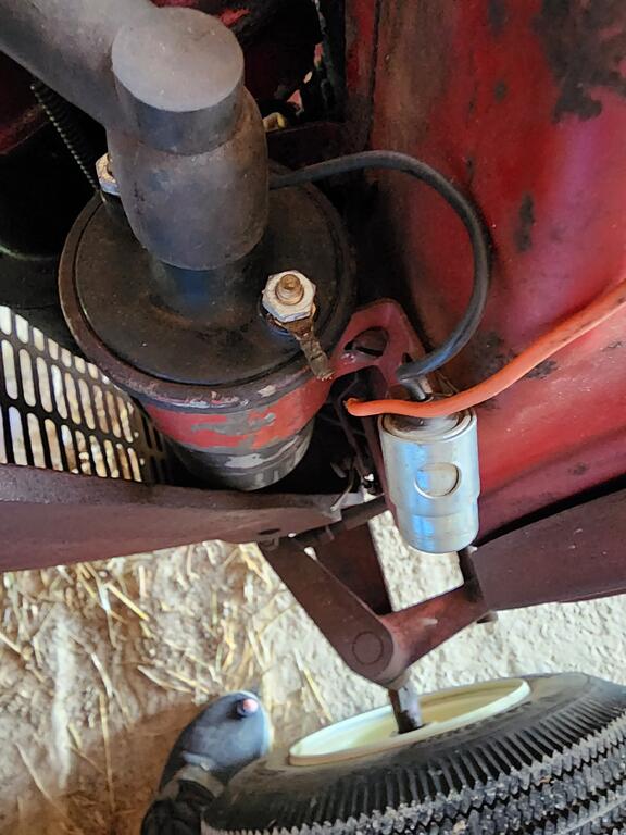

cafoose 3,819 #19490 Posted July 8, 2023 The @Ed Kennell 953 from the Big Show shut off last week and didn't start. I have it in the neighbor's barn and didn't have tools with me to check it out at the time. The clamp screw on the coil is completely unscrewed and the coil slid down. Looks like the wire was too short with the coil all the way down. I found this: 6 1 1 Share this post Link to post Share on other sites
Ed Kennell 47,070 #19491 Posted July 8, 2023 1 minute ago, cafoose said: I found this: Wish they were all that easy. 5 2 Share this post Link to post Share on other sites
Lee1977 7,750 #19492 Posted July 9, 2023 1 hour ago, Ed Kennell said: Wish they were all that easy. A lot of then are If you knew where to look. My 312 wouldn't start back up over at the farm. Had to haul it back home. Used my meter found no power on the battery wire. Fuse was good the fuse box was bad. 4 Share this post Link to post Share on other sites

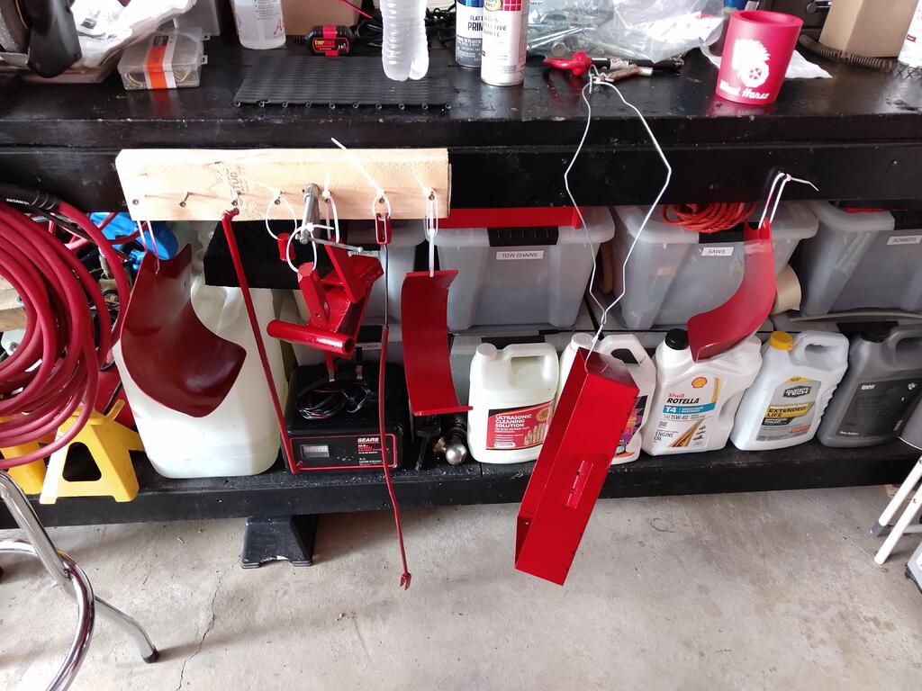

ML3 2,485 #19493 Posted July 9, 2023 Took RJ apart. Initially wasn't going to paint it but it wasn't a correct color & had a few spots where paint was coming off. Got some parts painted w/1coat. Do another coat tomorrow. Plenty little things to fix. Whoever did refurbishment before didn't use cotter pins- used bent up nails??? Most the bolts are all mismatched so I wanna correct that. Simple little details need taken care of. Wheels & seat are painted white they need refinishing. Think I wanna go with the almond or antique white?? 9 2 Share this post Link to post Share on other sites
