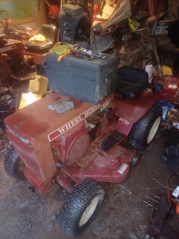

ccs002 81 #19313 Posted June 22, 2023 (edited) Got this B-100 Automatic I picked up recently back together. Someone managed to shear all the teeth off both of the sun gears that drive the axles 😬. Edited June 22, 2023 by ccs002 Added another picture of the tractor when I got it. 1 9 Share this post Link to post Share on other sites

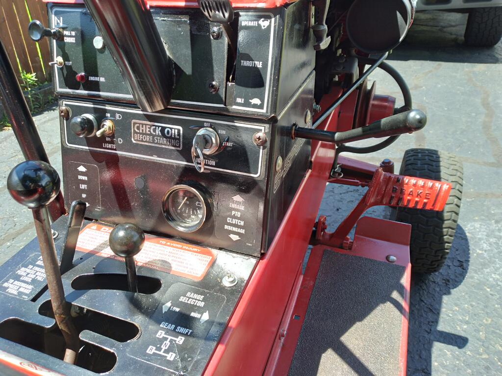

D_Mac 9,339 #19314 Posted June 22, 2023 (edited) Did some detailing on the FREE10-8 this morning. Coming along nicely. Talked to @Vinylguy yesterday about my custom decals. He should have them done and shipped to me by Monday. If any of you are even even thinking about decals, either factory originals, or a set of customs, @Vinylguy is the best in the business. Great quality and affordable prices. I have purchased several sets from him and he has never disappointed. Can't wait to get them on. I guess I should drag the deck out of the shed and give it a once over. I have no plans on painting it. I fear if I drag it out of the shed those plans might change. Edited June 22, 2023 by D_Mac 6 3 Share this post Link to post Share on other sites

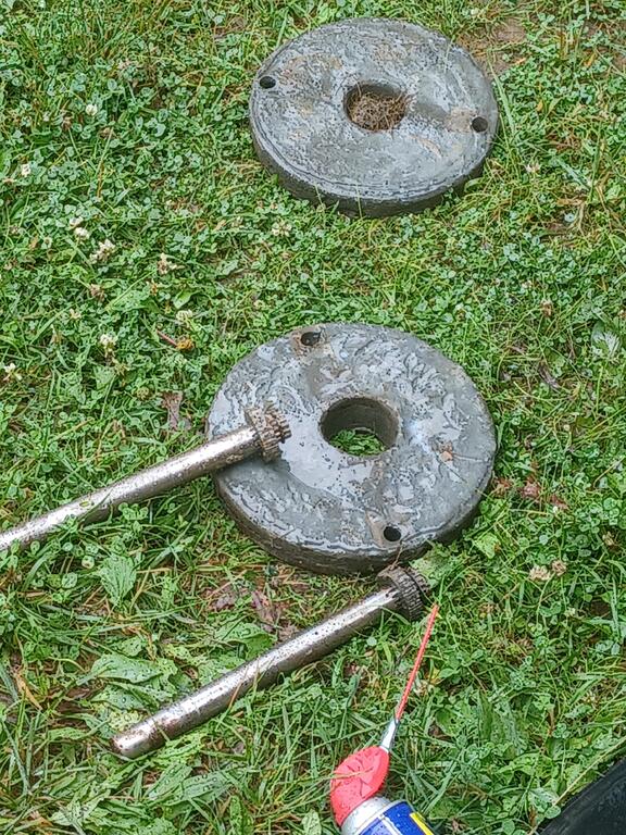

ccs002 81 #19315 Posted June 22, 2023 Was cleaning up parts and tools from working on the B100 Auto and grabbed a picture of the wiped out axle gears along with the homemade lead wheel weights that no doubt helped make them that way. 2 Share this post Link to post Share on other sites
ebinmaine 81,032 #19316 Posted June 22, 2023 49 minutes ago, ccs002 said: Was cleaning up parts and tools from working on the B100 Auto and grabbed a picture of the wiped out axle gears along with the homemade lead wheel weights that DID NOT help make them that way. @ccs002 Those stripped gears are almost definitely the result of someone using improper methods to attempt removal of the rear hubs. The hubs MUST be pulled using a good quality hub puller that is NOT a standard 3 jaw type. MANY times I've seen pics and in person where folks use a hammer to remove the hubs. This destroys the axles as your machine has experienced. Lots of folks run lots of weight and never have issues. Those gears are destroyed by an outward motion. Heavy weights produce a downward motion. 1 Share this post Link to post Share on other sites
WHX?? 58,310 #19317 Posted June 23, 2023 46 minutes ago, ebinmaine said: @ccs002 Those gears are destroyed by an outward motion. Heavy weights produce a downward motion. How do you figure EB... I would say 🔨 out on the hubs would break them c clips first? One side and a PO would have learned the lesson? Can't tell but looks like both sides are mangled. Something get in the diff @ccs002? What did the pinions look like? 1 Share this post Link to post Share on other sites
ebinmaine 81,032 #19318 Posted June 23, 2023 8 minutes ago, WHX?? said: How do you figure EB... I would say 🔨 out on the hubs would break them c clips first? One side and a PO would have learned the lesson? Can't tell but looks like both sides are mangled. Something get in the diff @ccs002? What did the pinions look like? Looks to me like someone tried one side - failed to remove - and continued to the other ... I've had transmissions apart with only one bad, but definitely also seen damage to both sides. 2 Share this post Link to post Share on other sites
ccs002 81 #19319 Posted June 23, 2023 6 minutes ago, WHX?? said: How do you figure EB... I would say 🔨 out on the hubs would break them c clips first? One side and a PO would have learned the lesson? Can't tell but looks like both sides are mangled. Something get in the diff @ccs002? What did the pinions look like? WHX?? The pinions were all pretty beat up, I was guessing from eating all the teeth of those gears. I was guessing jerking something with a chain caused the damage as the hitch pin was very bent but now I'm not as sure. Someone had replaced the LH hub and it looks practically brand new. The keyway on both sides were badly worn and looked like it may have sheered a key or two along the way. 1 1 Share this post Link to post Share on other sites
ebinmaine 81,032 #19320 Posted June 23, 2023 10 minutes ago, WHX?? said: How do you figure EB... I would say 🔨 out on the hubs would break them c clips first? One side and a PO would have learned the lesson? Can't tell but looks like both sides are mangled. Something get in the diff @ccs002? What did the pinions look like? You certainly do raise a valid point of wondering if there's foreign matter in the differential too. 1 Share this post Link to post Share on other sites
ebinmaine 81,032 #19321 Posted June 23, 2023 1 minute ago, ccs002 said: The pinions were all pretty beat up, I was guessing from eating all the teeth of those gears That's a good guess 1 Share this post Link to post Share on other sites
WHX?? 58,310 #19322 Posted June 23, 2023 21 minutes ago, ccs002 said: WHX?? The pinions were all pretty beat up, I was guessing from eating all the teeth of those gears. I was guessing jerking something with a chain caused the damage as the hitch pin was very bent The keyway on both sides were badly worn and looked like it may have sheered a key or two along the way. Eicch ... sounds like a clear cut case of animal abuse then... I would notify PETA... Hub keyways are shot I can fix them. 2 Share this post Link to post Share on other sites
ebinmaine 81,032 #19323 Posted June 23, 2023 26 minutes ago, ccs002 said: WHX?? The pinions were all pretty beat up, I was guessing from eating all the teeth of those gears. I was guessing jerking something with a chain caused the damage as the hitch pin was very bent but now I'm not as sure. Someone had replaced the LH hub and it looks practically brand new. The keyway on both sides were badly worn and looked like it may have sheered a key or two along the way. Pop up some pics of the transmission guts and we can see just what ya need. Share this post Link to post Share on other sites

kpinnc 19,033 #19325 Posted June 23, 2023 1 hour ago, WHX?? said: How do you figure EB... I would say 🔨 out on the hubs would break them c clips first? Nope. It will shear the spline ends from the axle. Seen it several times. I'd be curious about the condition of both the axle and differential bearings. Likely the result of a case full of water for a very long time. Axle bearings corrode first, then begin to fail. This allows for misalignment of the axles in the diff end cap. Crunch and grind... 4 Share this post Link to post Share on other sites
