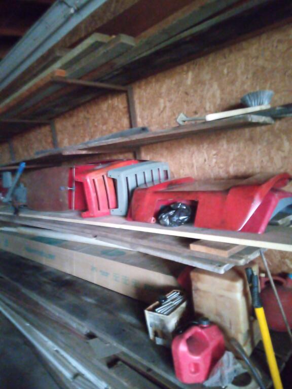

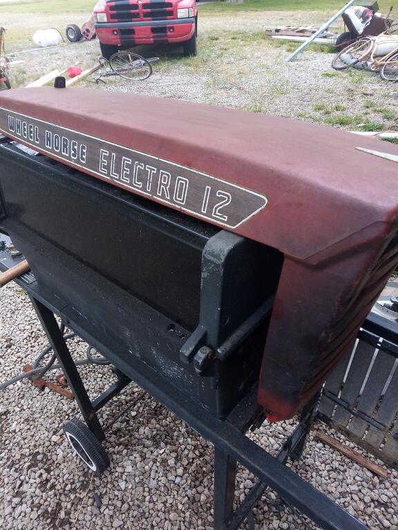

ohiofarmer 3,474 #19251 Posted June 17, 2023 Maybe not what I did To my Wheel Horse, but For it. I am mostly done clearing off the shelving in the barn lean to for in process storage and to organize parts when taking tractors apart. The shelf standards are angle iron with 24 inch square tubing formerly used to store vinyl siding . Lags hold them to the studs and they can carry the weight. There are four seat pans and four hoods and other parts on there just to get a feel for things. Plenty of room for storage tubs for the smaller stuff. Oh ,and look at the Electro hood. She's a patina oil candidate if ever I saw one with the decals in fine woodgrain condition. 6 Share this post Link to post Share on other sites
Handy Don 17,368 #19252 Posted June 17, 2023 3 hours ago, ohiofarmer said: Please explain the process that involves the gas grill!? Share this post Link to post Share on other sites
ohiofarmer 3,474 #19253 Posted June 17, 2023 3 hours ago, Handy Don said: Please explain the process that involves the gas grill!? Just to snap a picture. I just use 0w30 synthetic and let them soak for a few days, wash it off, and then do as others have advised 1 1 Share this post Link to post Share on other sites

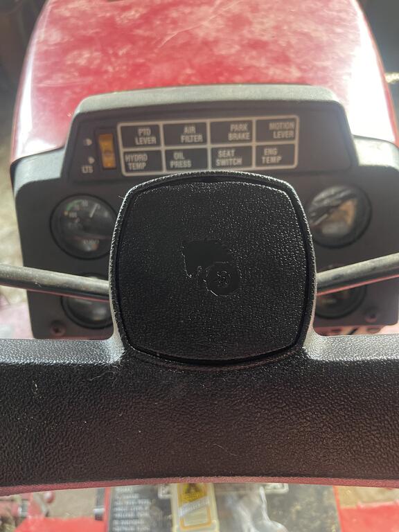

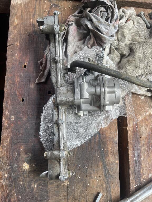

Desko 686 #19254 Posted June 17, 2023 No rain for the past couple weeks so I took that time to glue my new center cap on and split and resealed the spare intake manifold for the 520H and try out one of those cheap adjustable carbs from amazon. Overall not super impressed with it looks and fit wise but hopefully it makes it run better because even after cleaning the accelerator pump and carb the original will still hunt and surge. 3 Share this post Link to post Share on other sites

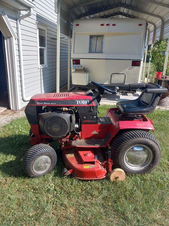

Beap52 2,440 #19258 Posted June 18, 2023 (edited) Some time ago I asked how to set the deck height on my 520H. I was having a hard time setting the deck height for 3 1/2 inches because that is how tall my neighbor mows his grass. I've been mowing his yard (about 1 1/2 acres) all summer because he has cancer and the "poision" the doctors gave him to fight the cancer perforated his intestines. He now walks with a walker and I doubt he gets much better. We have a zero turn but I like using the 520H. I've wrote all of this to get to this: Someone suggested that I may need 7" deck wheels to get to the height. I had some 3/4 treated plywood and gorilla glue in the shop so I made some sample wheels to see if I wanted to invest thirty or so dollars in 7" wheels. Well, the plywood wheels worked just fine. I guess I'll be making a trip to the farm and home store before long and buying 7" wheels. I appreciate this forum and the advice, humor and concern that the guys here have for each other. Unfortunately, other forums I visit are not so welcoming. By the way. Happy Father's Day. To the younger men: enjoy your children because they grow up so fast. The the grandfather's: You all have influence on your grand babies more that you know. Your wisdom and wit will carry on long after you're gone. My grandfather died 40 years ago, and I still remember times with him. Edited June 18, 2023 by Beap52 4 4 5 Share this post Link to post Share on other sites

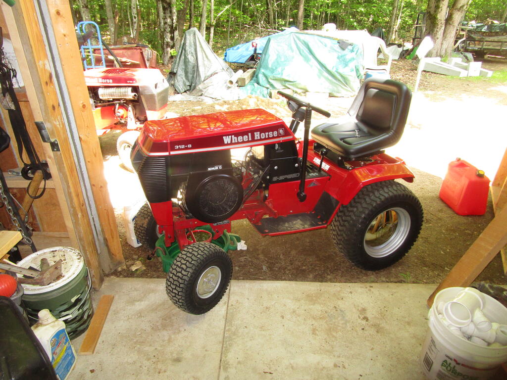

JCM 11,402 #19266 Posted June 18, 2023 Charged the battery on the 89 312-8, went for a trail ride to get the oil nice and hot then changed the oil. That tractor is lucky to see 5 hours per year. 4 8 1 Share this post Link to post Share on other sites

kpinnc 18,916 #19269 Posted June 18, 2023 1 hour ago, JCM said: That tractor is lucky to see 5 hours per year. It sure is a purdy one! 3 Share this post Link to post Share on other sites

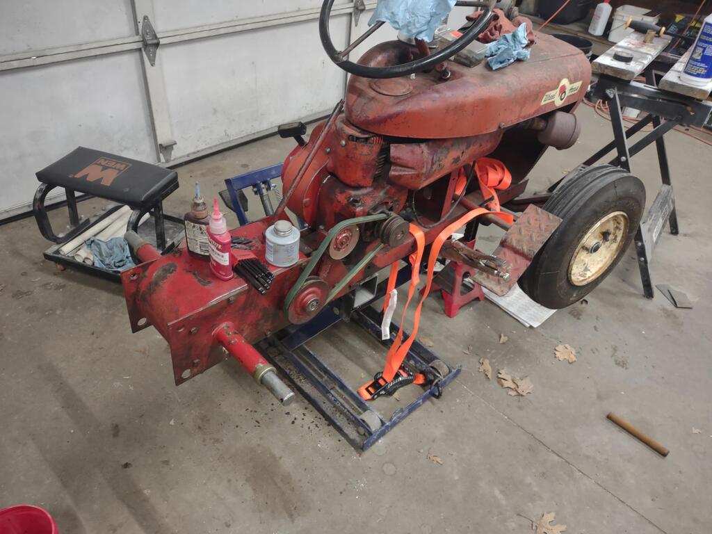

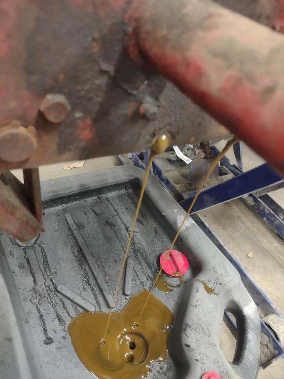

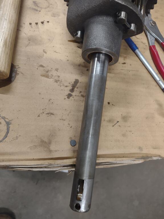

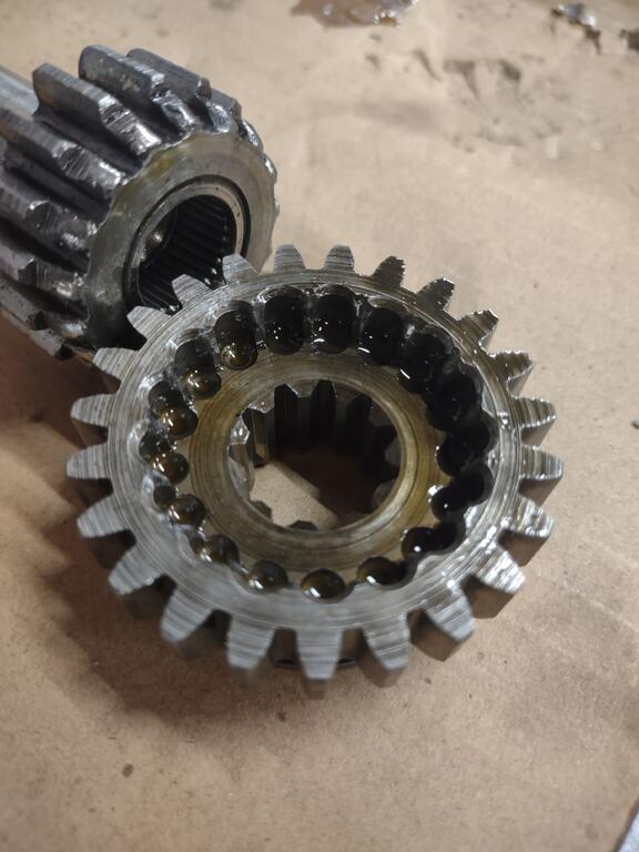

Achto 32,432 #19270 Posted June 18, 2023 (edited) It was time yesterday to take a look at the 401 that I bought last fall. On my initial shake down I found that it would not stay in 3rd gear. I mean you could not even hold it in 3rd to drive it, it would force itself out of gear. The subject at hand. Fluid in the tranny looked awesome! Golly gee wiz Walley. I wonder why it wouldn't stay in 3rd?? I have not seen a set of these so bad in a while. I replaced these with a new 3rd gear and a good used input shaft/gear. Axles look rough where the outer bushings ride so I did an axle flip as long as I had it apart. Assembling the transmission was a bit of a challenge for me. These 3 piece tranny's sure don't go together like the 2 piece ones do. Finally won though then called it a day. Back at it this morning, started by bolting the tranny back in place. Back together, test drive showed all systems go. Ready for duty. Edited June 18, 2023 by Achto 3 20 Share this post Link to post Share on other sites
