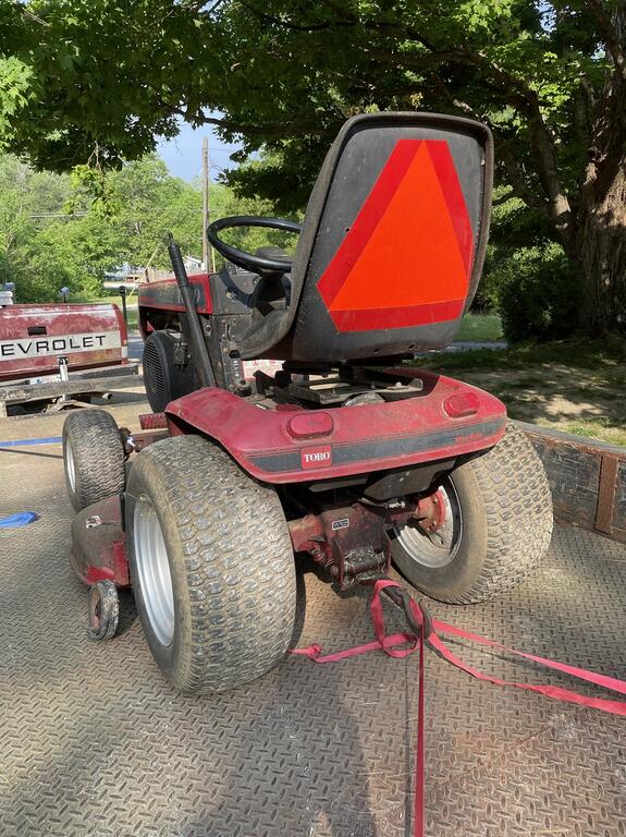

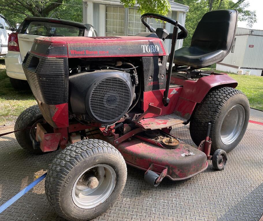

ebinmaine 81,032 #19176 Posted June 4, 2023 27 minutes ago, davem1111 said: She followed me home today.... REALLY looking forward to seeing how this one goes. 1 1 1 Share this post Link to post Share on other sites
davem1111 2,432 #19177 Posted June 5, 2023 6 hours ago, ebinmaine said: REALLY looking forward to seeing how this one goes. Me too, man! So, I get the feeling there will be tears shed if I decided to part this 520-8 out, so I'd like to fix it up. But so far I've only done some half-a$$ed rattle can painting. If I'm going to do this one I'd like to do a decent job, but don't have the experience. I know this is the right place for advice on restorations, so I'm hoping to get some good advice (but I need to do it within budget, which right now is pretty small. Maybe I can sell the 416-H I have to fund it. So far all I've done is pulled the deck and sprayed some PB Blaster on the blade nuts. The spindles seem to be in good shape, so that's a big plus. It's missing the deck belt covers but I have a spare pair from another 48" SD that was too far gone to rescue. Mostly I need advice on proper rust removal, prep and painting of the tins. I have a cheap air gun from Harbor Freight and a mid-sized compressor, and a can of Regal Red I bought when Rural King was out of rattle cans but had that. Haven't tried it yet. I'd like to get a really nice gloss on this baby. Also, need to replace the starter relay, and the engine is doing something weird where the governor keeps revving and dropping over and over again, mostly at low throttle. Hoping it's just the carb. Tires are dry rotted but they all hold air except the right front. Maybe I'll start a restore thread on this. I may do some minor work, get it running well, and sit on it till I move and retire in a few years. BTW, it only has about 620 hours on it. 3 2 Share this post Link to post Share on other sites
c-series don 12,598 #19178 Posted June 5, 2023 @davem1111 I’ve now done three frame up restorations with the guidance and help of my brother. He is a perfectionist in the trade. One of the things I learned from him is it’s all in the prep. He won’t paint anything until it’s properly prepared. Pretty much everything is glass beaded or sand blasted down to bare metal. Then a good primer that is sanded until it’s baby’s ass smooth. Paint, wet sand and clear coat. Yes it’s a lot of work but the end result is worth the effort. Don’t get me wrong, not everything I paint is done to this extreme. However you can’t expect good results without proper preparation. It’s unfortunate that since the early eighties and especially into the nineties Wheel Horse didn’t prime or prep the metal properly. This is why you see paint peeling off in sheets. You didn’t see that with the older tractors, it basically had to ware off!! Didn’t peel. 4 1 Share this post Link to post Share on other sites

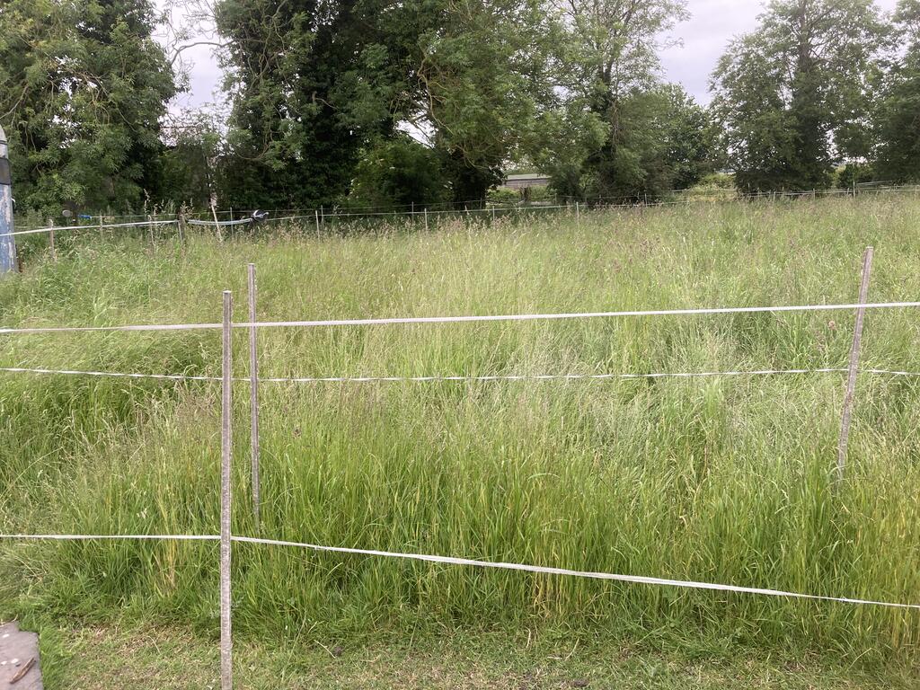

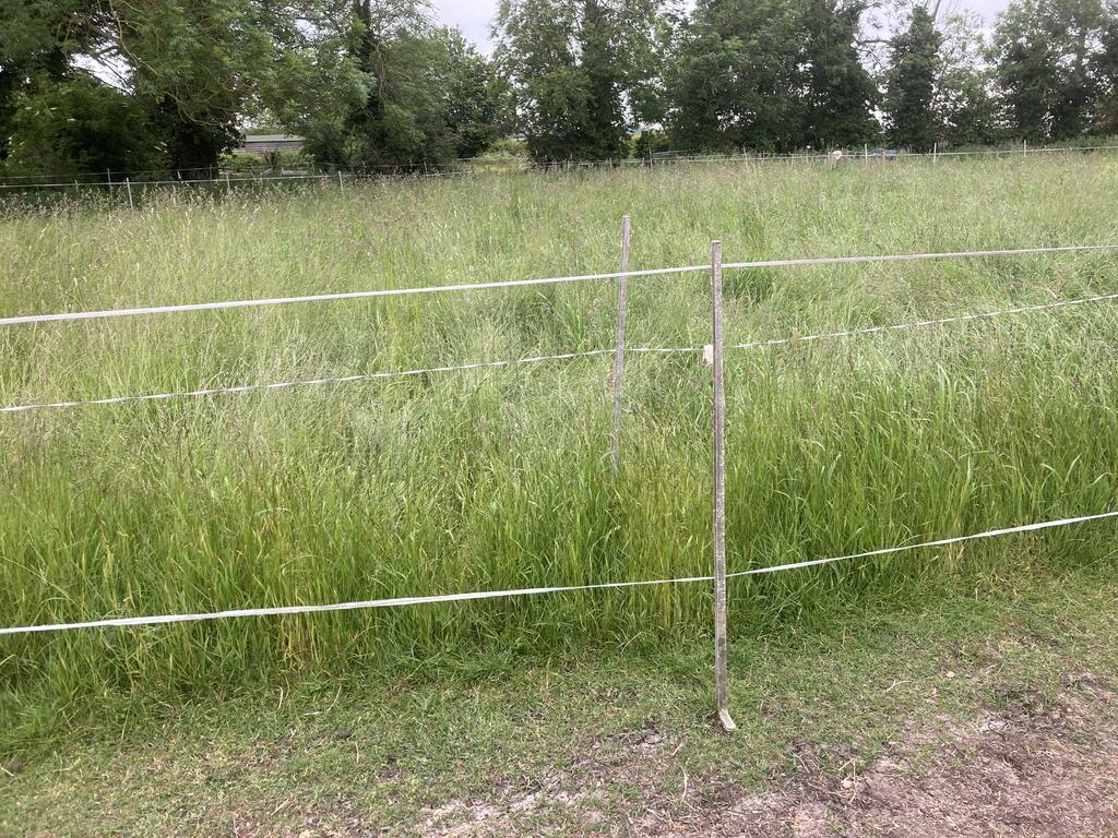

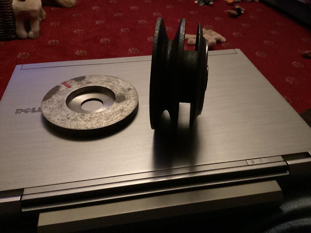

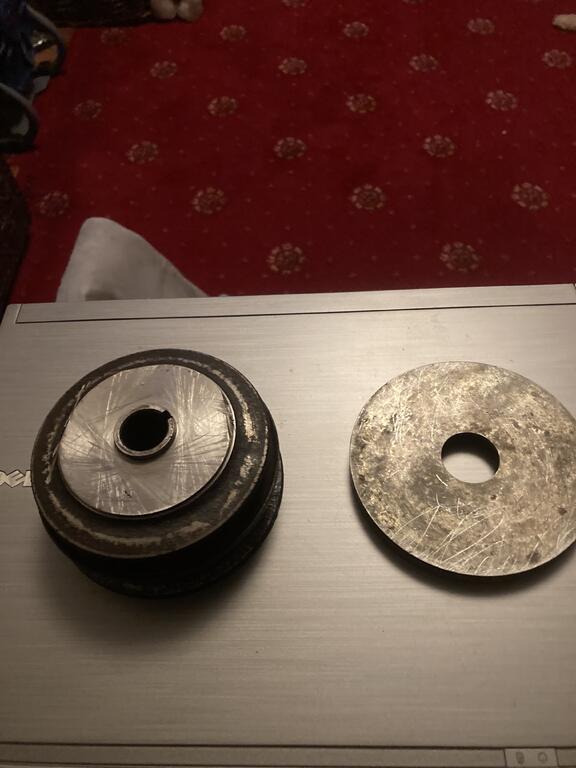

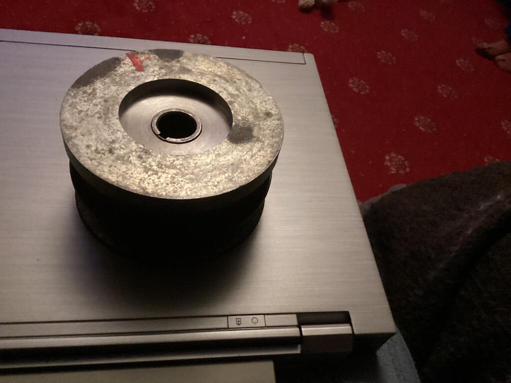

ranger 1,862 #19186 Posted June 5, 2023 Hooked up the broadcaster to the C121, ready to overseed the paddocks after the hay has been cut and the buttercups sprayed. Also been busy machining the double pulley on the 36” RD deck, due to a broken lower flange, and unable to locate a replacement over here. 2 8 Share this post Link to post Share on other sites

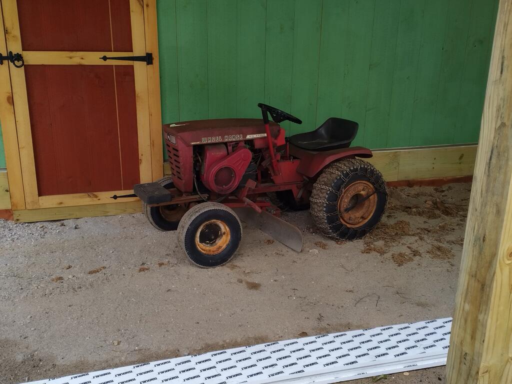

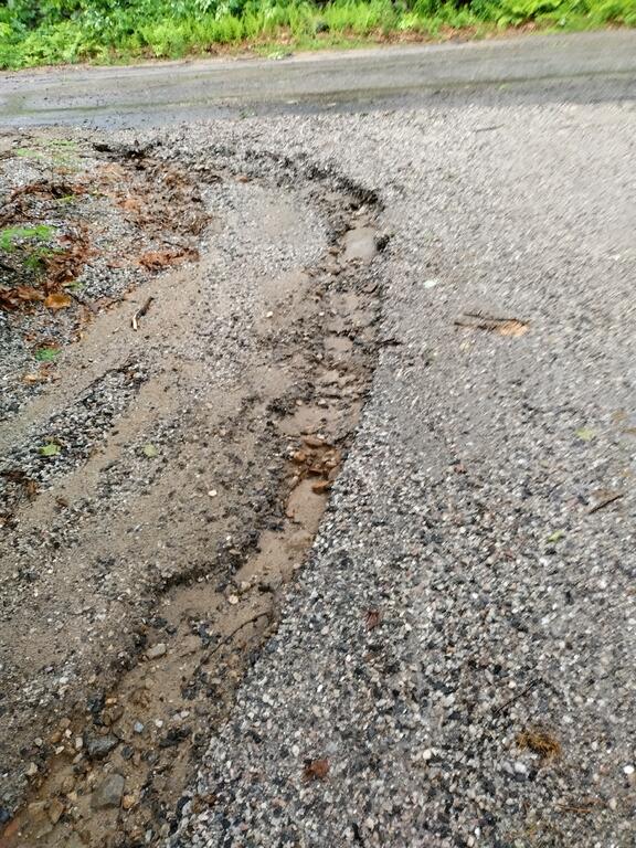

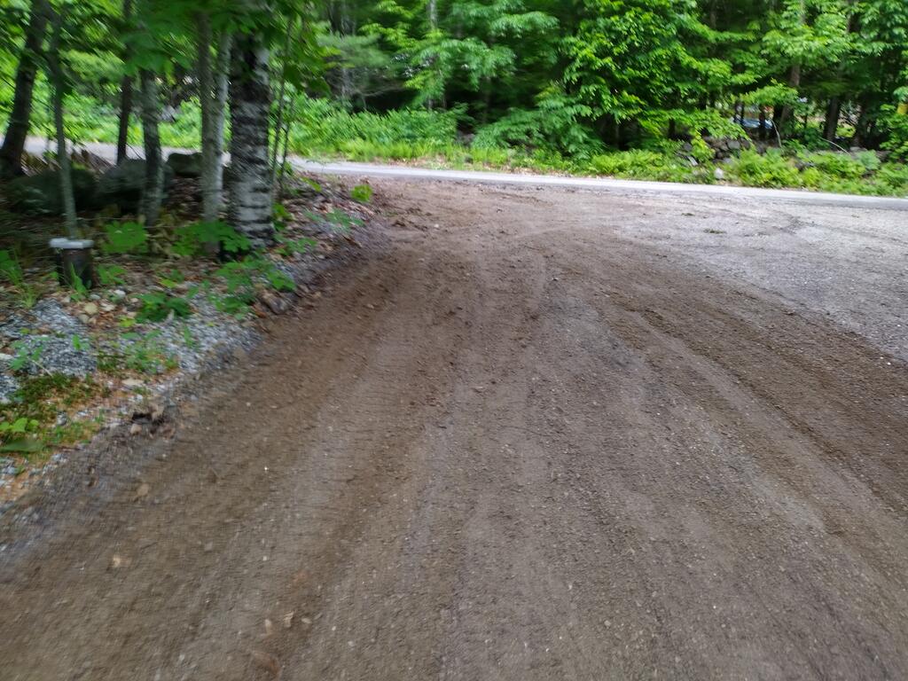

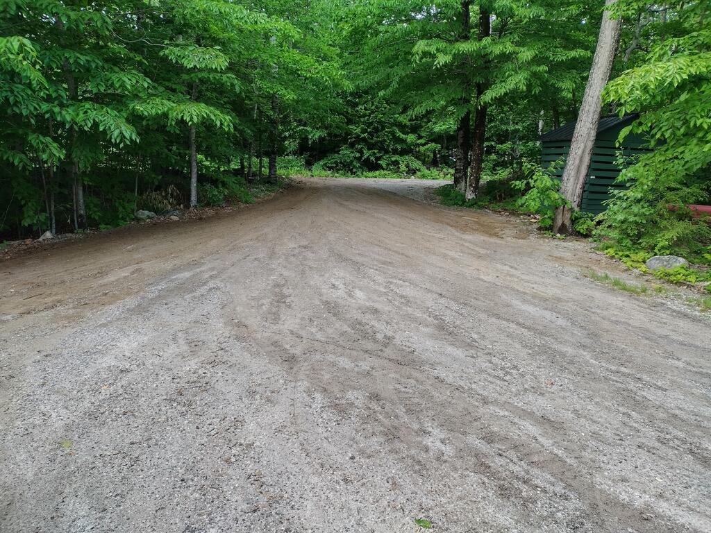

ebinmaine 81,032 #19187 Posted June 5, 2023 Many moons ago I thought it would be neato to have a mid mount grader blade. @Chris G helped me out with sourcing one. Got it here. Showed it to the BBT Trina person and immediately lost possession of said neato to have mid mount grader blade. But..... She does GREAT work with it maintaining our front dooryahd. I mentioned the other day we'd had some heavier than normal water flows screw up the driveway. Here's what it looks like after she rode around on her Tractah for an hour or so.... 4 8 Share this post Link to post Share on other sites

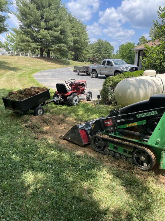

BrianKoch 370 #19188 Posted June 6, 2023 More chore work! 2 3 Share this post Link to post Share on other sites
lynnmor 9,058 #19189 Posted June 6, 2023 50 minutes ago, ebinmaine said: Many moons ago I thought it would be neato to have a mid mount grader blade. @Chris G helped me out with sourcing one. Got it here. Showed it to the BBT Trina person and immediately lost possession of said neato to have mid mount grader blade. But..... She does GREAT work with it maintaining our front dooryahd. I mentioned the other day we'd had some heavier than normal water flows screw up the driveway. It appears like the highway department is donating the bulk of the water. Can you get your road grading department to do some creative work so that the water can find a new home? 1 Share this post Link to post Share on other sites
ebinmaine 81,032 #19190 Posted June 6, 2023 25 minutes ago, lynnmor said: It appears like the highway department is donating the bulk of the water. Can you get your road grading department to do some creative work so that the water can find a new home? Yeah they're gonna have to do some ditch creation and maintenance across the street. Share this post Link to post Share on other sites

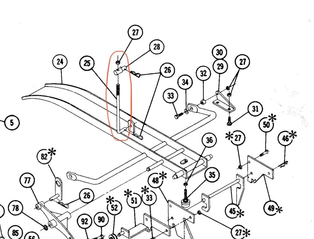

BrianKoch 370 #19199 Posted June 8, 2023 (edited) Gentlemen, It appears I have lost my mower deck lift rod … Does any one have an extra rod kicking around I could purchase? I have the trunnion and nut, just can’t find the rod! Thanks! Edited June 8, 2023 by BrianKoch Share this post Link to post Share on other sites
