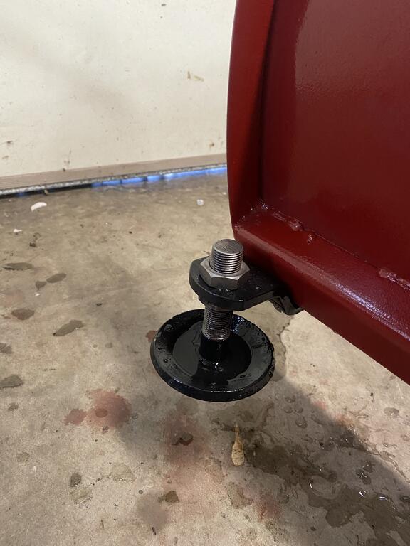

peter lena 10,080 #18057 Posted December 24, 2022 @Heatingman merry christmas ! like your blade slides , are they on compression springs? blade is also clean , any lubricant on it? do a lot of road side touch up plowing , slides off like nothing , pete 2 Share this post Link to post Share on other sites
Heatingman 977 #18058 Posted December 24, 2022 1 hour ago, peter lena said: @Heatingman merry christmas ! like your blade slides , are they on compression springs? blade is also clean , any lubricant on it? do a lot of road side touch up plowing , slides off like nothing , pete Just metal 1/2 round pucks welded onto 3/4” threaded studs to adjust ride height. close up of the slides. No lube on the blade…yet. Probably do a lube down once it thaws and dries in the heated garage it lives in. 5 Share this post Link to post Share on other sites
8ntruck 9,315 #18059 Posted December 24, 2022 nice. Better than $50 each for factory slides that are still available through Toro. I need to add some to my blade. Most of my snow removal plowing will be on turf or gravel. Do you have trouble snagging those on anything? 3 Share this post Link to post Share on other sites
Heatingman 977 #18060 Posted December 24, 2022 4 minutes ago, 8ntruck said: nice. Better than $50 each for factory slides that are still available through Toro. I need to add some to my blade. Most of my snow removal plowing will be on turf or gravel. Do you have trouble snagging those on anything? Not yet. But I also have a thick plastic wear bar sandwiched between the blade and the original wear bar. It glides pretty good so far, and my driveway is fairly smooth. The apron to the garage is concrete, the rest is asphalt. The slides and the wear bar are set approximately the same height. 2 Share this post Link to post Share on other sites
peter lena 10,080 #18061 Posted December 24, 2022 @Heatingman seen similar slide discs with a compression spring , so it would work on irregular surfaces , used on a quad blade set up . been using aerosol penetrating oil on my blades for years , snow release is ridiculous , just a continuous smooth roll off . good talkin , merry christmas , pete 3 1 Share this post Link to post Share on other sites
