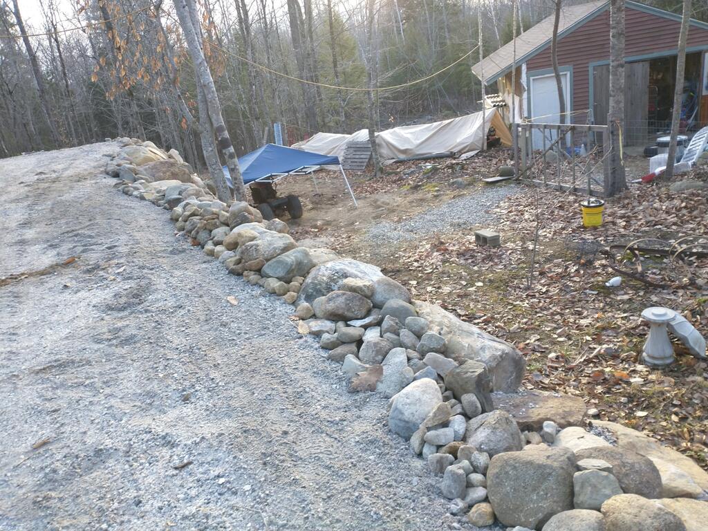

ebinmaine 79,633 #17877 Posted December 4, 2022 We've been needing to reinforce the top of the rock wall by the pole barn since that wall was built. The aggregate loves to run down through the huge boulders during the more aggressive rains. Today we used Trina's Pigpen 867 and my Cinnamon Horse C160-8 with trailers on each to move a BUNCH of rocks stones boulders to the wall top. I spent several hours tossing some up from the bottom then moving the rocks into place. I moved 3-½ big loads while Trina and her mom moved 5 smaller loads. Got em all set. Now we wait for another good rain shower to see what else needs filling in. 8 4 Share this post Link to post Share on other sites

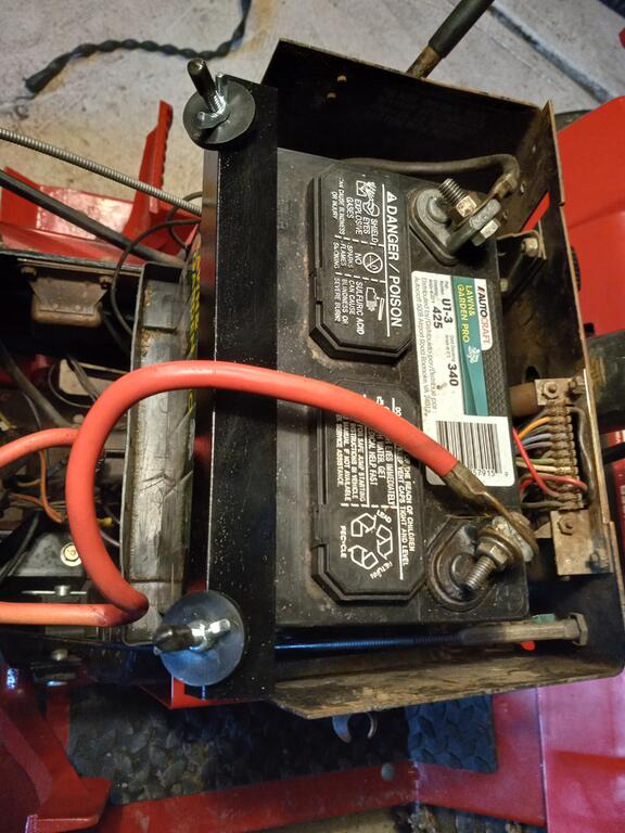

Panther416-8 342 #17878 Posted December 4, 2022 Made a battery hold down today, did the RandyL mod. No more bunjee cord. Thanks @RandyLittrell for the idea. 6 1 Share this post Link to post Share on other sites
SylvanLakeWH 31,706 #17879 Posted December 4, 2022 59 minutes ago, ebinmaine said: The aggregate loves to run down through the huge boulders during the more aggressive rains. Could try the plastic silt fence that is used to reduce run off on construction sites... black very fine mesh... place it buried couple inches then vertical couple inches above grade and then put stone on top... will keep the fines where they belong... Just a thought... 1 1 Share this post Link to post Share on other sites
Ed Kennell 46,549 #17880 Posted December 4, 2022 I know spouting is no no in snow country, but it could eliminate a lot of water. Share this post Link to post Share on other sites
RandyLittrell 3,944 #17881 Posted December 4, 2022 21 minutes ago, Panther416-8 said: Made a battery hold down today, did the RandyL mod. No more bunjee cord. Thanks @RandyLittrell for the idea. Looks great!! Glad I could conbritube something of value!!! Randy 4 Share this post Link to post Share on other sites

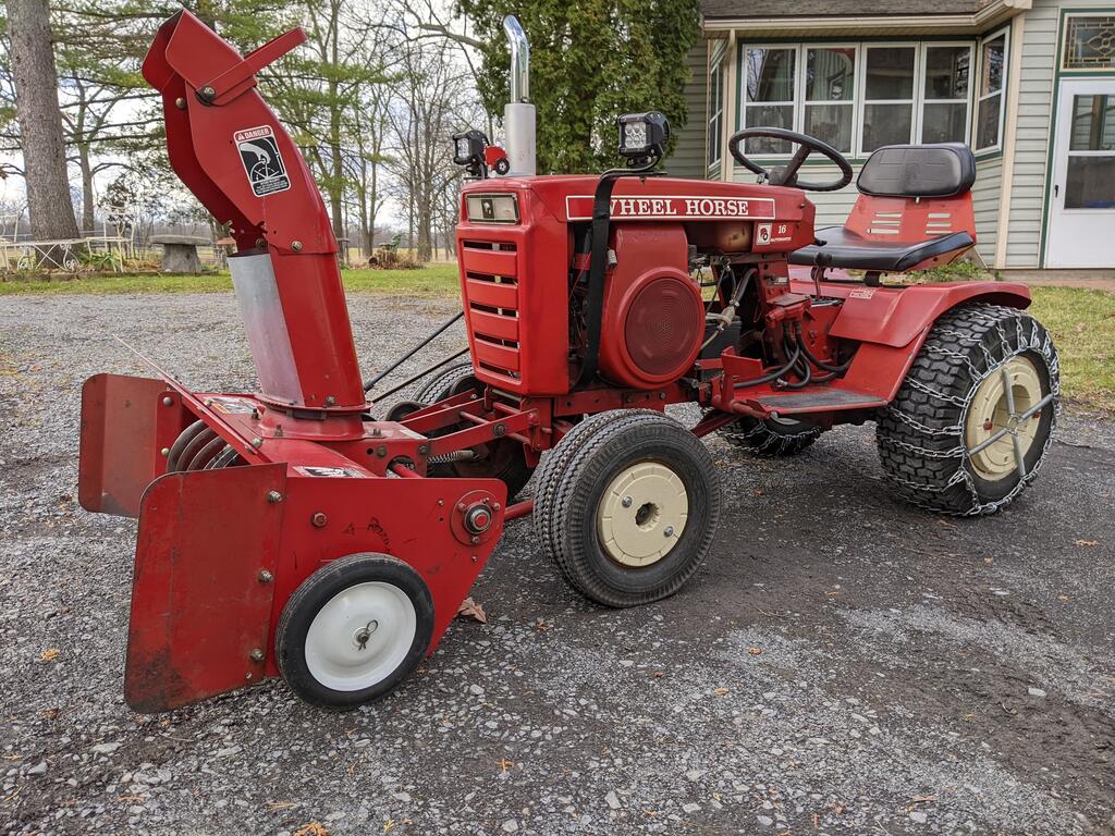

Panther416-8 342 #17882 Posted December 4, 2022 On 11/30/2022 at 11:53 AM, sparkys toy said: Just a novis question about the weight’s on the front,with a150 lb blower on the front do you really need the extra weight making it harder to steer,i can see it with a plow when angled it can push you left or right but didn’t think that would happen with the blower.and as Panther mentioned more air less friction,great looking rig by the way I'm not sure Sparkys toy but if the blower is lowered with the skid shoes in contact with the ground I don't imagine there would be much additional weight on the front axle from the blower. In that case it would be good to have the additional front wheel weights to help with traction/steering up front. I could be wrong, hopefully some others will chime in with their thoughts on this. BTW, the whole 2 stage blower is more like 360 lbs or so. 2 5 Share this post Link to post Share on other sites
Blasterdad 3,167 #17883 Posted December 4, 2022 4 minutes ago, Panther416-8 said: it can push you left or right but didn’t think that would happen with the blower It does, the blowers are a lot heavier than a plow, my single stage won't turn sometimes without lifting it up to put more weight back on the front, weights & chains DO help. 1 Share this post Link to post Share on other sites
rjg854 13,179 #17884 Posted December 4, 2022 I use weights and roller chains on the front wheels on my blower tractor to help with steering. It doesn't like to steer with the blower resting on the ground when trying to turn. 6 2 Share this post Link to post Share on other sites

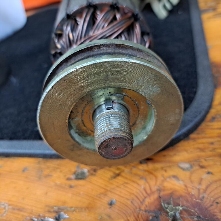

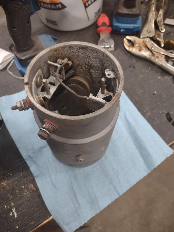

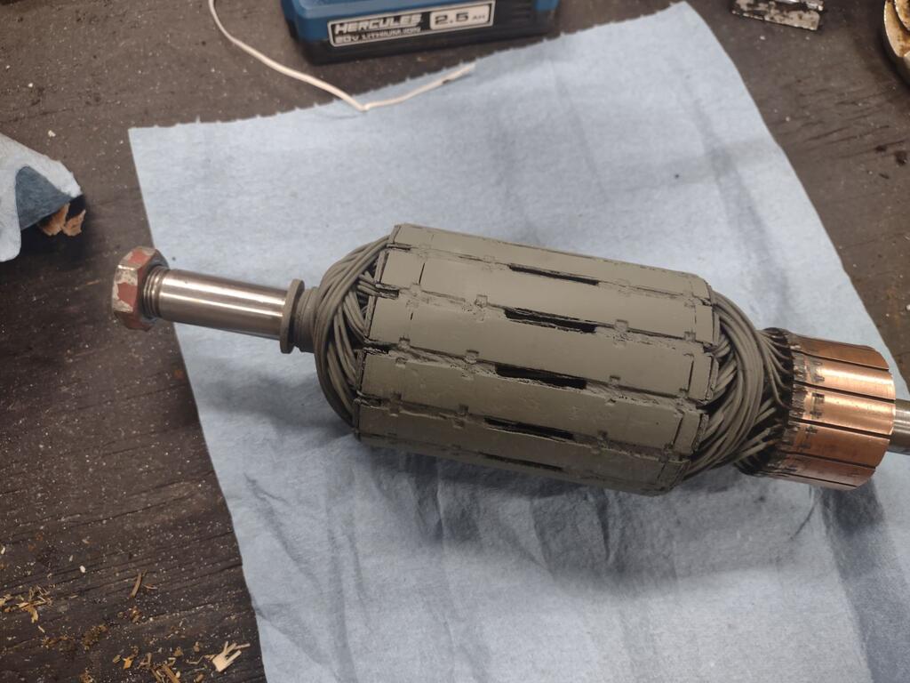

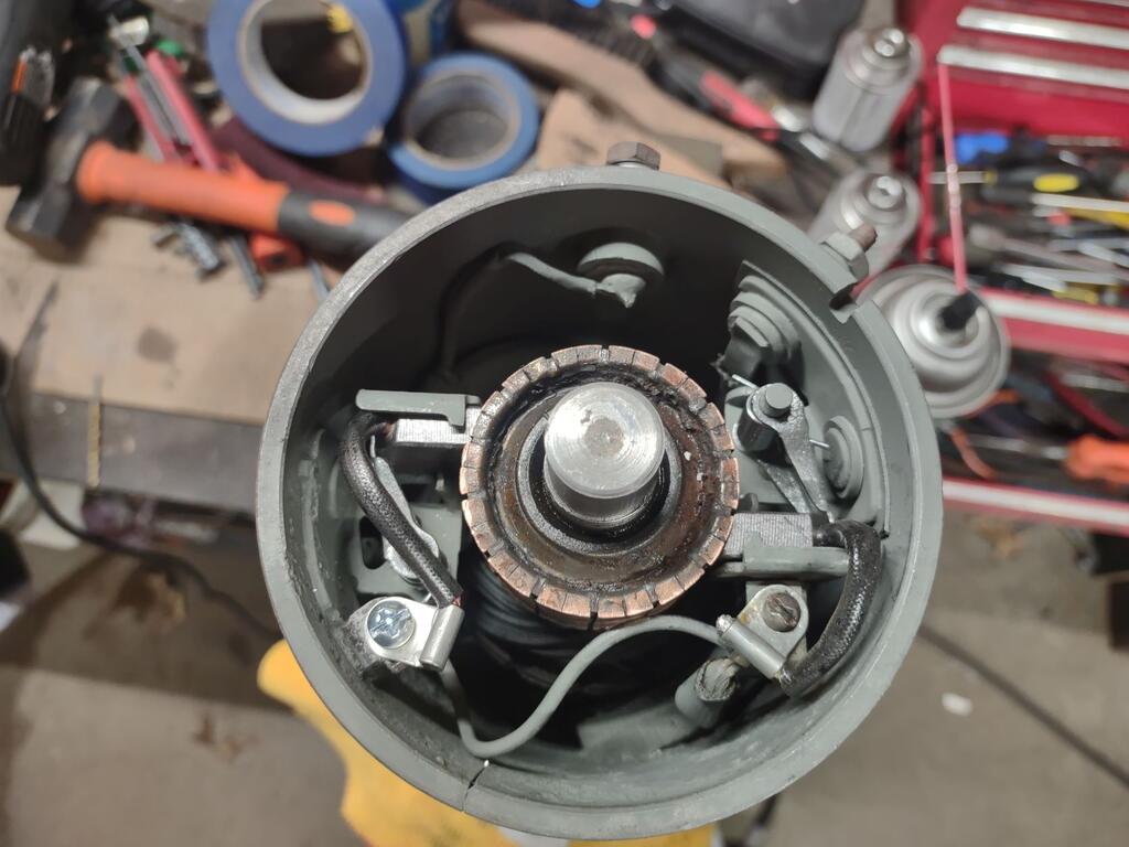

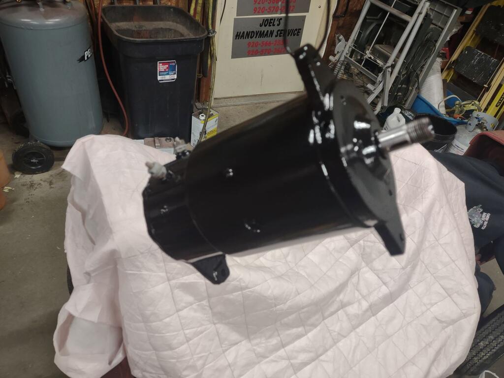

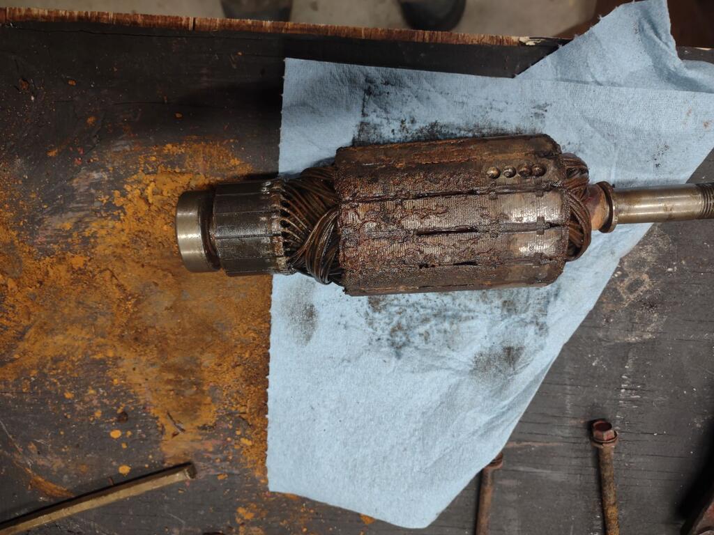

Achto 32,094 #17886 Posted December 5, 2022 (edited) A few post ago I shared some pics of the starter/gen mess that was on my 953. Here's a recap. After some scrubbing and some blasting it didn't clean up too bad. After evicting all of the rust, I sprayed a couple of coats of self etching primer on the inside parts to keep them from rusting again. Then installed a new rebuild kit. After bench testing the gen, it got a fresh paint job. All ready to install on the tractor. Edited December 5, 2022 by Achto 5 11 1 Share this post Link to post Share on other sites
ebinmaine 79,633 #17887 Posted December 5, 2022 1 hour ago, Ed Kennell said: spouting Gutters? Share this post Link to post Share on other sites
Ed Kennell 46,549 #17888 Posted December 5, 2022 21 minutes ago, ebinmaine said: Gutters? Yep, could be installed low enough so the snow could slide over top. With a buried pipe to take the water to the other side of the wall. 1 Share this post Link to post Share on other sites
8ntruck 9,039 #17889 Posted December 5, 2022 3 hours ago, Panther416-8 said: Made a battery hold down today, did the RandyL mod. No more bunjee cord. Thanks @RandyLittrell for the idea. I like it. Both of my tractors need battery hold downs. @RandyLittrell, think I'll borrow the idea too. Share this post Link to post Share on other sites
davem1111 2,282 #17890 Posted December 5, 2022 23 minutes ago, 8ntruck said: I like it. Both of my tractors need battery hold downs. @RandyLittrell, think I'll borrow the idea too. Yeah, I need to make a few of those myself. Looks nice, and functional. 1 Share this post Link to post Share on other sites
RandyLittrell 3,944 #17891 Posted December 5, 2022 32 minutes ago, 8ntruck said: @RandyLittrell, think I'll borrow the idea too. It is one of my few idea's that didn't require someone to hold my beer!! Randy 3 Share this post Link to post Share on other sites

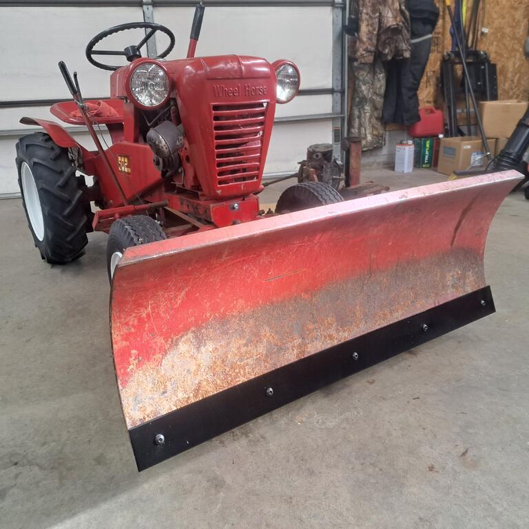

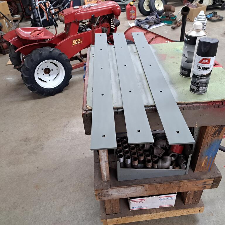

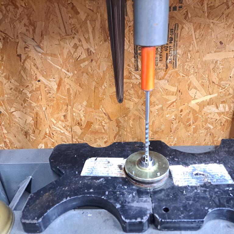

WHX?? 57,381 #17894 Posted December 5, 2022 (edited) 15 hours ago, Achto said: starter/gen mess that was on my 953. Some PO had a pully on it that had no keyway ... how was that gonna work?!?!? Broached a keyway in it this morning... Figured as long I was painting some plow scrapers Dan kindly made I would be a nice guy and paint the pulley for him... Figured EB might like my choice of color but it just didn't look right.... So I changed it.... Edited December 5, 2022 by WHX?? 4 1 5 Share this post Link to post Share on other sites
Achto 32,094 #17895 Posted December 5, 2022 6 minutes ago, WHX?? said: Broached a keyway in it this morning Saweeet!! Thanks Jim! 1 Share this post Link to post Share on other sites

lynnmor 8,895 #17897 Posted December 5, 2022 15 hours ago, Ed Kennell said: Yep, could be installed low enough so the snow could slide over top. With a buried pipe to take the water to the other side of the wall. When I built the pole barn, gutters were required and the downspouts had to be run into a seepage pit. Spouting and gutters seem to be interchangeable words in our area. The builder was a major player in the pole barn business in this area and he never heard of using gutter guards to keep the leaves out of the seepage pit even though it is right there in the ordinance The gutters and downspouts were farmed out to a third party that specialized in that work. I asked those folks to keep the gutters below the slide line to prevent backup and damage, they looked at me like I had two heads. It took some splainin' to get this simple matter across to the numbskulls. When they reached the underground pipe they wanted to go at an angle, so I said to use an offset and I got the same look, so I said to leave it alone and I'll take care of it. EB probably will have a major leaf problem with gutters, but it might be worth it to prevent erosion. Share this post Link to post Share on other sites
Ed Kennell 46,549 #17898 Posted December 5, 2022 (edited) 31 minutes ago, lynnmor said: When I built the pole barn, gutters were required and the downspouts had to be run into a seepage pit. Same here in Chanceford Twp. when I built my pole barn. Right after the last of three inspections, I disconnected the $1200 seepage pit and ran the downspouts onto barrels for irrigating my strawberry and blackberry plants. Leaves are a problem, but Eric can clean his gutters. from a 6' step ladder. Edited December 5, 2022 by Ed Kennell 1 Share this post Link to post Share on other sites
lynnmor 8,895 #17899 Posted December 5, 2022 1 minute ago, Ed Kennell said: Same here in Chanceford Twp. when I built my pole barn. Right after the last of three inspections, I disconnected the $1200 seepage pit and ran the downspouts onto barrels for irrigating my strawberry and blackberry plants. We are both in the same township. I'll be disconnecting one of the downspouts because the pipes are apart about a foot down and the rain water is washing out a corner pole. Share this post Link to post Share on other sites
