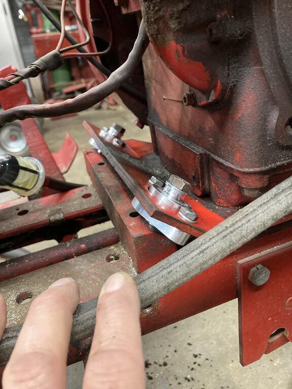

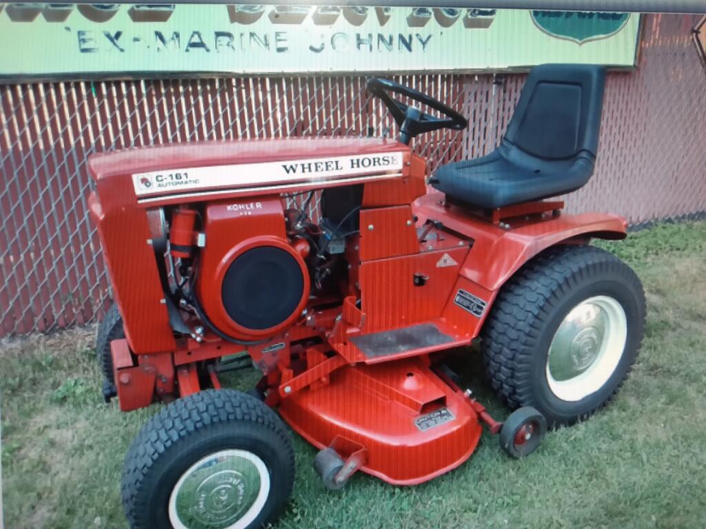

D_Mac 9,334 #17852 Posted November 27, 2022 9 hours ago, Blasterdad said: Put the new solid engine mounts on the C-161 tonight, ( the tuykey & pie wore off & coffee kicked in, lol ). These have been hanging on my workbench for 3 years, too many other 's wanting my attention. These are the Bee's Knees. I replaced them on my C-161 when I had it few years ago. One of the best mods I ever did to it and wished I did it sooner. 2 4 Share this post Link to post Share on other sites
Blasterdad 3,163 #17853 Posted November 27, 2022 6 minutes ago, D_Mac said: I replaced them on my C-161 when I had it few years ago. One of the best mods I ever did to it and wished I did it sooner. She is a beauty! I'm sure the new ownner is very happy! 1 Share this post Link to post Share on other sites

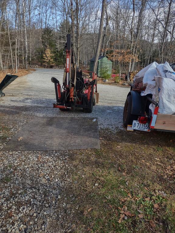

ebinmaine 78,115 #17856 Posted November 27, 2022 Got the seat put on Wally Digger the backhoe tractor. Messed around with it a little in the yard and then put it in its new home under the left shed overhang of the new barn. Seems to be pretty happy there. 8 4 Share this post Link to post Share on other sites

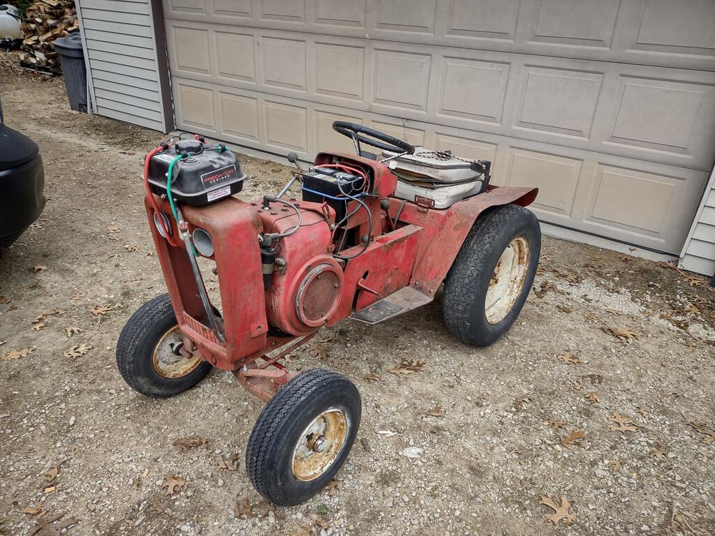

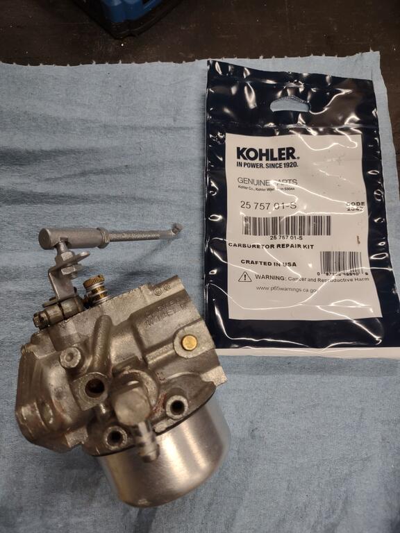

Achto 31,469 #17857 Posted November 27, 2022 (edited) Spent a little time with my 953 today. I acquired this tractor from @PeacemakerJack roughly about 3yrs ago, parked it in storage and hadn't done any thing with it until last weekend when I drug it out of storage. I found out that there was some issues with the starter/gen when I tried to start it but couldn't let a little thing like that stop me from seeing if I could make it run. 1 - Check to see that there was oil in it. 2 - rebuild the carb. Every thing cleaned to hospital sterilization. New kit, throttle shaft bushings, and reassembled. 3 - Make sure that I have power to the coil. 4 - Clean points and verify spark. 5 - Strap on an IV bottle. 6 - Wrap a rope around the S/G pulley & give 'er a pull. Second pull it fired up & runs well. Smokes a bit, stearing kind of works but that's OK for now. Transmission works well in all gears. Hydraulic pump also works well. Next step, tear it all apart to prep it for a resto. Edited November 27, 2022 by Achto 3 13 Share this post Link to post Share on other sites

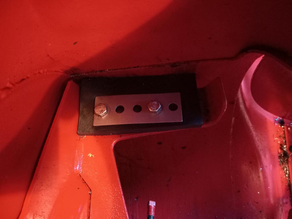

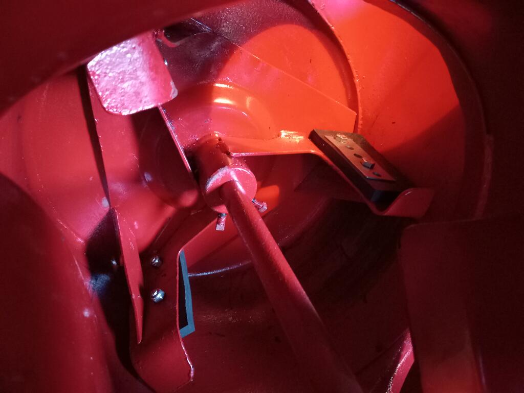

Panther416-8 342 #17859 Posted November 27, 2022 Cut some 1/2" SBR, drilled my impeller blades and attached with some stainless steel straps, bolts and nuts. Snug against the inside of the chamber but I can rotate by hand easy enough. 4 7 Share this post Link to post Share on other sites

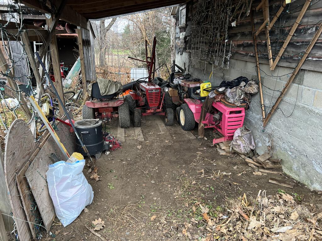

WHGuy413 2,851 #17860 Posted November 27, 2022 Spent a decent amount of time cleaning and moving tractors around today in my big shed. Still a few things to move around but should give the boys ample room for their new tractors we pick up next weekend. If all goes well these 2 wheeler and made a deal for 5 wheel horses and attachments/ accessories. I’m sure Alex will fill you all in when it happens. 7 2 Share this post Link to post Share on other sites

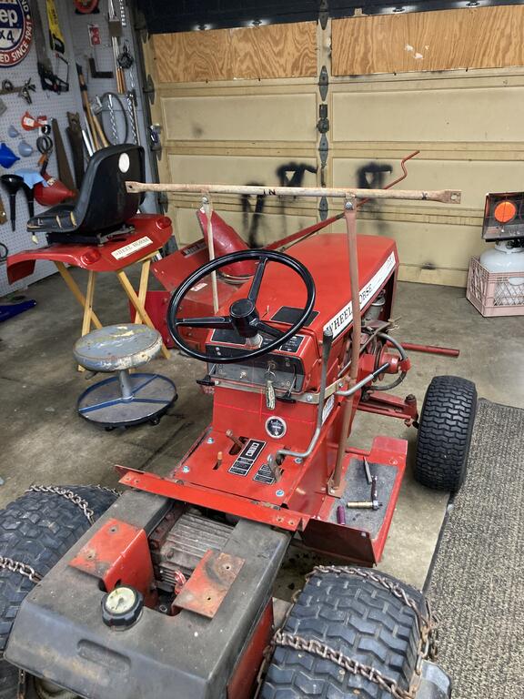

Blasterdad 3,163 #17861 Posted November 28, 2022 Got the C-161 back together, new ammeter, new mounts work greatI Started to put the snow cab on. 8 4 Share this post Link to post Share on other sites

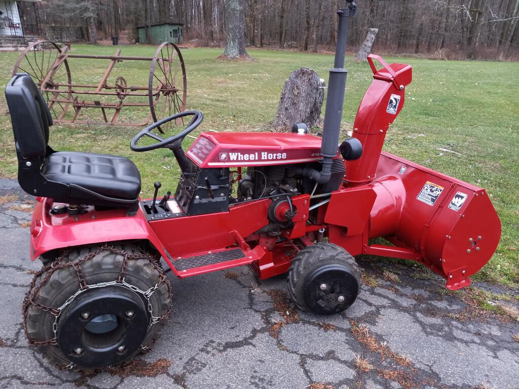

Panther416-8 342 #17862 Posted November 28, 2022 Finally finished the re-assembly and attachment of the two stage blower. Everything seems to run as it should. I wish this tractor had power steering, that blower is darn heavy. Linear actuator for the chute deflector shipped today so I guess that's next weekend's project. 7 5 Share this post Link to post Share on other sites
WHGuy413 2,851 #17863 Posted November 29, 2022 2 hours ago, Panther416-8 said: Finally finished the re-assembly and attachment of the two stage blower. Everything seems to run as it should. I wish this tractor had power steering, that blower is darn heavy. Linear actuator for the chute deflector shipped today so I guess that's next weekend's project. Even harder to steer when one front tire goes flat on you. Not speaking from experience or anything lol. Good looking set up. 2 Share this post Link to post Share on other sites
Blasterdad 3,163 #17864 Posted November 29, 2022 12 hours ago, Panther416-8 said: I wish this tractor had power steering, that blower is darn heavy. You'll get used to turning when your moving only, much easier... Glad you got it together, looks great! 2 Share this post Link to post Share on other sites

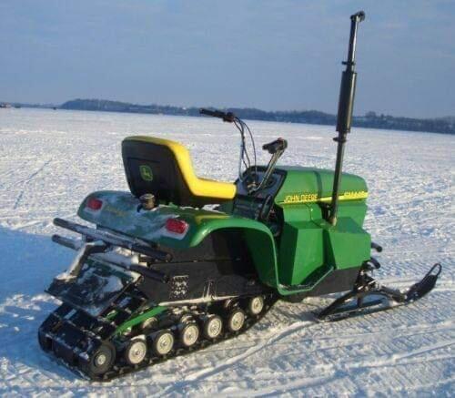

cleat 8,897 #17865 Posted November 30, 2022 I don't normally like green things but... 2 5 2 Share this post Link to post Share on other sites

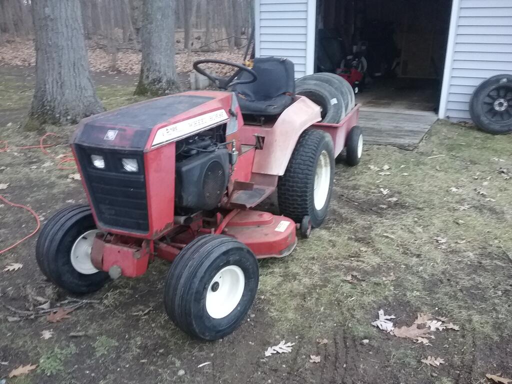

8ntruck 8,737 #17866 Posted November 30, 2022 (edited) Tis the season for changing the Jeep's summer tires for snow tires. Clyde got tapped for a little cart hauling time to get the winter tires from the shed out to the driveway and return the summer tires to the shed for storage. Note the fresh painted front wheels and new 5 ribs. I was really surprised at how well Clyde fired up. He hasn't been run for about 2 months and his battery was down. The starter would spin, but not engage the flywheel. I put a charger on the battery for maybe 15 minutes. Was enough. He fired right up in maybe two crankshaft revolutions. Interesting story on the Jeep. Before we left for Kentucky a week ago, we had noticed a "clunk" noise in the drivetrain when backing out of a parking spot with the front wheels turned to full lock. Dropped it off at the local dealer. Turns out that it was something in the rear driveshaft - it was replaced. Now the good news - it was covered by warranty! My bill was only $130. Inspecting the tread on the summer tires tells me they are done. Will replace them with new summer tires next spring. Edited November 30, 2022 by 8ntruck 6 Share this post Link to post Share on other sites

Wheelhorse#1 1,902 #17872 Posted November 30, 2022 17 hours ago, 8ntruck said: Note the fresh painted front wheels and new 5 ribs. @8ntruck Good looking front tires there.What size and brand are you running ? 2 Share this post Link to post Share on other sites
8ntruck 8,737 #17873 Posted November 30, 2022 1 hour ago, Wheelhorse#1 said: @8ntruck Good looking front tires there.What size and brand are you running ? Those are Vredestein V61 tires. The size is 18x8.50-8. Got them from Miller Tire. 1 2 Share this post Link to post Share on other sites
