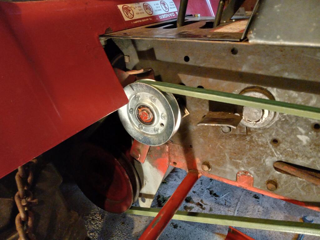

Panther416-8 342 #17832 Posted November 25, 2022 Replaced a noisy tension pulley. Bought the pulley from NAPA (7-05485). Gave it a few extra pumps of grease with a needle before installing...nice and quiet now. 9 2 Share this post Link to post Share on other sites

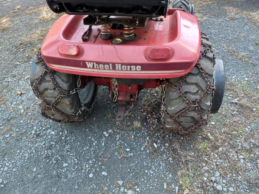

Panther416-8 342 #17833 Posted November 25, 2022 Found an old pair of diamond chains with V bars that seem to fit the rears pretty well. Gotta get a pair of chains for the front. 8 4 Share this post Link to post Share on other sites
ebinmaine 79,633 #17834 Posted November 25, 2022 26 minutes ago, Panther416-8 said: diamond chains with V bars Love those. The ultimate in gription right there. 1 Share this post Link to post Share on other sites

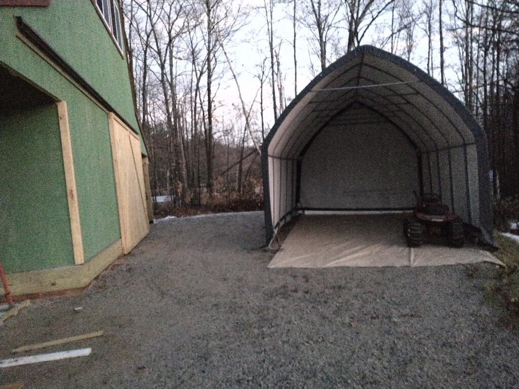

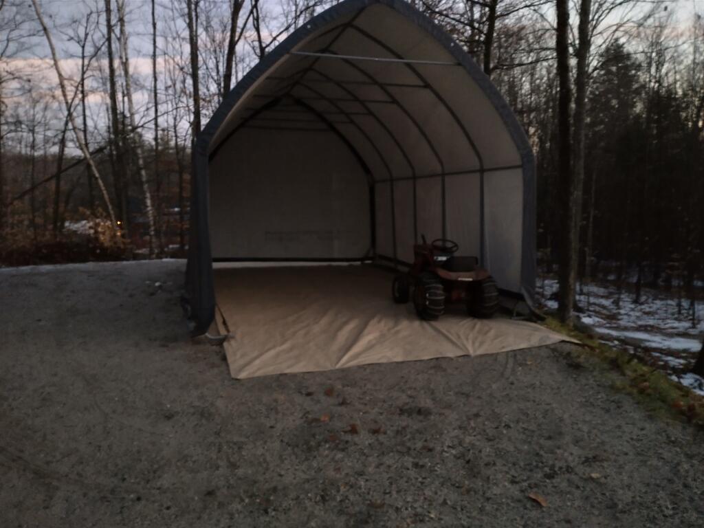

ebinmaine 79,633 #17835 Posted November 25, 2022 Been spending time moving things around today. The gray portable garage is out of the front lawn and over behind the new shop building. We used Trina's 867 Pigpen to pull my non running Ariens S16H across the yard to its new house. Pigpen is now setting comfortably in the newly relocated tarp garage. 6 4 Share this post Link to post Share on other sites
peter lena 9,939 #17836 Posted November 25, 2022 @Panther416-8 yup thats what you want , that pully and original undersize bearing . is a chronic problem , fairly easy to swap out and grease needle improve , get some aerosol tube lubricant into that lift lever end point , both sides of the chassis , make the rust run out . you done good , greasy , pete 1 Share this post Link to post Share on other sites

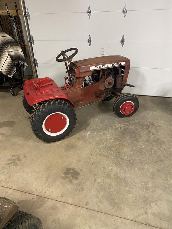

Tonytoro416 1,372 #17838 Posted November 26, 2022 (edited) Still picking at the Raider 12. Getting it ready for snow. Have seat out getting reupholstered. Makes me want to paint the rest of the tractor now. UPDATE: still waiting on the seat to get done. Having hard time getting the foam in. Should be shipped this week Edited December 4, 2022 by Tonytoro416 Update 7 2 Share this post Link to post Share on other sites
peter lena 9,939 #17839 Posted November 26, 2022 @Tonytoro416 if you can't paint it , you can give it a lubrication soak / rub down , retain patina , stop rust , shed water like a duck , thats what I am seeing , opportunity . also get some aerosol lubrication in that lift lever , bushing set up , both sides , make the rust run out , looks sharp like it is , get after that plow steering quadrant , slide pin area , red aerosol grease , extension tube , get greasy , pete 2 Share this post Link to post Share on other sites

Wheelhorse#1 1,956 #17842 Posted November 26, 2022 (edited) 21 hours ago, ebinmaine said: Love those. The ultimate in gription right there. Yep...haven't seen that style before.Makes sense they would have more traction.Old style usually means better made .But what do I know, Im just a old geezer Edited November 26, 2022 by Wheelhorse#1 1 2 Share this post Link to post Share on other sites
ebinmaine 79,633 #17843 Posted November 26, 2022 42 minutes ago, Wheelhorse#1 said: Yep...haven't seen that style before.Makes sense they would have more traction.Old style usually means better made .But what do I know, Im just a old geezer My experience and speaking with others shows old chains are much better made. The diamond pattern chain is a standard up here in logging country. They don't move around as much as a standard cross chain. The grip is better in different directions. Also, the ride is smoother. 3 Share this post Link to post Share on other sites

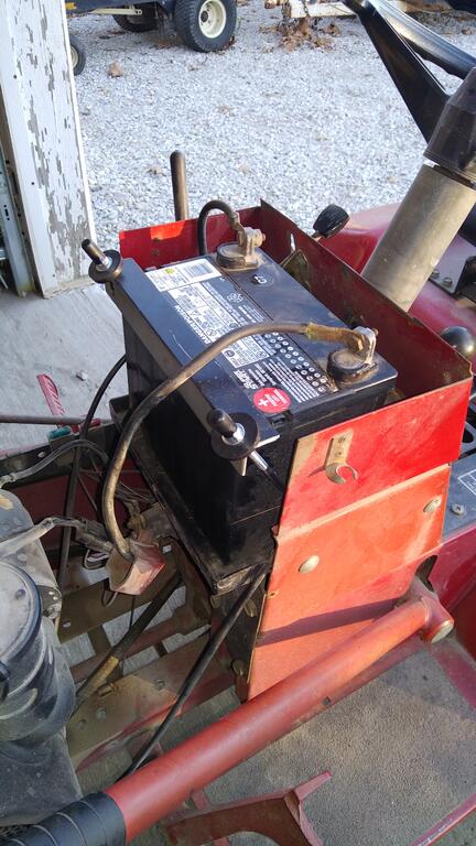

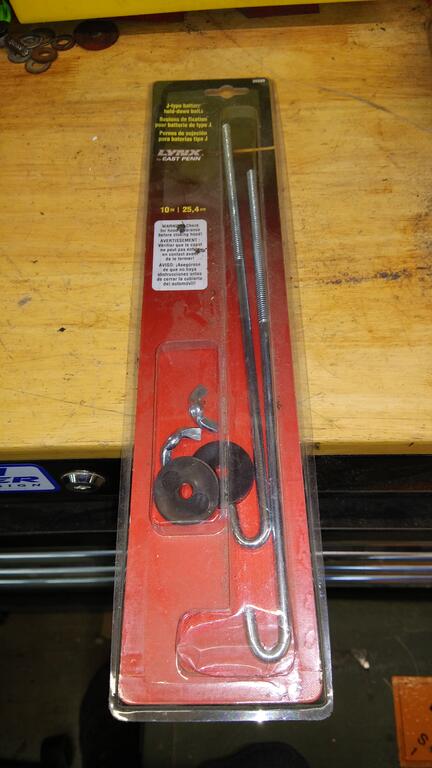

RandyLittrell 3,944 #17844 Posted November 26, 2022 Finally replaced the rubber tarp strap with a proper battery hold down on the 310, I am not sure how it was originally, but think this will work. You guys with your reading glasses on will notice the need for new battery cables, they will be fixed later in the week!! 5 2 Share this post Link to post Share on other sites

953 nut 67,361 #17846 Posted November 27, 2022 3 hours ago, RandyLittrell said: new battery cables, they will be fixed later in the week Buy a longer ground cable that can be bolted to the engine block on one of the starter bolts. 2 1 Share this post Link to post Share on other sites

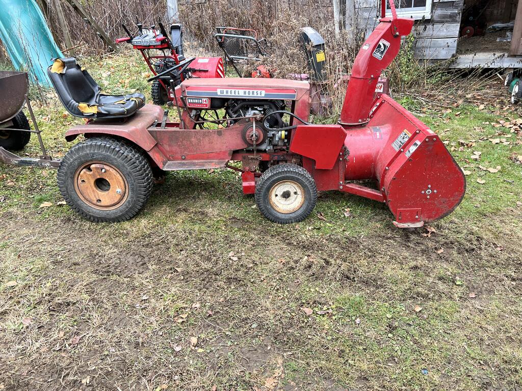

WHGuy413 2,859 #17847 Posted November 27, 2022 (edited) I detached the 2 stage from my grandfathers old 1848. I haven’t had time to figure out the no start issue with it. I reattached it to the bronco 14 which happens to be the same grandfathers. I think I’ve got it all hooked up right minus a couple springs and the belt. Of course the bronco14 ran out of gas right there and when I went to look for the gas can the boys had used all my gas in the 4 wheeler and never told me. yes that’s another 2 stage in the background sticking up to the left of the chute. That’s a ber-vac. I bought it for 50 bucks and it works great. This is the first year of having a wheel horse 2 stage and I figured I’d give this one a try and see how it does compared to the other. Edited November 27, 2022 by WHGuy413 8 3 Share this post Link to post Share on other sites

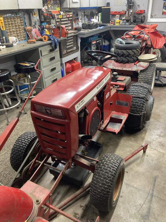

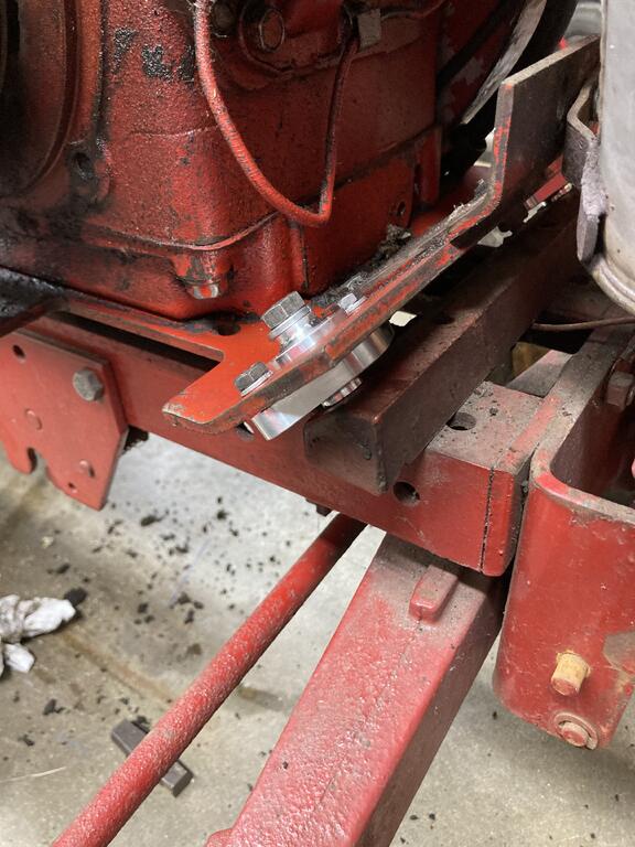

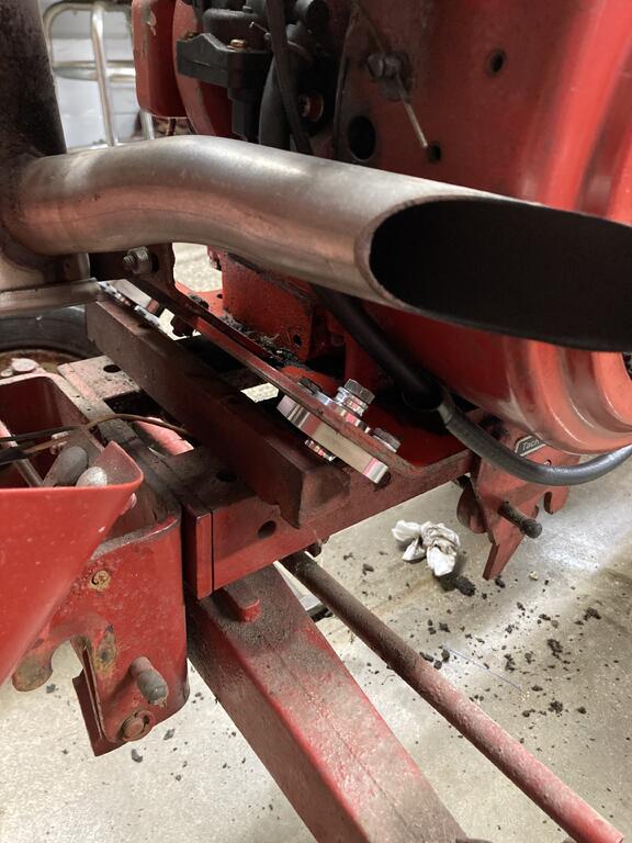

Blasterdad 3,167 #17849 Posted November 27, 2022 Put the new solid engine mounts on the C-161 tonight, ( the tuykey & pie wore off & coffee kicked in, lol ). These have been hanging on my workbench for 3 years, too many other 's wanting my attention. These are the Bee's Knees. 5 4 Share this post Link to post Share on other sites
Panther416-8 342 #17850 Posted November 27, 2022 16 hours ago, RandyLittrell said: Finally replaced the rubber tarp strap with a proper battery hold down on the 310, I am not sure how it was originally, but think this will work. You guys with your reading glasses on will notice the need for new battery cables, they will be fixed later in the week!! Looks nice Randy's. What did you do, just cut and drill a piece of angle steel? Do the J rods hook into the stock hold down holes in the tray? I've been waiting since August for a stock battery hold down set from WH &More but they are having trouble getting them in from their supplier. I might go this route. Matt 1 Share this post Link to post Share on other sites
