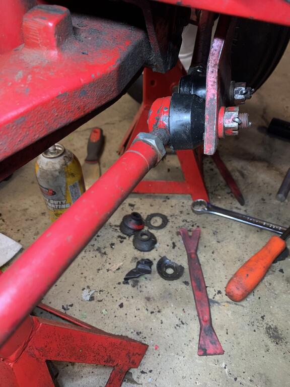

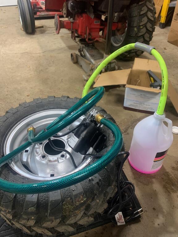

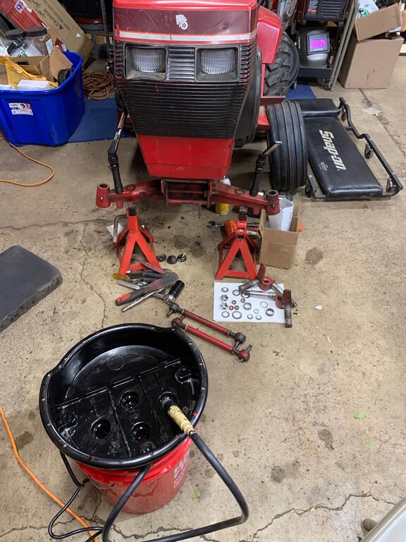

Andy N. 2,803 #17756 Posted November 21, 2022 Really a 2 weekend project.... installed reduction steering kit on the 520-H along with new boots around the steering rod ends as well as fluid filled the rear tires. I did not have good luck steering in the snow with the tri rib front tires so I took them off and installed 5 ribs. Also got the snow removal fleet ready for winter. 7 7 Share this post Link to post Share on other sites

cleat 9,004 #17763 Posted November 21, 2022 2 hours ago, Andy N. said: Really a 2 weekend project.... installed reduction steering kit on the 520-H along with new boots around the steering rod ends as well as fluid filled the rear tires. I did not have good luck steering in the snow with the tri rib front tires so I took them off and installed 5 ribs. Also got the snow removal fleet ready for winter. Where did you get the shiny new tie rod boots ? They look great. 1 Share this post Link to post Share on other sites
Andy N. 2,803 #17764 Posted November 21, 2022 8 hours ago, cleat said: Tie rod boots. https://www.amazon.com/dp/B000CN7B5C?psc=1&ref=ppx_yo2ov_dt_b_product_details Share this post Link to post Share on other sites
cleat 9,004 #17765 Posted November 21, 2022 Great. Thanks. I am rebuilding another 520 this winter may need need to replace the boots. 1 Share this post Link to post Share on other sites

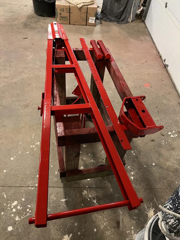

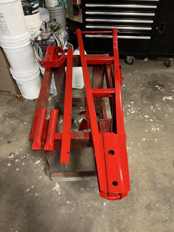

WheelHorse_Kid 359 #17766 Posted November 21, 2022 My dad stayed late after work and painted my plow.I think it is looking good.we are going to let the paint dry and put it together on thanksgiving. 4 7 2 Share this post Link to post Share on other sites
19richie66 17,929 #17767 Posted November 21, 2022 10 minutes ago, WheelHorse_Kid said: My dad stayed late after work and painted my plow.I think it is looking good.we are going to let the paint dry and put it together on thanksgiving. Looks great. You are doing a great job. 2 1 Share this post Link to post Share on other sites

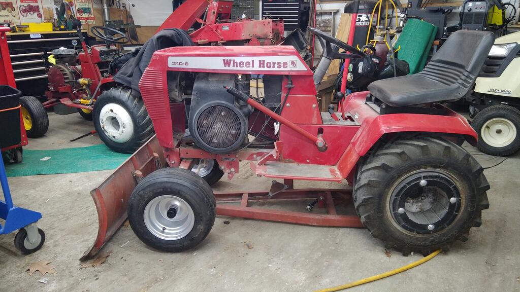

RandyLittrell 3,944 #17773 Posted November 22, 2022 Got rid of the devils spawn 6" wheels and put some 8" wheel and tires on the front of the 310. I really need to get the rear wheels painted now!! 6 3 Share this post Link to post Share on other sites
ebinmaine 79,633 #17774 Posted November 22, 2022 9 minutes ago, RandyLittrell said: Got rid of the devils spawn 6" wheels and put some 8" wheel and tires on the front of the 310. I really need to get the rear wheels painted now!! Randy if you don't want those extended length front spindles let me know 1 Share this post Link to post Share on other sites
